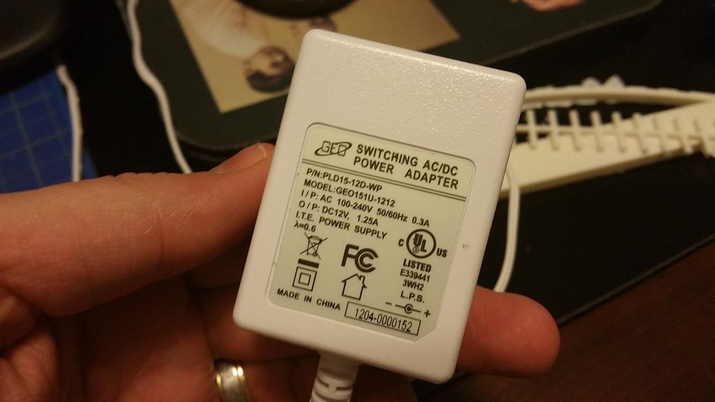

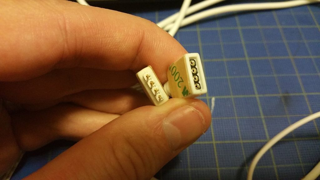

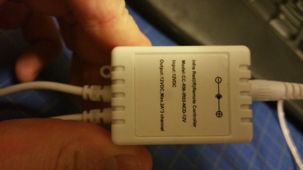

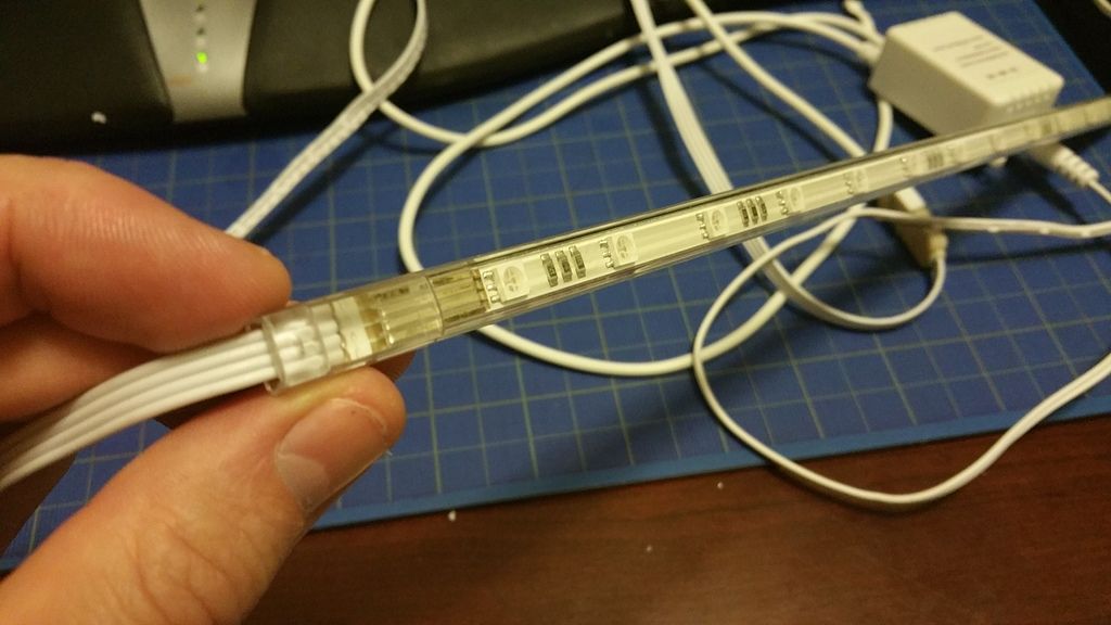

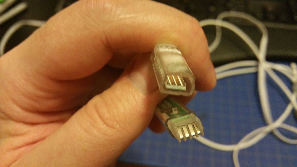

Hey everyone! I have this light setup that I kinda inherited and it works great for my engine assembly. Problem is that I also wanna add in some more LED's for the headlights and running lights under the hull and I know nothing about LEDs and how to hook them up. I was wondering if anyone has any ideas how I could hook up more lights to this. Or if I just need to run a completely separate set of wiring for the rest of the lights.
To give you an idea what I am thinking...

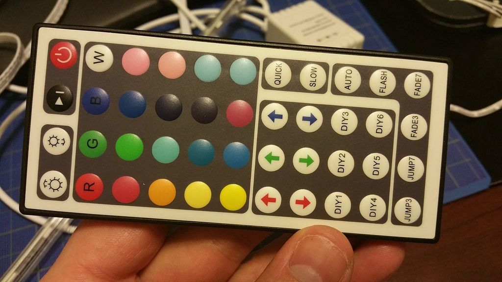

These lights I have come with a remote. If I can wire it all up to that I would love it. This light setup allows me to change the colors of the lights which is also awesome.
Here are some pics of the setup I have. Showing them in order of the connection from the power to the light.

I have a similar lighting set and was thinking of just feeding fibre optic cable off it. Maybe glueing it to the strip and feeding it off where you need it to go?

Yeah that would work, but for the running lights and headlights I want more power than I can get from the fiber optics.

That was my first thought, too, Dimejinky.
Sir Charles, have you considered which of the desired lights would need only a simply 'on-off' function and then run those as a separate circuit? Also, the lighting 'systems' will logically serve different situations and so you'd not want everything operating at one time (such as the 'headlights' [flight] vs the 'underside illumination lights' [landed]?) Grouping the lights into 'modes' might allow for a simplified switching functionality.
One basic concept I can recall is your "circuits" can either be in parallel or in series. If you want separate control of individual circuits, then that is parallel 'wiring' which may already be a part of the switching remote's design, while series wiring is just one switch controlling an entire string. Christmas light strings are a perfect example for both: ones that the entire string fails if one 'bulb' is bad is a series circuit because the power goes through each element in succession so every light depends on the power coming through its predecessor. Strings that stay lit even with a failure because the individual bulbs each 'bridge' between continuous ground and 'hot' lines such that a failure in the 'bulb' doesn't break the lines. There are rules regarding how & what 'mixing' of parallel & series wiring you can do, but I cannot recall any specifics. Thank goodness for Google!

oh man..I want them all on at once and have no clue how to do that

DJ, look up stuff (aka 'Google' or 'DuckDuckGo.com') on parallel circuits so you can wire it all to one switch but won't loose them all if a single "lamp" stops working.

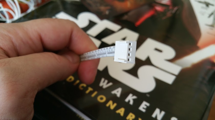

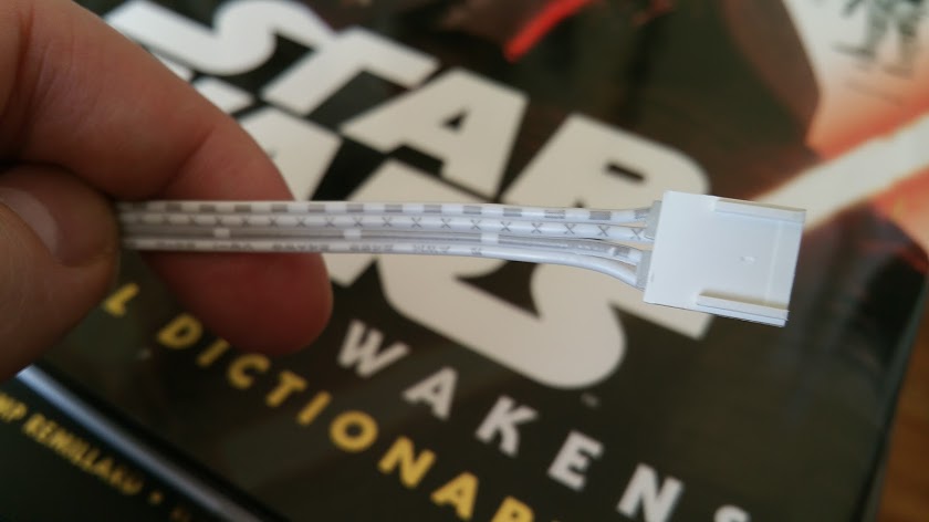

So going back to the images I posted with my wiring setup as it currently stands...
The 4th image shows the RGB connector that has 4 total slots on it. Those allow me to wire 4 sets of lights to this single RF sensor for remote control.
You can see in this image what the connector and cables look like. The other end of this wire is the one that connects into the strip as I showed above.

So up to four control "channels", each with separate LED's for each of the color control circuits, wired in parallel (I believe.) I'm assuming you cannot control individual LED's on the string, right? For example, if you program for a flashing red, ALL the reds will flash together, correct? If so, then essentially, each control "channel" (aka slot) can support individual control of up to 4 different LED circuits for a total of 16 possible. So, in theory, you could wire the red LED for the fiber as one, the underside LED's as two and the forward "lamps" as a third by hooking each to one of the color controls on the one cable. Whether you could run all at the same time depends on what it can do with RGB-W at the same time...
You'll need a multi-meter to map out which four wires are being powered depending on which channel you've selected (R-G-B-W.) Make sure you know how to use the meter since you're testing power-on, you don't want to damage anything. Alternatively, make a simple tester using some clamps and an LED (two wires.)
I can see from the pix that most likely each LED is using one of the six possible current feed combinations. If we call the four wires 1-2-3-4, then you can have 1+2, 2+3, 2+4, 3+4 and 4+1 & 3+1. With four color channels and 6 current combinations, obviously things can get fancy.
Once mapped, you then will need to determine how many LED's the thing will power on a single 'color' circuit. Again, testing using a breadboard setup can help validate your wiring setup before doing anything permanent. Recommend using the same size & approx. lengths of wire so the resistance will be comparable to the final desired wiring, if possible. The existing LED strip provides some idea, of course, if you can determine the ratings.
With luck, someone may have been through this exact thing before and can give you more specific guidance about this gear, but there are a lot of variables so experimentation may be the best (and perhaps most fun!) route to take.
