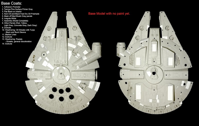

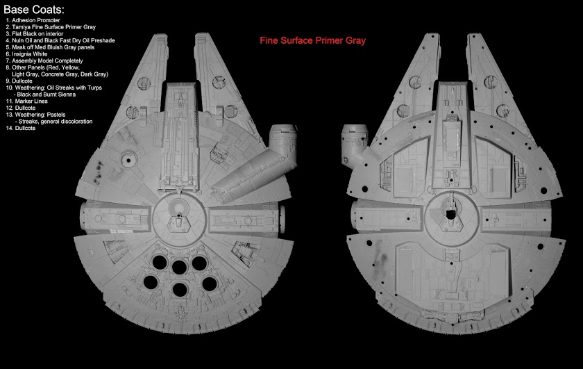

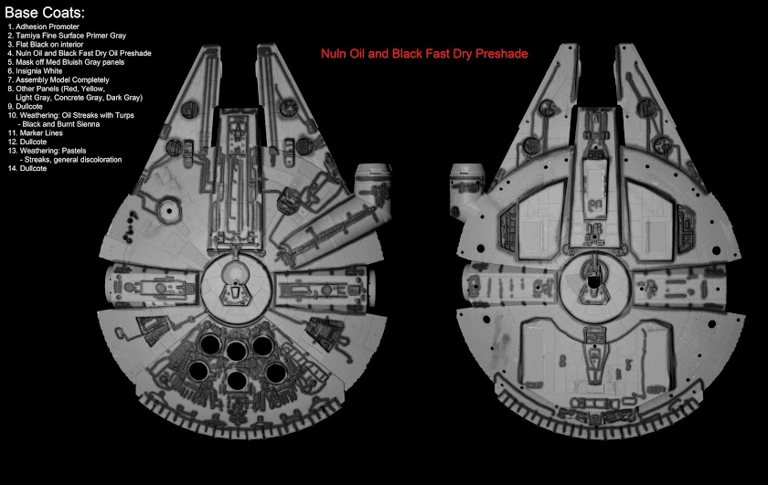

Ok, well I have been a bit busy building a wall...literally I am building a retaining wall in my backyard and its been occupying pretty much all of my free time of late.
But I did manage to get in a bit of work on my next step this weekend!! Here is my paint scheme plans for how I am going to approach painting my Hasbro Falcon!! Let me know what you think!
Please, feel free to point out any mistakes, either missing steps in my process, missing panels or hash marks, etc.
Disclaimer on this...These are MY plans, not necessarily going to be 100% screen accurate. So use these as reference at your own risk. If you wanna use it as a starting point feel free but I recommend you look at all of the details relative to actual reference images before you consider this bible. Also, the exact colors I plan to use are still a bit TBD. I just tried to narrow it down to a few colors that I will fill in later as I go with the actual color I find I like.
I stopped before the weathering stage, as thats a TON more work to add to this and I honestly don't think it will be of any help. I plan to kinda wing that as I go just looking at reference and adjusting as I go.
Hope you enjoy! I am hoping to get a bunch of feedback from you all and update this again before considering it final!
Also one last thing...If you really wanna see the differences, I recommend you download these images to your computer and look at them in an image viewer like XnView so you can flip between them. Since I am one at a time layering on each step, when you flip you can really catch the differences. Especially important in the Light gray and Hash Mark stages.
