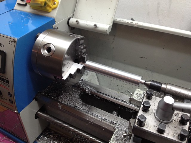

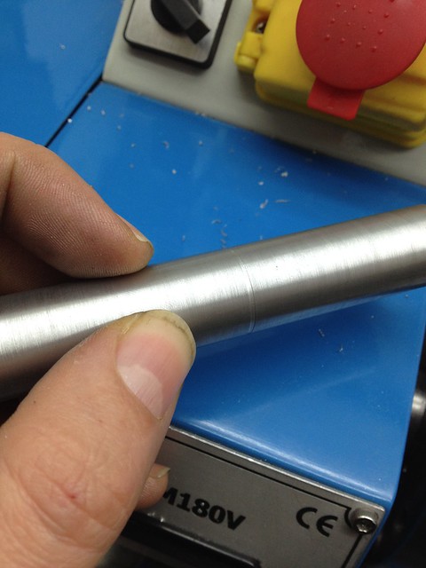

I started making the barrels, with the aluminum going first.
It all started out with a 22mm dia. stock of 5052 Aluminum.
All went well up until right about the end of the lathe work... I was a bit overzealous with the plunging of the drill into the bore and didn't put enough clamping force on the jaws... which resulted in a snag that stopped the piece while the chuck spun causing a gouge. I tired to take some material off in hopes of erasing it, but it's too deep to keep within an acceptable tolerance, so it's no good. Need to make a new one.
Still finished it off and will complete it along with the other one with the slot and tapped holes. It's a good representation of what the aluminum barrel looks like.
Steel is next...

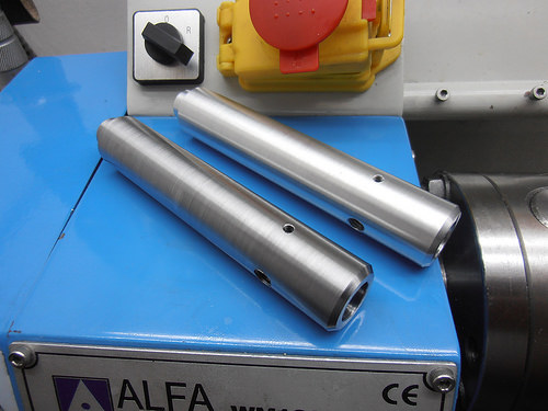

Quick update...
I have completed the lathe work on the barrels and will be taking them on Tuesday to a friends machine shop for the final cuts on his mill.
I ended up cutting 2 aluminum barrels and 4 steel barrels. So if anyone is interested, there are still 3 barrels available.
Teddz
Re: Tomenosuke Blade Runner Blaster Steel or Aluminum barrel
The barrels are all done and being packed up for shipping. I had made 4 steel barrels, but on one of them was no good.
Steel barrels:
3 steel and 2 Aluminum barrels:
There's still one Aluminum barrel available. Get it now and it ships next week with the rest.
