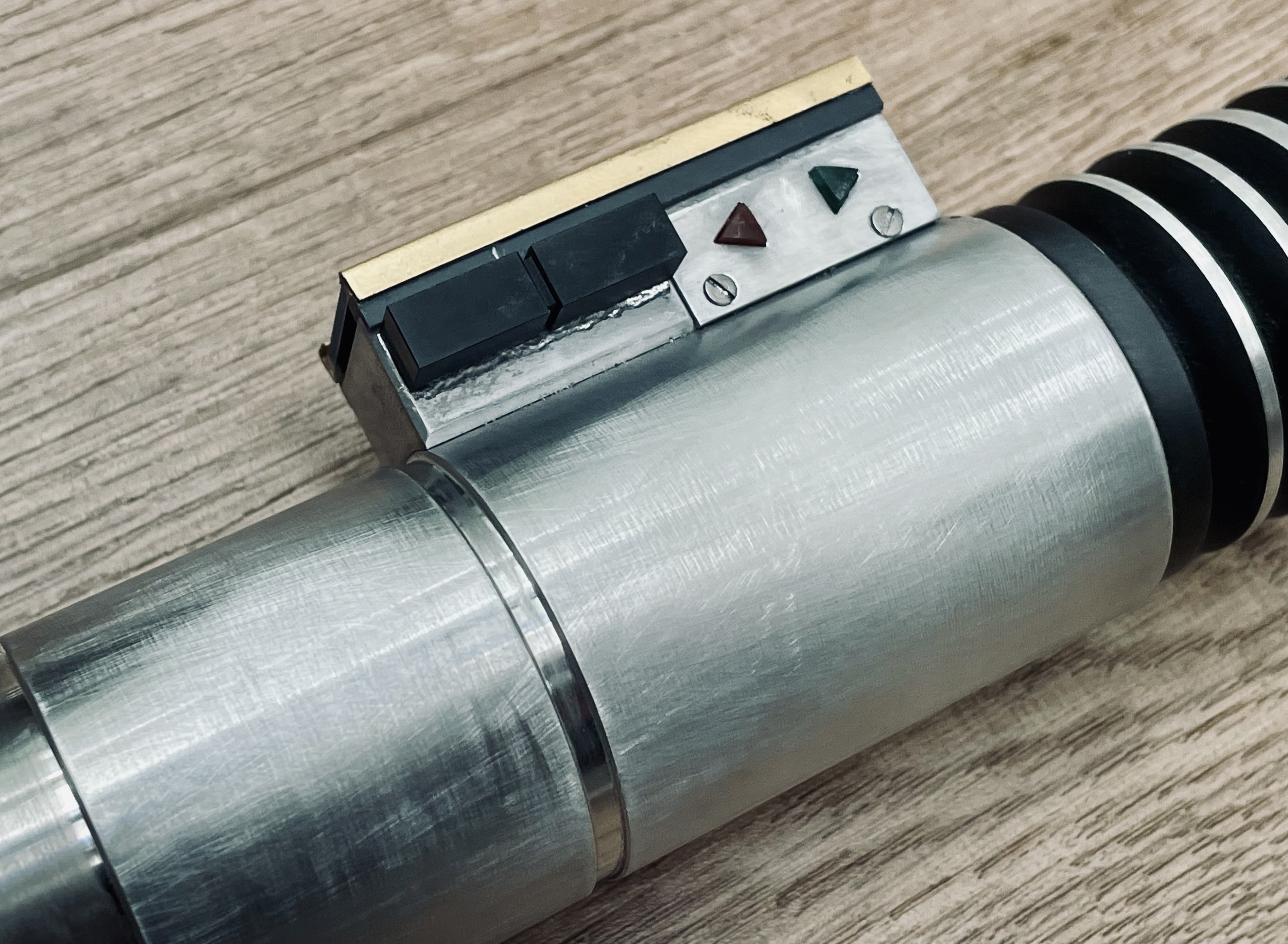

Adding to BRRogers theory that these were hand made rails is how thin they appear to be. The thickest part of the Death Star Brass is around .25mm or just under .01”. While it’s possible that they found prefab brass angle this is very thin even for modeling material; thinnest I’ve found is .014”. While this doesn’t seem like a large difference, when dealing with parts this small, ever bit counts

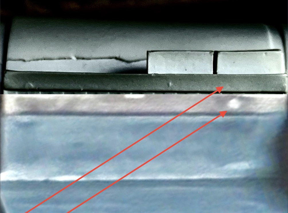

Just scanning over my casting, it’s really, really hard to capture in the lighting but there is a very slight, textural circle here IN the casting surface.
I’ll invite anyone with a lineage casting to see if it may be more pronounced on theirs (or not)
The K&S 1/8 Angles are .014 and are too thin compared to the blue card as far as I can tell from this picture.
If the real blue card is .06" then my guess is the real rails should be around .02" thick.
But if you add enough paint over a .014" brass rail it should add thickness to match the picture.
Just for comparison one brass piece that I have is 0.017" and is almost there, but still looks little too thin over the blue card.

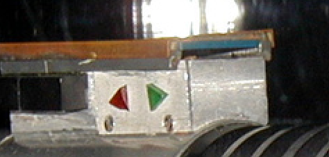

My 2 cents… I heartily believe the glue behind the black buttons dissolved the paint on the rails right above them. Revealing a brownish tarnish on the original brass. It’s always seemed to me they lightly painted the rails to more match the card because the brown tarnish looked really bad against the card for publicity
This is after filming. Raw brass during filming and a few years later.. maybe a decade… the rails tarnished in storage
As for the source, I don’t know. I do know ILM had an embossing machine and would run thin sheets of metal through it
Bryan I’ve never noticed the circles until now. I did always seen a triangle far left right above the black buttons
For myself this at least this is a solid confirmation that it is the same rail, and informs a bit about the coloration and layering.

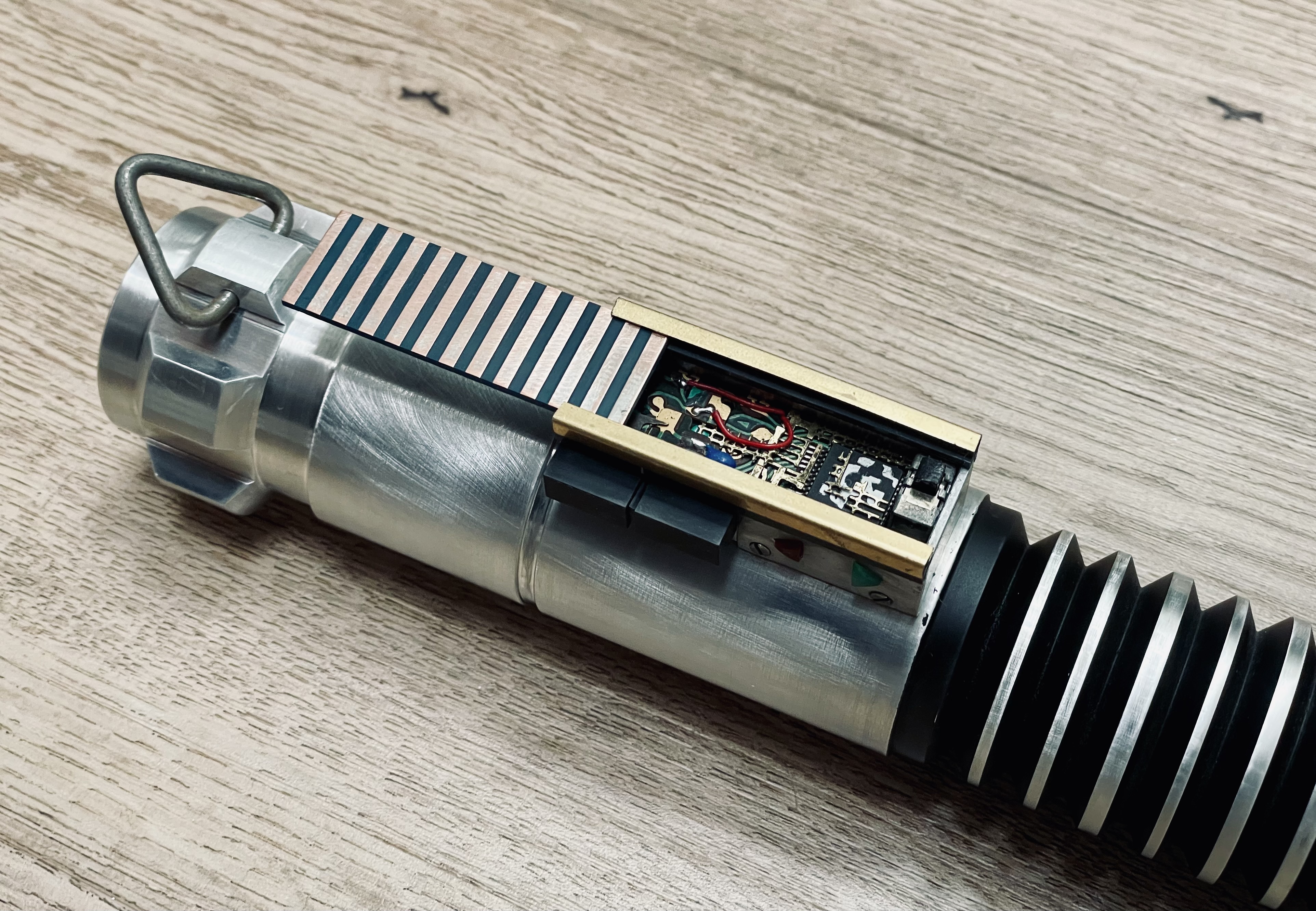

Step one. Tape up your brass
Step 2. Use ACE Interior Metallic Copper
(post NASA V3 neck paint)
Step 3. Remove masking and apply darkener.
Step 4. Enjoy accurately weathered rails.
(Optional end step, matte clear your clampcard and rails to lock in the color and texture)
Apologies for not masking a bit more intentionally- but this is after all just a quick process test

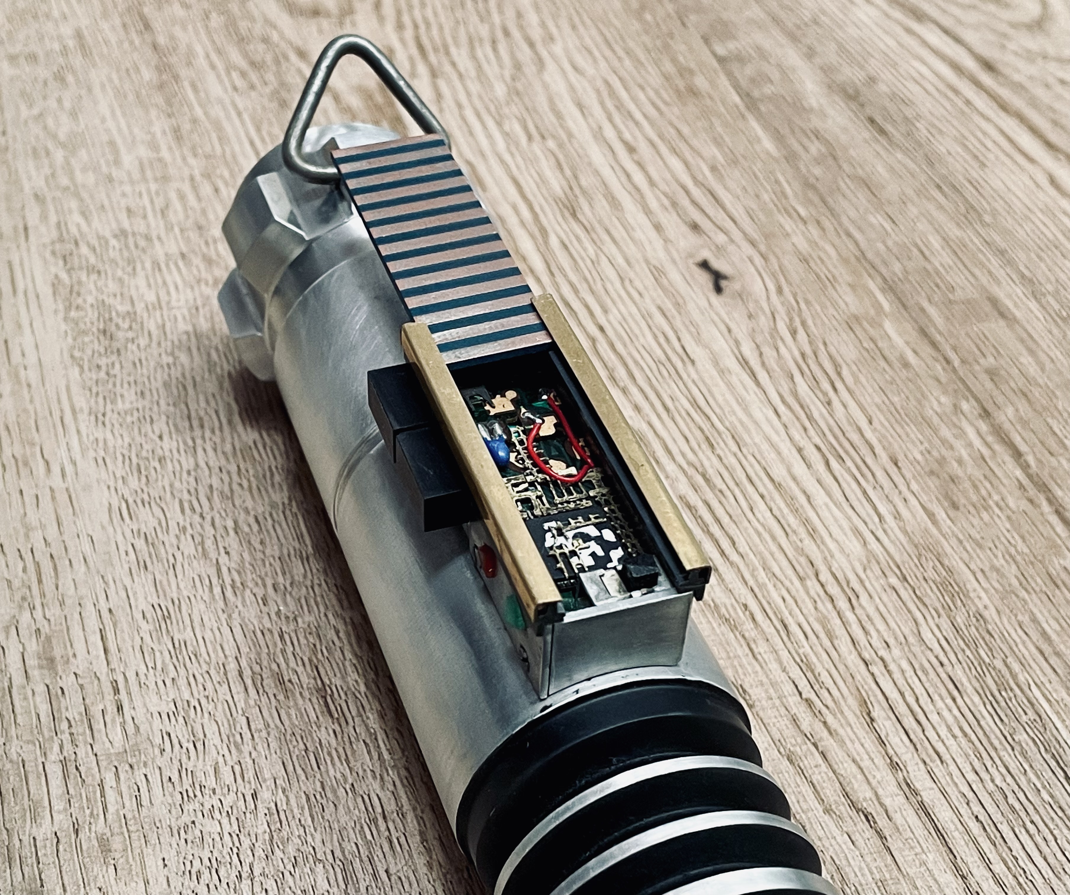

And a quick note about the assembly of rails outlined earlier in the thread…
The 3MM Albion Alloys L stock is not quite long enough for proper coverage which indicates something between 3-4mm (the MoM model uses 3.5)
So at this time I’m in agreement with the theory that it was production bent brass.
The other elements do seem to line up.
Plastruct Grey ABS L, T, and square balsa
