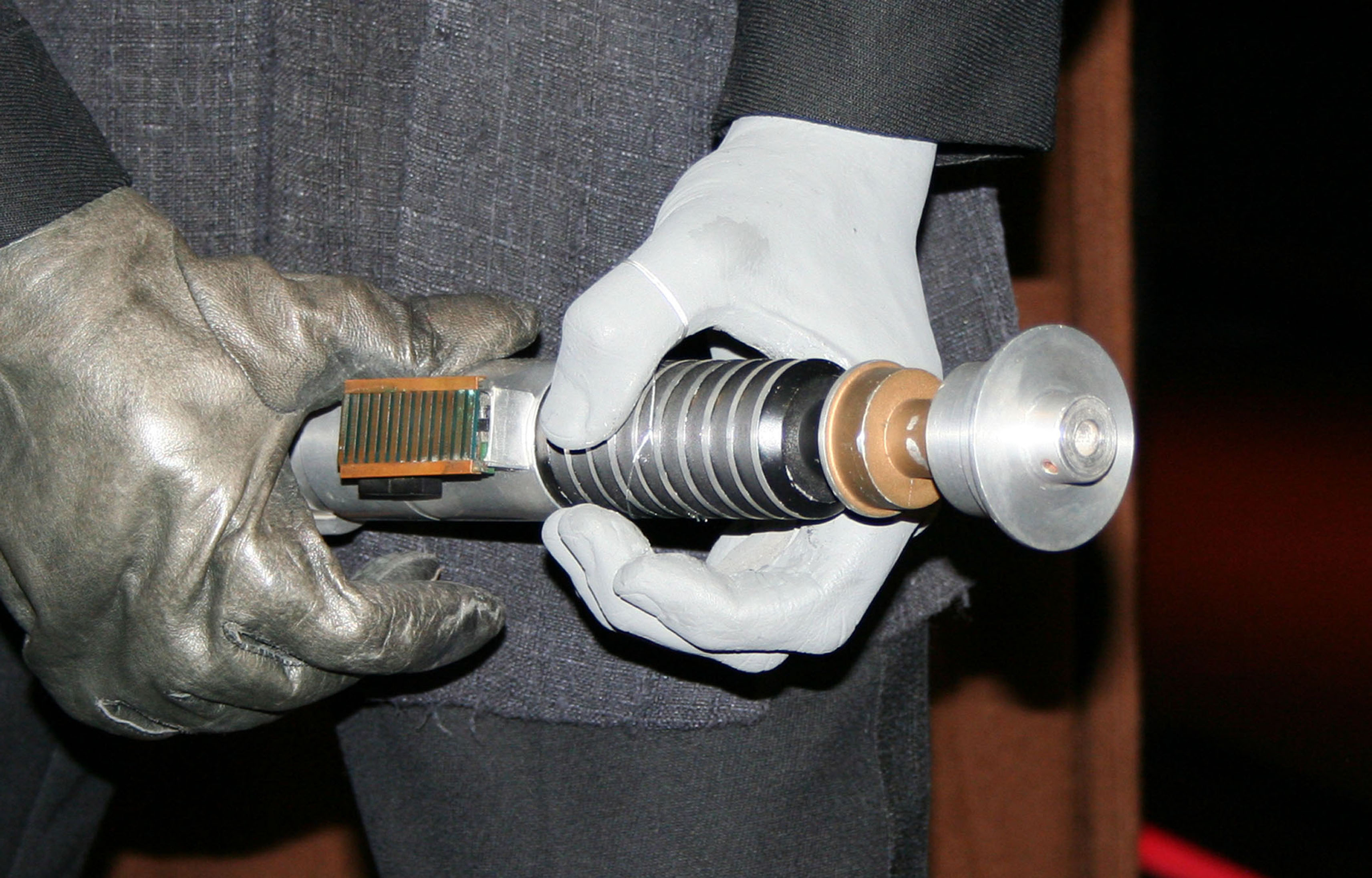

Are there images showing the slotted screw under the emitter lip? I think I missed this, and it changes some things for me
this is the main exhibit photo-wise.
Resembles a slotted screw which detail might’ve been burnished down along with surface buffing.
Confirmed? No, but convincing... considering the feature
