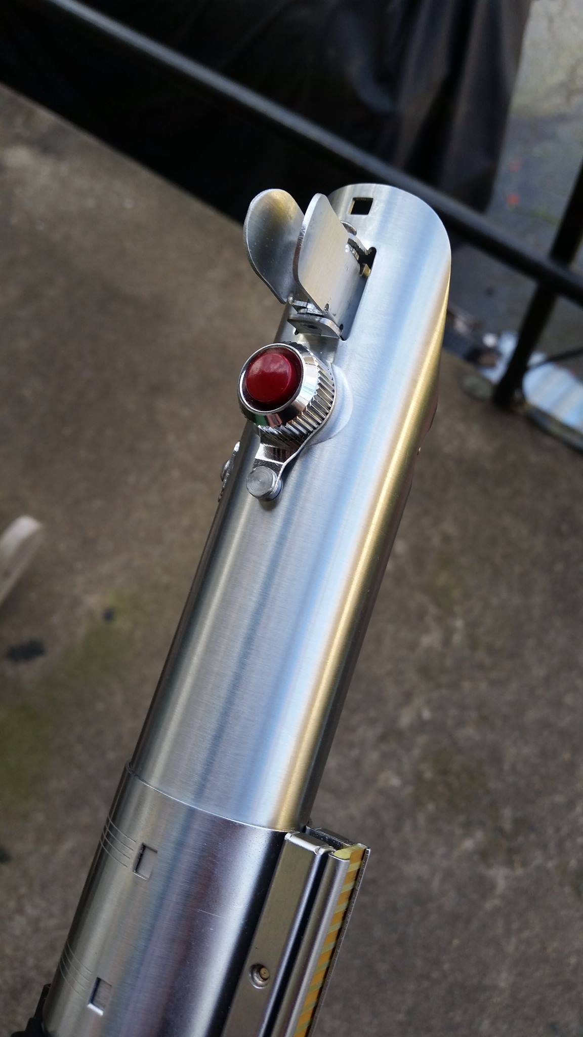

pics of the button please!? :)

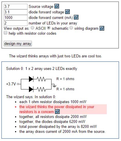

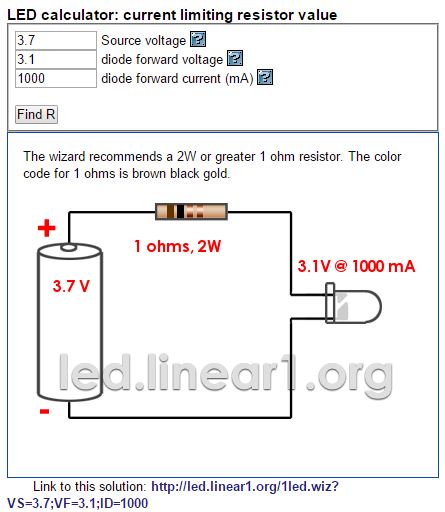

************* Resistor help **************
Battery - Panasonic Li-Ion 18650 3.7V 3400mAh
LED = Tri Cree Xpe2 (BBW)
Info for the Blues -
Illumination Color:Blue
If - ForwardCurrent: 1000 mA (Etsy listing says 350mA, Justin confirmed 350mA is not the max you can drive them, 350mA is what the Lumens listed are rated at. He said run them at 1000ma)
Vf - ForwardVoltage: 3.1 V
Power Rating: 3 W
Remember there are 2 blues and the white is for FOC.
This is what the online calc gets me for each one. -
When I run those numbers telling it I have 2 LEDs it gives me an error.
Someone please confirm what resistor/resistors I should be using.
Thank you!
Actually, you can just wire a .5 ohm resistor in series with the BBW and its ok. Look at this video for help (same setup as your build): https://youtu.be/ZldjWimMAvE
