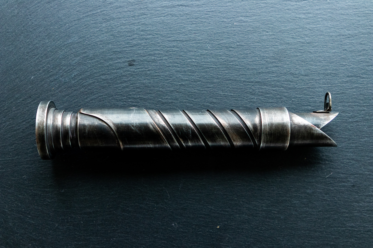

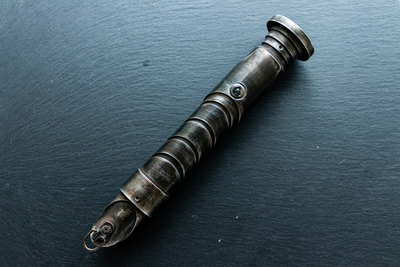

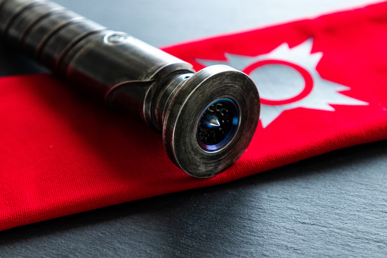

I managed to finish another one. This time, I went back to the Old Republic with the Lord of Hunger lightsaber.
Some years ago, I bought online one of the Nihilus hilts made by Holocron on Etsy back in the day.

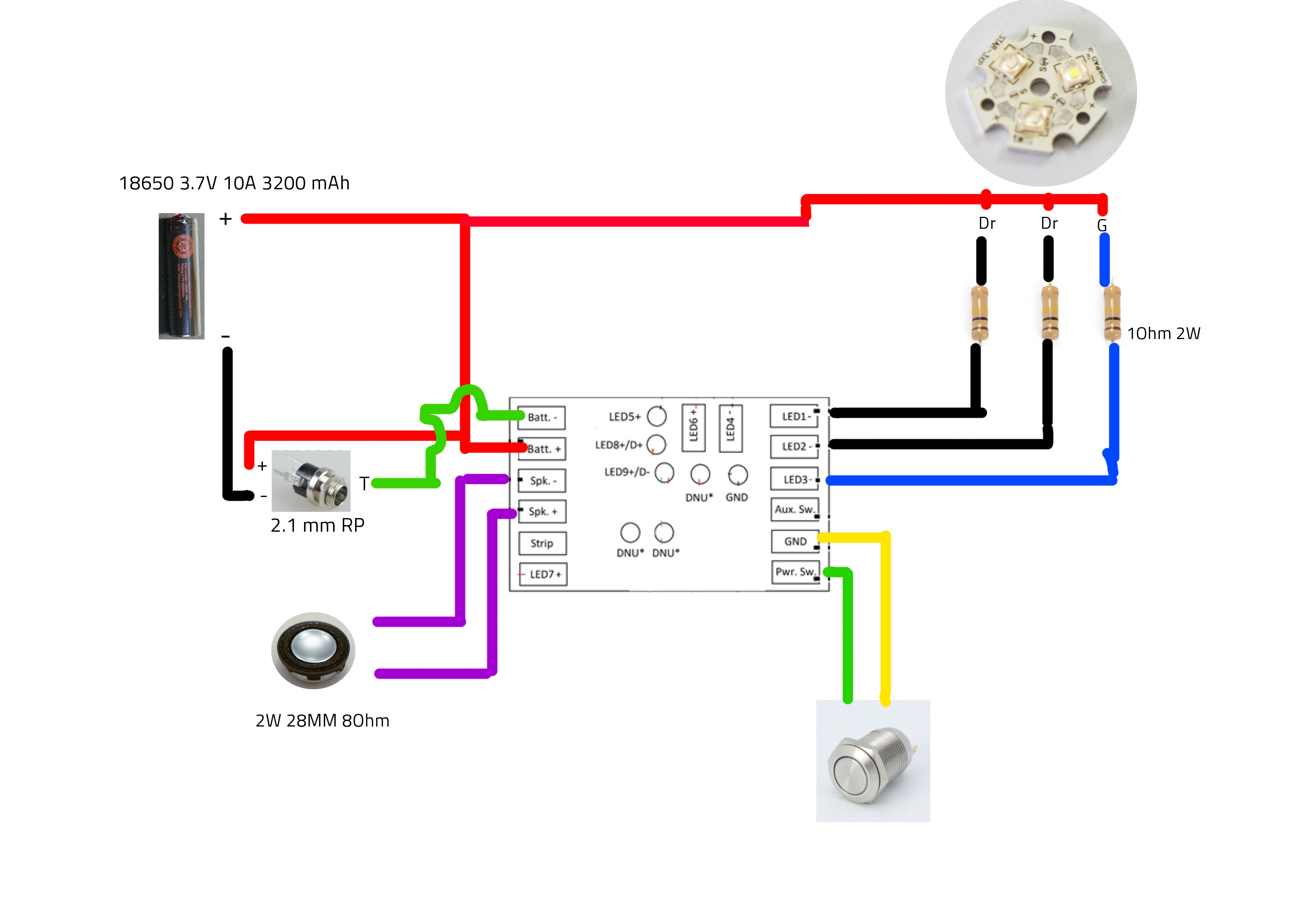

The hilt was installed with a NBV1 and a single Red LED.
As for the other ESB Graflex topic , I will list the material and items I used to build this saber and where I got them from.
Hilt : Nihilus Saber by Holocron
Chassis :
Glam Shots :
Chassis :
- 1" OD Heatsink Module For Single and Tri LED - The Saber Armory
- GOTH-3D All-In-One 1.10″ OD Variant 1 FDM ECO Chassis - The Saber Armory
- Main LED : Tri Cree XPE-2 LED DR/DR/G - The Saber Armory
- Battery : Panasonic Li-Ion 18650 3.7V 10A 3200mAh PCB Protected Rechargeable Battery - Solo's Hold
- Recharge Port : Switchcraft High Quality 2.1mm Recharge Port - The Saber Armory
- Switch : 12mm AV Momentary Switch Silver - The Saber Armory
- Speaker : 2W 28mm 8ohm OD Bass Speaker – The Saber Armory
- Board : Golden Harvest V3 - Sabertec
- Wires : 28awg Electronic Wire Kit,Flexible Silicone Wire 28 Gauge Stranded Wire Tinned Copper Wire - Amazon
- Resistors : 1ohm 2w resistor x3 – The Custom Saber Shop
- Blade plug : DarkSide Engineering
