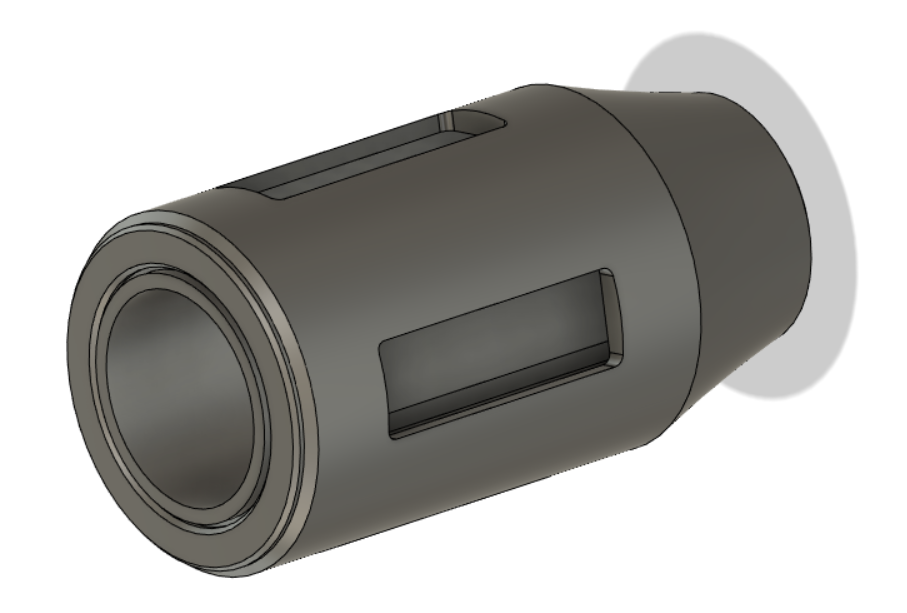

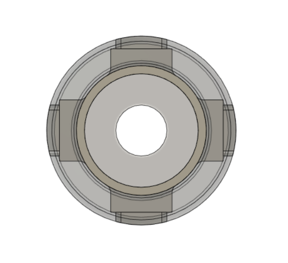

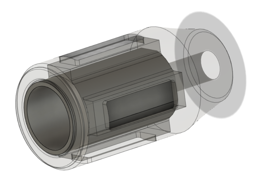

Currently I am doing work on the emitter..

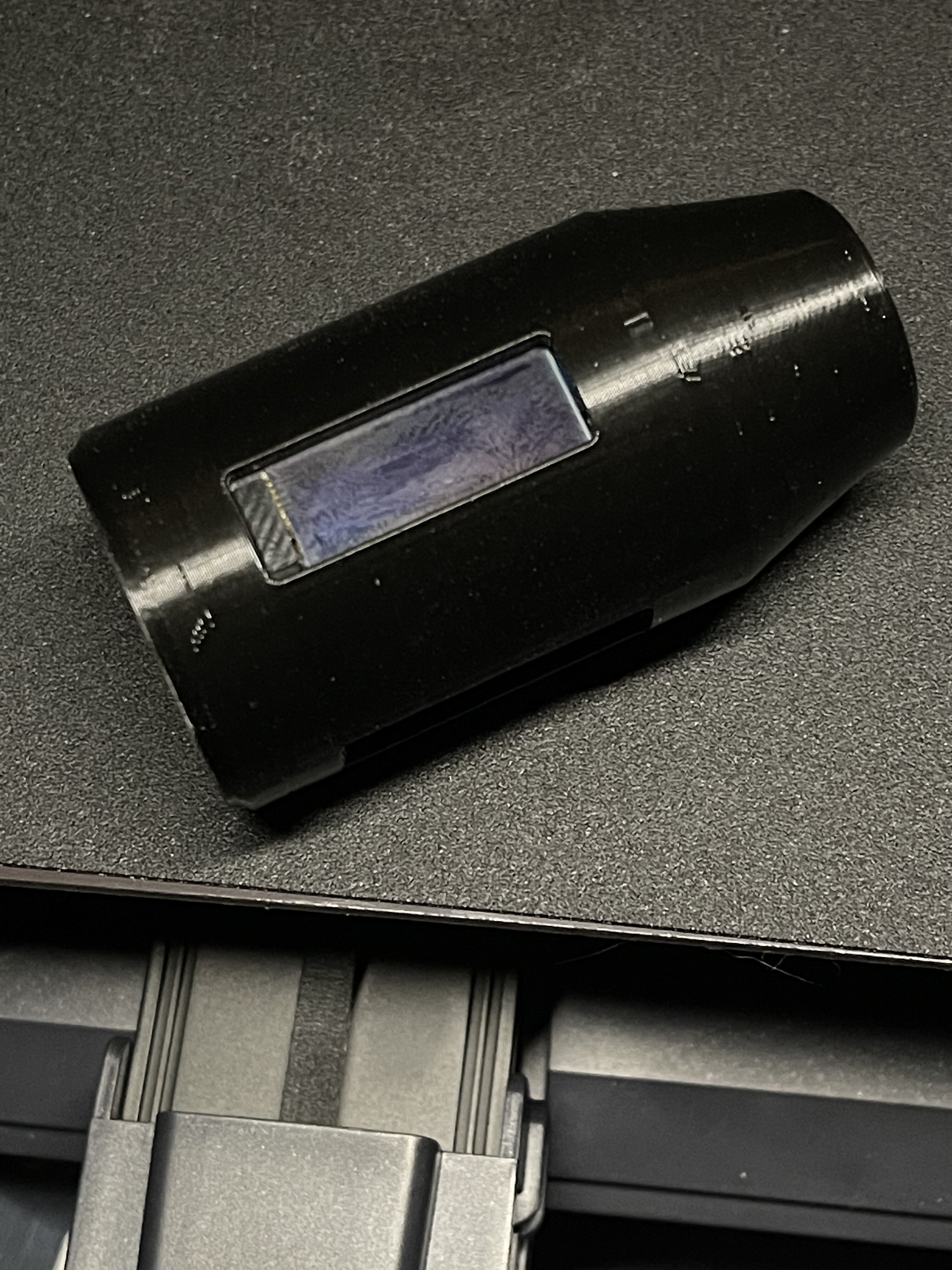

this is a mockup ( ready to print ) to test fit the Oleds and blade.
The Oleds I am using are these
They will run the custom BMP animations for the CFX.
I still may adjust the outer shell as I think its a little too short , however, I wanted to strike a balance between oled screen window size and emitter size. right now I think it looks close to how I would like it to be.
I will keep everyone posted with updates as they come in.. I will also post pictures of my test prints when they are done and the fitment process etc.
