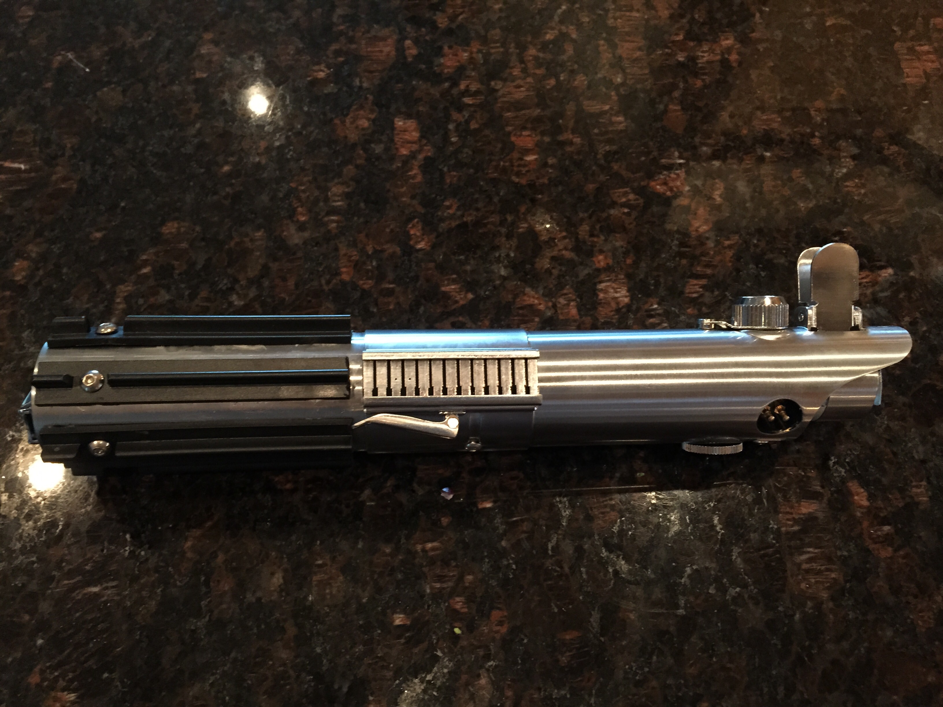

My 1 inch adapter arrived from VV today. Here are some pics with the heatsink and the optional Aux switch...
Chris
