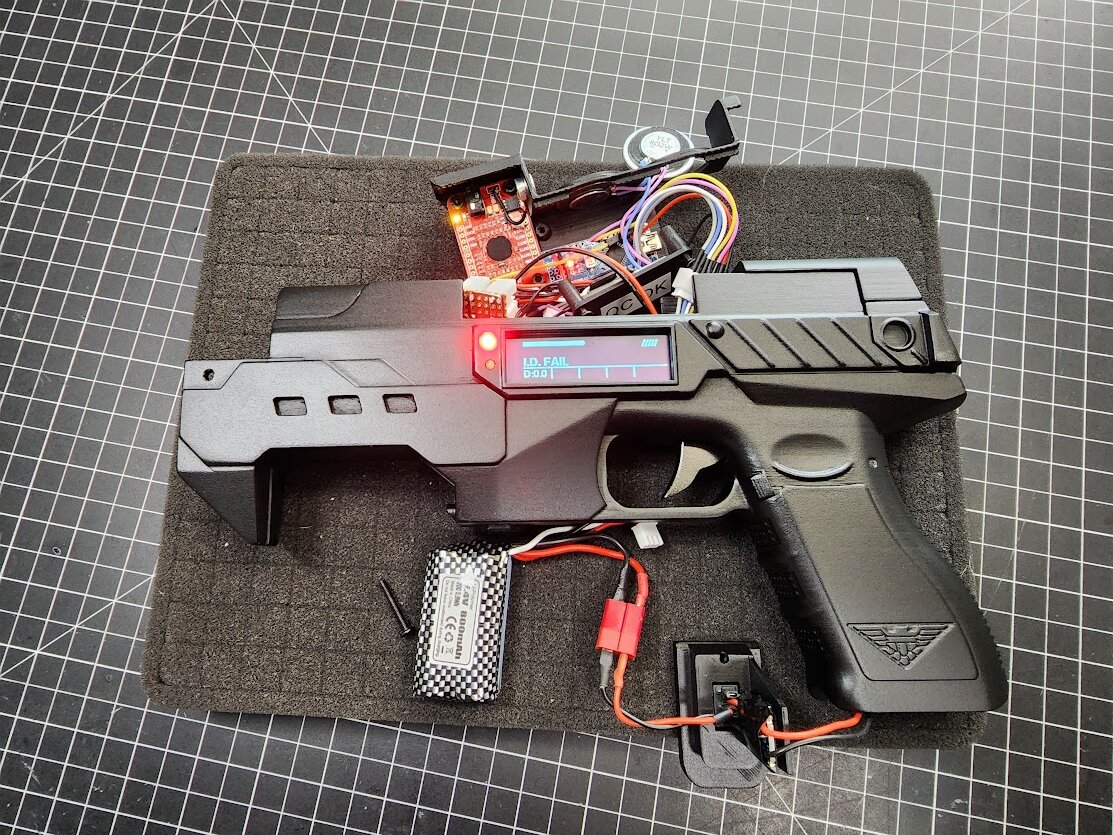

Sorry these pics are just taken with my phone under studio lights, meant to take nice ones but it's been a crunch time weekend and I want to get this posted before it's too late. Note that I'm doing a lot of parallel operations then when it gets to the finishing stage I'm doing them 1 by 1.

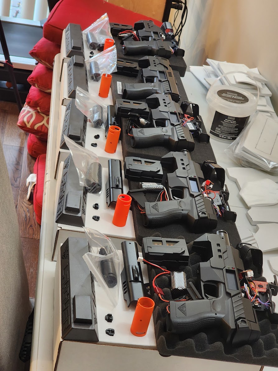

Here's a full state of the union on each of the remaining Lawgivers for my part of the run.
enterprise0216 :
Yours is ready to go*!
* I did remember that you wanted the stand coppered and weathered, doing that either tonight or tomorrow AM
(serial blurred because it's custom)
rolandblais :
I'm just doing the final electronics installation, it's all ready to go after that pending inspection
asavage :
Yours is almost ready to go but still needs the top coats on the frame, everything's 100% except for that
The next two are coming along behind these, the electronics are done and they're on their second primer/finish pass:
The last one on my list is the Toy Traders one which will be after all these have shipped and will be filmed for the 'how to' videos.

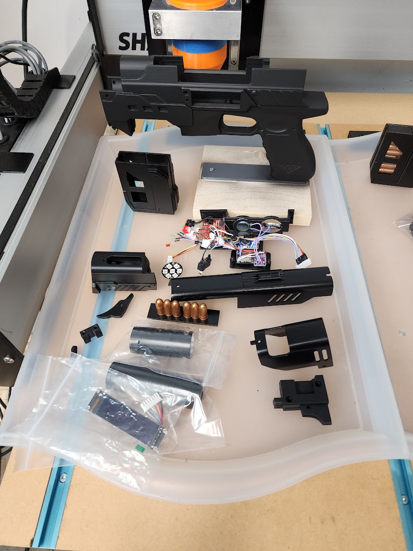

Here's the last part of asavage 's lawgiver, it was suffering from the same issue of not being smooth enough after airbrush primer, fortunately the weather FINALLY let up so I was able to prime and sand it today, this pic is taken about 30 sec before I ran up to do this post so it's still wet:
And finally here's the last parts of the last two of my part of the run, well on their way to final completion:

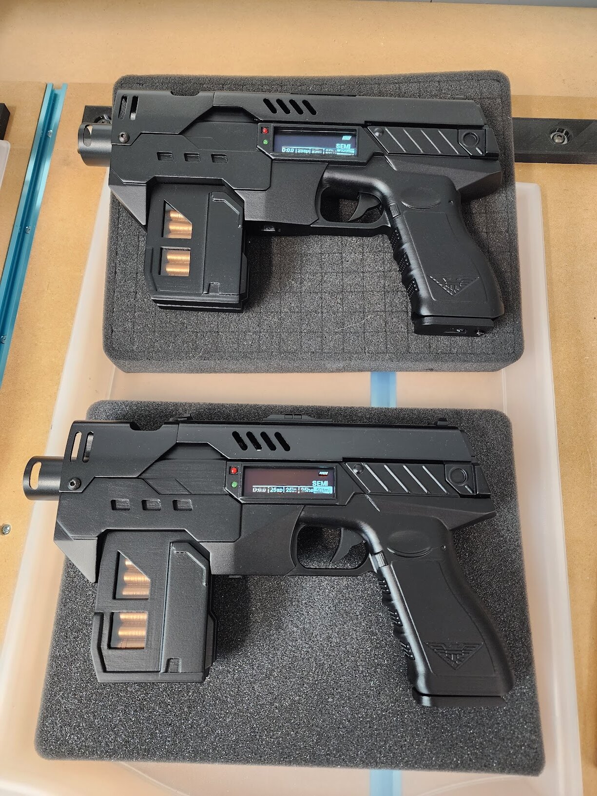

The sins of the past have been washed away, here's enterprise0216 and asavage 's all refinished with the new airbrush topcoat along with the refinished stands for the rest of the run and what I'll call 'the next one', Spidey74 (Craig) and I need to co-ordinate about the delivery on the rest, we're both very close and need to figure out who has to do what custom serials and brass plates later today.
rolandblais 's is all assembled and ready to go when the stand is, I just need to do the color on the logo and the paint washes for weathering, going to do the same look for all remaining stands.

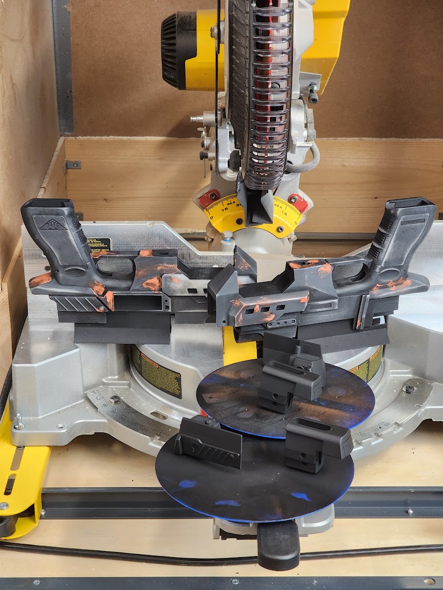

Dec 13 - Lawgivers
- Stripped down 4 full sets of matching flat parts (everything but the cowl) and repainted, this is so I can do a full set in the new airbush primer to match the redo on the frames. This was a huge amount of work so it's most of the update
- Used the new Ultra Matte top coat on one frame and one magazine. And quite pissed, turns out my compressor doesn't have enough hamsters in the tank for this honking airbush with the thick top coat, I had to order another compressor with a higher rating. It was working but sputtering so I'm just going to stop since I don't want to risk blotching everything
Dec 14 - Lawgivers
- Ok, got a new ultra beefy compressor, it's a Chinese one worth about 1/4 of my nice Japanese one but it's soo much more powerful, I love it. I top coated all of the matte parts for 4 lawgivers and 2 frames, it worked great this time. I really need to test and see if it needs 1 or two heavy coats. I'm hoping 1 because this stuff isn't joking when it says 'ultra matte', 1 coat looks great and I worry about dulling it too much doing a second. Now we play the 'how long until it cures' game where it's really easy to scratch and I'm itching to put them together.
- Top coated all stands for the run

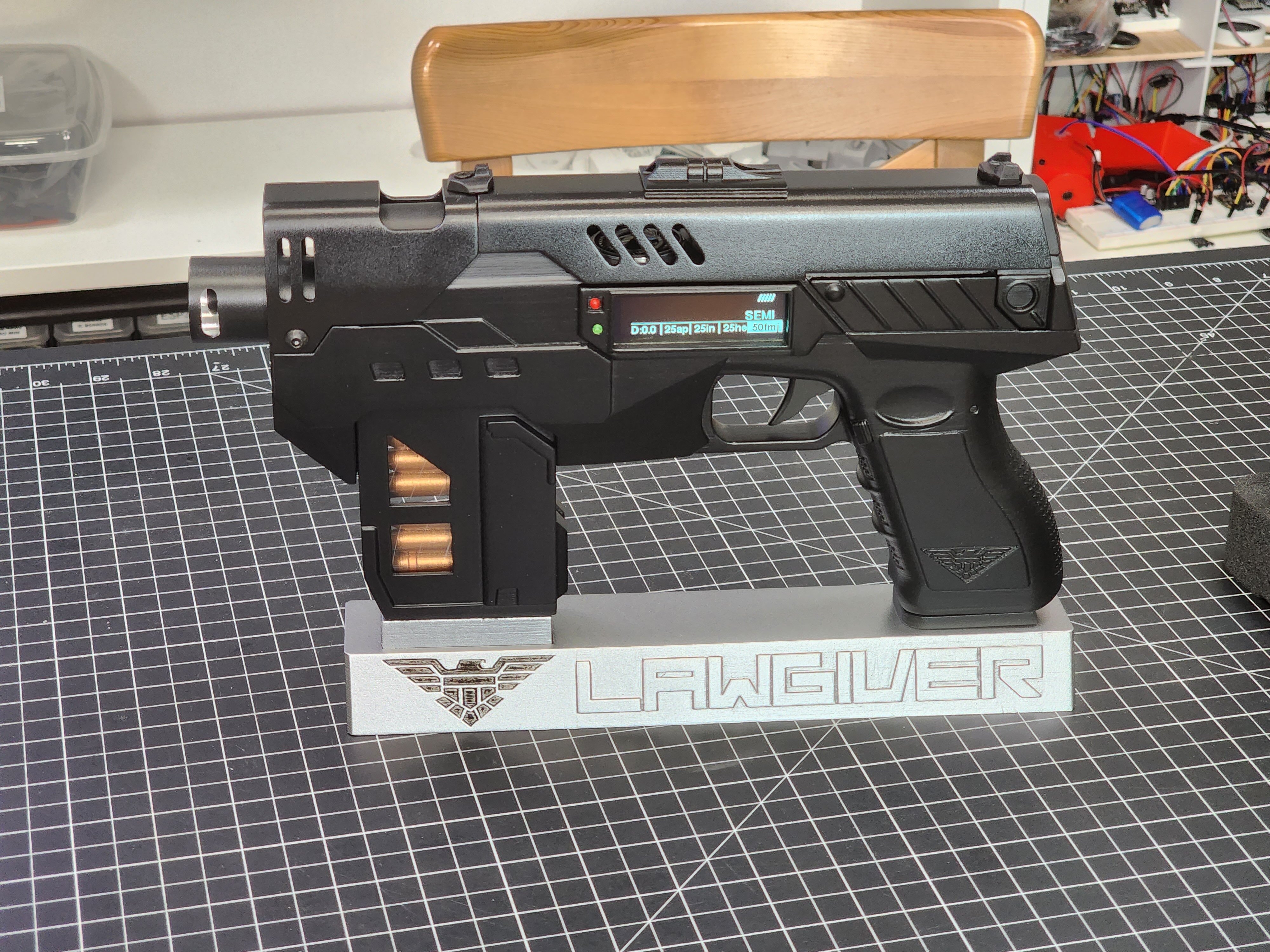

All working! Not quite ready to ship, got some more individual testing to do, my day's goal was to get the electronics installed and working in four of them. Now I've hit that I gotta call it for the night.
Props3D
What a friggin marathon. I had a promise to myself to get these done by the end of the year, and somehow that's... now?
Of course last minute hell broke loose as the latest code update from Spidey74 caused an absolutely nonsense issue that should never happen, that he would have no way of finding and still makes no sense to me. Then the guy and his family get sick over the holidays and can't look at it just he's bedridden, the nerve! (he's better now, I wouldn't jest if he was still in that shape)
How's this for a head scratcher: So if you test the Lawgiver over USB (how you would do it if you're working on the code) it's 100% perfect. If you test it on the Arduino 328p with the V1 bootloader, all perfect. But I have the newest bootloader 328p's and when you boot it up on battery the 'fail' sound when you don't press the trigger doesn't play, and when you do hold the trigger the startup sound plays but the progress bar sound doesn't. It works on USB, it works with the other bootloader on battery, WHY!?!?!?!
So rather than solve it I've been waiting for nature to take it's course with Spidey74 and crew and just keep powering through the run, so when he's ready I'm ready. But D day is here and on time:
So rather than miss this arbitrary due date I'm been trying very carefully to not throw this ready to ship lawgiver across the room while I figure out WTF is going on:
And figure it out I have! I do know my way around Arduino code pretty well but you really have to take a look at what Craig's done on Github, he's some next level savant at these things. I spent the first 30 minutes just figuring how how all the dots connected together to make it do anything. The problem was the MP3 player needed to be 'prepped' for some reason, so if I just fired a little silent blip at it during the boot phase it sorts itself out.
So throughout the day I'll be updating the code, testing and boxing these one by one. When I'm confident of their integrity I'll be messaging each person in turn with pics and a video. These are not in run sequential order exactly, Spidey74 would have had 2 done well before now if his family wasn't struck down by pestilence, but I talked to him today and he's targeting to have the gap ones done in less than a week, he was just about there when his misfortune happened.

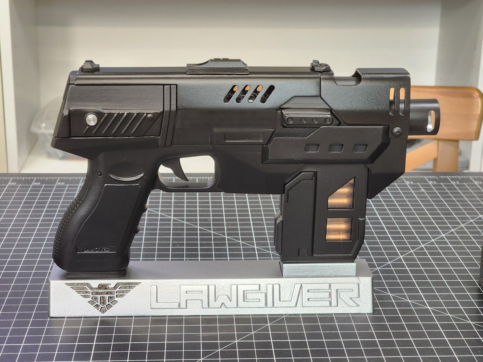

And my last thread spam for the day:
My part of the run is all done! Going to celebrate by taking the kids for a make-up-milkshake at Rocco's (the diner from Riverdale) and hope the sugar rides us through to ring in the new year. Will do the vids tomorrow but they're all tested and approved :)
