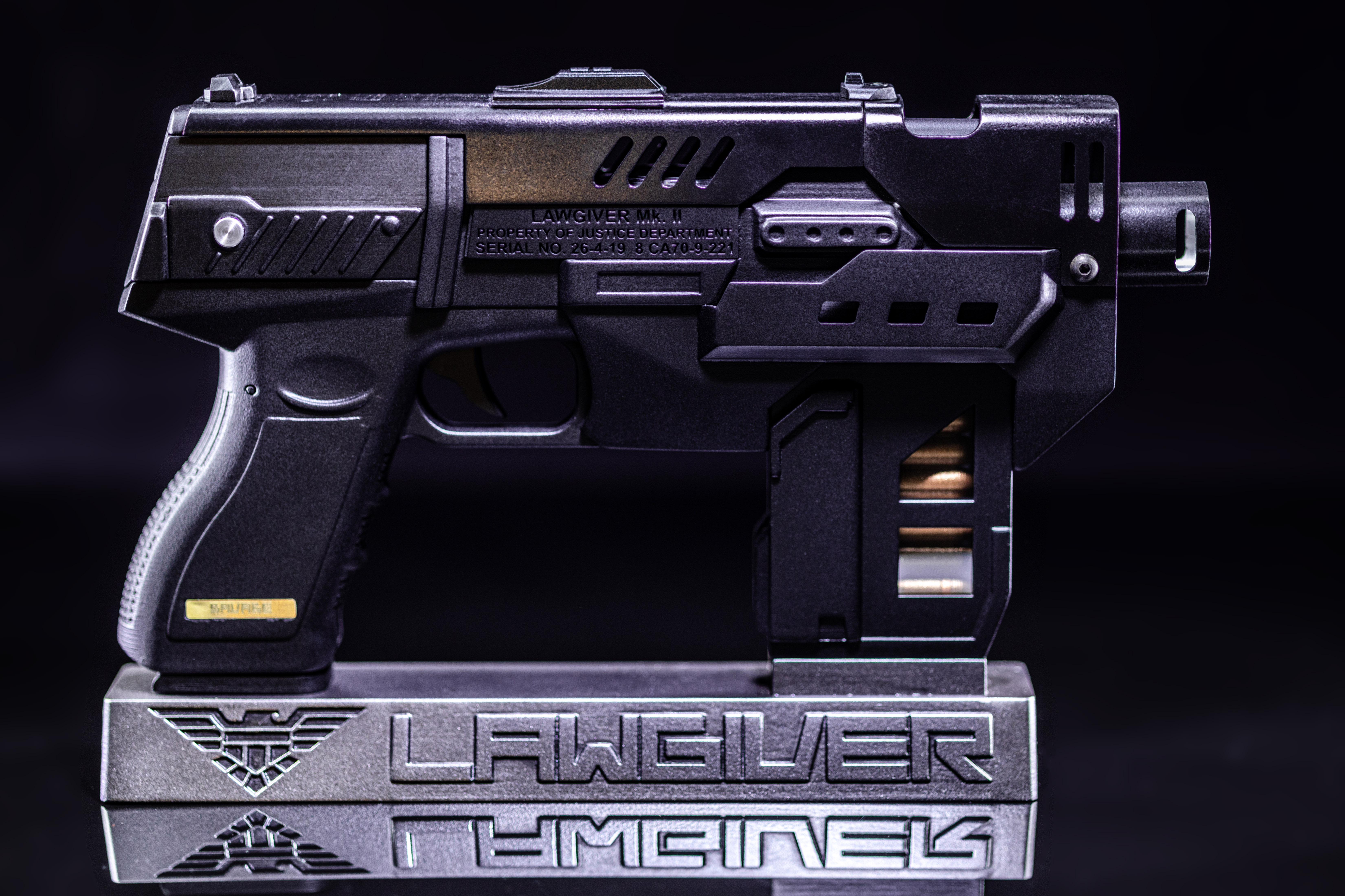

Dredd Lawgiver 2012 Full Electronics and Action
NOTE: this video and pic were made with an early release model and only quickly sanded and finished to get it ready for a demo to list the run. No metal parts, no brass plate, no rear glow sight etc. The ones made for you will have a lot more care and polish. I’ll replace this pic as I get another one finished.

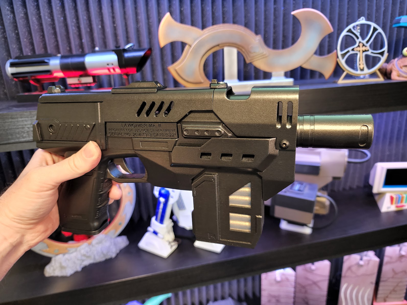

I'll be posting more of the progression of the run here, with updates on just the main model progression there, since this is both here's a pic of today's big step, the concept suppressor:
Still going with the quick paint, I took this pic like 10min after painting so my one hand is a nice sparkly metallic and I have to sand this down tomorrow, but really wanted to get a sense of how it looks before printing a whole whack of them. Gets an approval on my end, if you have any thoughts on improvements let me know :)
