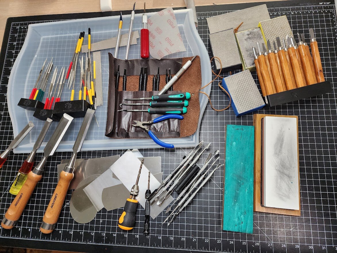

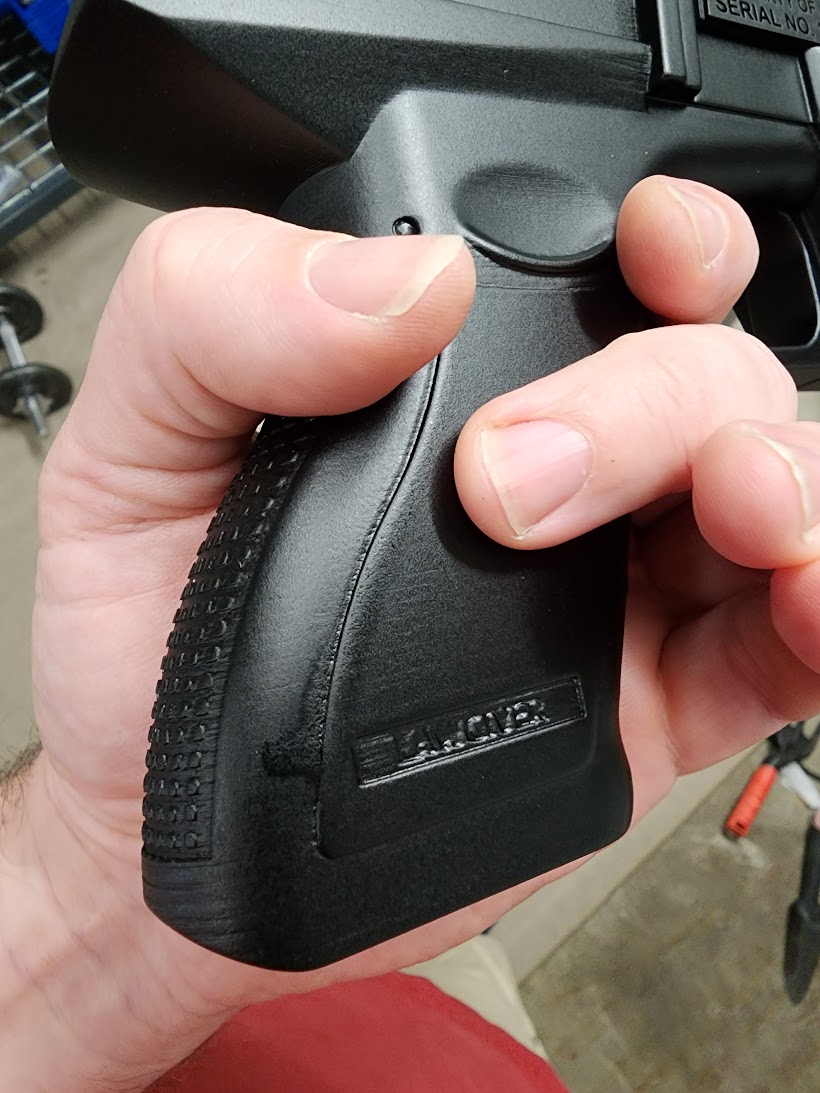

JDiamond I do a lot of woodworking too. Here's one of my pieces done in oak attached to a thing I've cropped in quite closely for some reason:
I have some scrapers and gave it a go after seeing a video on it, but it's no where near as good as the interwebs would have you believe, or at least hasn't been for me. Here's some of my sanding/finishing tools, or at least those that were in easy grabbing distance, each has their use.
Everything is wet sanded on trays like the one in the pic, I don't use power sanders because they're too aggressive and I don't want dust in the air with kids in the house.
I would take the diamond blocks and diamond files over scrapers any day, they give you a ton of control and do a great job. Though the scrapers are useful for large angled surfaces. There's a lot of nooks and crannies and that requires small tools. My favorite tool by far is the Korean signature stamp making kit, you can use those like scrapers and chisels to get layer lines and imperfections right out of the teeniest places. I use the 6000 grit stone with the strop after to keep them at a razer edge.
Normally I wouldn't finish these nearly to this level, which has also added a lot of scope, but it's sort of become a challenge project as much as my first RPF run. It's always hard to know where 'good enough' is, especially when you're doing a first time thing on a place with a lot of big names like the RPF.

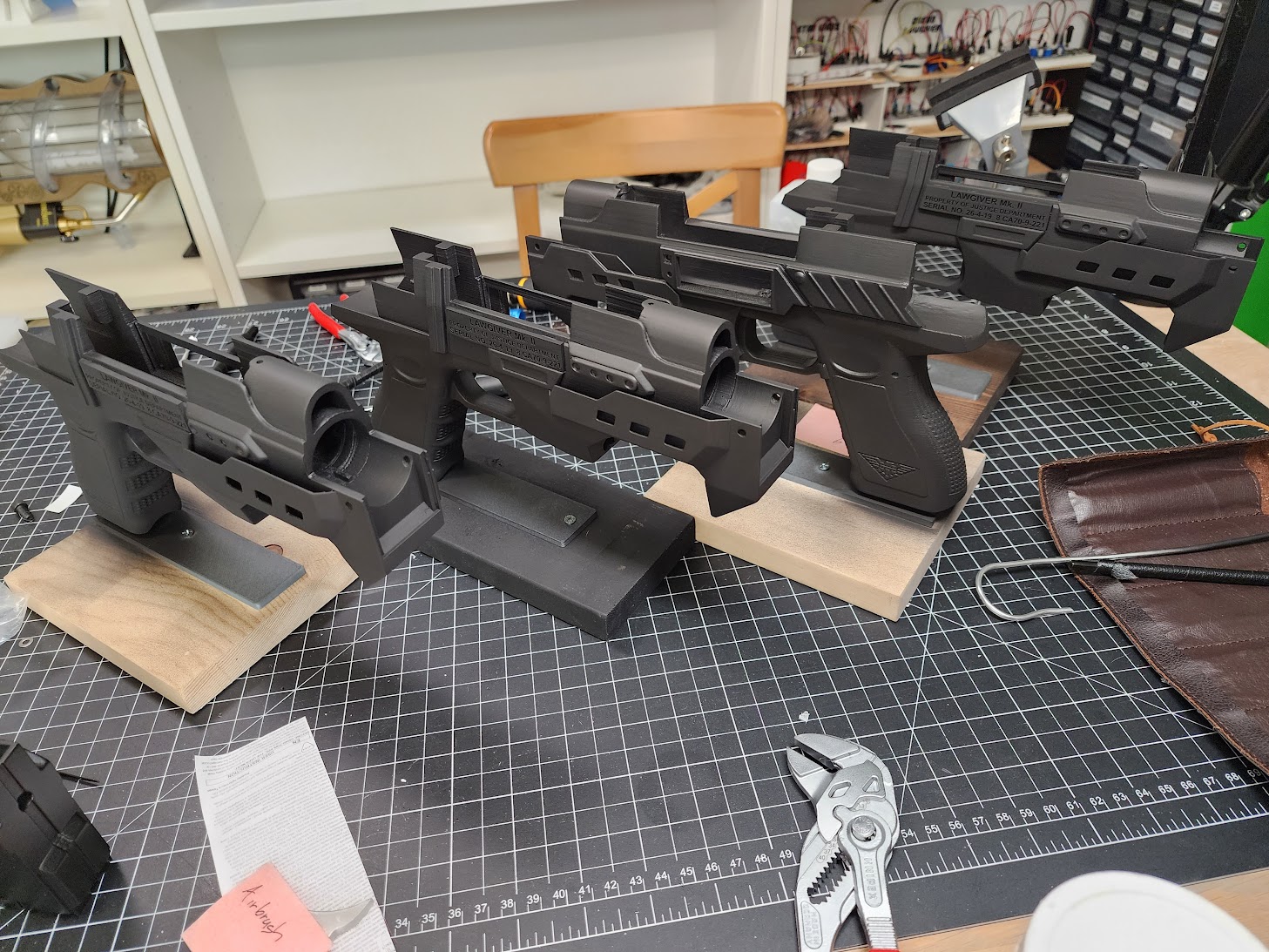

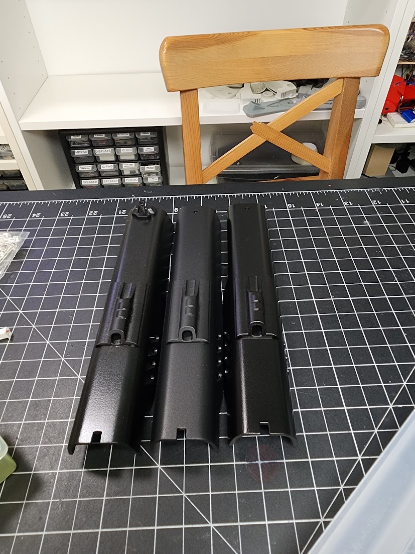

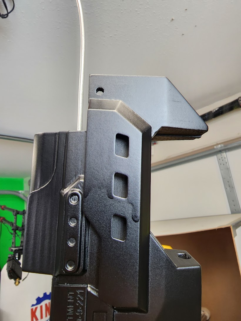

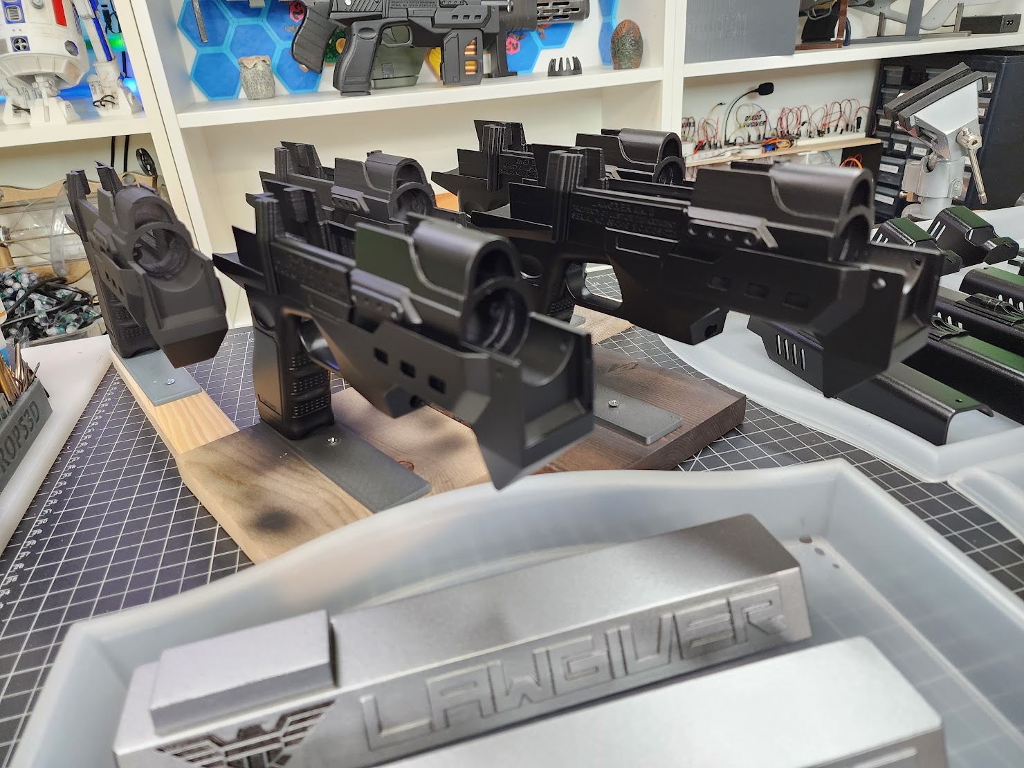

First, a fun one: I painted up the next 4 stands but one SMALL thing that’s bothering me is that they’re too clean. So I did 3 versions here: left and middle have a copper wash, left has subtle oil grime.
Close up of the grimed one, I kept it VERY subtle, mostly makes the reflections sell. The paint on the eagle is still wet if you’re wondering why it looks like that, just ignore it.
If you want either of the weathering options on the stand just DM me, super easy and happy to do it. You can also weather yourself, they have a nice thick coat of poly to protect them regardless so you can paint right on top of it, I'll include a weathering tutorial after the build video for the whole Lawgiver if you want to go that route. I think I'm up to like... 6 vids now on this? I'm certainly not going to get bored this winter!

So I had to smooth out EVERY frame again and repaint, which I just finished a few minutes ago:
On the plus side they look even better for one more entire pass. So I'm going to leave these overnight and top coat tomorrow, it's supposed to be 11c, which is a perfect temp.

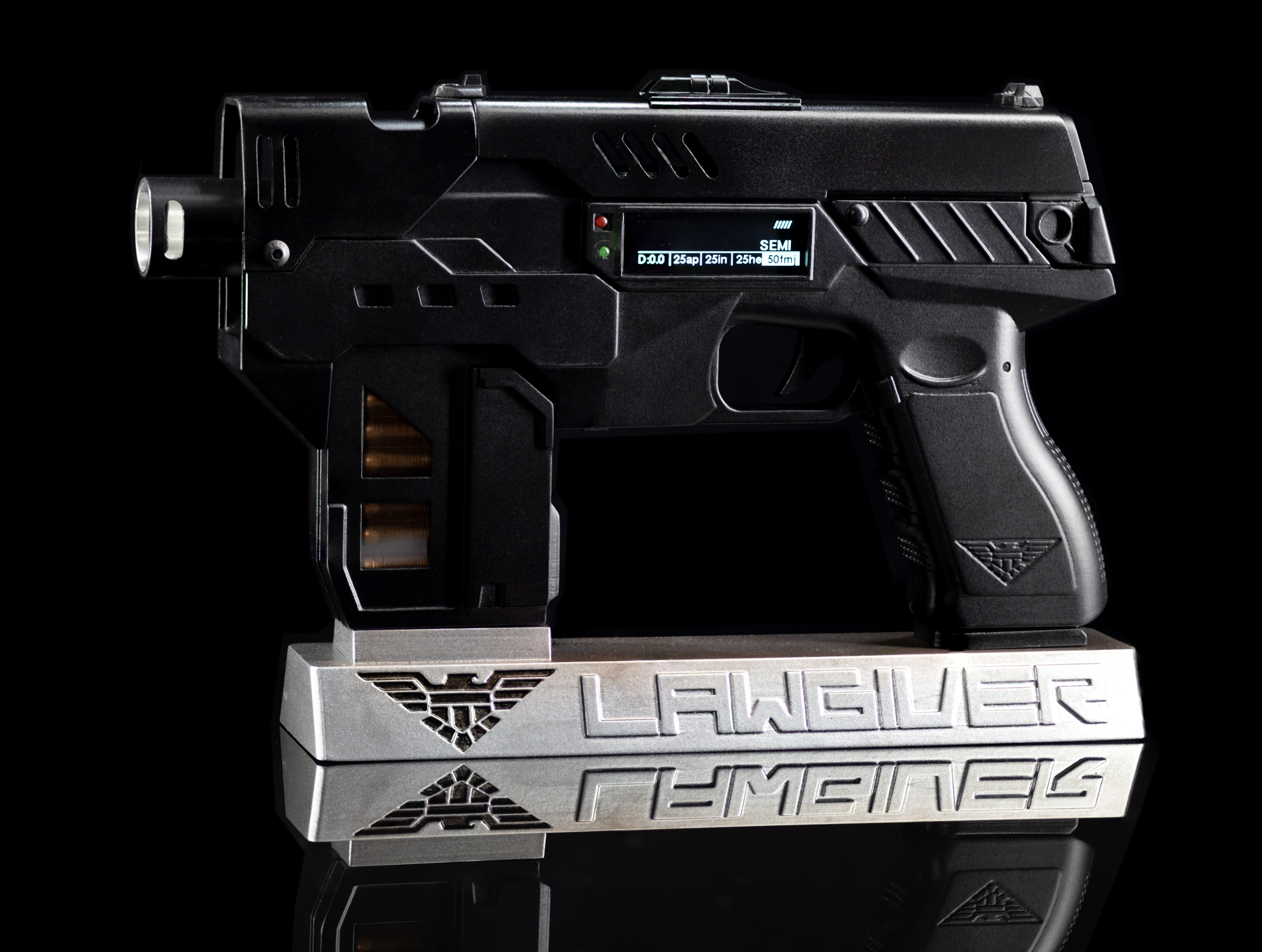

jds12 Just have to put the cowl on! This a test of the new code build from this morning and a final test before finishing the assembly.
Bigger update coming tomorrow, along with some completed pics in the new photo booth of the one above. I really wanted to get it done and do the update today but it's late on Sunday and I just wanted to show quickly how things are rolling, proper update coming tomorrow.

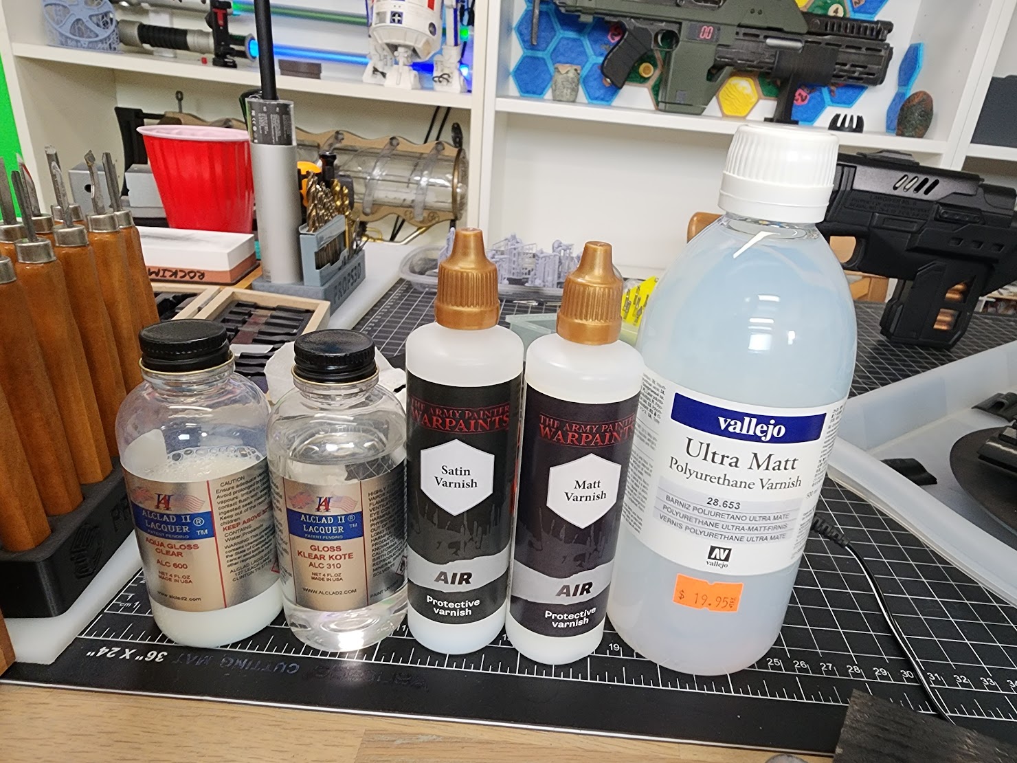

On the left is the top coat I was using for the ones already shipped, it's not liking the cold so instead of the smooth even coat I was getting before it's all kinda mottled. To a certain extent this looks cool but it's not on point. So after research I ordered the best airbrush topcoat to match the look (in the middle) but for some reason it knocked down the back enough that it didn't 'pop' anymore from the frame. I really thought it would be on the money and It's certainly a really nice top coat, but no.
So I got yet another topcoat (brands coming with the big post) and it was perfect, that's the one on the right. Unfortunately I did all the tops with the left top coat with that mottled look so I had to sand them all down and repaint. It's a time consuming process, you would think I could just paint over but a lot of paints don't stick well to top coats and the mottle pattern may show though. So I had to take them all right back down to bare and reprime, 3 paint passes, and then top coat. I'm at paint pass two and I'm realizing there's no way I'm going to have them done tonight if I'm doing this properly, so I'll just post this short update to let you know I'm still beavering away (Canadian expression?).

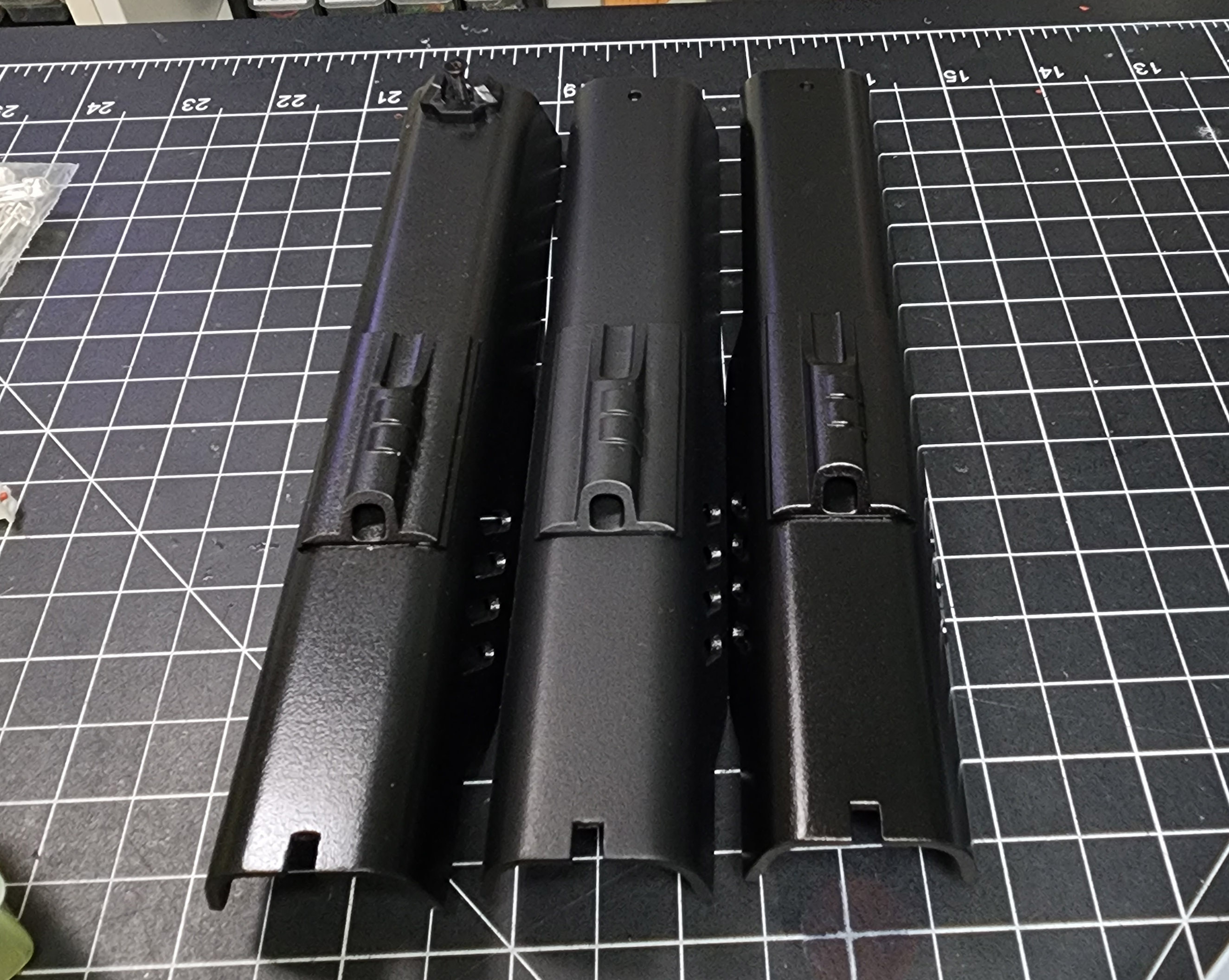

Half the run got messed up because the new kind of flat top coat I used worked great when it was warm, but since it's 2022 it went from 40c to freezing and 100% humidity ALL the time, wth nature?? This weather is fine for a lot of my other top coats, but totally messes this stuff up (of course). So I sanded everything down and did it all again when the weather finally gave me a bit of a break, but it was an all day thing and when it cooled down in the evening it messed up some of them again, so 2 were good and 2 are not, so I had to redo them yet again.
I also did all the satin top coats and had a similar issue, so I realized this wasn't sustainable and I need to do a huge shop upgrade so I can switch my entire workflow to airbrush.

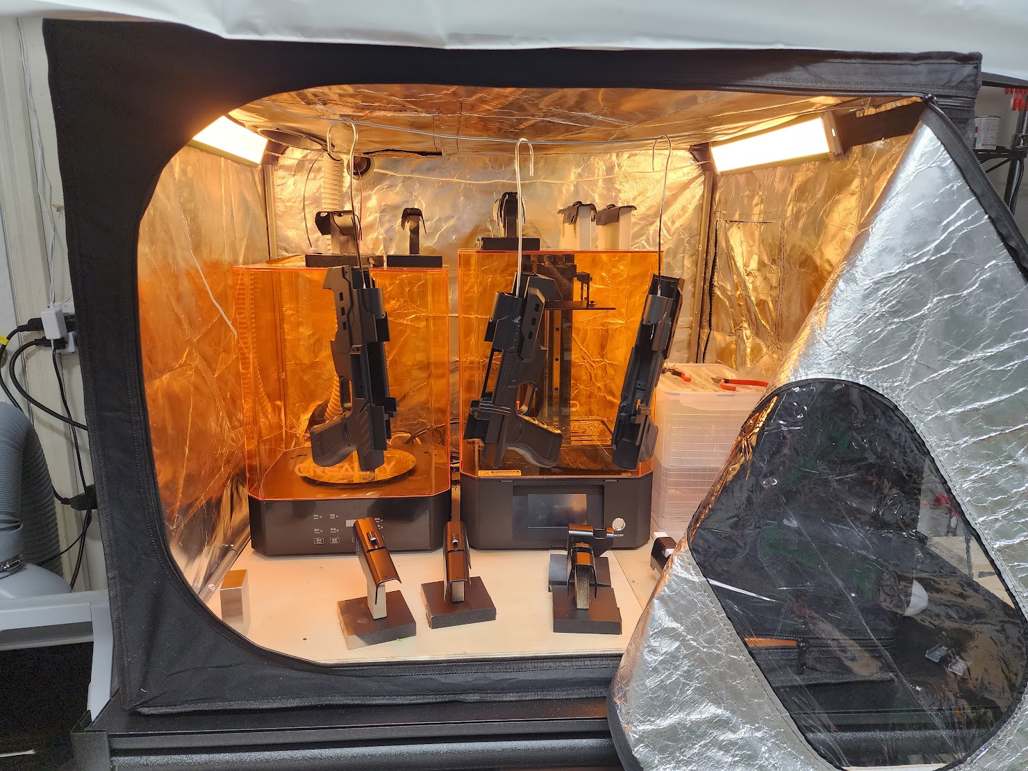

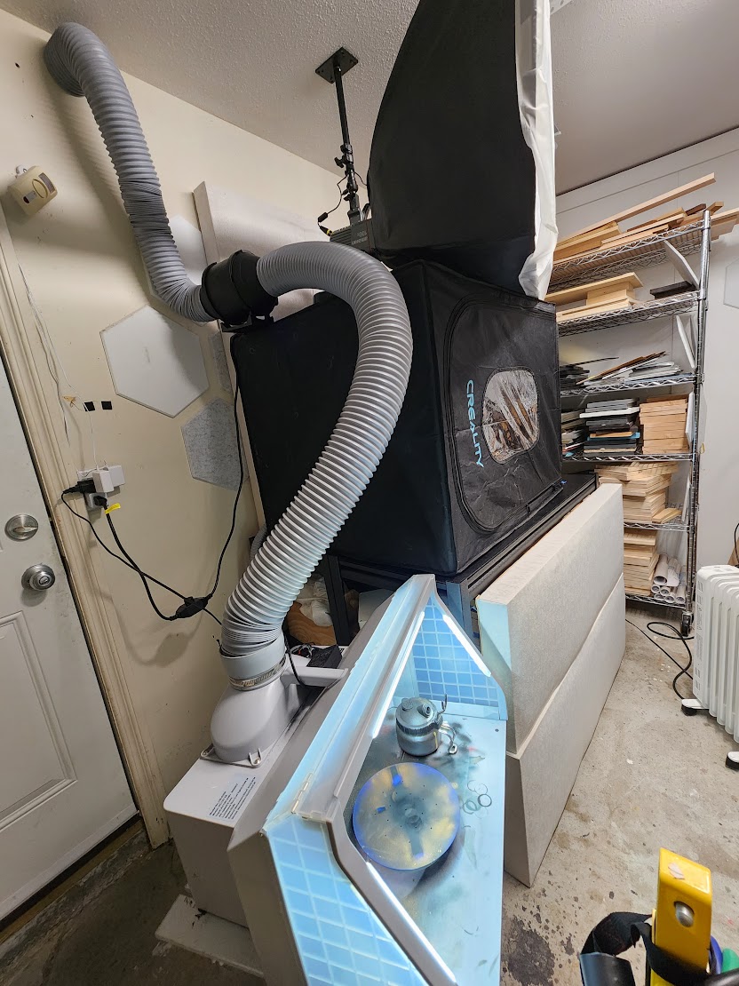

First thing to do was make sure my wife wouldn't talk to me for a week:
This is a double win: First off, I can now airbrush inside where it's warm. And my resin printer enclosure can now also use the vent system to act like a mini drying room if I switch the hose over:

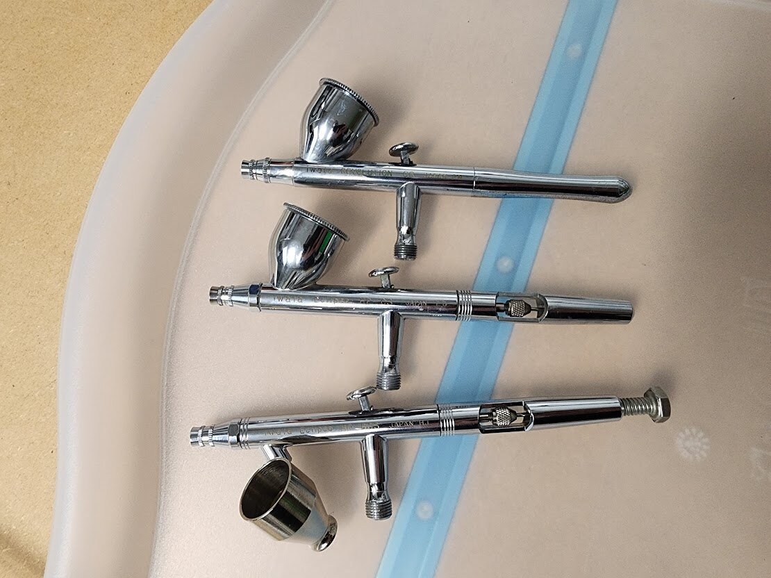

I also bought two higher flow airbrushes to handle thicker primer and top coat (the two on the bottom):
I decided to do the tops first because they're much easier to refinish and they also need to be the smoothest, here's the top coat contenders:
And the result showing the messed up one using my old top coat (left) the second best one (middle) and the absolute perfection that's the best one (right):

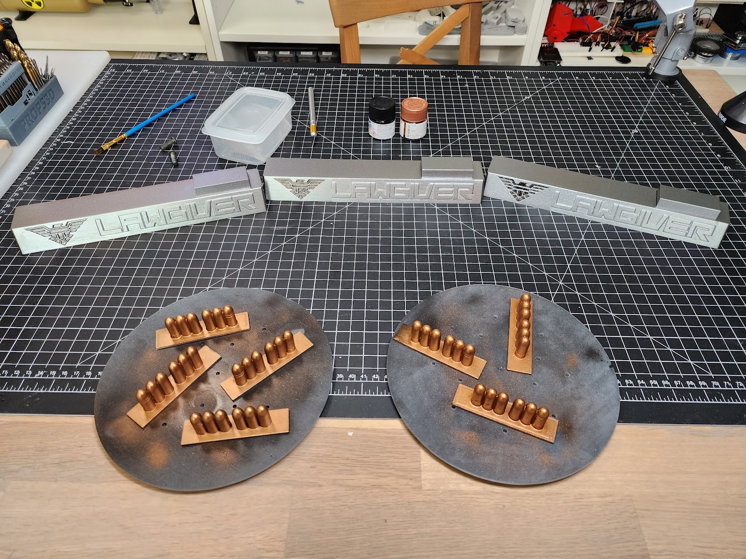

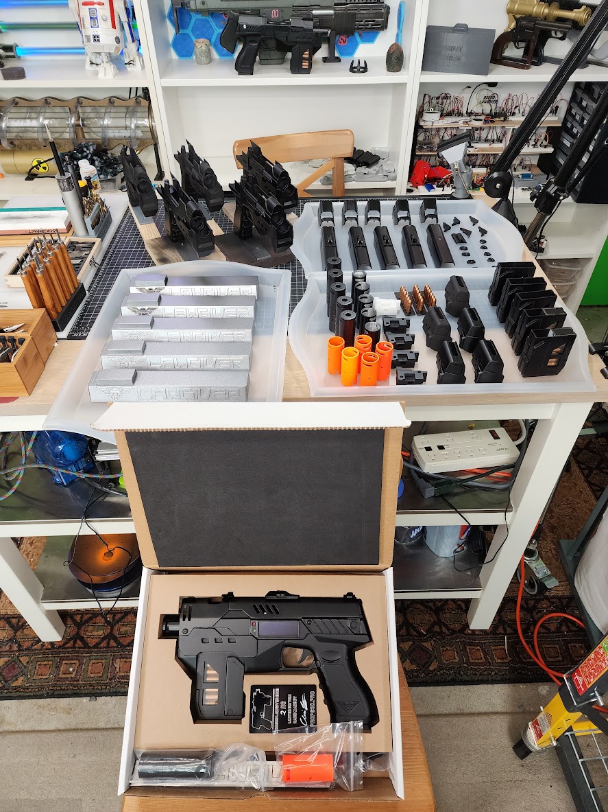

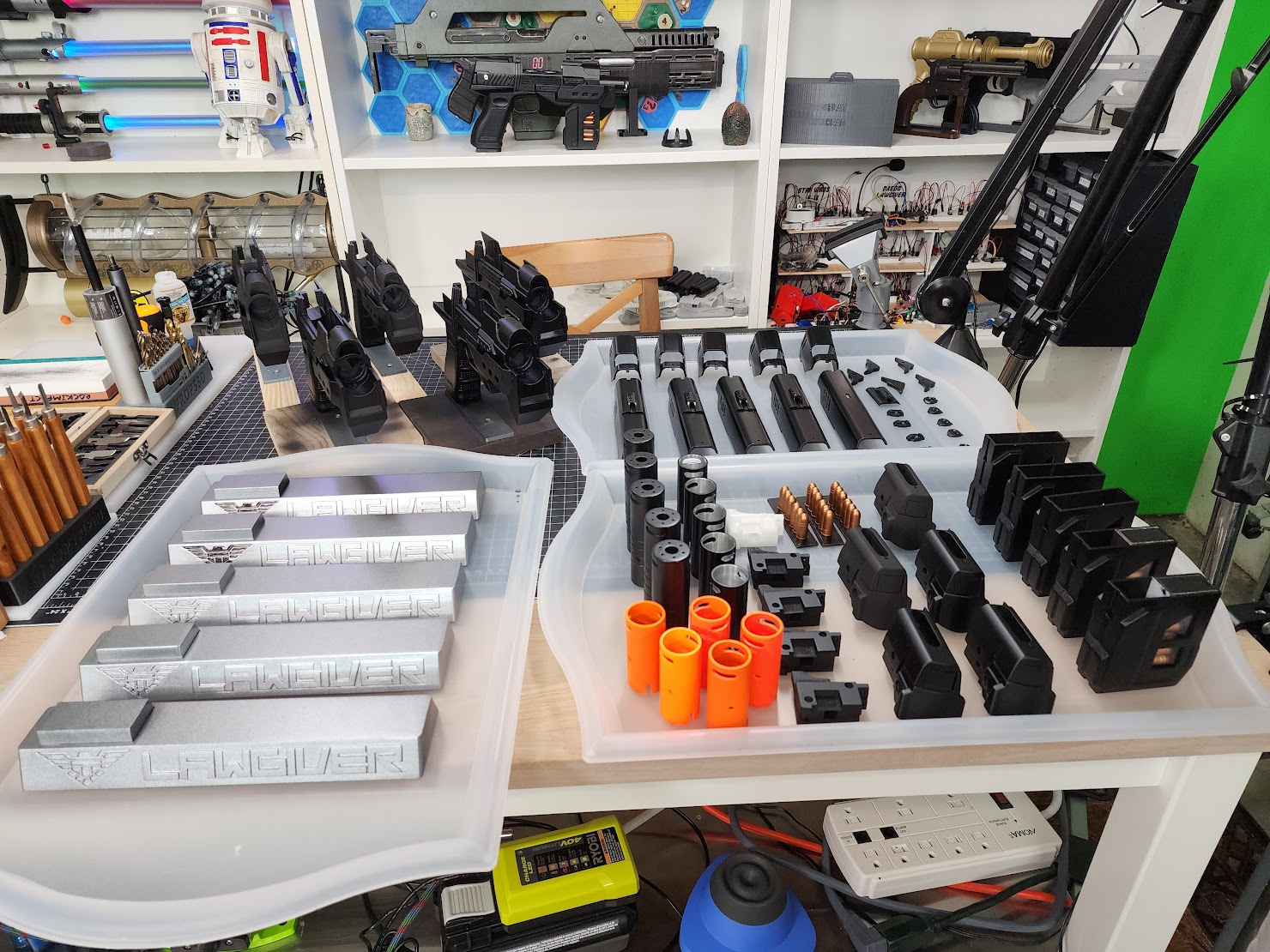

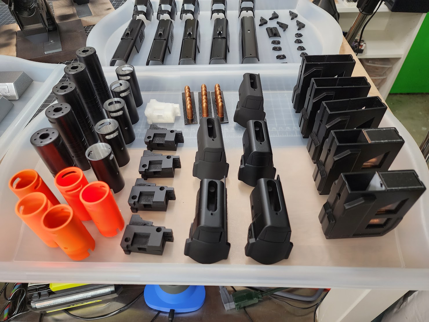

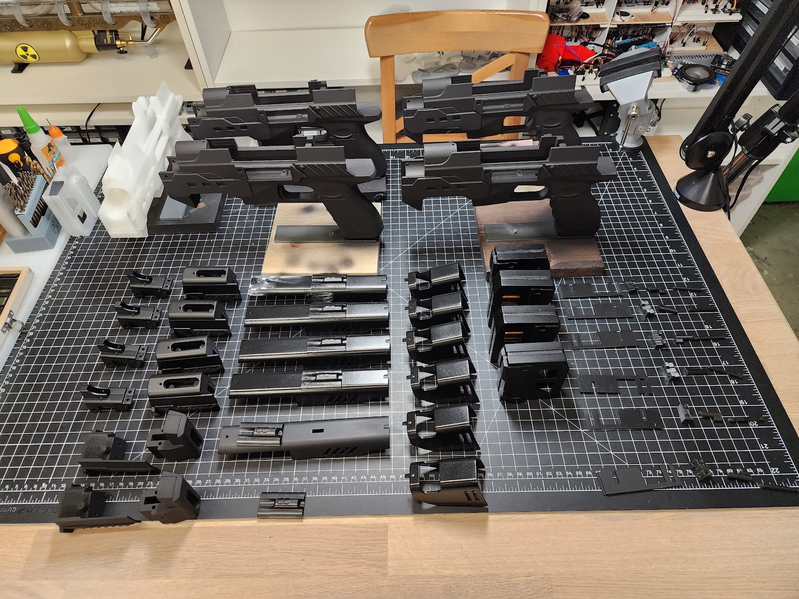

But here's some pics to show you where we are:

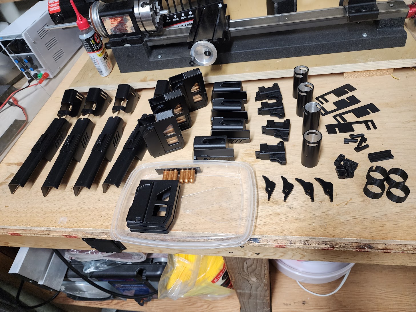

This is all the parts for the last 5 in this pic:

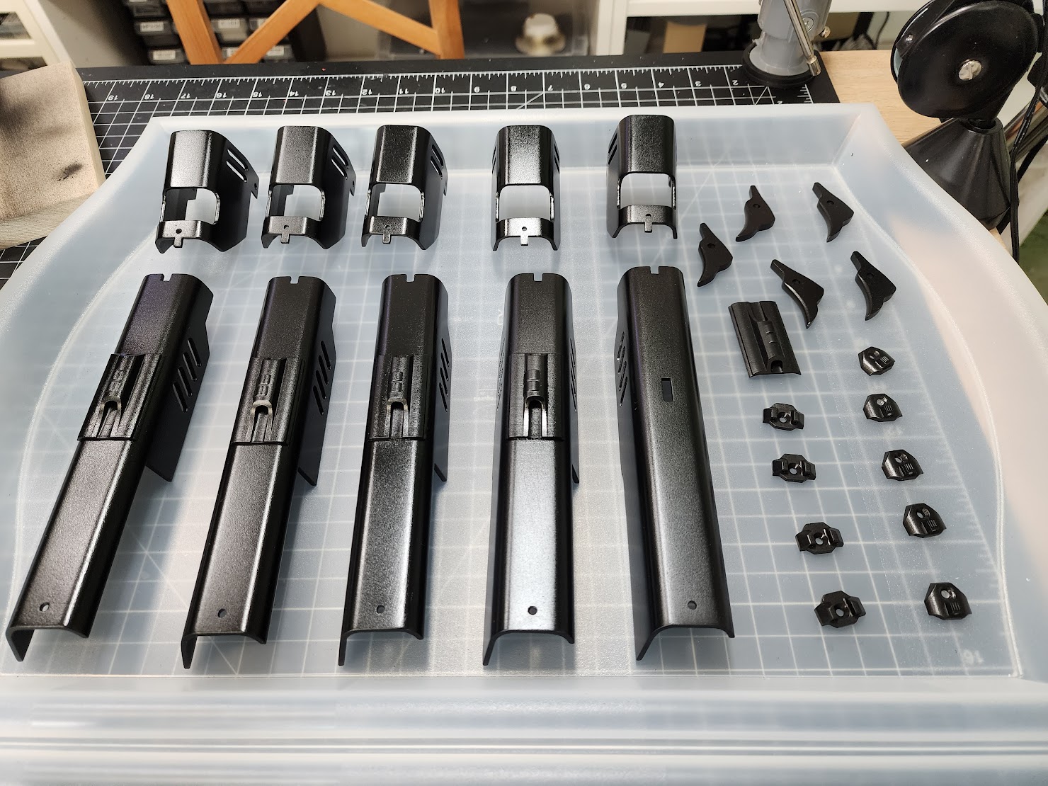

Tops:
All 5 are done and ready to go. Resin sights and metal triggers can be seen here.

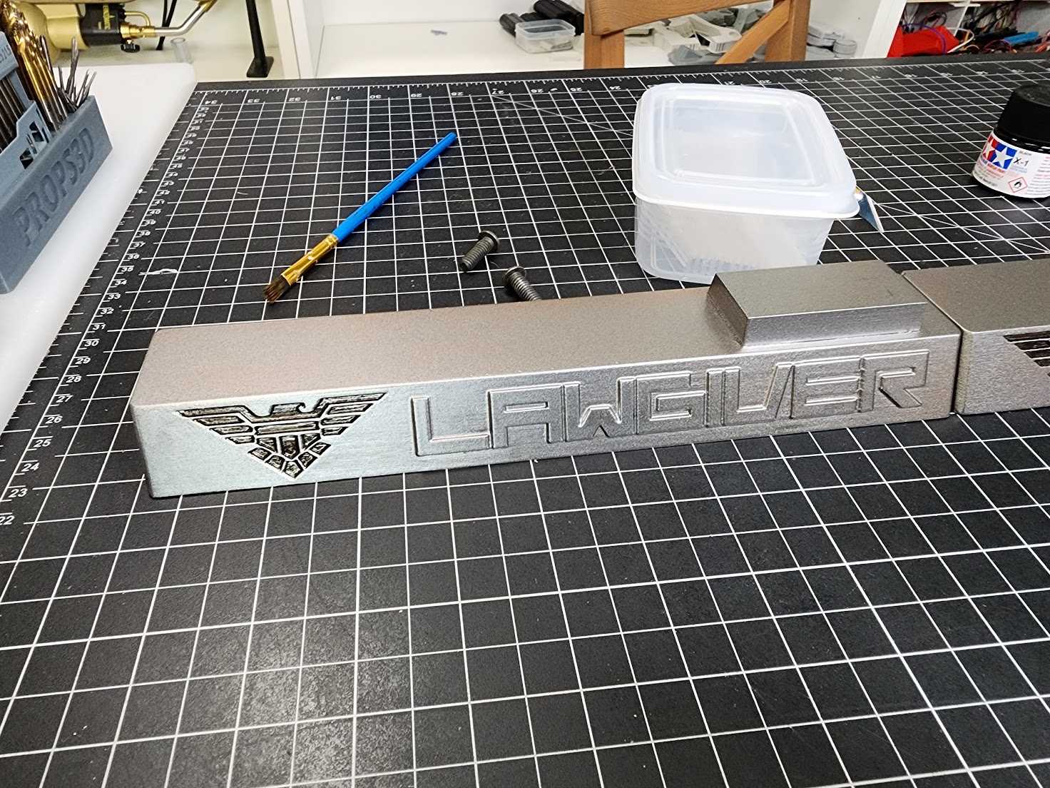

Stands:
2/5 are finished, 2/5 have top coat, 1/5 needs another base coat ant top coat:

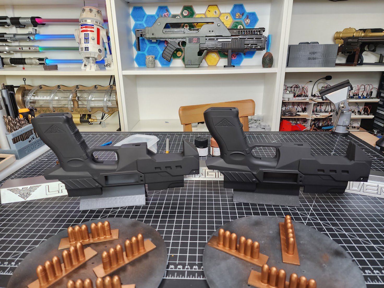

Main parts:
5/5 metal barrels done, 5/5 suppressors done, 5/5 orange tips done, 4/5 trigger groups done, 3/5 cocking mechanisms done, 2/5 cocking mechanisms primed, 2/5 magazines done, 3/5 magazines waiting for assemboly
Frames:
3/5 maybe done (they need close inspection), 2/5 sanded and primed
SOOO CLOSE!!!!
