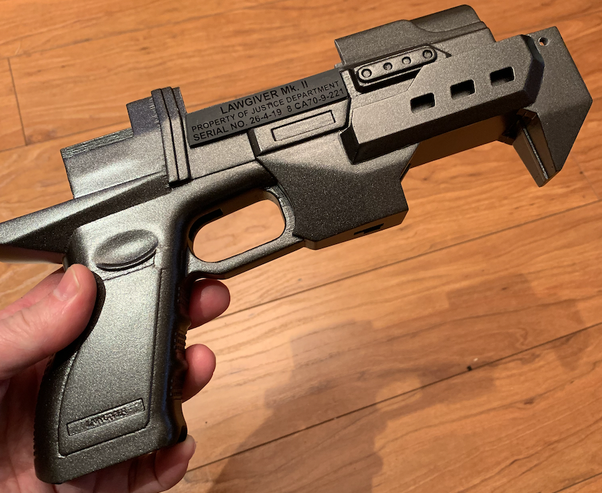

I have not been idle while dealing with the top coat debacle and I've been sanding, priming, and painting the nights away.
So here's the story:

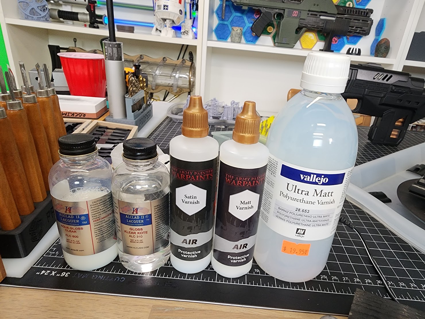

Half the run got messed up because the new kind of flat top coat I used worked great when it was warm, but since it's 2022 it went from 40c to freezing and 100% humidity ALL the time, wth nature?? This weather is fine for a lot of my other top coats, but totally messes this stuff up (of course). So I sanded everything down and did it all again when the weather finally gave me a bit of a break, but it was an all day thing and when it cooled down in the evening it messed up some of them again, so 2 were good and 2 are not, so I had to redo them yet again.
I also did all the satin top coats and had a similar issue, so I realized this wasn't sustainable and I need to do a huge shop upgrade so I can switch my entire workflow to airbrush.

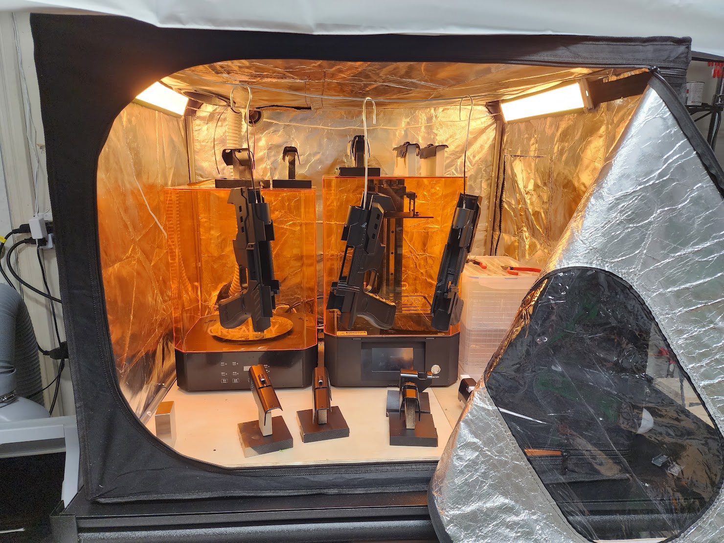

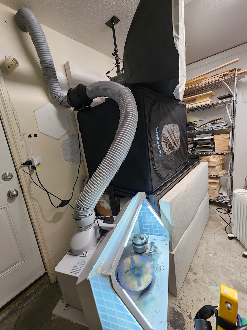

First thing to do was make sure my wife wouldn't talk to me for a week:
View attachment 1642535View attachment 1642536
This is a double win: First off, I can now airbrush inside where it's warm. And my resin printer enclosure can now also use the vent system to act like a mini drying room if I switch the hose over:
View attachment 1642540View attachment 1642539

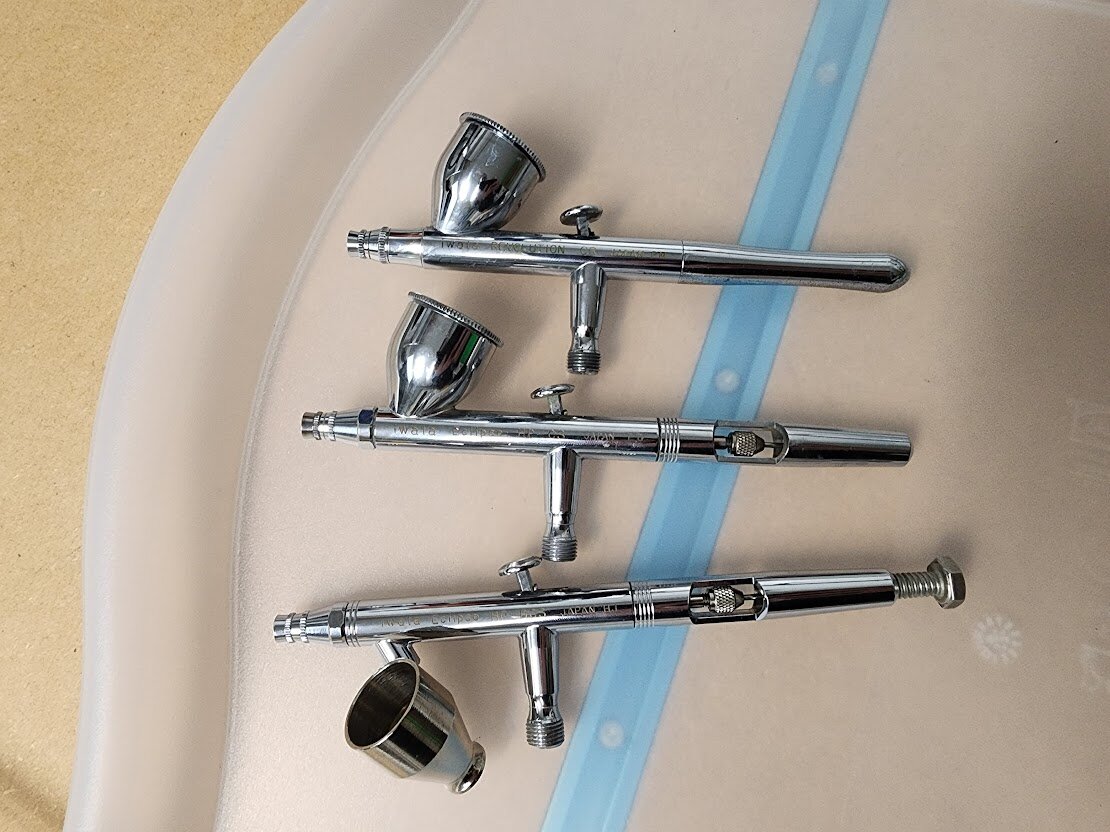

I also bought two higher flow airbrushes to handle thicker primer and top coat (the two on the bottom):
I decided to do the tops first because they're much easier to refinish and they also need to be the smoothest, here's the top coat contenders:
And the result showing the messed up one using my old top coat (left) the second best one (middle) and the absolute perfection that's the best one (right):

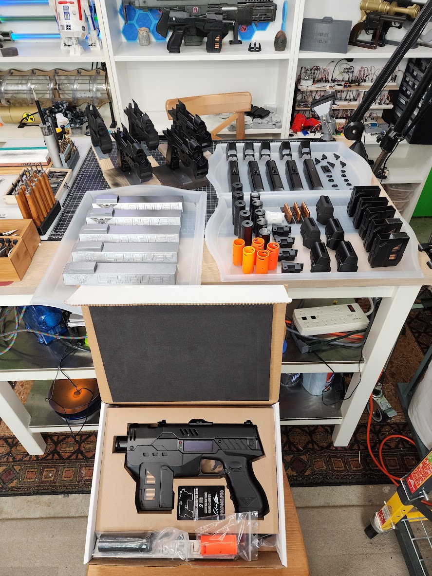

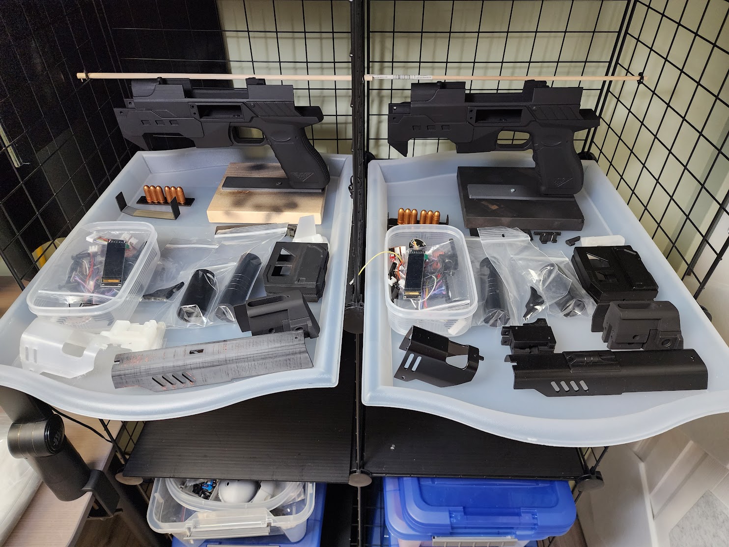

But here's some pics to show you where we are:

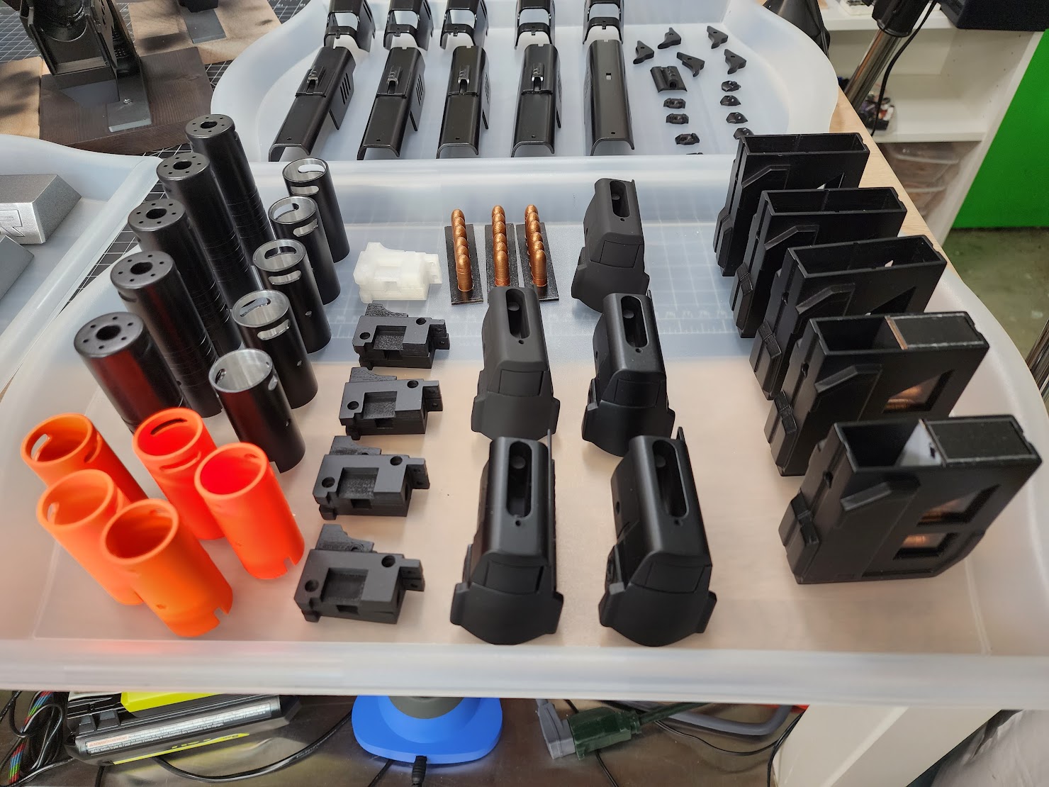

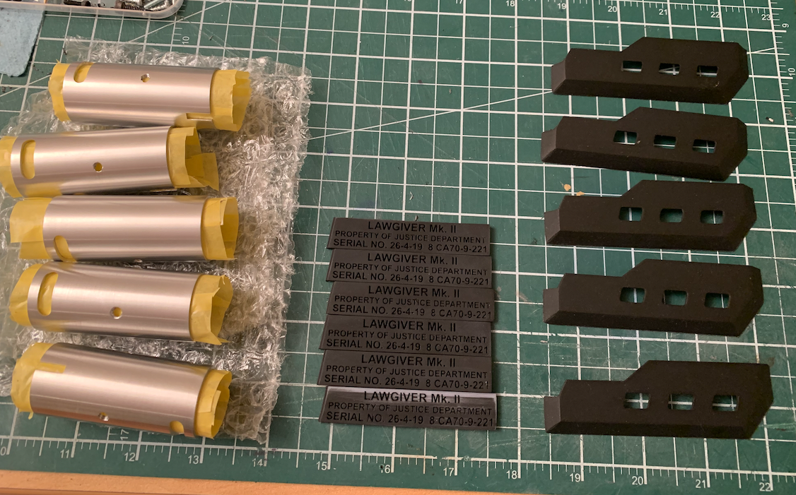

This is all the parts for the last 5 in this pic:

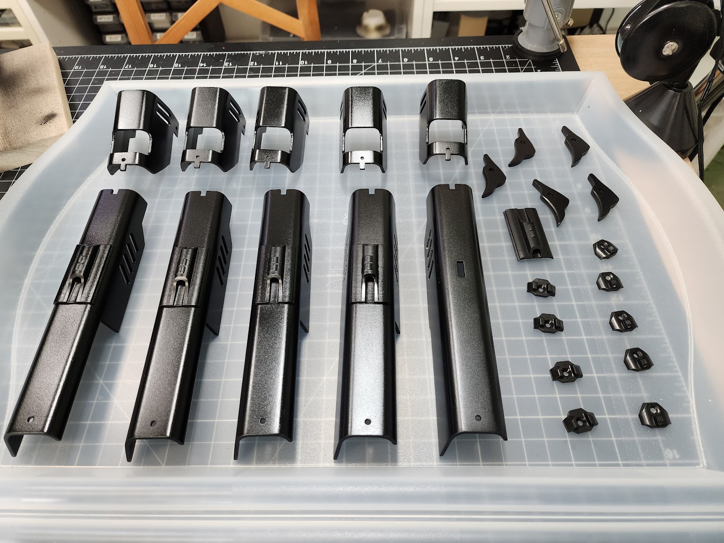

Tops:
All 5 are done and ready to go. Resin sights and metal triggers can be seen here.

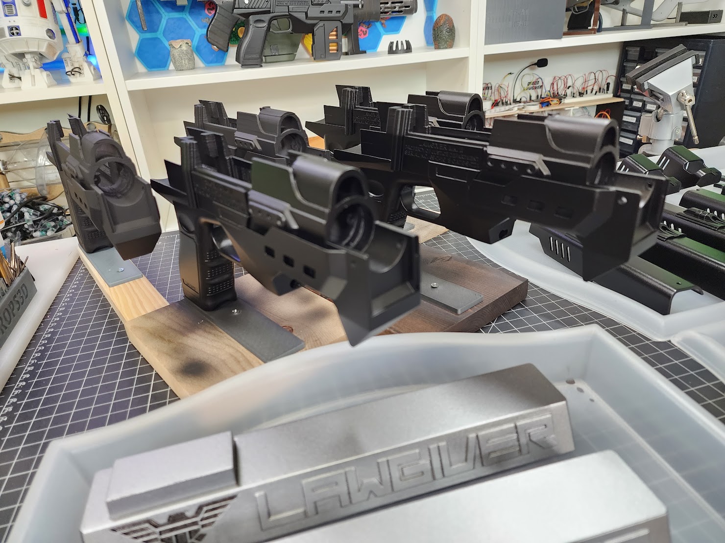

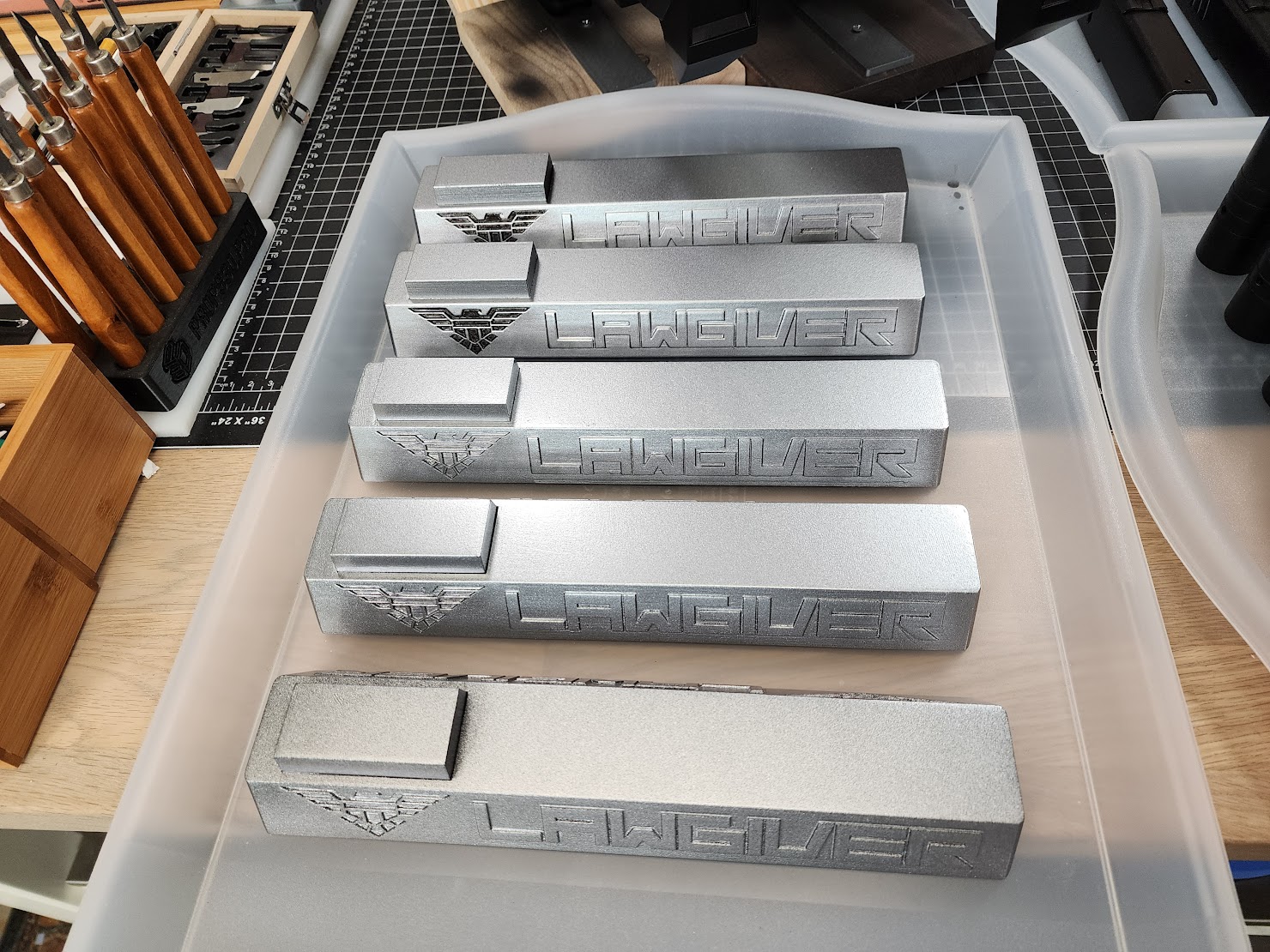

Stands:
2/5 are finished, 2/5 have top coat, 1/5 needs another base coat ant top coat:

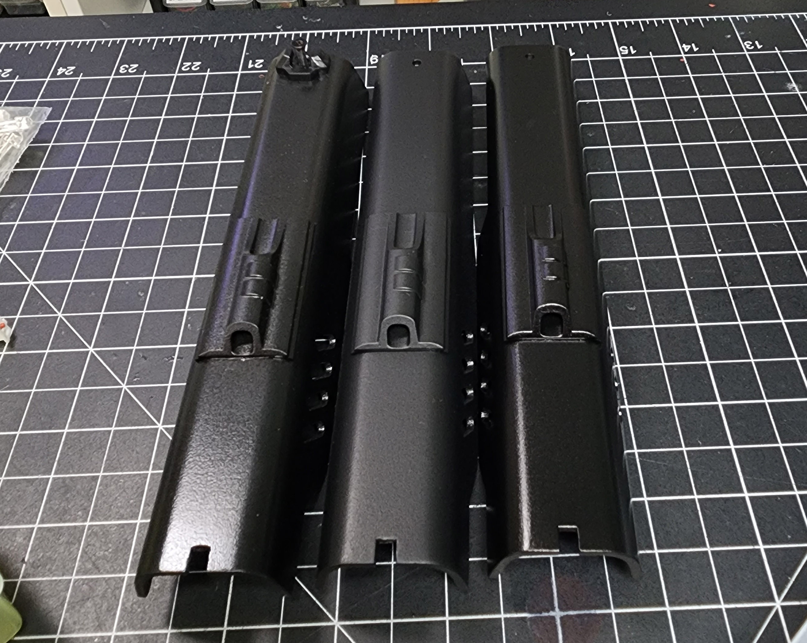

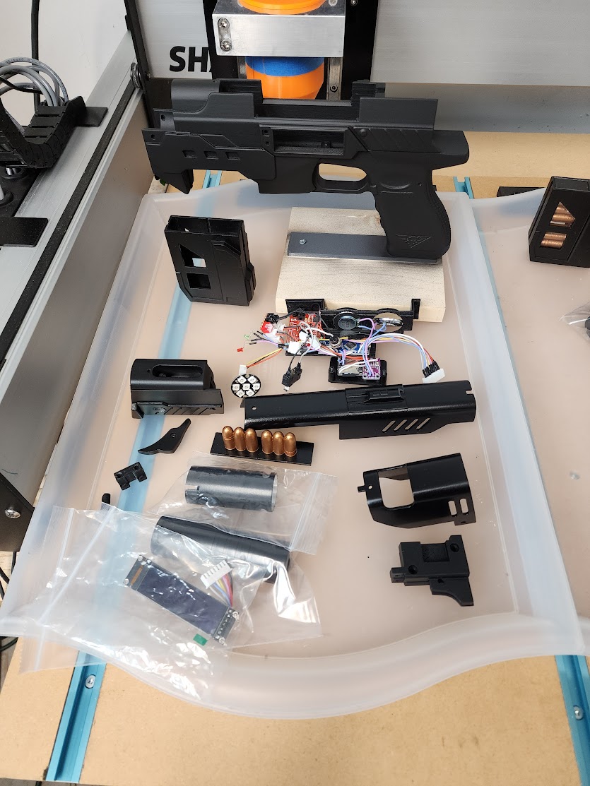

Main parts:
5/5 metal barrels done, 5/5 suppressors done, 5/5 orange tips done, 4/5 trigger groups done, 3/5 cocking mechanisms done, 2/5 cocking mechanisms primed, 2/5 magazines done, 3/5 magazines waiting for assemboly

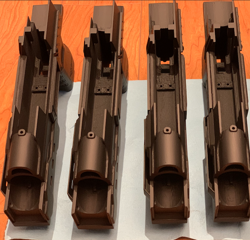

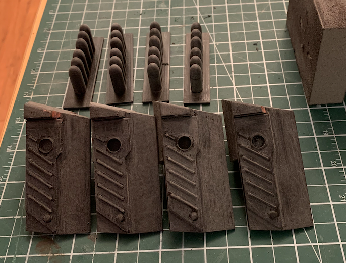

Frames:
3/5 maybe done (they need close inspection), 2/5 sanded and primed
SOOO CLOSE!!!!

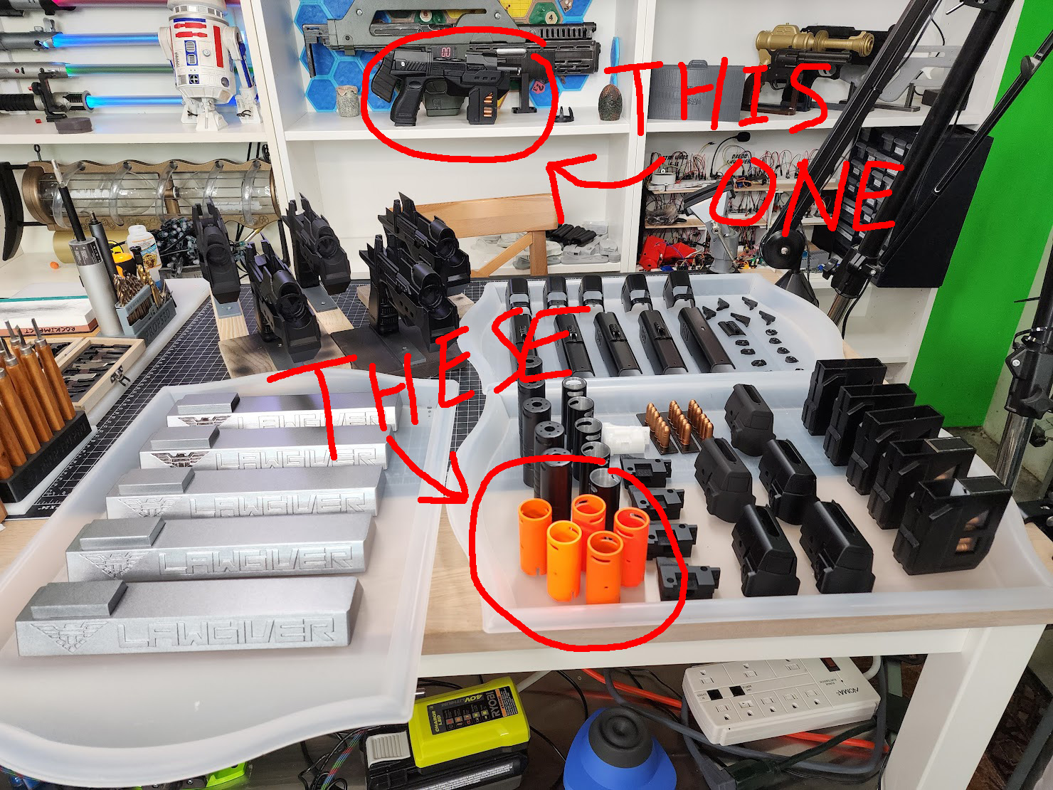

An addendum to yesterday's update addressing 2 points, one from a DM and one reminder:
First, THESE: I had a bit of a 'YIPE!' a few months ago when someone came by my shop to pick something up and saw a Lawgiver, they thought it was a real gun until I let them inspect it. DIY guns are a nono in Canada and I don't need my door kicked in by the police yet again. That got the wheels turning and the 'click' came when I saw a post on the Judge Dredd Costume Group on Facebook of Judges in parades and at events that these may be a little TOO real. So these orange tips are a freebee we're putting in every box to give you the option of being a little bit safer. There's a another group of Judge, Jury, and Executioners out there that may be a little fast to render a verdict. I'll leave it to you if you want to use it, but it's there. You can easily pop out the lens holder from the metal barrel and put it in this one if you want it as well.
Second, THIS ONE:
We're taking our time to get them right, and maybe taking a bit longer than we have to on things only we would notice (Craig and I had a Zoom call today for a mutual 'Do you think this is good enough?!?' ). So if you're ever in the state of "Just give it to me already!" This is a finished V3 ready to go at any time... hmmm... any Top Gear fans? Maybe this would be a clearer analogy:

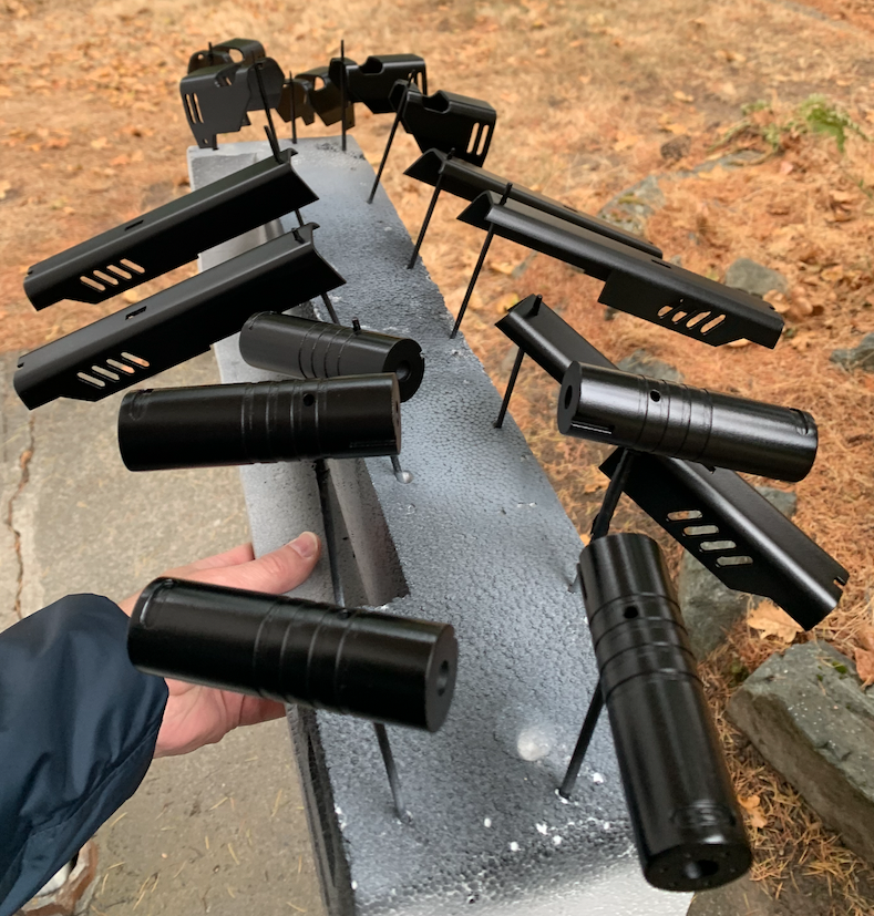

Nonetheless, there's still lots to show you. I've been making progress on processing all the prints. Most of the sanding has been completed at this point with the exception of a few pieces in progress still. But they'll be in primer soon enough.

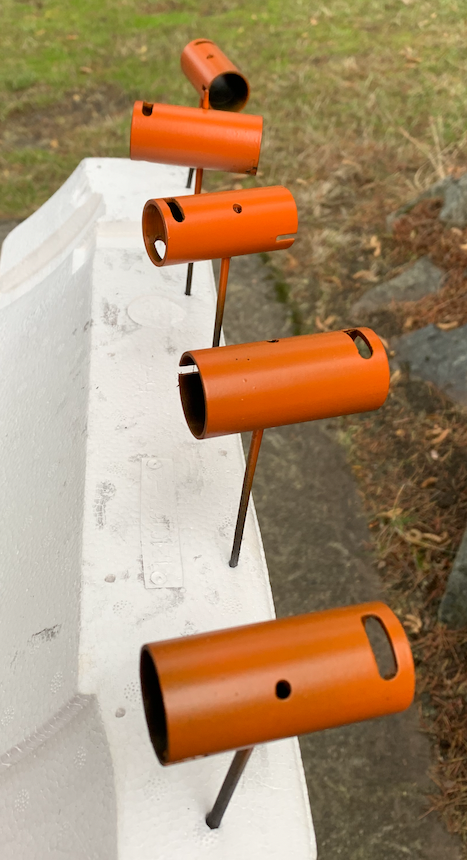

Barrels and plates ready for primer and base coats.
Some finished tops and silencers.
Bodies primed and ready for base coats:
Some smaller parts that have been top coated but need a little more attention include the orange barrels, mags, etc. These will need the top coats polished and refinished.

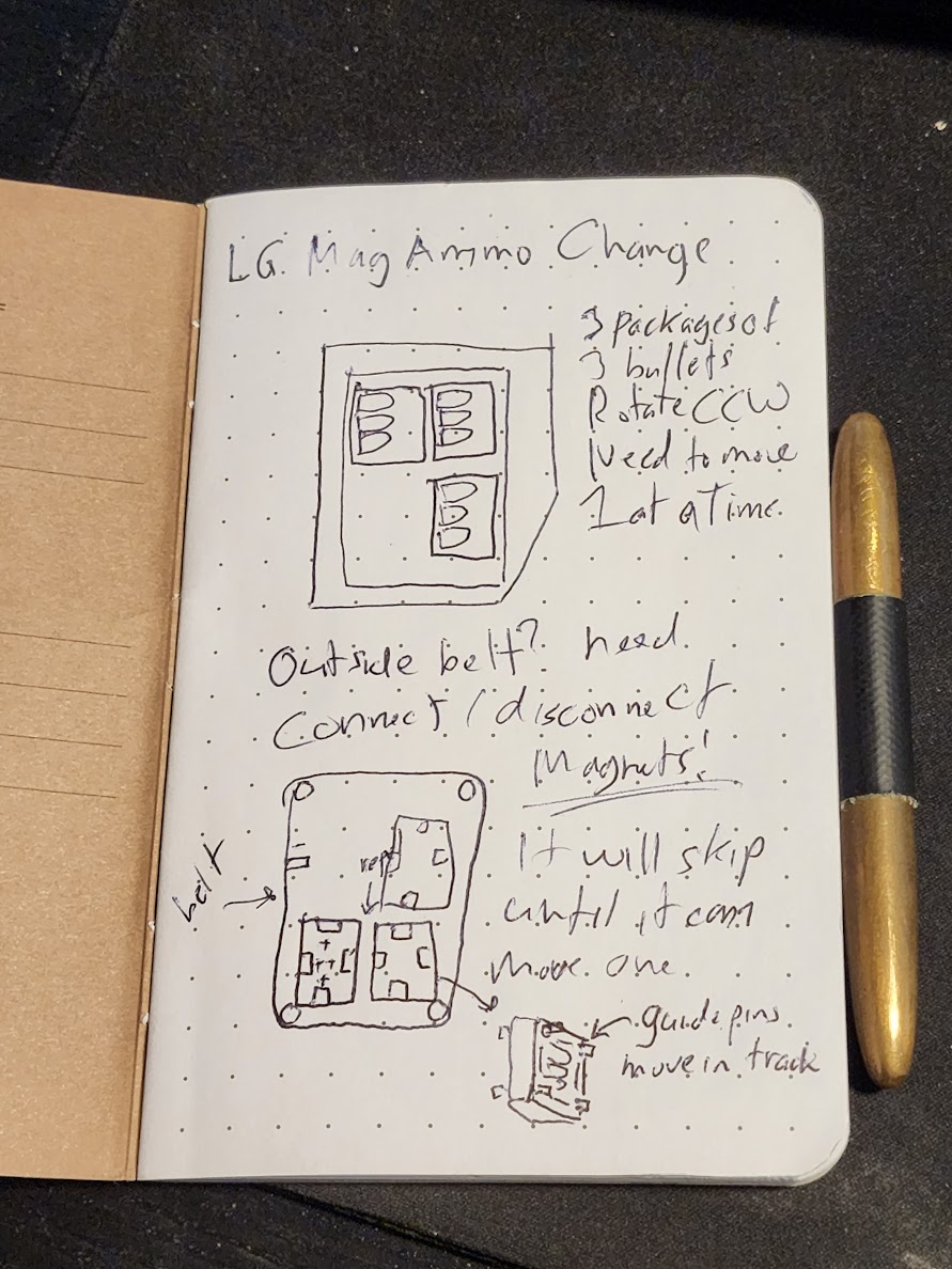

Here's 3 other ideas I worked on that didn't make the final cut, just for fun (and maybe for inspiration for someone since the models still have the theoretical support for them):
MECHANICAL MAGAZINE ROUND CHANGER
Idea:
When I was originally creating the model I had included an automatic round changer in the magazine when you changed modes. It was based off a design that was tested but never used in the movie so I wanted to make it real. I wanted to use 3D printer belt running around the inside of the magazine with 4 magnets on it that would 'grab' each of the 3 stacks of ammo. As the the magnets passed over each stack magnets on the stack would try and grab them but only one stack could move at a time since there was only 1 space open. So in one 2 full belt rotations every stack would move one place, with one move per 2 'grabs'. (one move into place, then disconnect since it can't move further, quarter turn on belt, grab next one, move one place, repeat). The belt track was facing outwards so it would mesh with the motor in the frame when you inserted it, but it was designed to be screwed in place and not removable. There's still space in the model behind the magazine for the N20 drive motor.
Movie Concept (uses friction):
Why not:
The complexity is huge on this, there's so many moving parts in such a small place I can see this failing unless well maintained. I still plan on doing this later but making it a separate model. It also needs a ton of hard to find parts so it just wasn't worth it, I'm still trying to make this project semi-accessible. Removable magazine is cool enough.

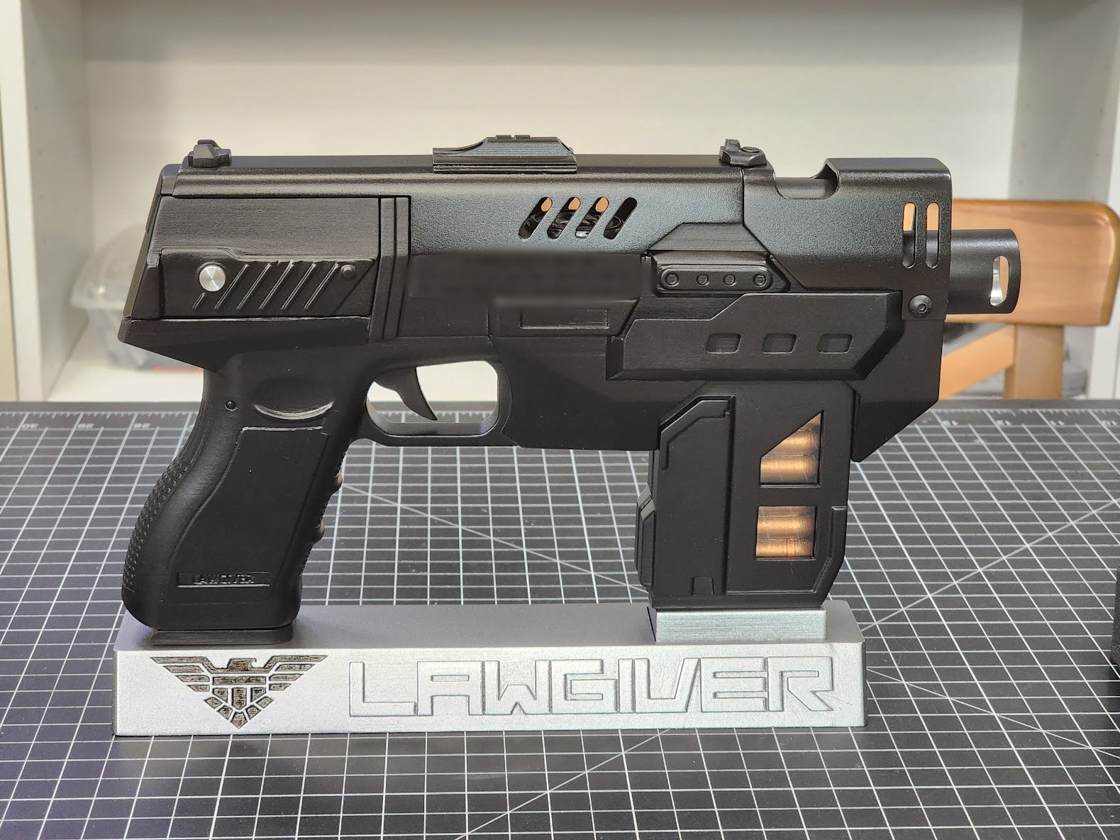

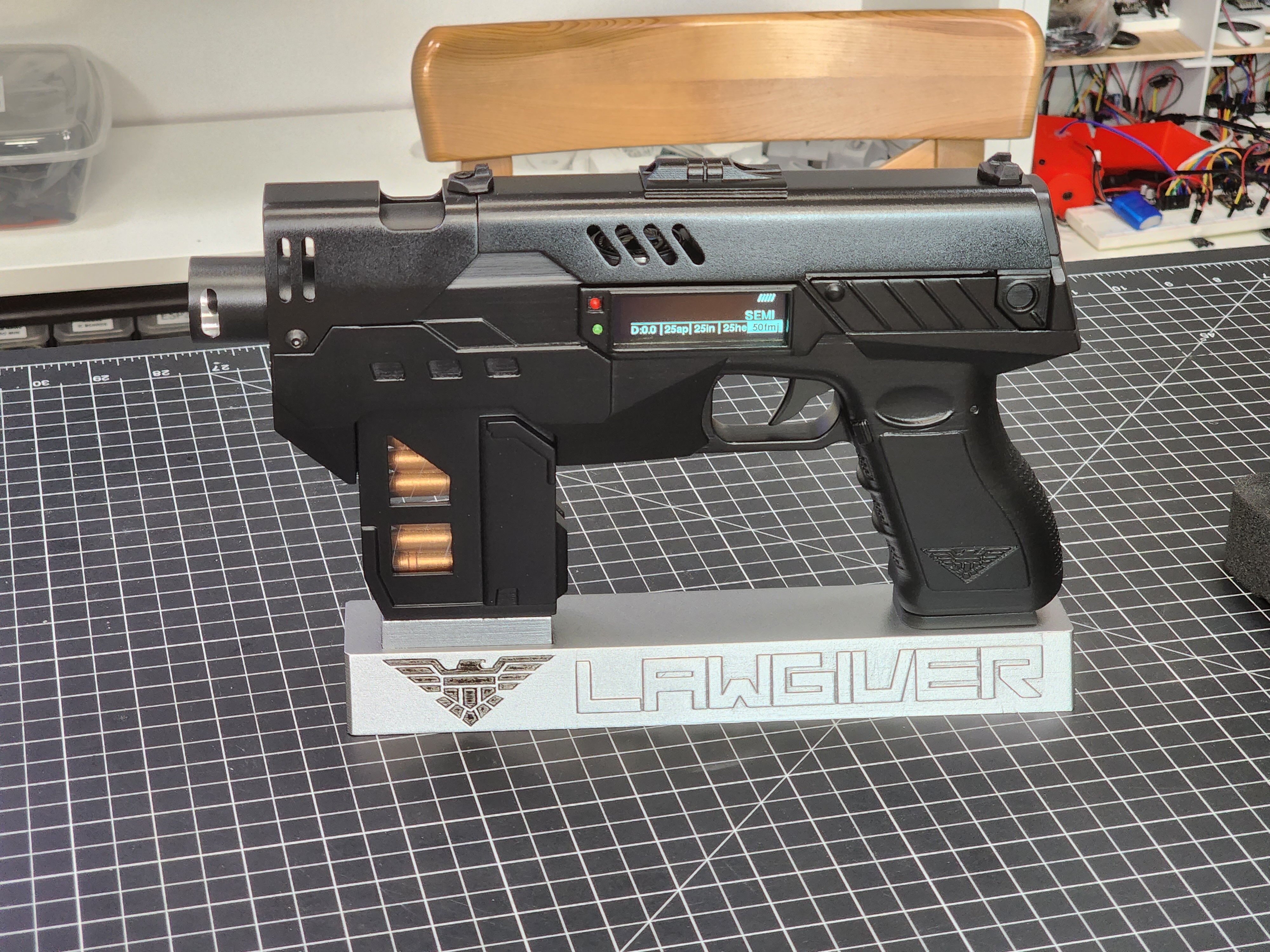

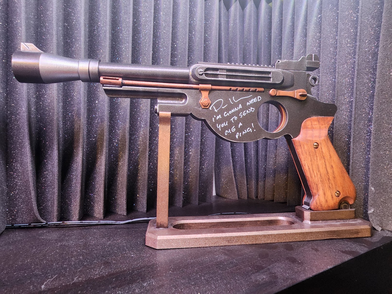

Sorry these pics are just taken with my phone under studio lights, meant to take nice ones but it's been a crunch time weekend and I want to get this posted before it's too late. Note that I'm doing a lot of parallel operations then when it gets to the finishing stage I'm doing them 1 by 1.
Here's a full state of the union on each of the remaining Lawgivers for my part of the run.
enterprise0216 :
Yours is ready to go*!
* I did remember that you wanted the stand coppered and weathered, doing that either tonight or tomorrow AM
(serial blurred because it's custom)

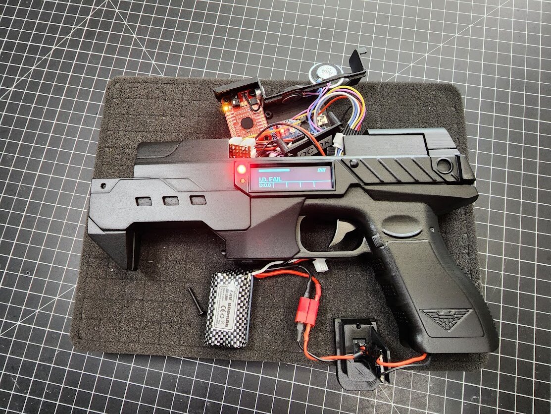

rolandblais :
I'm just doing the final electronics installation, it's all ready to go after that pending inspection
asavage :
Yours is almost ready to go but still needs the top coats on the frame, everything's 100% except for that
The next two are coming along behind these, the electronics are done and they're on their second primer/finish pass:
The last one on my list is the Toy Traders one which will be after all these have shipped and will be filmed for the 'how to' videos.
