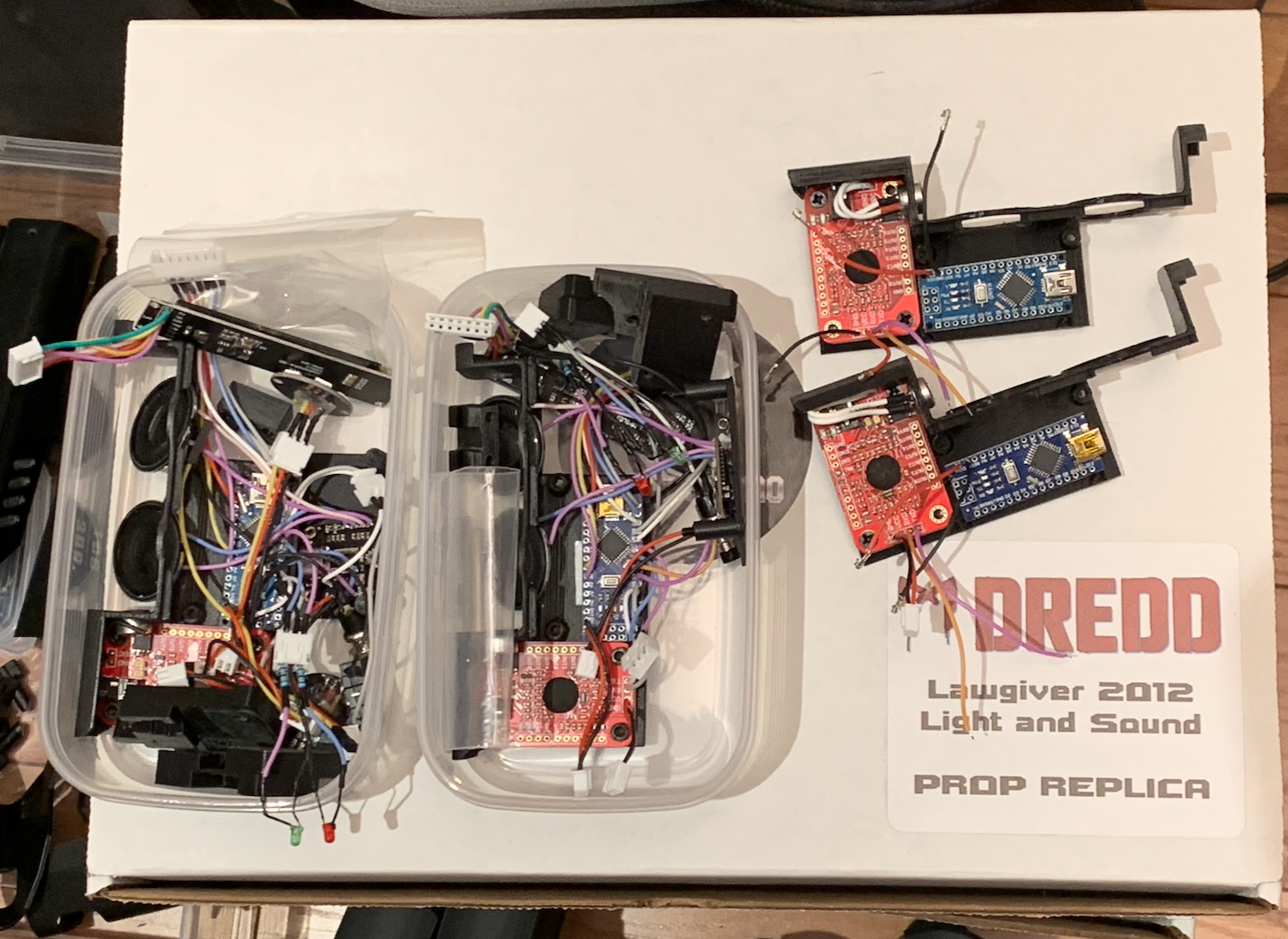

I'm making progress on the electronics part of the next two builds. At this point, I have two working kits ready for final assembly, and I'm working on the components for the last two kits. Goal for this week is to get final assembly completed for the next two Lawgivers which will entail fitting and gluing the brass plates and aluminum knob, fitting led and barrel assembly, and the full electronics caddy. Once assembled then a power test to ensure all the functions are working, then I'll get them boxed for shipping. Chris will contact individuals once items are ready to ship.

I managed to get the next two props nearly finished. Both have the brass plates and aluminum knobs fixed in place, the trigger and cocking mechanisms are assembled and in place, and both caddy's assembled. Both power and function checks passed and were ready to have final assembly done for shipping.
Unfortunately, the caddy separated in two places during fitting which is not a big deal since it's screwed down and secured to the frame. However, I want to replace the caddy before it's completely assembled so it doesn't impede or hamper any future servicing (if it's ever needed). So I started printing a replacement caddy and my Prusa stopped with M112 - Emergency Stop error :(
Turns out that after 3.5 years of printing the heat bed thermistor crapped out. My printer has always been incredibly reliable and I've only had to replace the nozzle over the 3.5 years. Just bad timing I guess. So I've ordered the replacement part and it's on the way. While I'm waiting, Chris was nice enough to print out some replacement caddy's for me and they should be here in a day or two. Should be an easy swap.
they're the new 'beefcake' edition caddies, since there's no stress on the caddies once installed I had originally designed them super thin to make more space for wires. In hindsight I should have considered the fact that they're coming in and out for updates. If anyone else in the run has issues with the caddy let me know and I'll mail you a new one.
The new caddy design also has better speaker retention so they won't pop out if you bang them. On careful inspection the original design 'bowed' a bit around the speakers so they can be banged out out easier than expected. I have 3 LGs now as well, as building over a dozen for the run etc, and haven't had that issue. But it's been reported that it's arrived at least once with the speaker out of place due to the rigors of shipping (again, it just pops back in) so I want to fix the issue. You can still glue the speakers down in the current design if it's happening to you or if you're worried about it happening, but the new caddy design fixes that:

After I got the caddies swapped out, I have two ready for shipping after the weekend.

And I managed to get most of the components done for the next two kits. Will continue on these this week.

- Last electronics kit will be done tomorrow at the latest, doing that together with filming so I have multiple takes
