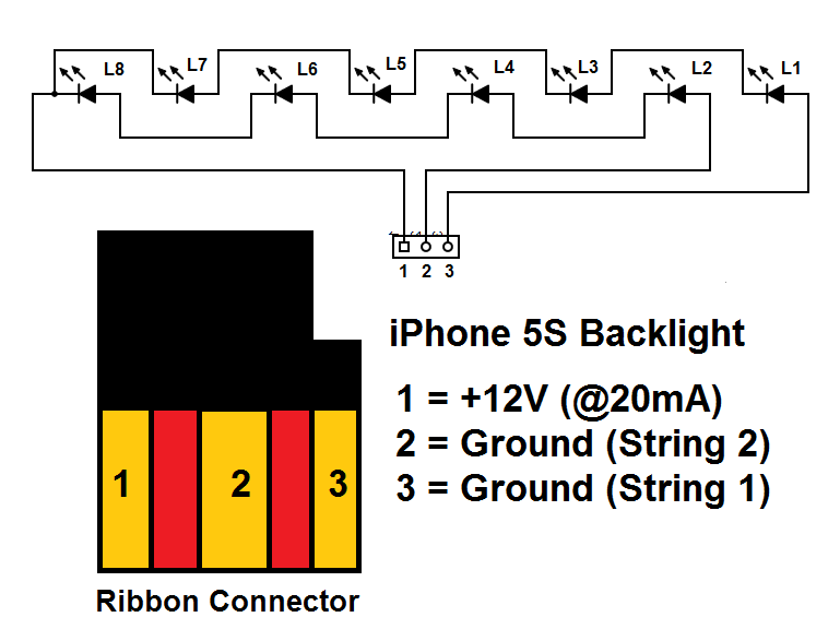

The 5s backlight that has the 3 contacts on the ribbon cable runs at 12V. There are 8 LEDs arranged in 2 series strings of 4 LEDs (all the 'odd' LEDs and all the 'even' LEDs) - the strings have a common positive connection and separate negative connections. With the backlight facing you and the ribbon cable at the bottom it forms a sort of squashed 'L' shape. From left to right the contacts on the connector should be:
1 = +12V
2 = Gnd (string 1)
3 = Gnd (string 2)
Here's the schematic:
The bigger 6s backlight is very different in that it has more pins on the connector, more LEDs (12) and the 2 strings are split unequally - one has 6 LEDs and runs at 18V, the other has 4 LEDs and runs at 12V.

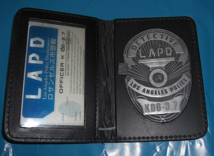

MAJSmith, can you confirm what size wallet and video greeting card you used here? I just received Gekko's badge and this looks like a good match for the size.
Sure thing. This is the Duty Leather wallet from www.badgeandwallet.com. Cut to fit the LAPD-style badge. The ID window listed as 3” x 4 ½” and the actual size of the visible window (plastic) is 2 ¾” by 4 ⅜”.

Take a look at the beginning of the thread. I think I photographed the screens as they come. If not, I’ll do it when I get home. The components don’t come as pictured. Mine were hot-glued to a paper card which was hot-glued to the back of the screen. The speaker (which I just broke off because it’s not needed) and the micro USB port were the only loose parts of the set-up. For the badge, I repositioned the USB port and electrical taped the back just to protect the wires. It’s a little thick, but it’ll fit in the ID section of the wallet.

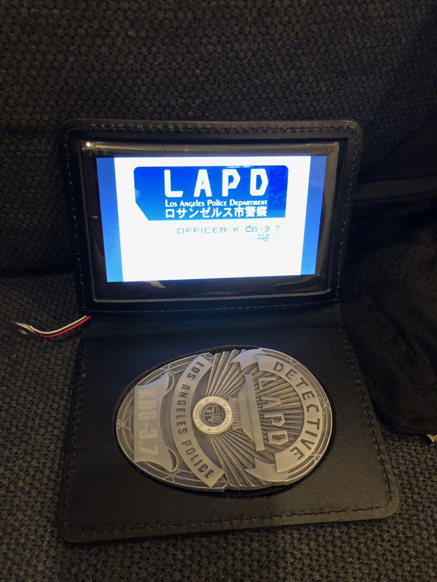

Here's my V1 using an EL panel. Panel needs trimmed, ID badge is not finished and needs enlarged, plastic sleeve is just cut from a polythene ziplock bag and glued under the frames using E6000.
I'll wait and see how your final LCDs turn out before I go that route :)
http://i678.photobucket.com/albums/vv142/kurtyboy2/props2/badge closed.jpg
http://i678.photobucket.com/albums/vv142/kurtyboy2/props2/badge off.jpg
http://i678.photobucket.com/albums/vv142/kurtyboy2/props2/badge on.jpg
http://i678.photobucket.com/albums/vv142/kurtyboy2/props2/badge on dark.jpg

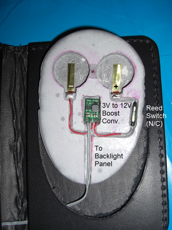

I'd previously routed out some pockets in the back of the badge to hold a couple of CR2032a and the 3V to 12v convertet. i had also made some battery contacts out of shim brass. Today I needed to make a pocket for the reed switch and finish off the wiring:
The two cells are connected by a brass shim busbar that screws into the post between them and also holds them in place. The reed switch is a Normally Closed type, that opens in the presence of a magnet. The magnet is a slim neodymium one that is taped to the lower edge of the backlight panel in the ID side of the wallet - when the wallet is closed it then opens the reed switch and disconnects the battery positive connection. The thin grey ribbon cable is soldered to pins 1 (+12V) and 3 (Ground for string 1) on the tiny edge connector of the backlight panel.
With the badge in place, it looks like this:

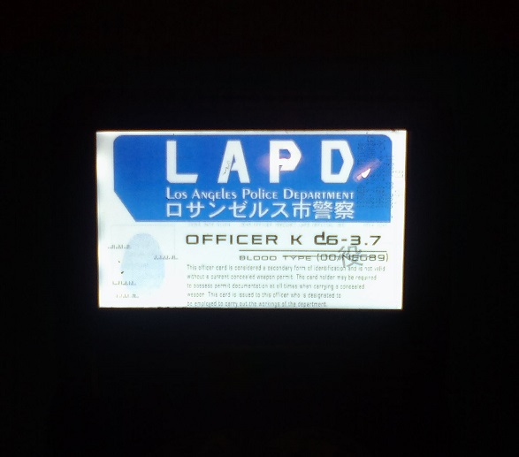

the ribbon cable will be stuck down and painted when I finish it off. The ID was another file I found though Google that seems to be a little more accurate, laser printed onto an OHP transparency and taped to the edged of the backlight with clear vinyl (I could do with finding a better resolution printer though). The magnet is there to keep it turned off while I was taking the photo, as it's bright enough to overload the CCD on my camera.
this was taken using my phone, which adjusted the exposure that much the surroundings were turned black (this was taken with the living room ceiling light on). It's 'acceptably bright', I'd say.
