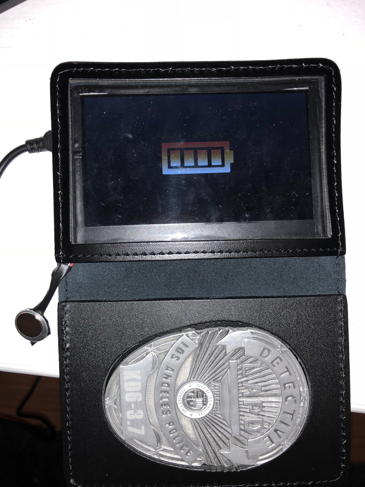

That's good information. I had a small wire break on my prototype model, so I had to use the larger wallet to complete version 1. Here it is without the clear wrap around the sides.
I like it! Is there a way to enlarge the image to eliminate the border? Is it uploaded on an SD card? I’m assuming this is a file you be made in illustrator or similar?
I got the file from Birdie's ad on Etsy (thanks Birdie) and I don't think I can enlarge it without distorting the image. The image is uploaded via micro-usb and that's the same way the screen is charged. I reinforced everything with electrical tape and now I just need to figure out how to secure the vinyl wrap.

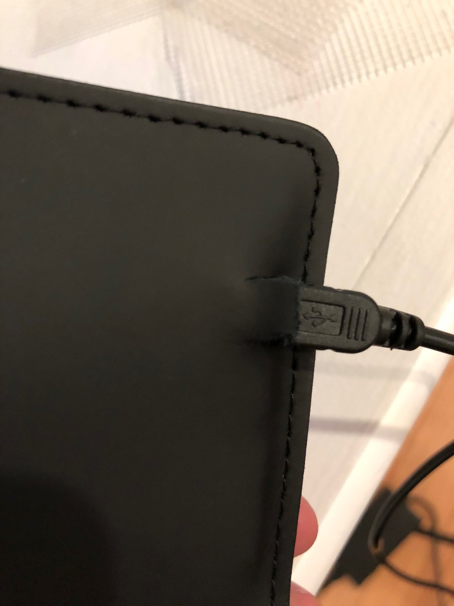

I cut a little slit in the side to fit the charger. Here's how it charges:

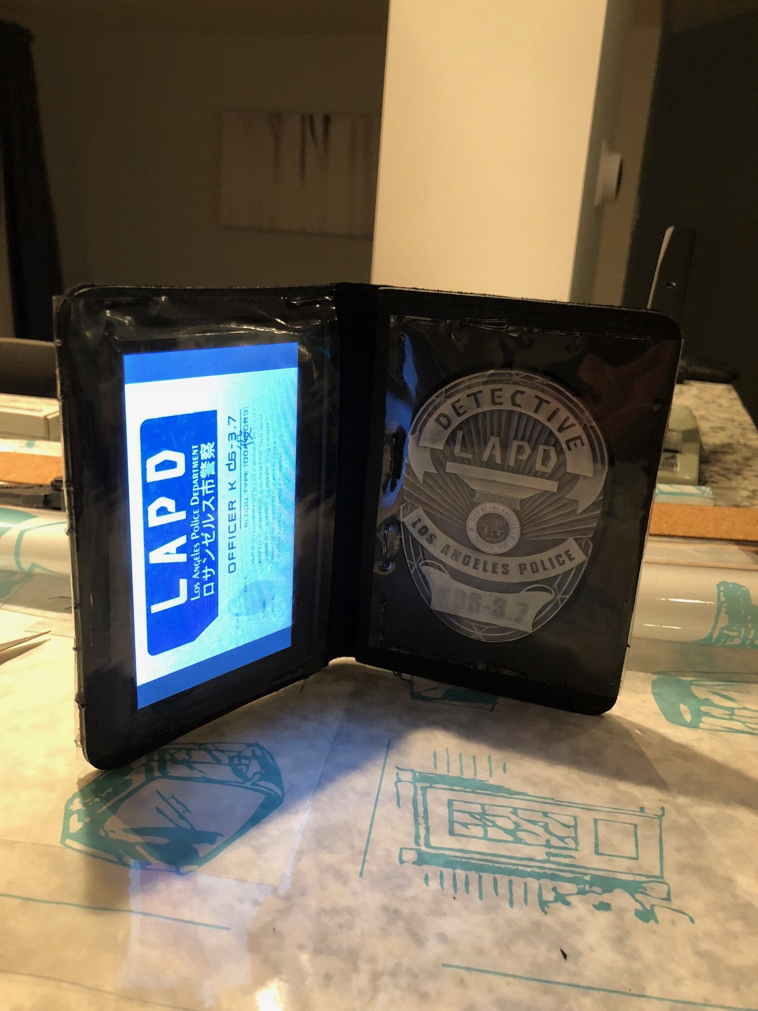

Here's Version 1.0. I experimenting with the vinyl wrap and black staples. This was just a quick, and rather sloppy, build. I'm going to use a thicker wrap and tape the sides of the exposed screen to hide the excess glow.
Looking spectacular. You can just cut out a frame for the ID with a thin section of black heavy paper and slide it in to finish that part off.

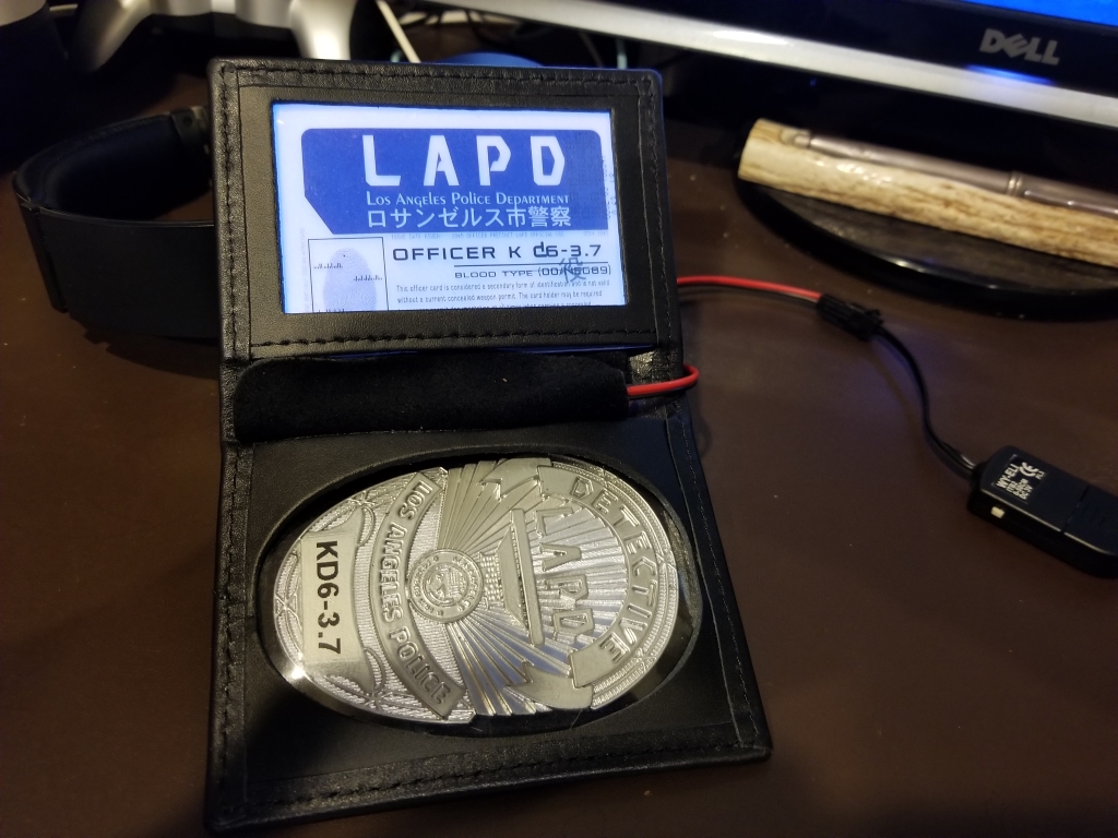

This is my current version. The lighting is still a bit dim (but looks good in low light settings) and I still need to weather the badge.

The lighting is an ePanel from Adafruit. It uses a coin cell battery. My intention was to make a small cut and route the battery holder/switch behind the wallet.
