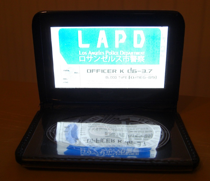

The iPhone 5S backlight I used is designed to run at 20mA at 12V (there are 2 sets of 4 white LEDs in series, though one set of 4 LEDs is enough for the ID). Each white LED needs at least 3V light, so the 12V is split equally across all 4 LEDs. Ideally you would have a current limiting resistor between the LEDs and the power source, but my testing showed that using 2 CR2032 coin cells to power the boost converter it could just about deliver 25mA maximum at 12V (which decreases as the barreries discharge) so the LEDs were safe to use without a current limiting resistor. If a current limiting resistor was required I would have needed more than a 12V supply too as the limiting resistor bleeds off some of the voltage.
When I tested the Lithium Manganese pouch cell (which has similar discharge characteristics you your LiPo cells - it can dump a lot more current than a CR2032) I found that the initial current supplied to the LEDs peaked at over 30mA, which is getting into the damage territory. However, as the Lithium cells discharge quicker than the coin cells the peak current drops quite rapidly as the battery discharges. You may find that the battery doesn't last very long at all, which is why I went to using a 6V supply (2 CR2032s) for the boost converter. Increasing the supply voltage also decreases the current the boost converter requires to output 12V, making the batteries last longer as well.

I used 2 cores stripped from an old hard disk ribbon cable. I stripped a small section of both cores at one end and split the strands of each core into 2 roughly equal bunches (there were only about 6 or 7 very fine strands in each bunch), twisted the strands of each bunch together and then tinned them so it was like they had been split in two, or like the tines of a fork. I then tinned the gold pads on the end of the backlight's ribbon cable (both sides of each of the outer pads - the top and bottom pads on each contact are commoned together) and then slid the contacts between the 'fork' of the tinned strands of my ribbon cable. Once it was in just the right place (which took a couple of goes) I then held the iron (using my finest tip, one intended for SMD work) onto the tinned strands which soldered them onto the tinned contacts. I then flipped the backlight over and repeated the process for the other tine of the fork on the bottom contact.
I then securely taped the backlight connector and my soldered joint lengthways along the bottom of the backlight using kapton tape to stop it getting stressed (the ribbon connector on the backlight is very delicate and wasn't designed to cope with much handling).
You could just solder the wires onto the top or bottom contacts, but it increases the stress on the contacts and you can end up with them lifting off the tiny ribbon cable (as the solder joint is stronger than the bond onto the mylar film backing.

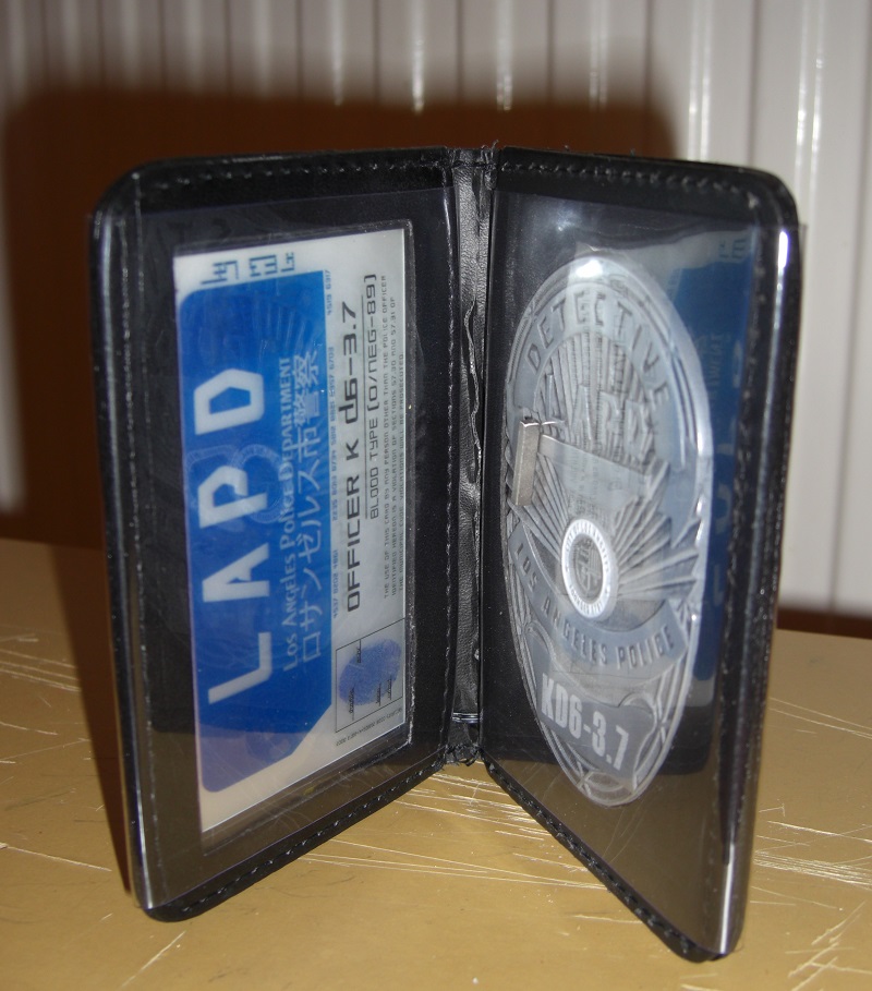

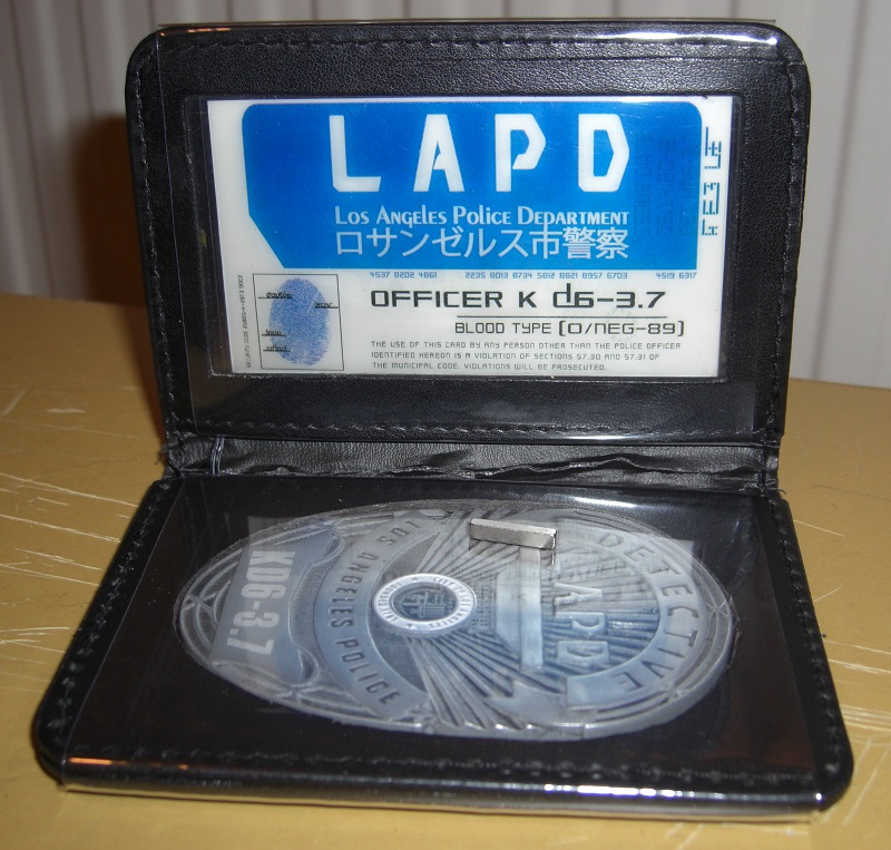

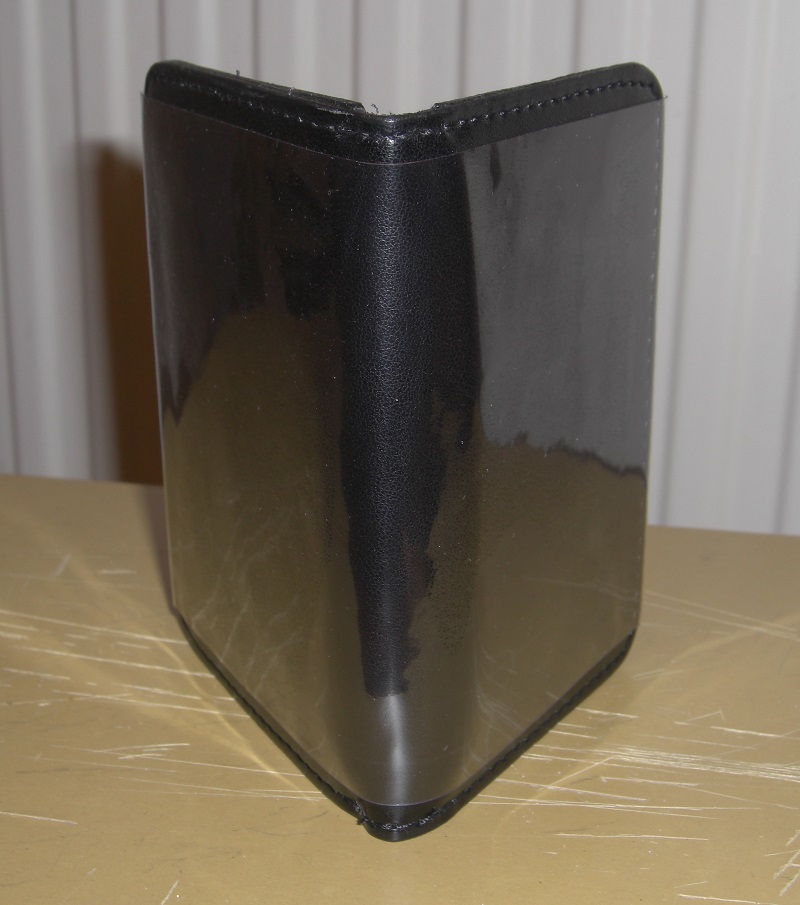

Finally got the PVC cover for my wallet sorted out. I went for 0.35mm - I got samples of that and 0.6mm, which was too thick. I did some adhesive tests and found superglue worked well for both PVC to leather and PVC to itself (I also tried E6000 which held both joints and was a bit more flexible but it's not very controllable, and Thixofix contact cement with worked OK on the leather to PVC, but gave way on bonding PVC to itself).
I eyeballed a paper template first to work out the llength and width of the piece I needed to cut to wrap around and tuck in the open ends of the wallet. I then measured the template and cut it out of the PVC I did a dry run to check the length was still OK (it needed a little trimming) and discovered that the static adhesion of the PVC wrap to the inside of the PVC window on the ID side was strong enough that i wouldn't have to glue it. This was fortunate, as it had the potential to get very messy gluing it while tucking it in. That just meant I had to glue it under the badge side, which I did using a professional Loctite CA gel (it comes in packs called Takpak, for glueing mod wires to PCBs). This gave me the chance to position it perfectly before applying pressure to complete the bond.

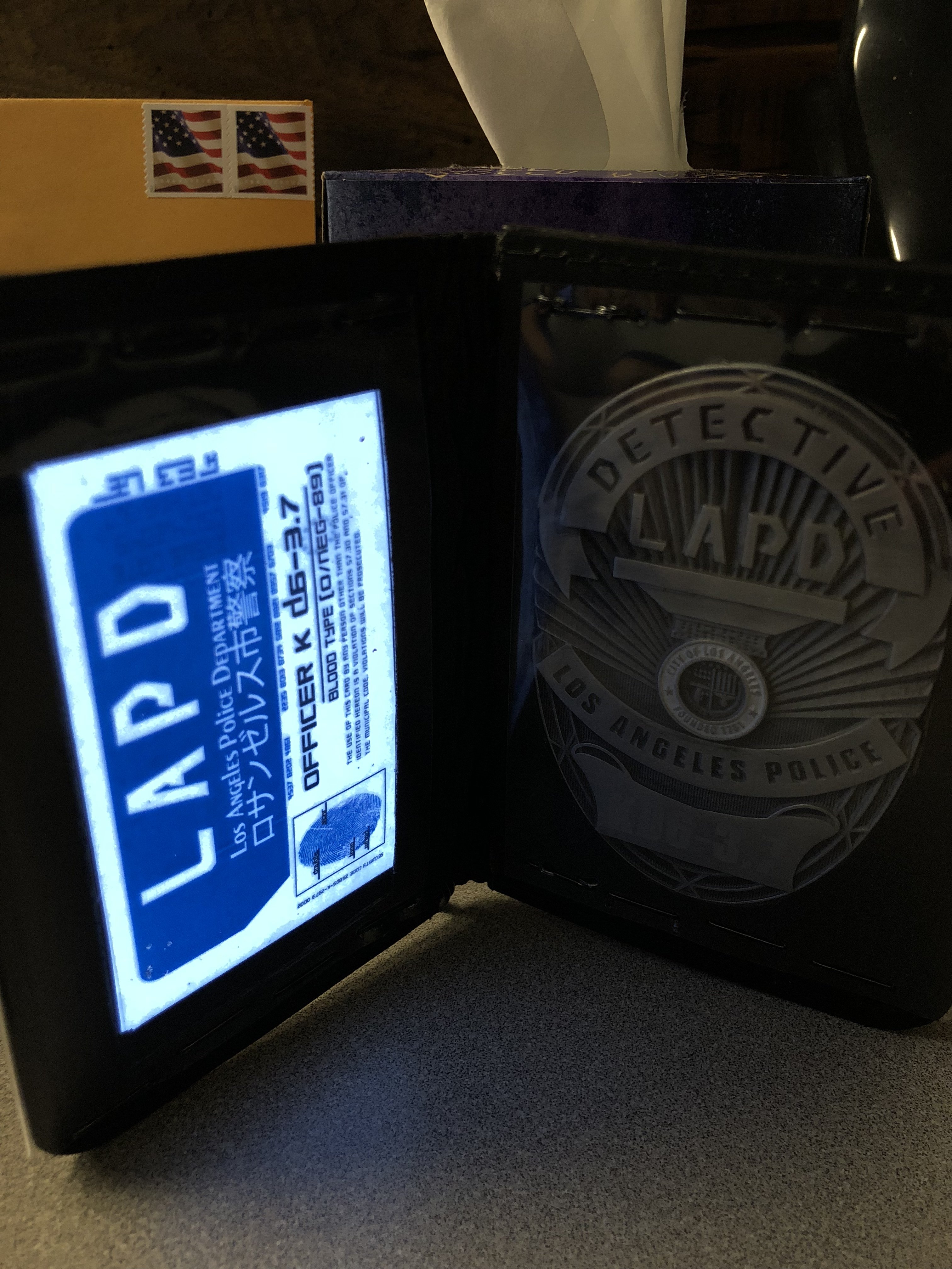

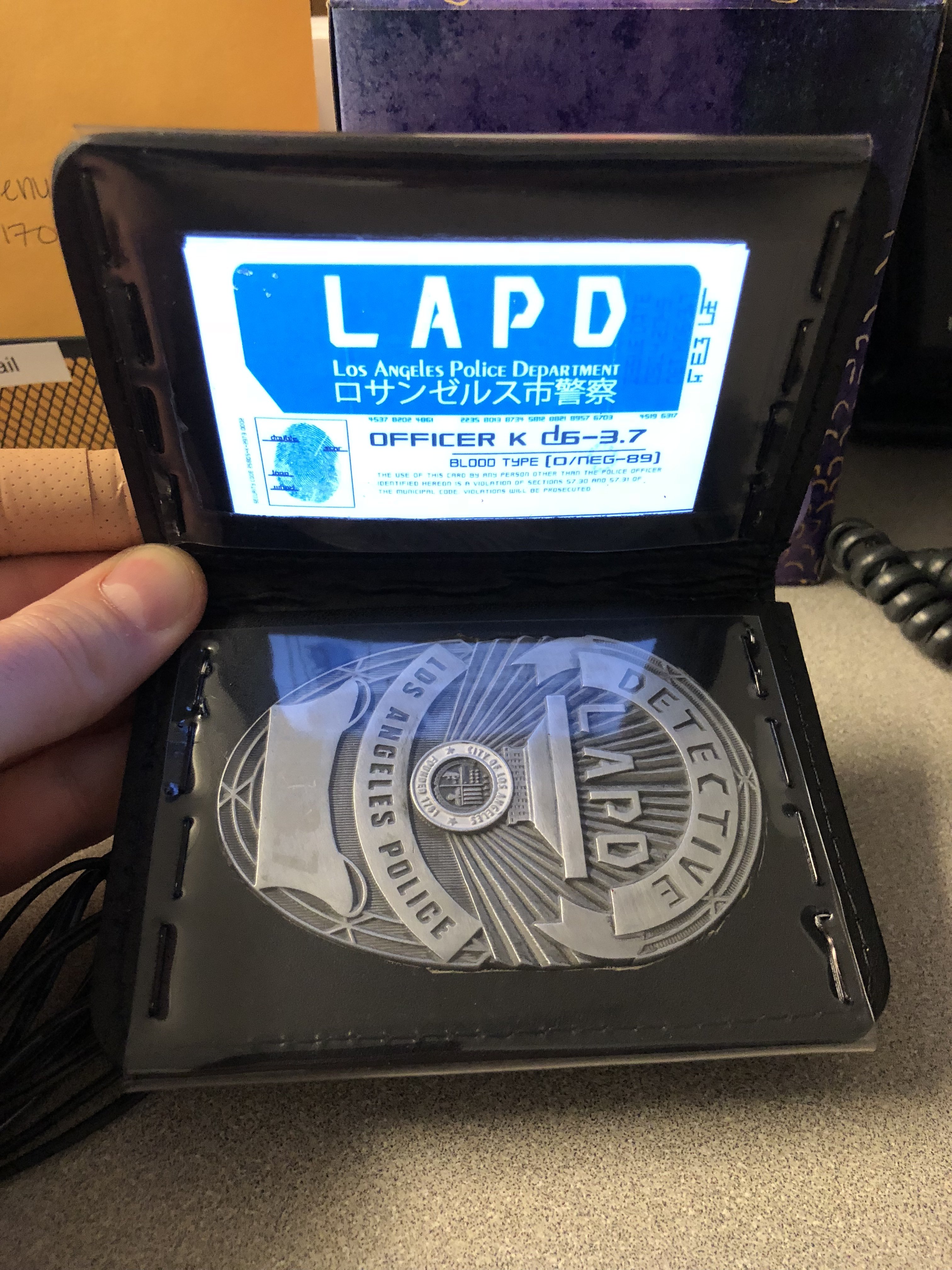

While I had my ID and badge out to do this, I updated the ID transparency to warvanov 's latest version, after a bit of resizing and a slight adjustment of some of the elements to make it look right when sized for my backlight. Here's the results:
I'm quite pleased with the way it looks. The PVC is wrapped tight enough that it clings to the surface of the leather so it doesn't really need to be stitched. It also clings to itself, which helps keep the wallet closed. The last picture is the best I've been able to get so far of it when it's lit up, and you can see it's bright enough to have effected the camera exposure. Easily a match for the brightness of the real prop in the film.
