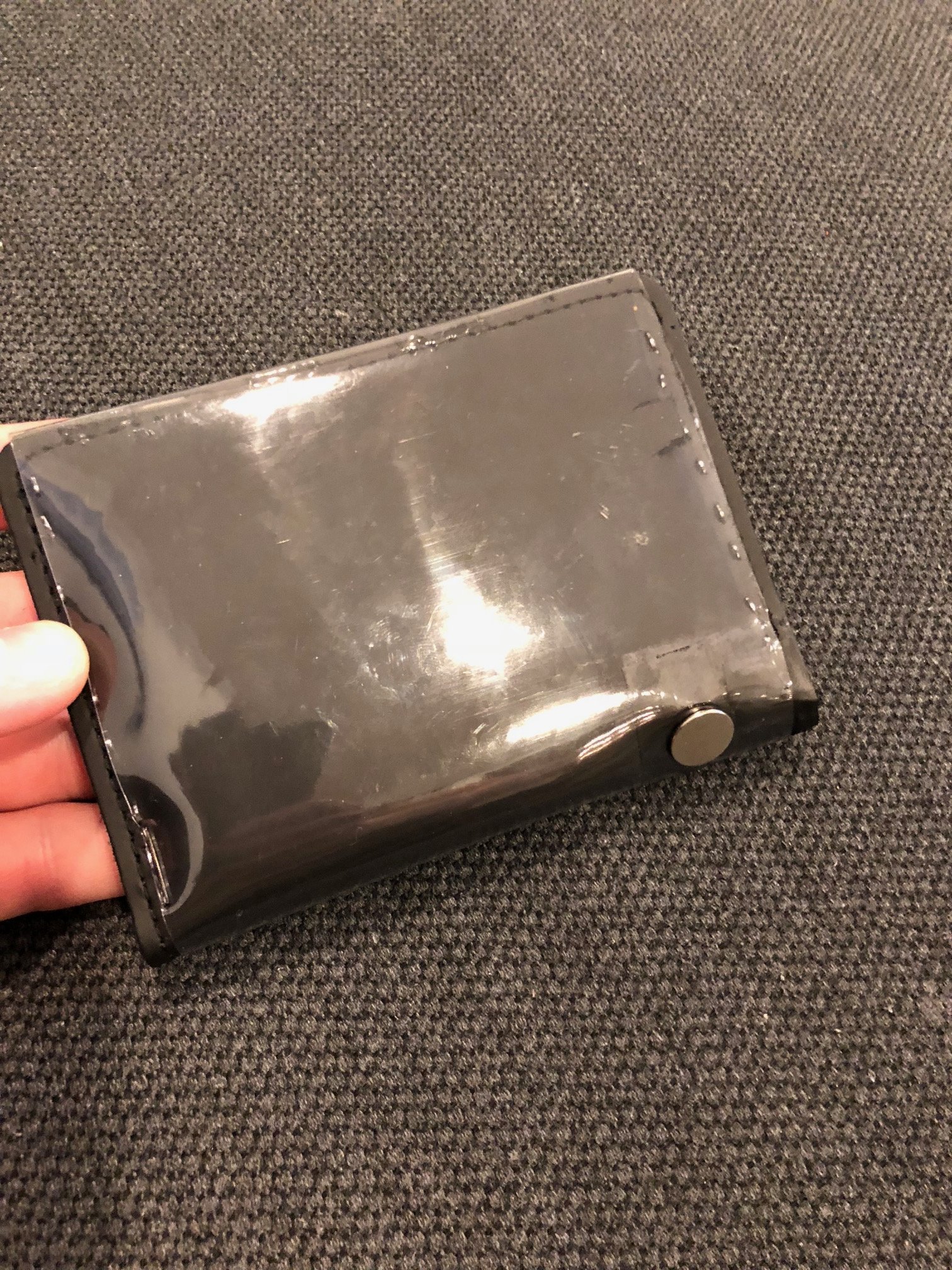

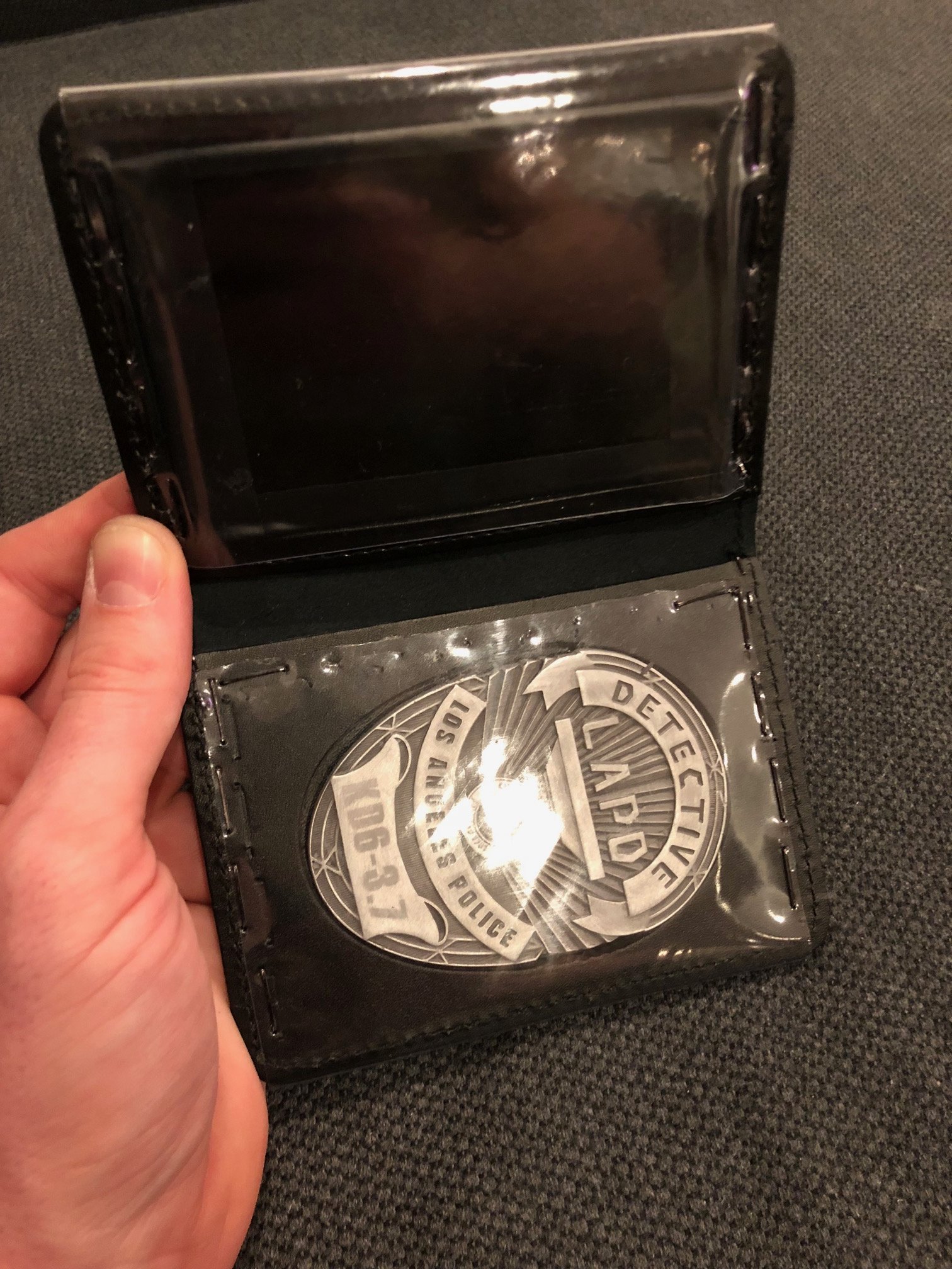

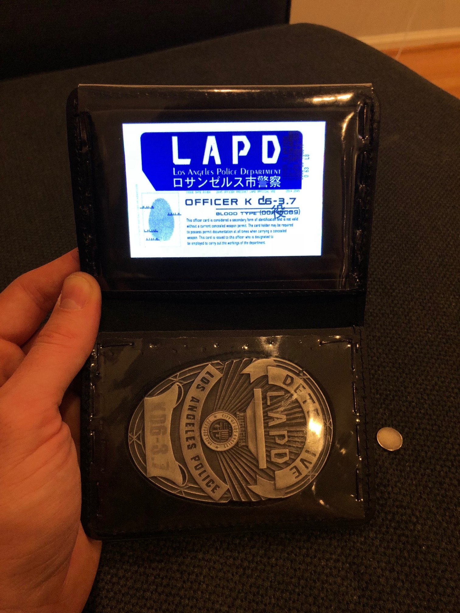

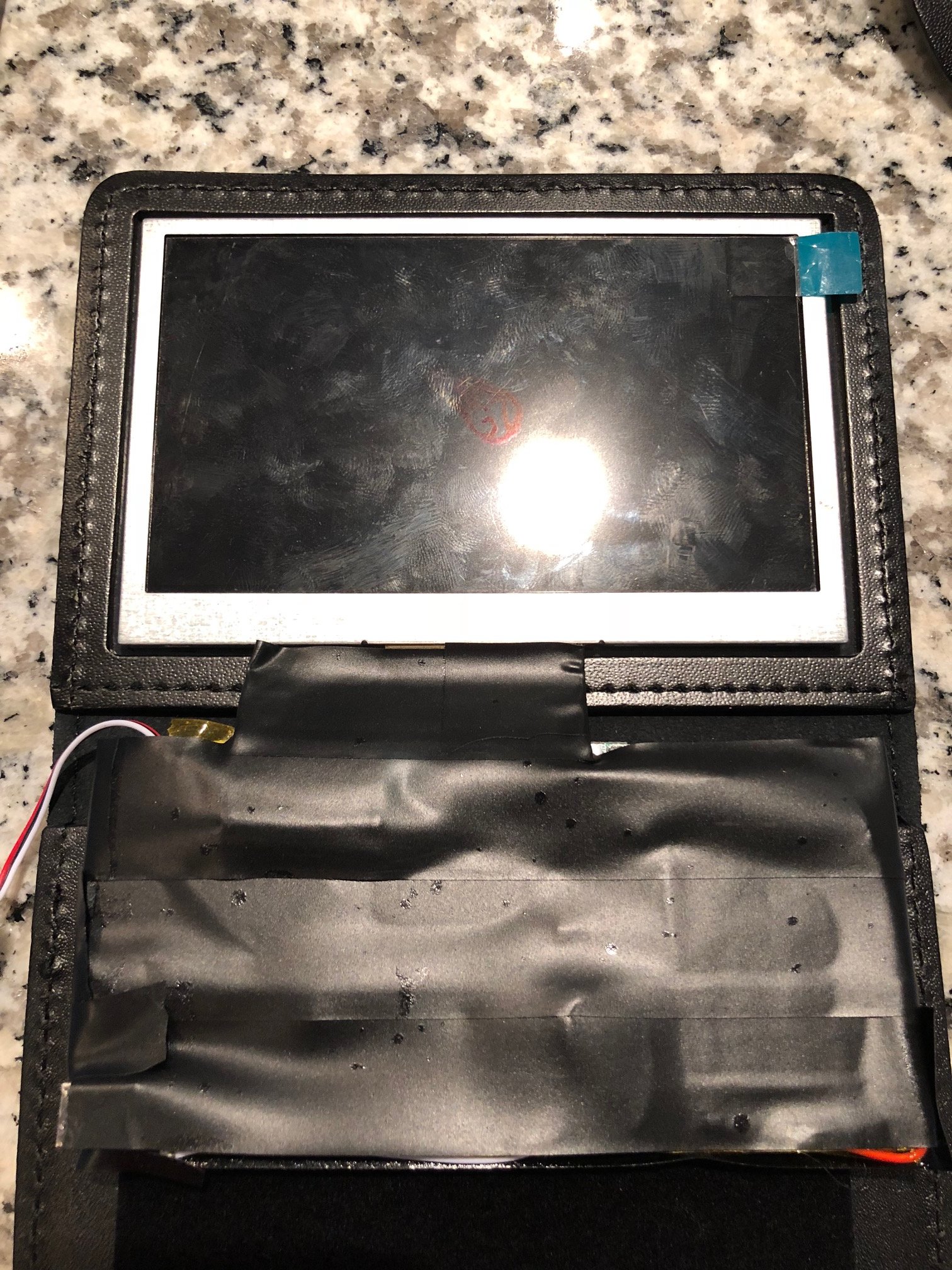

Alright! All done with version 1.0. I wrapped the wallet in 20-gauge plastic sheeting from Joann Fabrics. So here's how it works: The screen charges with a micro-USB and the power is controlled with a little magnetic disc that comes with the screen. The disc works through the electrical tape and the plastic sheeting, so it's perfect for turning the ID on and off discreetly when you open the wallet, just by sliding the disc to the side and off the contact. The backlit screen really keeps the detail in the ID sharp. I used heavy-duty staples, colored black with a Sharpie, to attach the sheeting to the wallet. I couldn't find a feasible way to actually sew the sheeting onto the leather. Here's the final product:

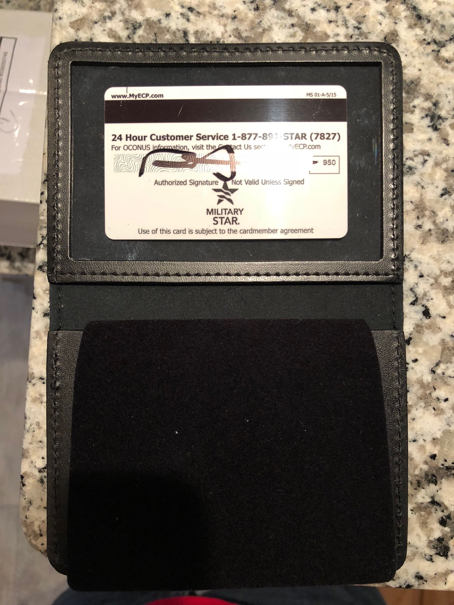

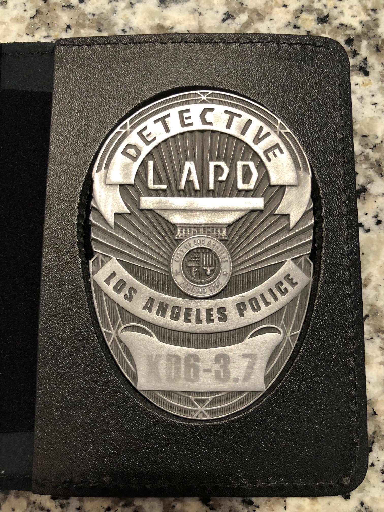

Ok, my first wallet is in and the construction is great, but the ID size is WAY off. Pictures posted below. You can see what I ordered and how it fits with both Gekkos badge, a drivers license-style ID, and the screen in the earlier pic. The badge fits pretty well, with some room to spare. The ID size ordered is 3” x 4 ½”, but the actual size of the visible window is 2 ¾” by 4 x ⅜”.
View attachment 789138View attachment 789136View attachment 789137
What size and shape options did you use for the badge?
I used Gordon Gekkos version of the badge, which is almost exactly the size of the actual LAPD badge, so I ordered the wallet to fit the LAPD badge-style.
Oh ok thanks, and sorry I remember you mentioning that already! That is the badge that I am going to get as well.

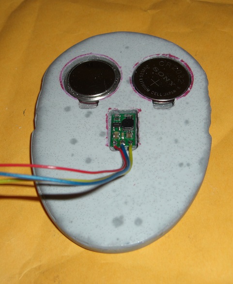

As coin cells were the way to go, I had to think about where I was going to put them (and make it easy to change them). The wallet I've got doesn't have much room in the ID pocket - I can just about get the backlight panel into it. I could either unpick the stitching and insert another layer to make more room in the pocket to put the cells behind the backlight, or look at moving them over to the badge side (which has a very thick piece of leather around the badge). This would mean routing some cutouts in the back of the badge to accommodate the cells and the boost converter, so I set to it today. I drilled about 120 1.5mm holes 3.5mm deep (which was about how much I reckoned I could get away with without breaking though) by hnnd with a pin vise, and then used the milling bits on my rotary tool to rout out the rest of the material and tidy up.
The cells will have copper or brass strips underneath them for the +ve and -ve terminals, and a sprung copper or brass bar screwed across them to connect them together and hold rhem in. I did break through in one area (where II lost concentration and put a little too much pressure on the pin vise) which left a small hole in the bottom of one of the 'valleys' above the LAPD logo. I managed to fill it with a little putty and touch the paint and weathering up though.

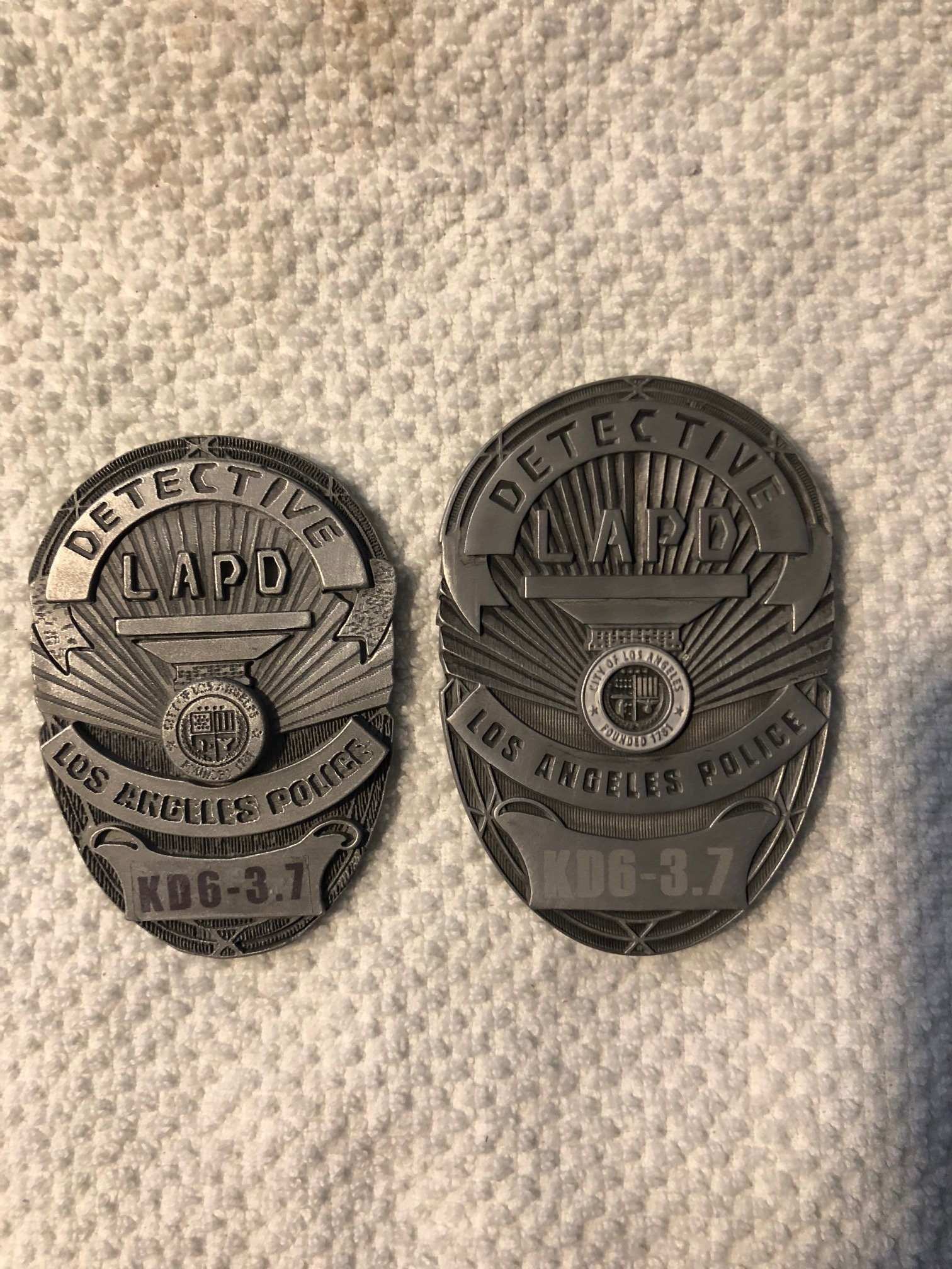

I think this is my final version of the wallet/badge. I ordered a badge from Gekko which should be a little bit nicer than the one I have now.
The proportions are perfect. Gekkos badge is bigger than Birdies, so if you switch them out, you need to cut some more room. I’ll do a side-by-side of both in the next hour or so.
Birdie's is on the left and Gordon Gekko's is on the right. Gekko's is much closer to the actual LAPD badge size and will fit in the LAPD badge cut-out wallets. I should’ve taken a picture of them lying flat. Gekko's is much flatter than Birdie's, which allows it to fold better in the wallet. Both are awesome examples of K's badge.

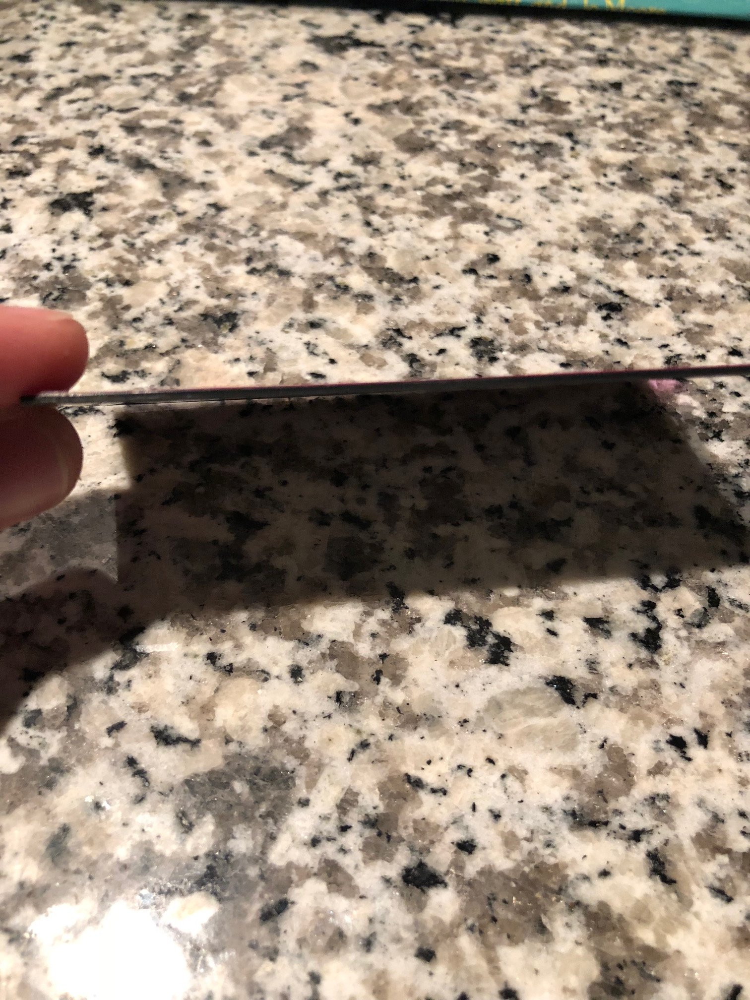

Does it seem like it would break easily? I had no idea they were so thin!
There's not much space in a phone, especially thickness. The LCD glass sandwich and polarising filter that sit on top of it are probably the same thickness again. The backlight is made of a sandwich of plastic sheets, so it shouldn't break. The ultra-thin film ribbon cable connector is probably the only fragile part.
