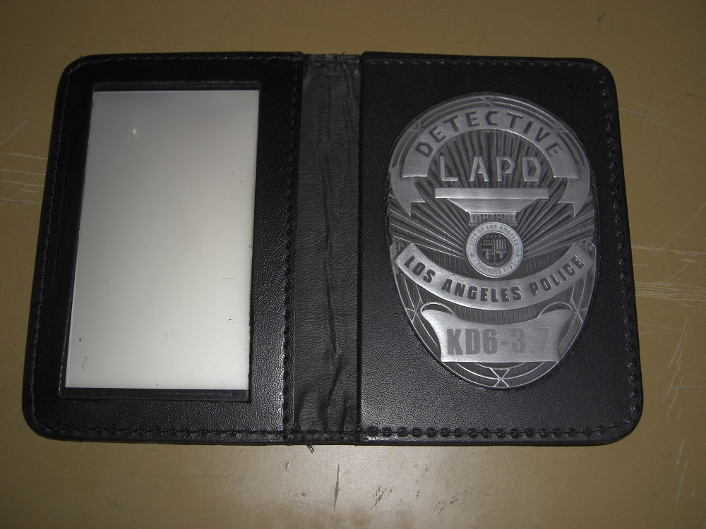

I hope you don't mind me chipping in on yor thread with a few photos of my WIP. I spent a long time looking though the various wallets on ebay to find one with just the right curve on the corner, stitching and window size. I found one I liked the look of, but only the NYPD mini shield version was listed. This wasn't too bad, as it would allow me to cut my own aperture to fit the Gecko badge. After waiting almost 3 weeks for it to arrive (seriously ebay? how can a letter-sized airmail parcel take that long from the US to the UK?) it finally arrived today, so I could make a start..
After the initial look-over it looked promising on size, so I taped up the badge panel, marked the centre line and placed the badge over so I could trace the outline (the X marks around the edges of the badge make it easy to line up with the centreline). I then put a new blade in the scalpel and set to work:

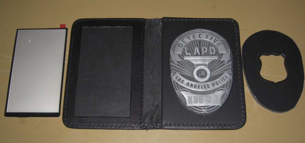

Sizing looks dead-on, and the badge is a nice snug fit. After the faux-suede flap had been removed it sunk in to almost level with the surface of the leather too. The next thing to look at was which phone backlight panel I need to go with - I had ones from an iPhone 5S and a 6s. The one in the picture is from the 5s, which looked like it would be the right one:
Again, a near perfect fit. The only issue is that to get the screen, the support PCB/power supply and battery in there is going to be tight. On the real prop it looks like they solved that by sandwiching an extra strip of leather along the edges on the ID side to make the 'pocket' wider, so I might have to do the same (maybe using foam rather than leather, which would be tough to line up new stitching holes through). The other option would be to carefully hollow out the back of the badge to get the battery and boost converter behind it.

Cheers. It's not even a screen, it's just the plastic backlight panel that fits behind the phone screen. The real prop appears to have the ID printed on transparent film sitting in front of a backlight panel (the silvery background is the give-away to this - it's the mylar mirror sheet viewed though the frosted diffuser), which is why it was still visible on the SDCC display and art book picture even though it's not powered up. i'm just attempting to recreate the same effect. The actual working LCD display on yours is probably more realistic to how it would be achieved 'for real' in the BR2049 universe though.
The wallet came from ebay seller mdelvek713. He sells a number of variations of the 'NYPD Mini Shield' wallet, it's the ones without the embossed gold title on the inside you want They do all have 'Genuine Leather' embossed on the back (without ink though), but that's less of a problem.

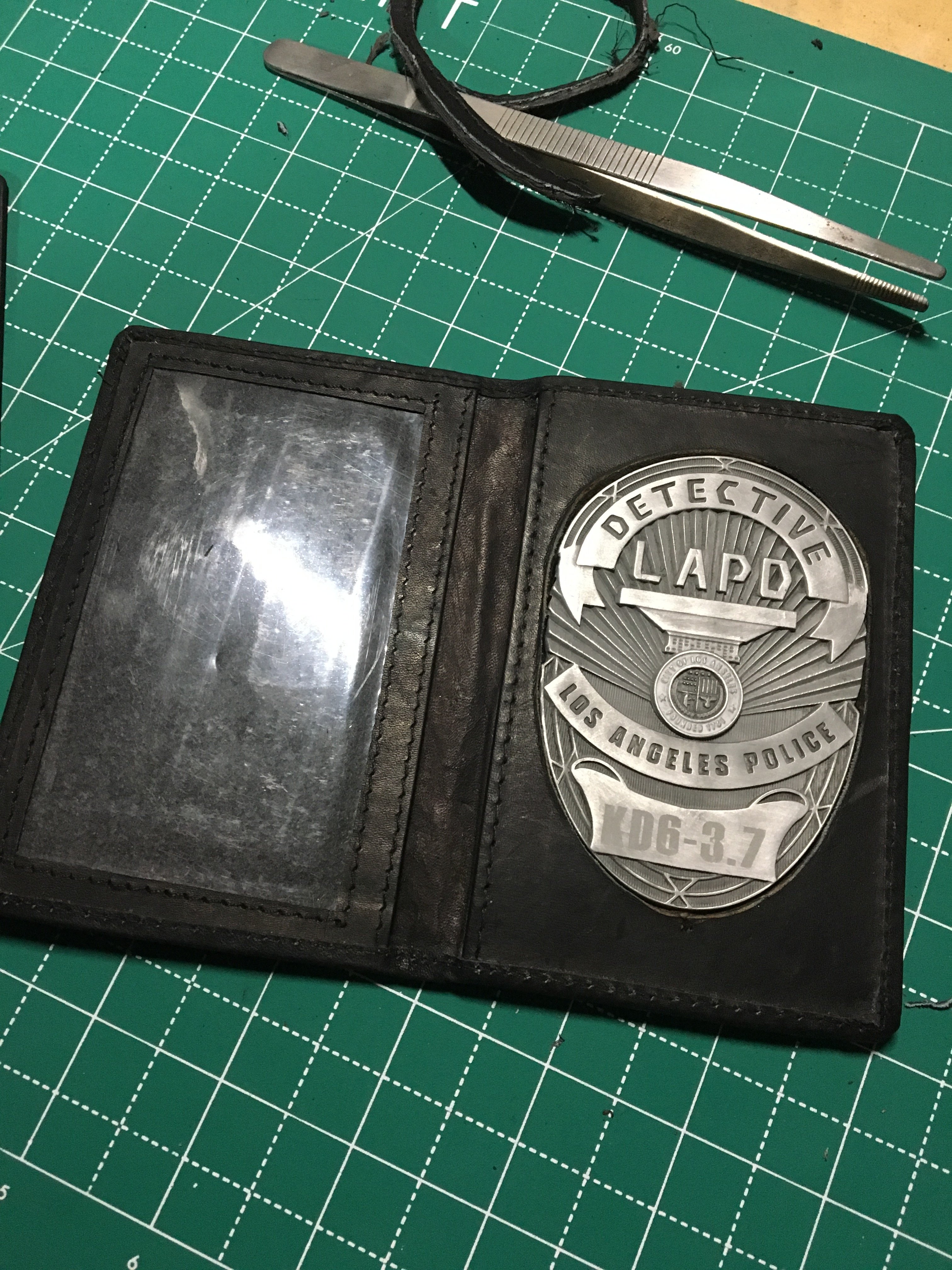

Here's my V1 using an EL panel. Panel needs trimmed, ID badge is not finished and needs enlarged, plastic sleeve is just cut from a polythene ziplock bag and glued under the frames using E6000.

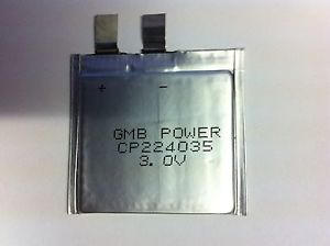

If I use a CR2032 it will be one with PCB mount tabs I can solder onto (or I'll make shim brass contacts) so I won't need a holder. I'm hoping to use a (non-rechargable) Lithium Manganese pouch cell though, like this:
It's about 30mm square and only slightly thicker than a coin cell but has about about 3 times the mAh capacity, 100 times the continuous current draw and 10 times the times the peak current.draw.
The issue with current isn't the overall capacity of the battery, but what continuous current draw it's chemistry can support. A typical name branded CR2032 coin cell can only really support a max peak current draw of 30mA due to it's internal resistance (which is a function of the chemical reaction in the cell), and are rated for only 0.2mA continuous current draw. This limits the output of the boost converter but on the other hand keeps the current supplied ot the LEDs in the safe zone, so it's a bit of a 'swings and roundabouts' situation.
