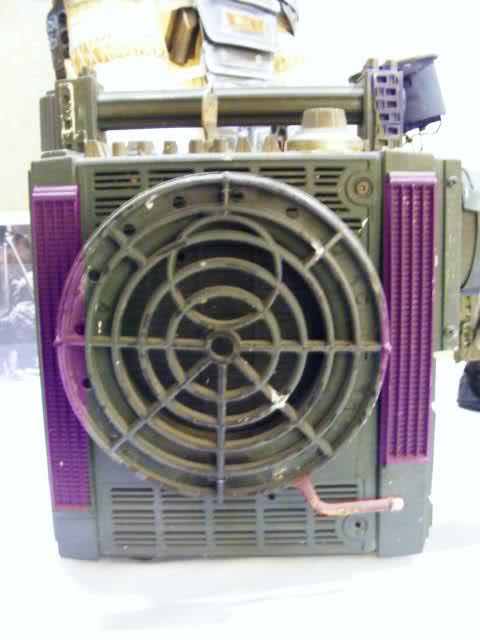

ORIGINAL GRILL FOUND
I identified the grills that can be seen on the motion tracker from Alien and since I've been told that I'm basically a freeloader, that I'm on this forum just to sell, that I do not "share" and that hence I would be better elsewhere... here's the information on the origin of the grills that are found on the original Alien motion tracker.
The original grills come from 1950's-1970's "ELIZABETHAN" tape recorders from United Kingdom. Since there is so many models of this brand, and many do not have the correct grills, I made a detailed list where I noted down the year of production and the presence of the correct grill (lots and lots of ebay browsing and a couple of collectors' websites have been the source of information). The list is not complete but it will save you a lot of time wasted on aimless "70's plastic grill" searches on ebay.
Keep in mind that the motion tracker also shows a "longer" vent grill (20cm) and I have not yet identified which model does this come from, if anyone wants to keep browsing on ebay searching the models that I have yet not found it might be eventually discovered.

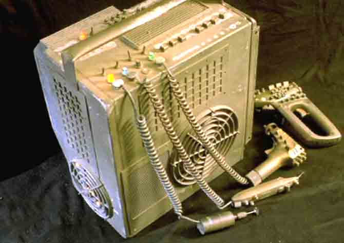

The cat box from the Bob Burns collection shows that one of these grills was also on that prop.
