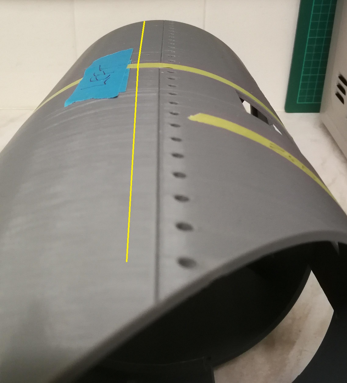

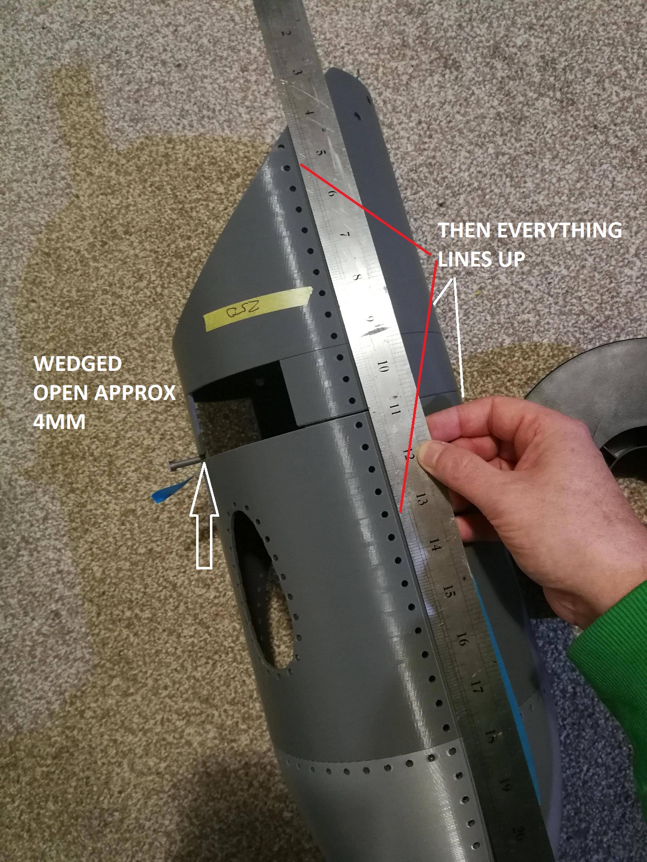

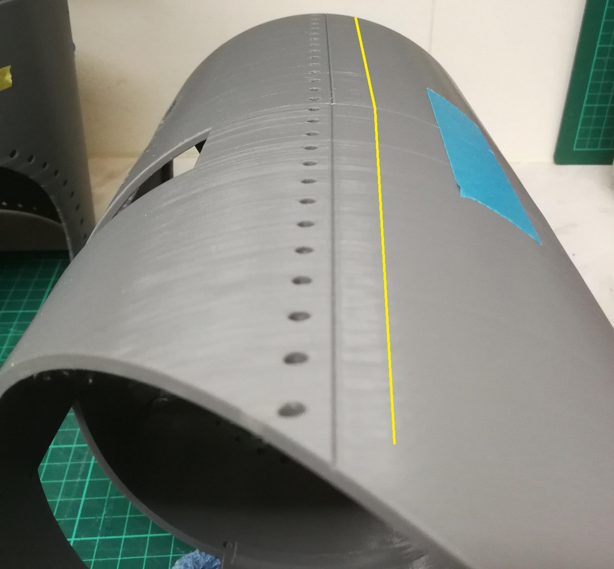

i have an issue with the tanks, i printed them in separate pieces, i just got the final one done this morning.
i noticed the line of rivet holes were not straight as they transitioned from middle to lower section then noticed the backs do not form a continuous cylinder but more of a crooked shape. the pics will explain it better hopefully.
since you have the most experience in printing these, did you encounter this at all if you printed in seperate sections?
if anyone else has printed any tank sections could you check and see if yours are ok or doing the same as i have?
it is on both tanks on my ones and in the same place by the same amount.
the pieces in cura 4.8 were seated correctly on the build plate each time as i'm quite careful to make sure they are.
have a look and see. if you can think of any reason this might have happened please chime in.

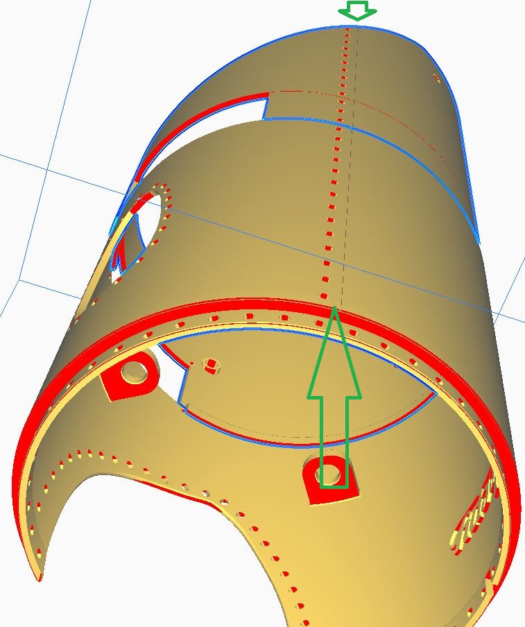

myself and gnolivos have both checked and the model is sound, just the prints i have are in question.
i assembled the model in cura and you can see the rivet hole lines are straight and true.
the left and right tanks

I've checked all my prints and I'm not having this issue. I know from all your posts that you are very experienced at 3D printing. Can I ask what materials and settings you're using? I've had some issues in the past with eSun filaments and I was getting some strange outcomes!

the nose sections are e-sun pla+, the darker sections are sunlu pla+...... i try to use good quality pla.
the actual prints are coming out great, just the odd imperfection around the rivet holes during travel.
the nose cones and middle sections line up great.
i could have printed them combined but i didn't want to risk it as its so tall. +(3 days)
215 degrees end, 55-60 bed.
had no issues the the filament beforehand, had printed out some xmas pressies with it.
do my pics explain what is happening clear enough? the only solution is to remove some material on the back just above my finger in the last pic.
i really don't want to re print it/them.
cheers

Your filament and settings seem fine. What version Veepy are you printing and I'll try and reproduce your results and hopefully narrow down the issue. I'll speak with gnolivos to see what might have changed from version to version. I'll keep you and the RPF posted!

The model is v1.03 the only one released. The cad has been triple checked as well as the STLs, (by me and by the person with the issue) and the sources are true and straight.
Something is up with the printing itself. If you have any ideas please let us know!

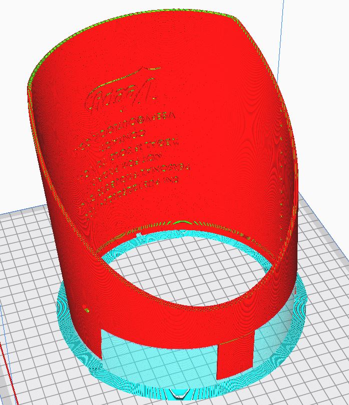

what orientation is the bottom section when you print and what supports and bed adheasion?
3dlac spray, works perfect every time.
all the parts printed very nicely, it's just the alignment that is all to pot. from what i have measured, everything seems to match from tank to tank.
