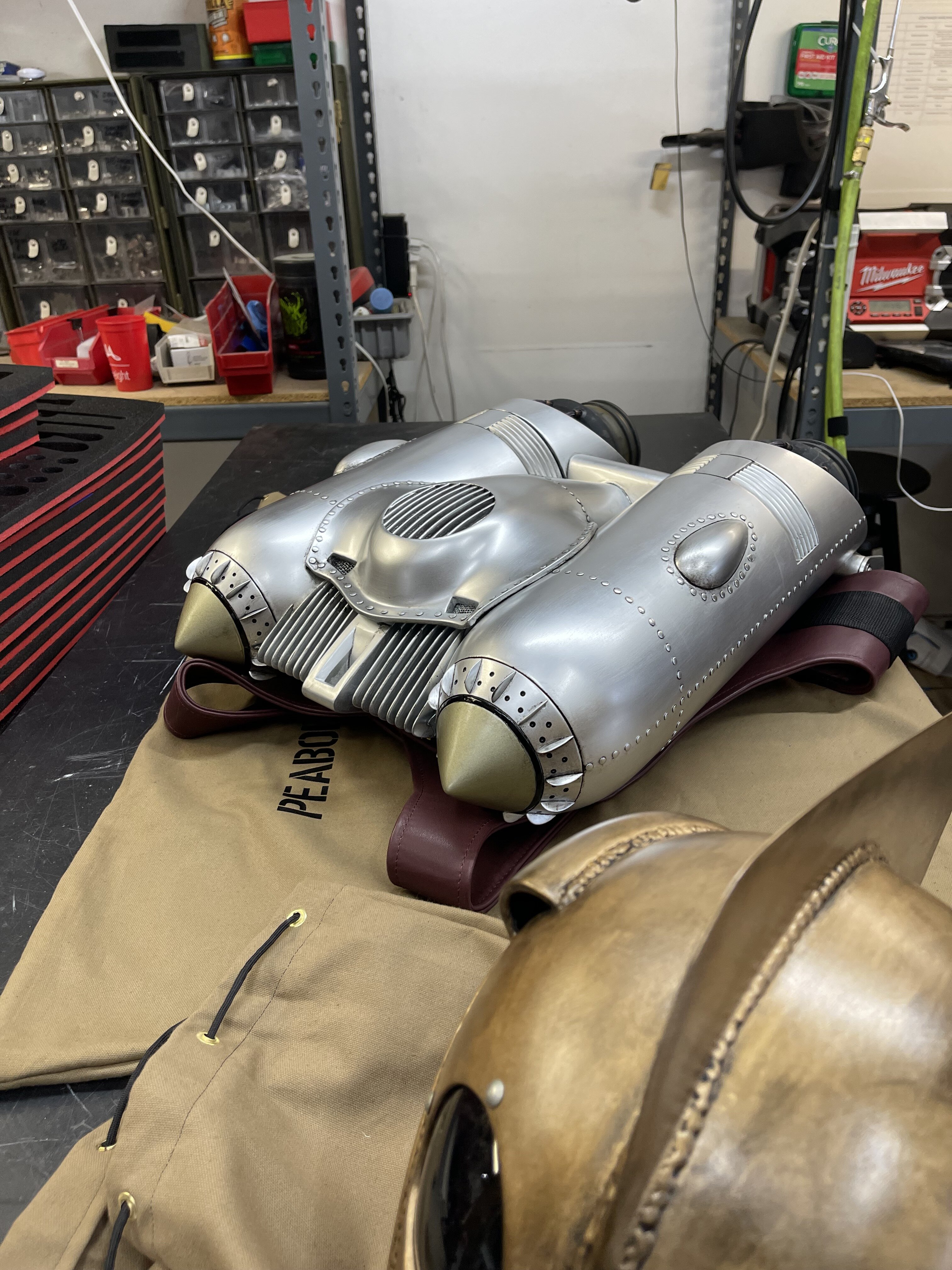

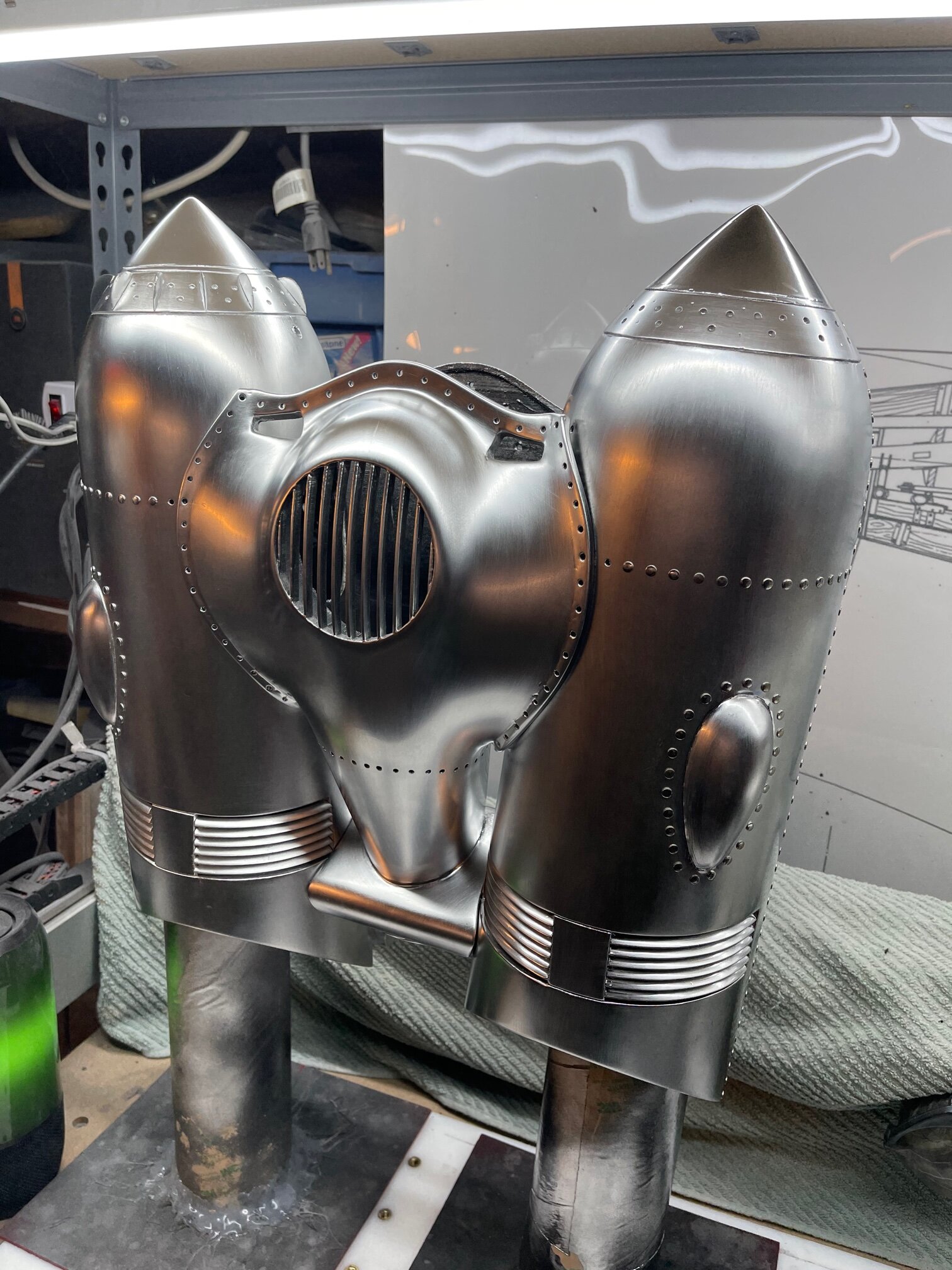

Hello and thank you for reaching out. First and foremost a ton of priming and sanding w/ high build primer. After you achieve a perfectly smooth surface and I mean perfectly smooth! Hit the body w/ high gloss black. Make sure the black is like glass before the next step! You might need color sand with multiple grades of ultra-fine sandpaper. Once there are no imperfections on the black paint you can start the next process and that is creating the "brushed" look in the base black coat. No swirls and no zig-zags! Up and down only!! Then apply Spaz Stix Ultimate mirror chrome. I've sampled all the "BEST" chrome paints and Spaz Stix was the only paint that gave me that perfect brushed aluminum look! Spaz Stix also has a high gloss clear coat for the chrome paint so it will not dull the paint!
Djh69
Member
What did you use to get the brushed look? Sandpaper (what grit) steel wool? So you brush the surface before you apply the spazstix?

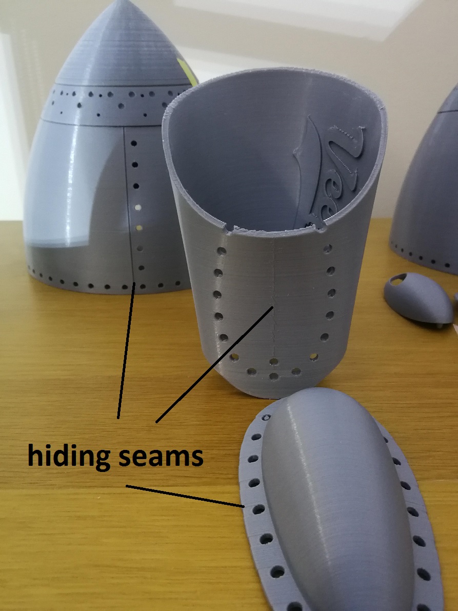

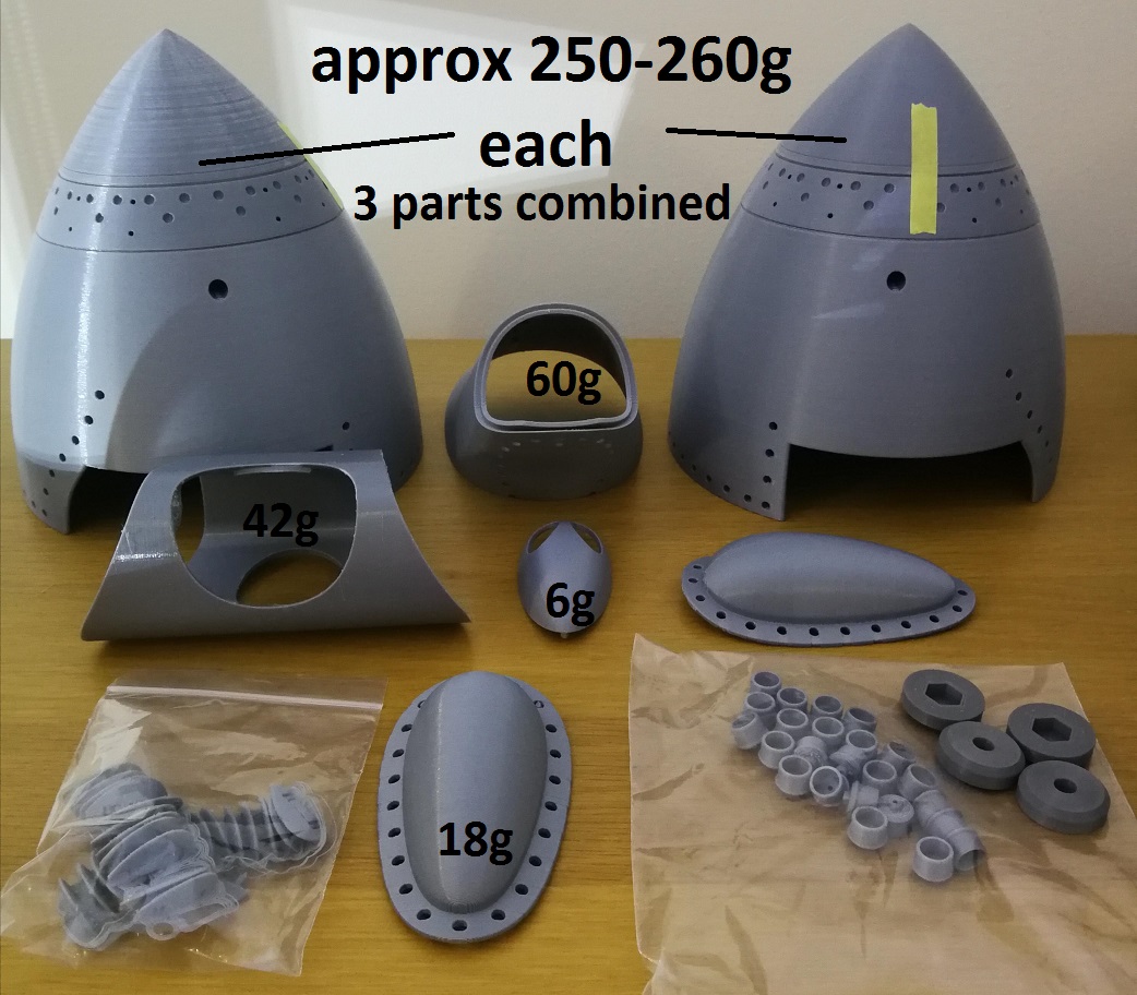

here is where i'm at right now, i got all this printed from a part roll of e-sun pla+ "silver"
creality cr-10 V2
55mm/s speed in general (35 for the little fins 0.12 lh)
0.24 layer height is coming out fine (for me)
stuck some weights on the picture incase you want a quick ref of approx weights to see what you can squeeze outta part roll.. its gonna be slightly different depending on your settings. these are post support weights.
i had to reprint the washers in sunlu grey as i wasn't happy with how they turned out.
i have also been trying to orientate the seam lines where they will be harder to see.
either blended into the existing seam or under other parts. or at the rear.
i printed the tank blisters standing up to avoid the layer steps.
i am printing 3 layer walls because i want it pretty sturdy due to the high G turns i expect when in flight.
