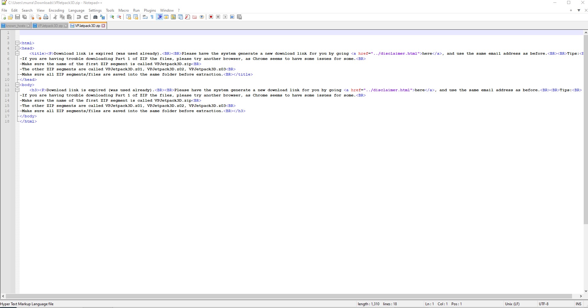

I'm still having major issues getting the downloads. Every time I try to unzip the first file, I get this...

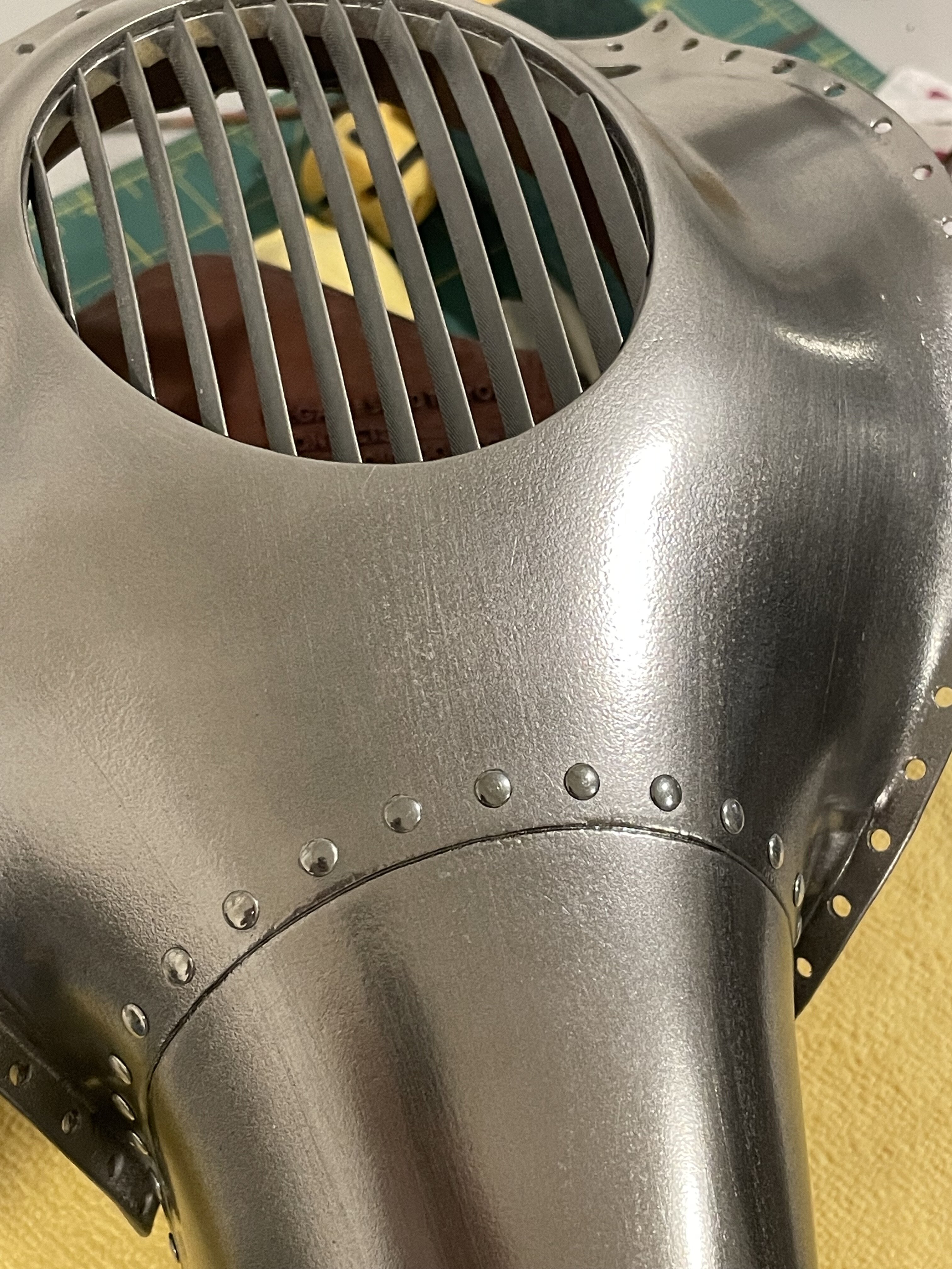

Thought it would be helpful to have a centralized paint thread for the Rocketeer Jetpack. As we all know, painting anything silver is always problematic (at least it is for me), especially for a prop that will be well handled. The saving grace for the rocketeer pack is that it’s more a brushed aluminum than a shiny chrome, so a decent silver automotive paint (or the like) should suffice.
There’s a bunch of info scattered around other build threads so it would be great for everyone to post here as a resource for future builds. Please tell us what brand of paint you used, what color you selected and any tips of tricks you learned along the way. Of course a pic or 2 of your finished Jetpack is a must so we can see the results. Paint tips for the helmet are also welcome.

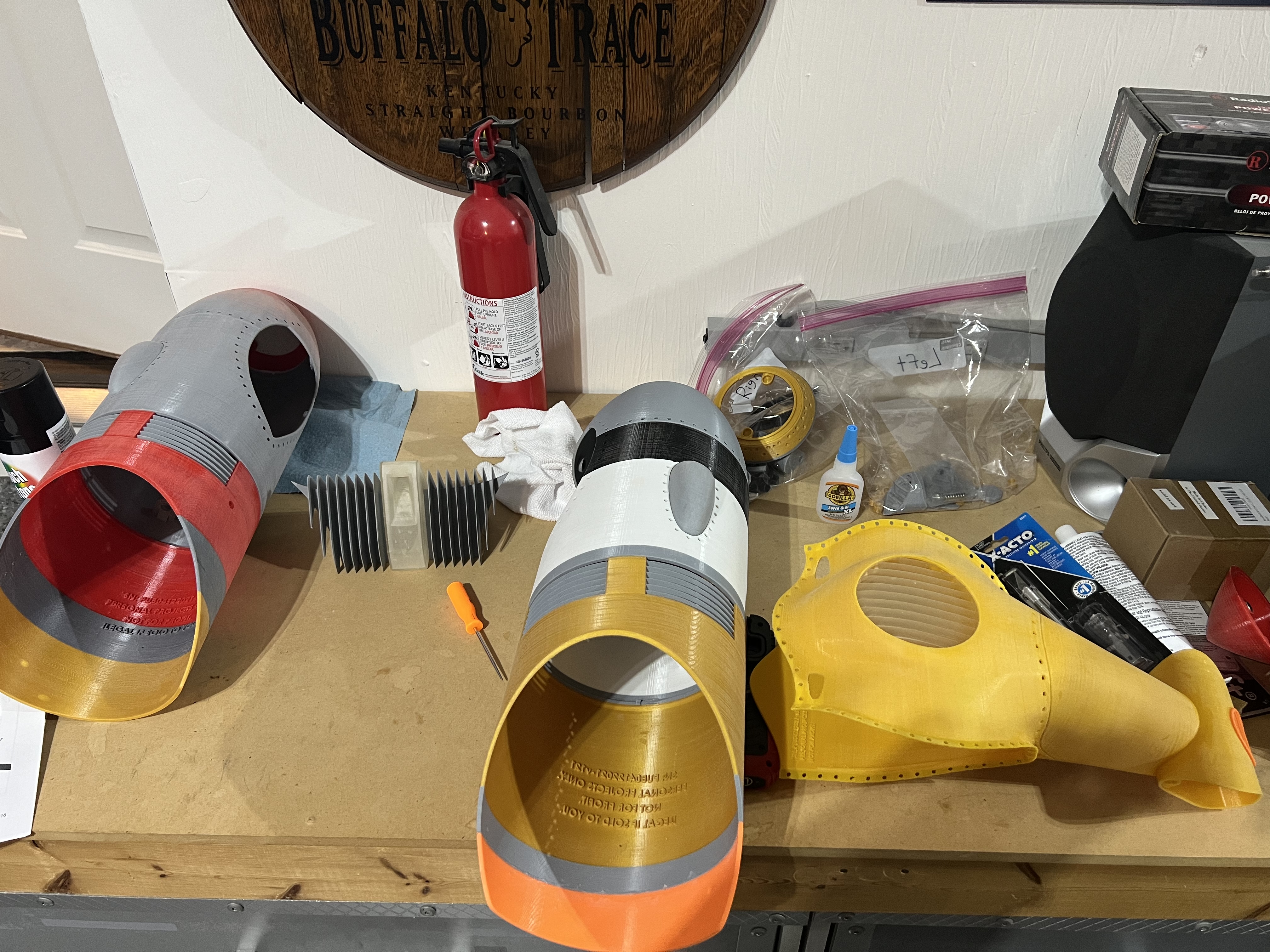

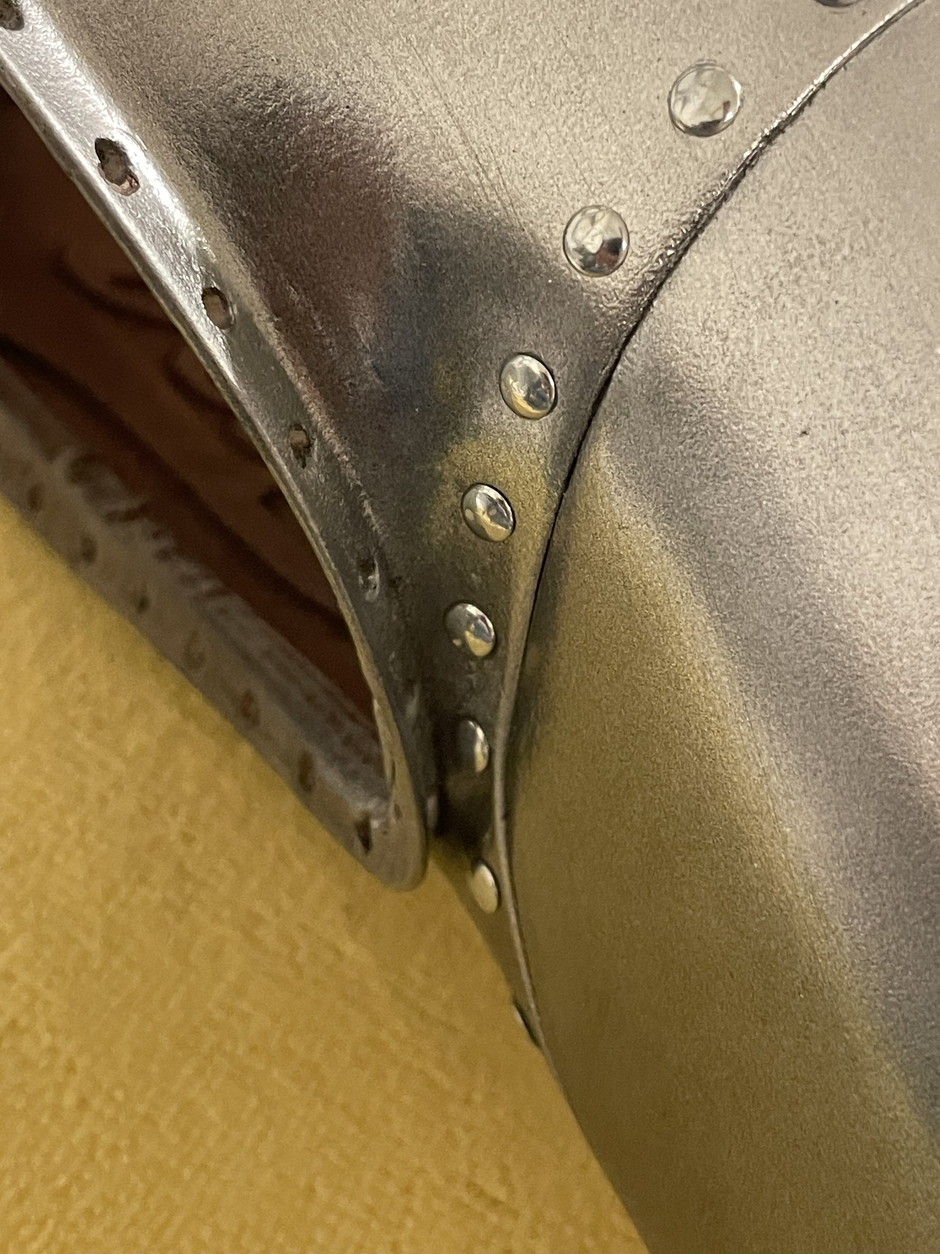

So I'm looking at tips on how to glue the rivets without making a mess.
What have others done? I unfortunately enlarged the Rivet holes with a dremmel, so a friction fit is no longer possible for me. I'm kind of stuck now. Ideas?

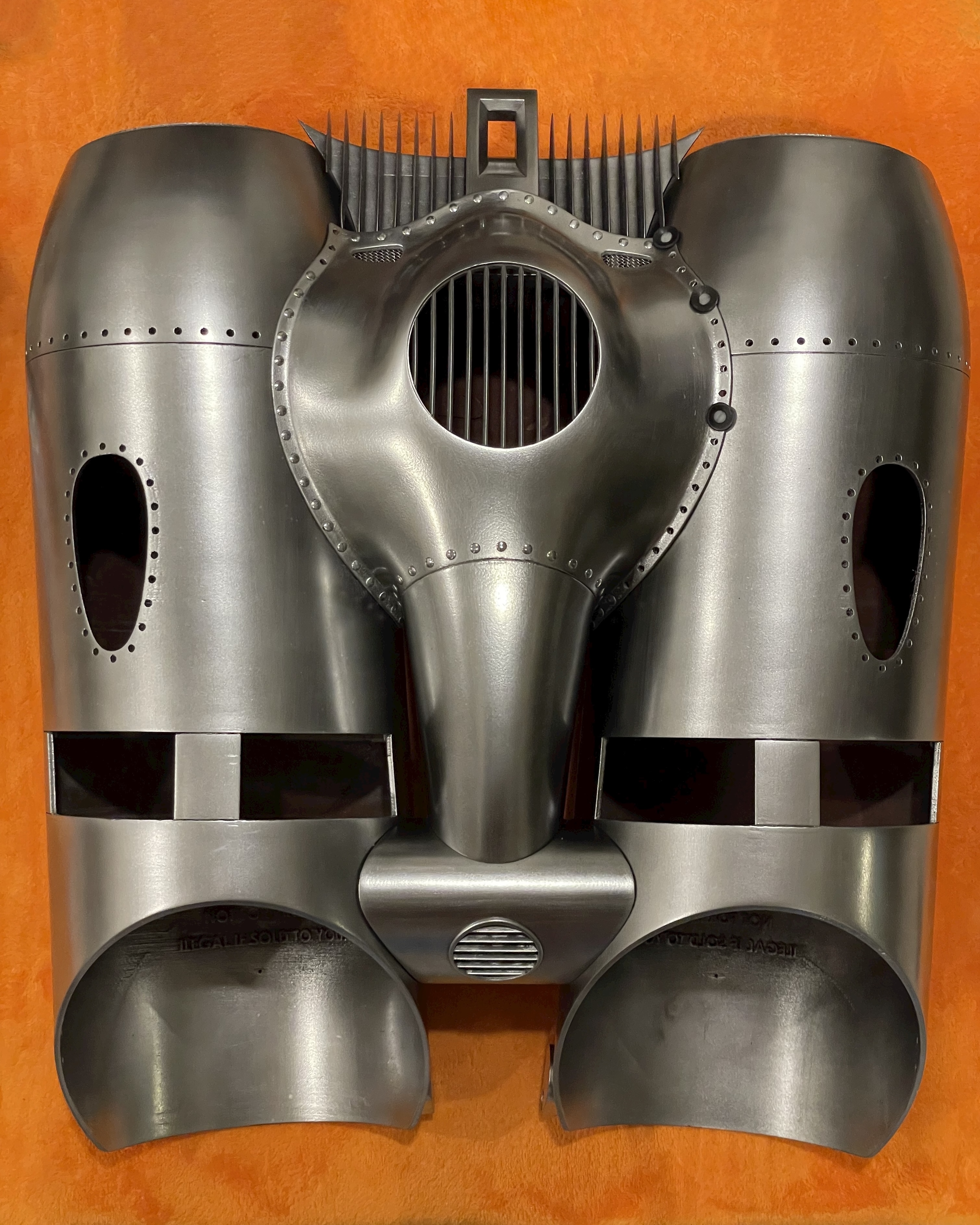

gnolivos posted a response to a paint question: "I use Spats Stix chrome paint. They also have a clear coat finish that barely dulls the finish at all.
It's not a hard finish; it only protects the paint"
I think that this is the best way of painting this prop. The metal look is spot-on:cool::cool:(y)(y):notworthy::notworthy:
I don't think I've seen this prop being painted professionally in a auto body shop...but I could be wrong.:unsure:
