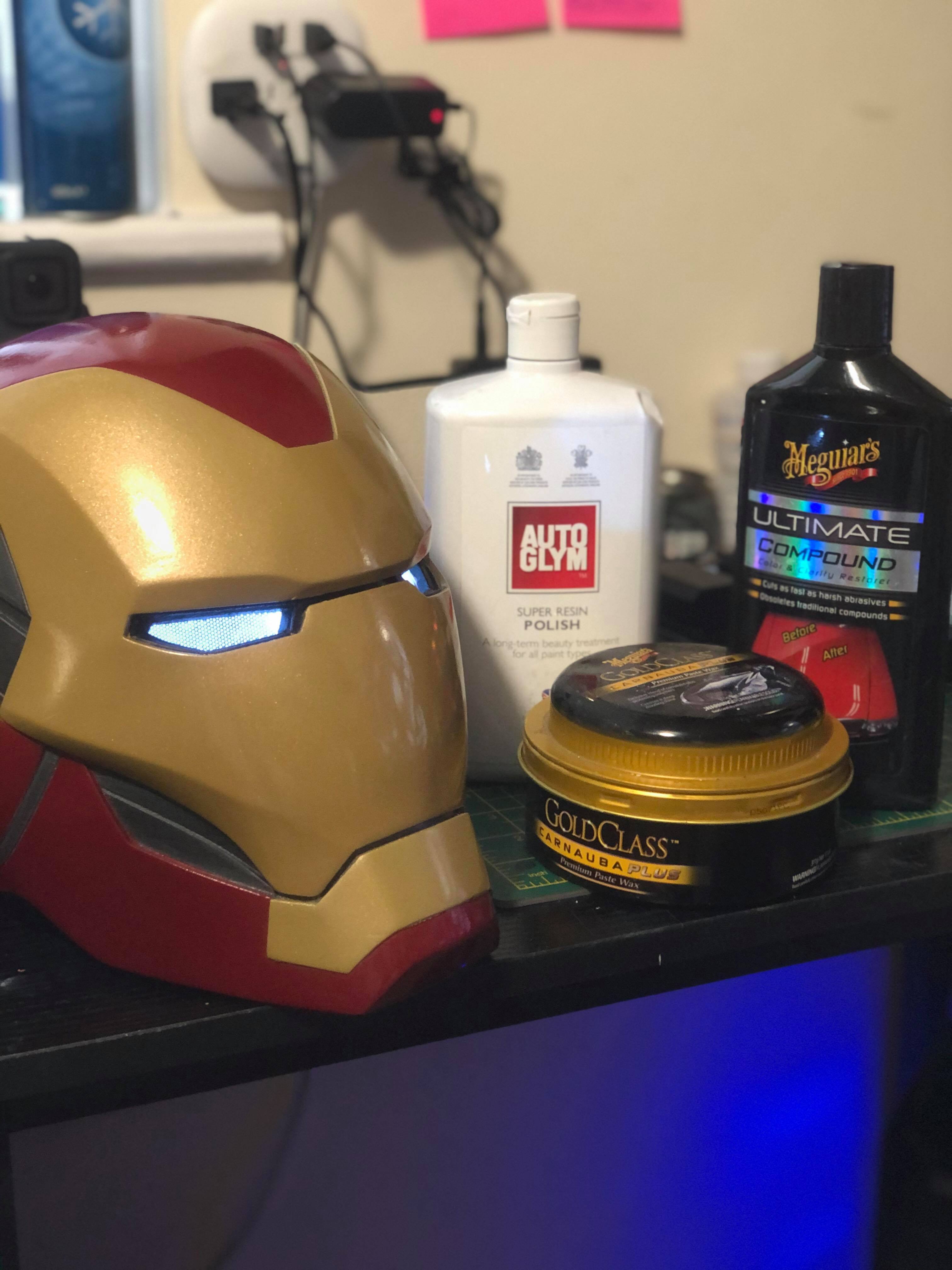

After all of the painting and clearcoating was complete i actually went over everything with automotive grade polishing products (Meguiar's sponsor me please!)
This really brought out that deep shine the lacquer had to offer. I started with rubbing compound then moved onto a resin polish. Followed by THE BEST smelling car wax ever; Meguiar's Gold Glass. It also helped add a small small small layer of protection from grime and dirt. Maybe. Probably. But hey isn't it shiny?

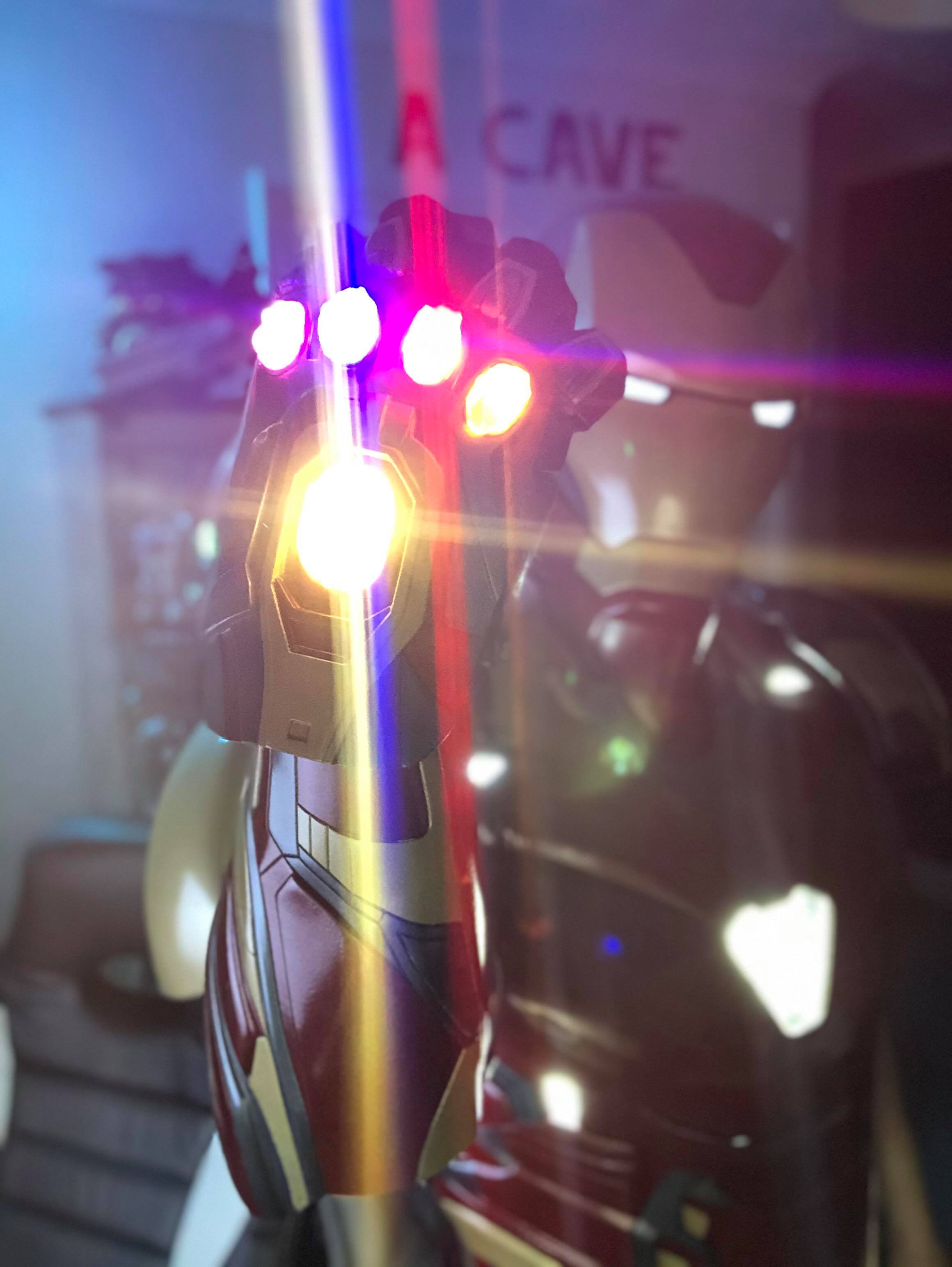

The Infinity Stones
Few words can describe just how proud of this thing I am. It was the focal point. The centerpiece. The main attraction.
The process and idea was actually pretty straight forward. I saw people who had just 3D printed colored stones. Or people who printed stones in clear PLA plastic and backlit them with LEDS. Well the Infinity stones aren't clear. I wanted them to look nice on and off.
Step 1: Print the plastic masters of the stones to proper scale and make resin-safe silicone moulds for them.
Step 2: Buy way to much resin dye and spend a few days testing different colors and combinations. Find the best 6
Step 3: Mix some clear resin with the resin dye and pour into the moulds. Let sit for 6 days because you didn't use enough hardener.
Step 4: Pop them out and let them sit even longer because damn; you really should've used more hardener.
Step 5: Install and backlight the Resin Stones with color specific super bright 12V SMD lights so you can down passing aircraft from the ground.
Step 6: Don't Snap. Ever.
Could the Mind stone be a little more yellow? Could the Soul Stone be a bit more orange? Yeah. But i'll live. I'l still super proud every time i look at them.
