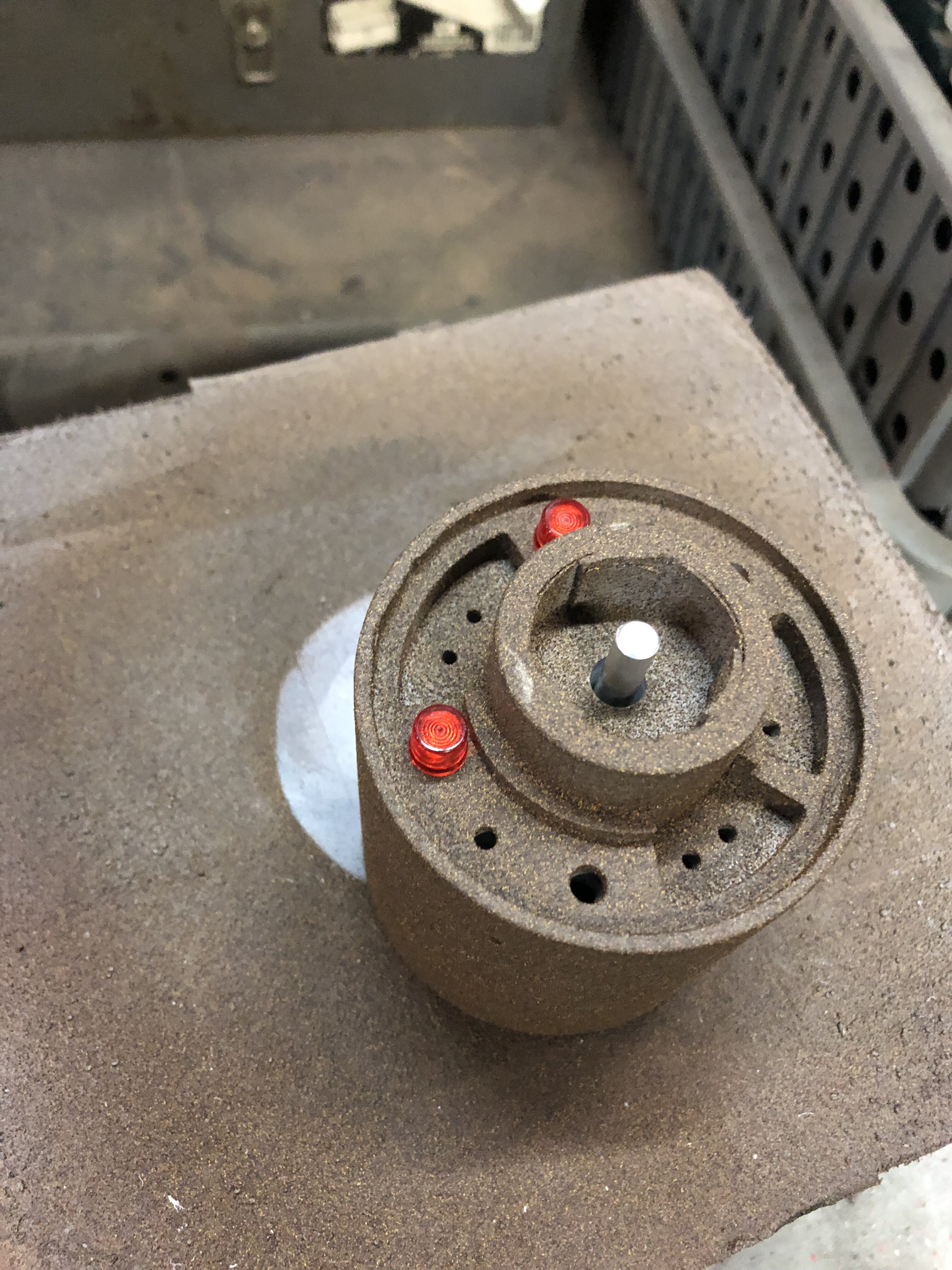

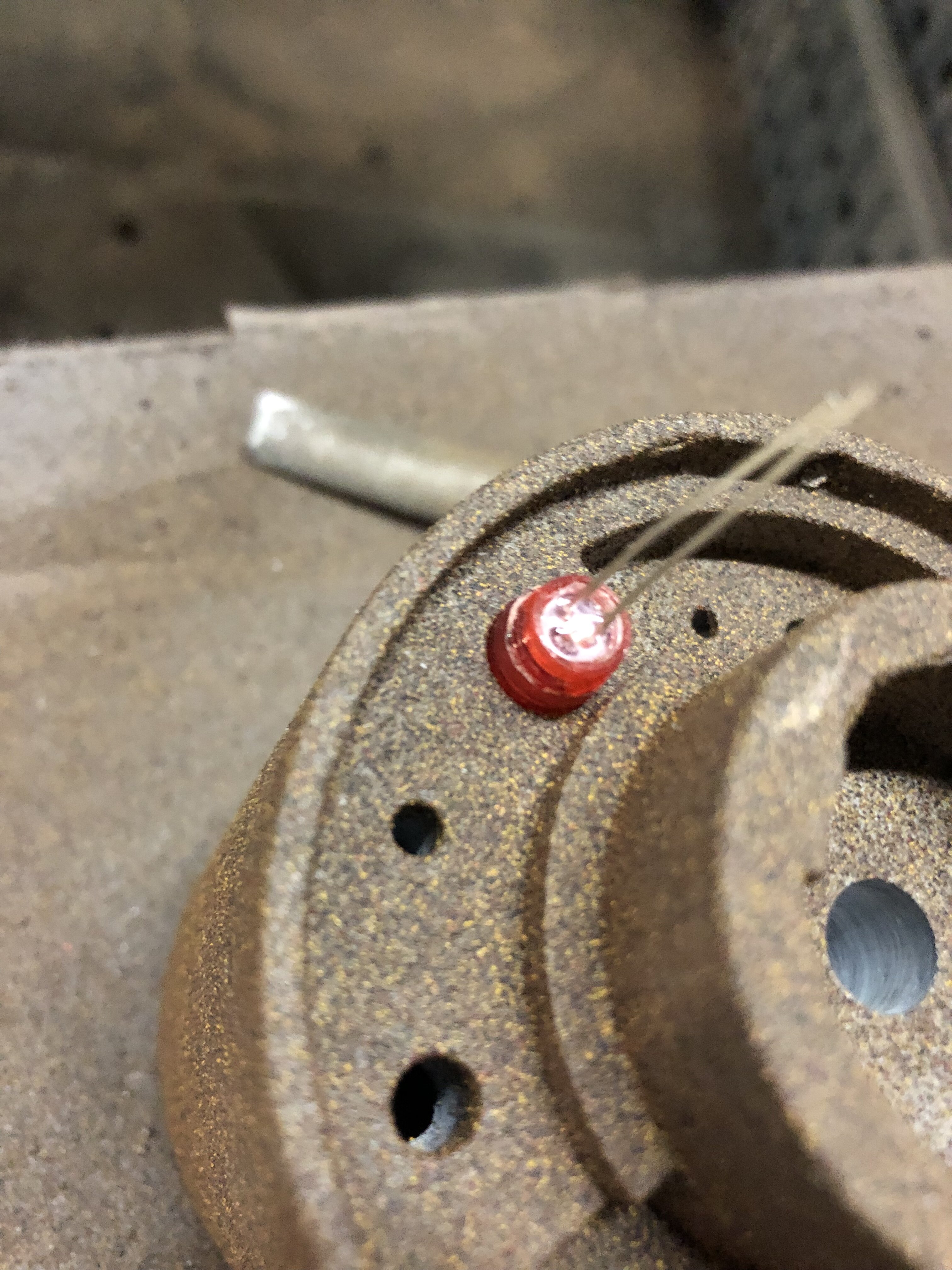

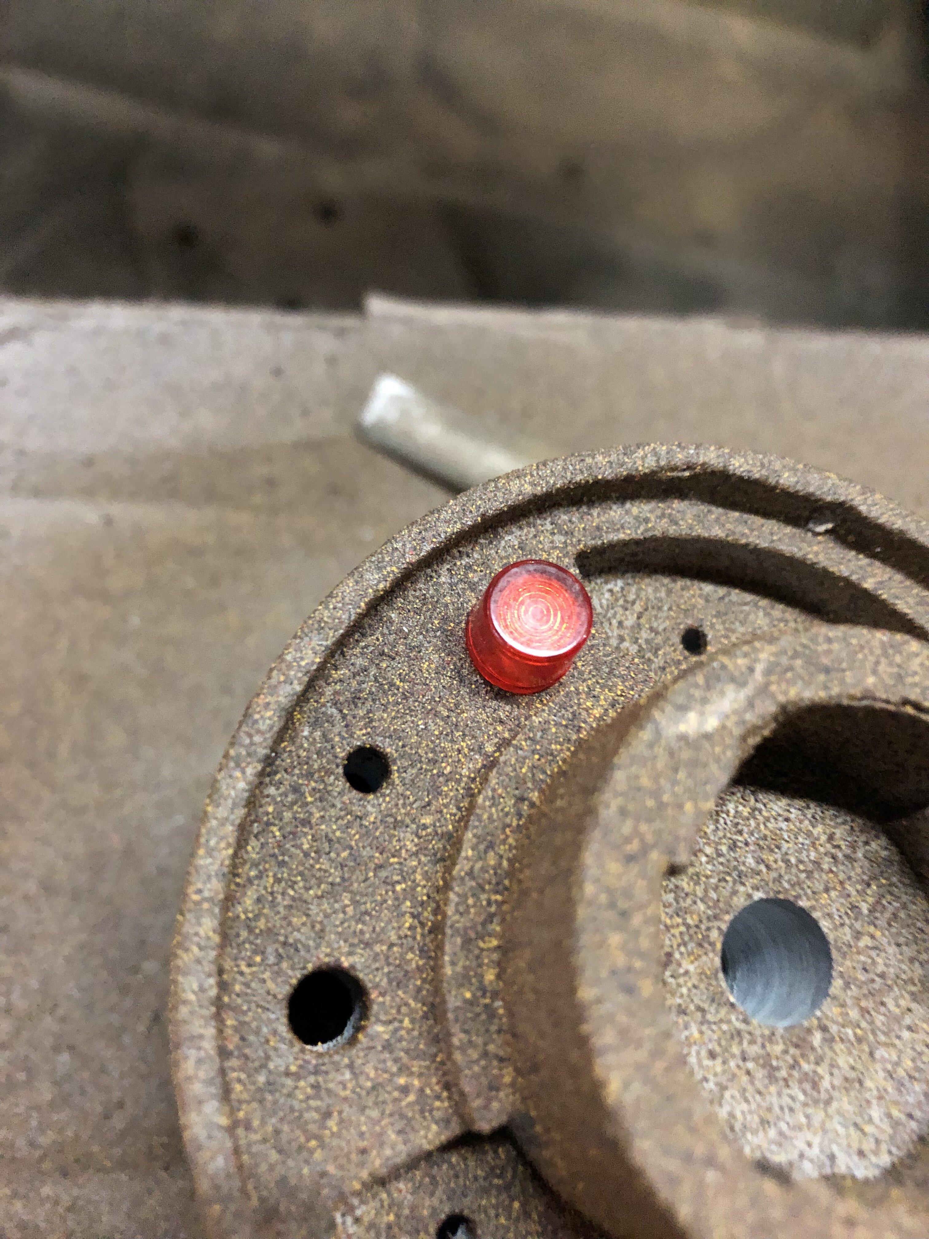

glued the LEDs into the lenses. Perfect fit.
Put an o-ring on the pot shaft to give a bit more resistance.
Drilled to pass the wires in.
Testing! I may get a dropping resistor… these are bright, even with the lens on top!
Here I’m filing the small flange off the bottom so they press into the hole.

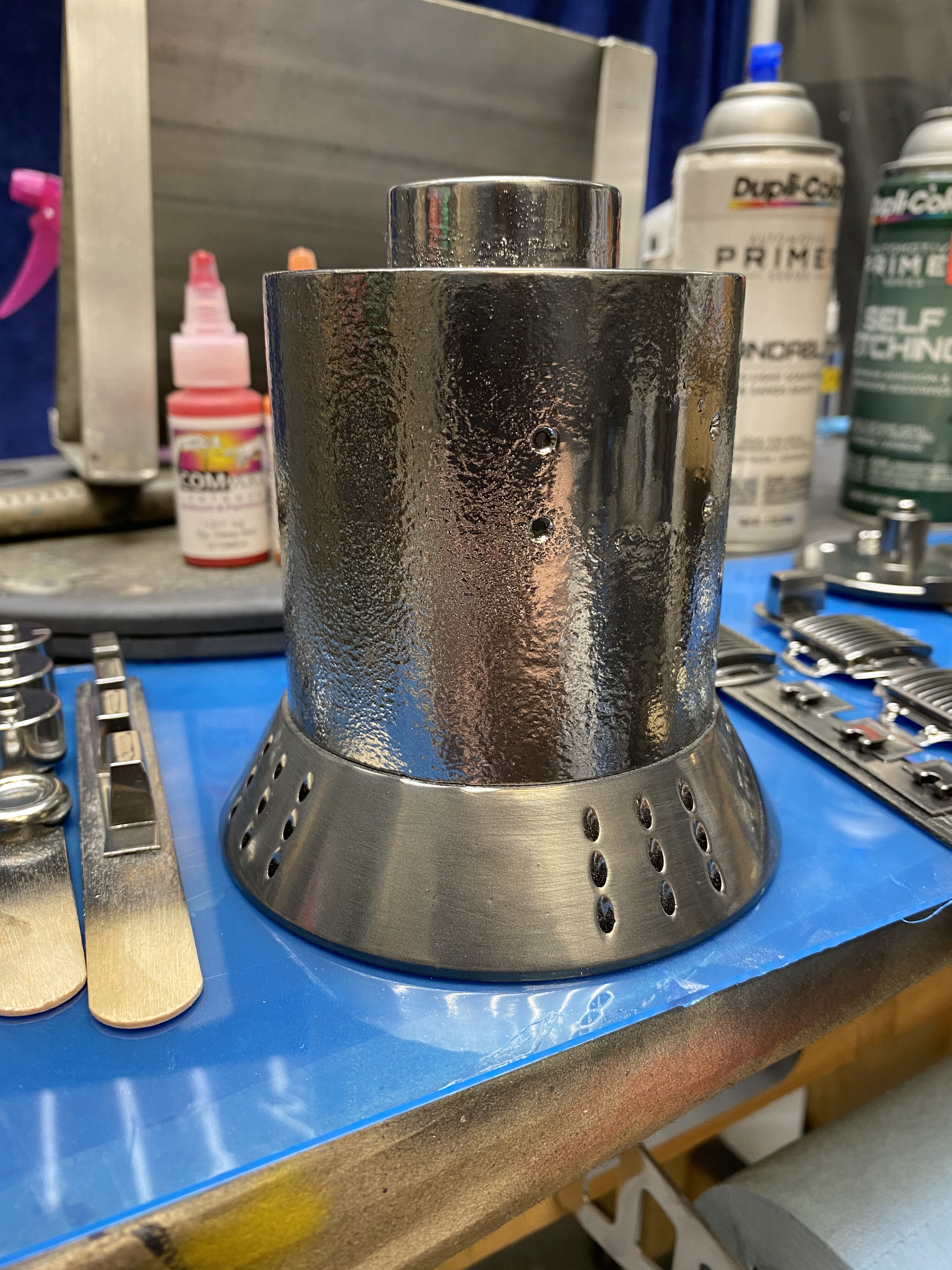

I’m getting everything ready so I can paint the main body.

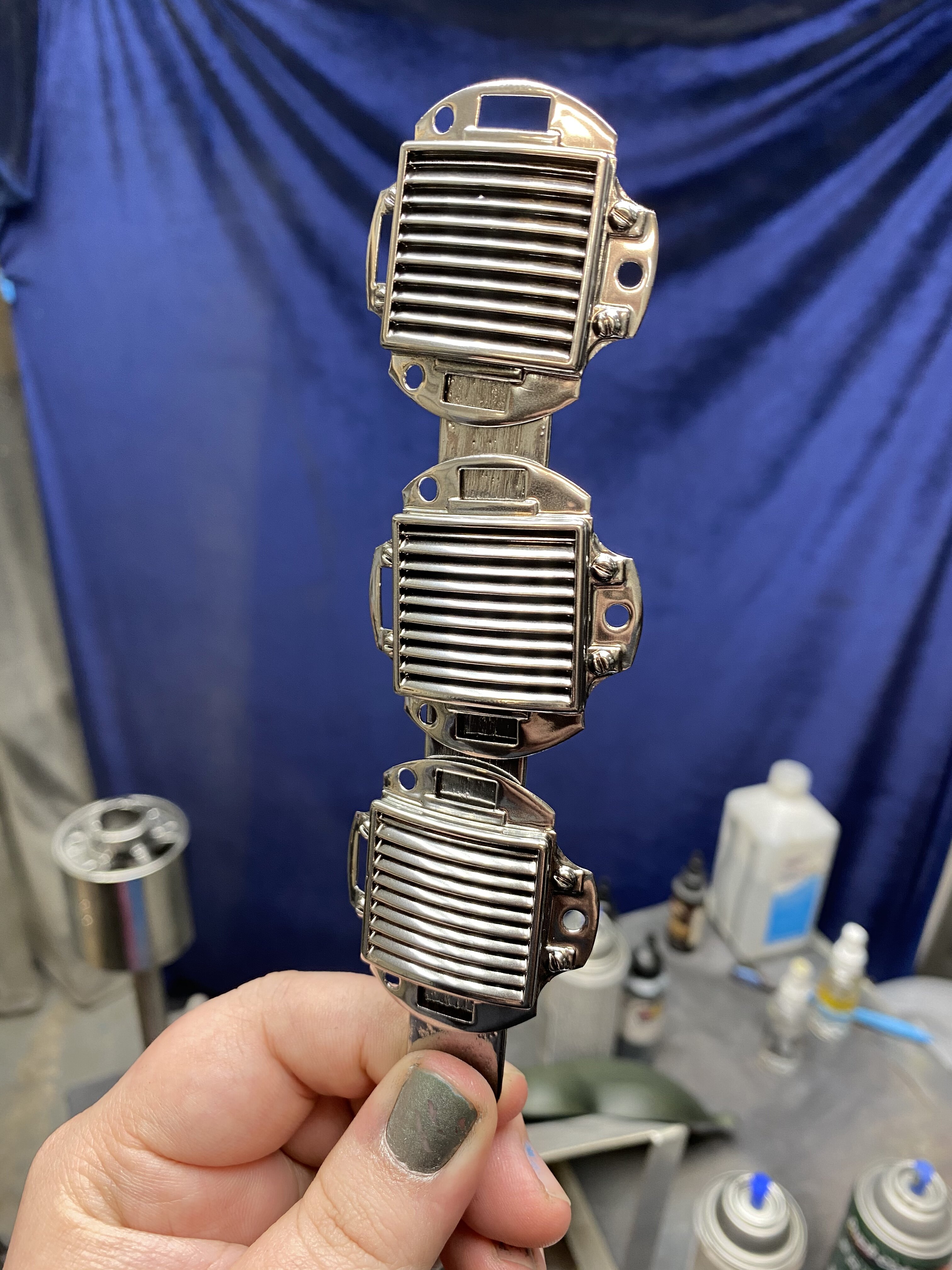

spraying the silver bits…
They look good from ten feet!

Lights are installed. Friction fit but they won’t fall out.

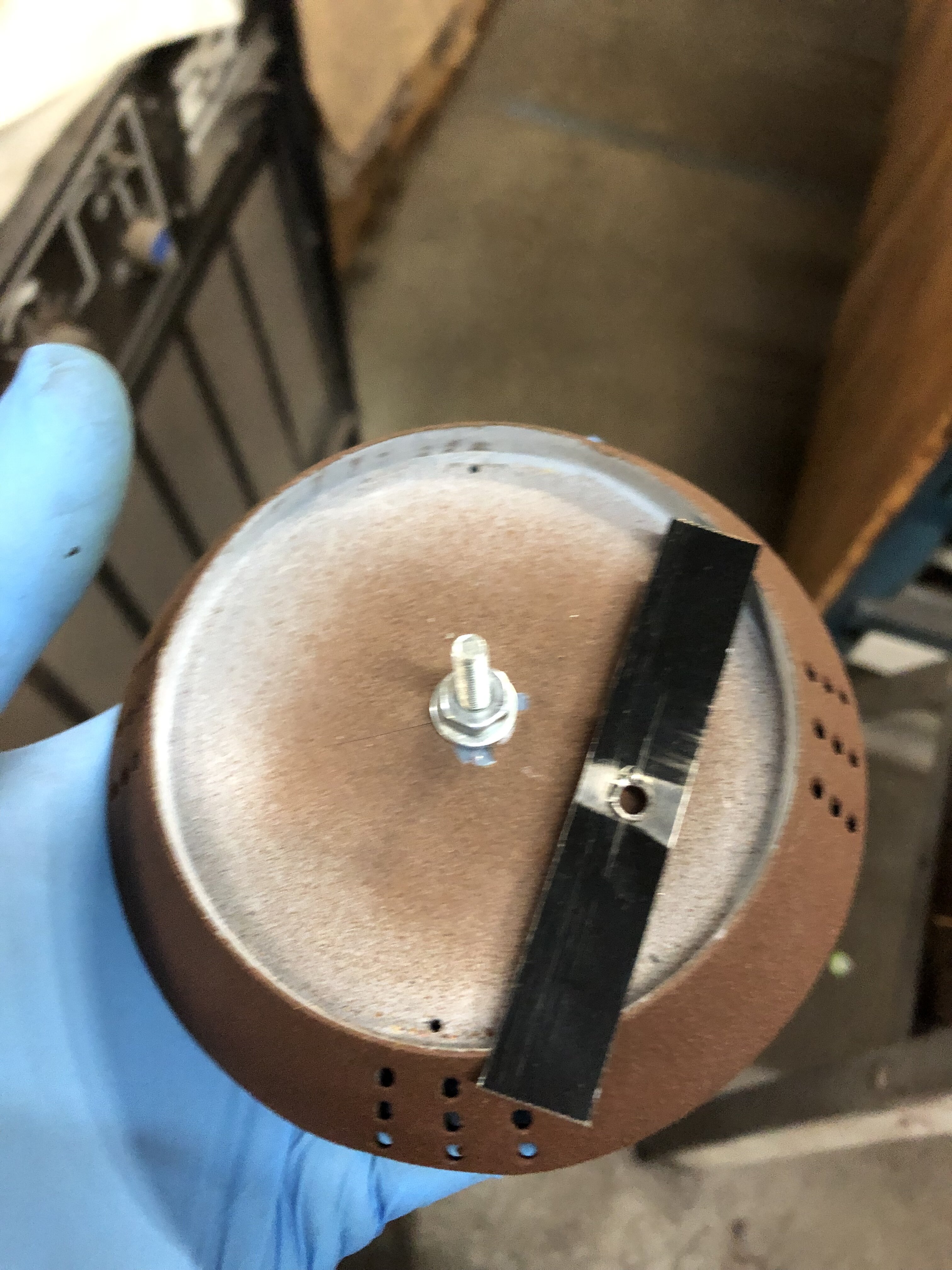

The final hurdle is attaching the skirt assembly to the main body. I can’t just glue it because I’ll have to change batteries at some point. There is a long bit of the center screw sticking up I thought I could use but I haven’t figured that all out yet.
Maybe if I drill a hole in a piece of spring steel just a bit wider than the ID of the body I can attach it to the center screw and then slide it in and it will bind and hold it together… or it will shatter the main body.
I have Velcro pieces that maybe I can make work.

Here’s my attachment solution. It works.
wiring made more socially acceptable.
Side view of the assembly clip thing.

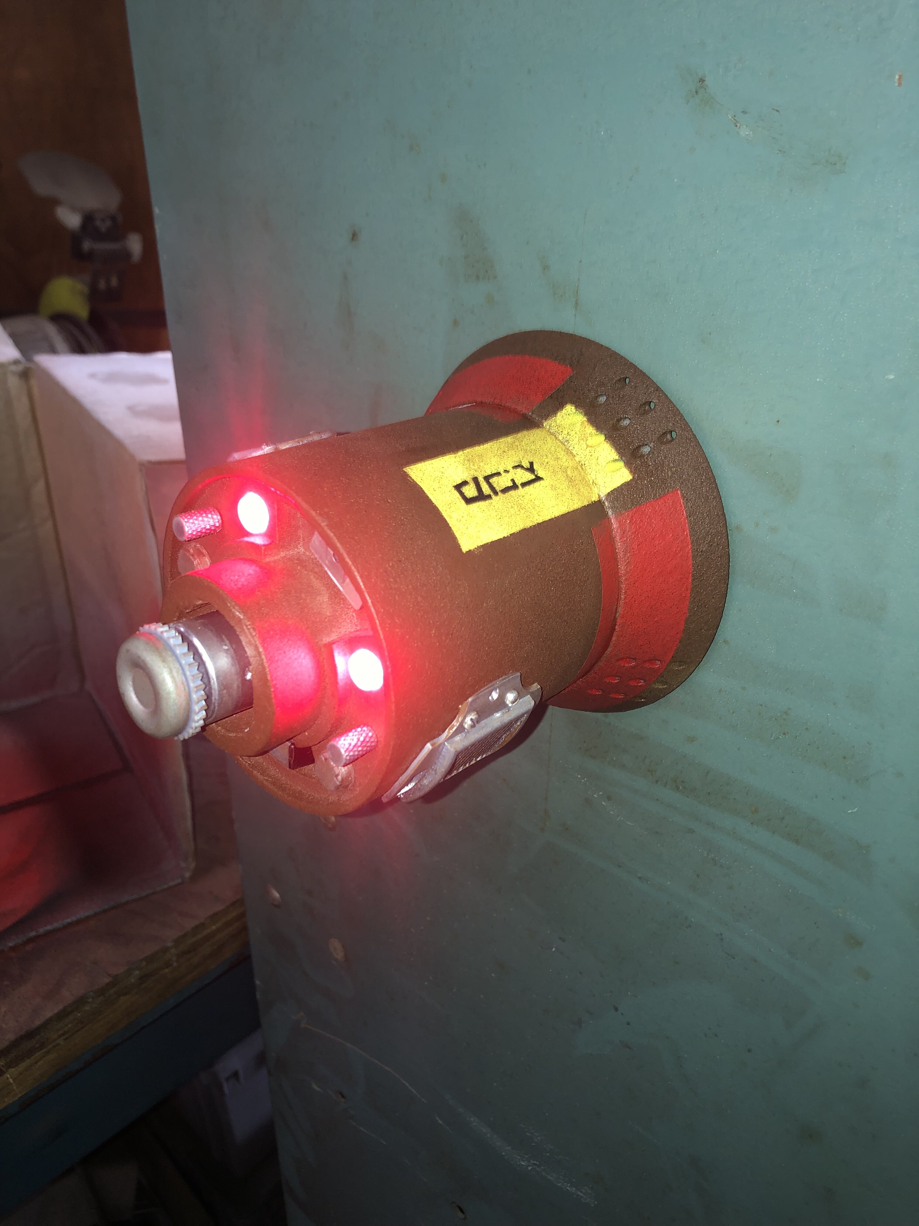

It still holds, even with the added weight of photon emission!
And here’s where we are at now. Just the color panels left to do, the text and some weathering. Maybe a few orange dots on the top edge…
Overall, I’m very happy with it. I had a vision of the “clicks knob” activating the lights, and I have it! Four clicks- 0,1,2 position just click; 3 turns on one light and 4 has both lights on.

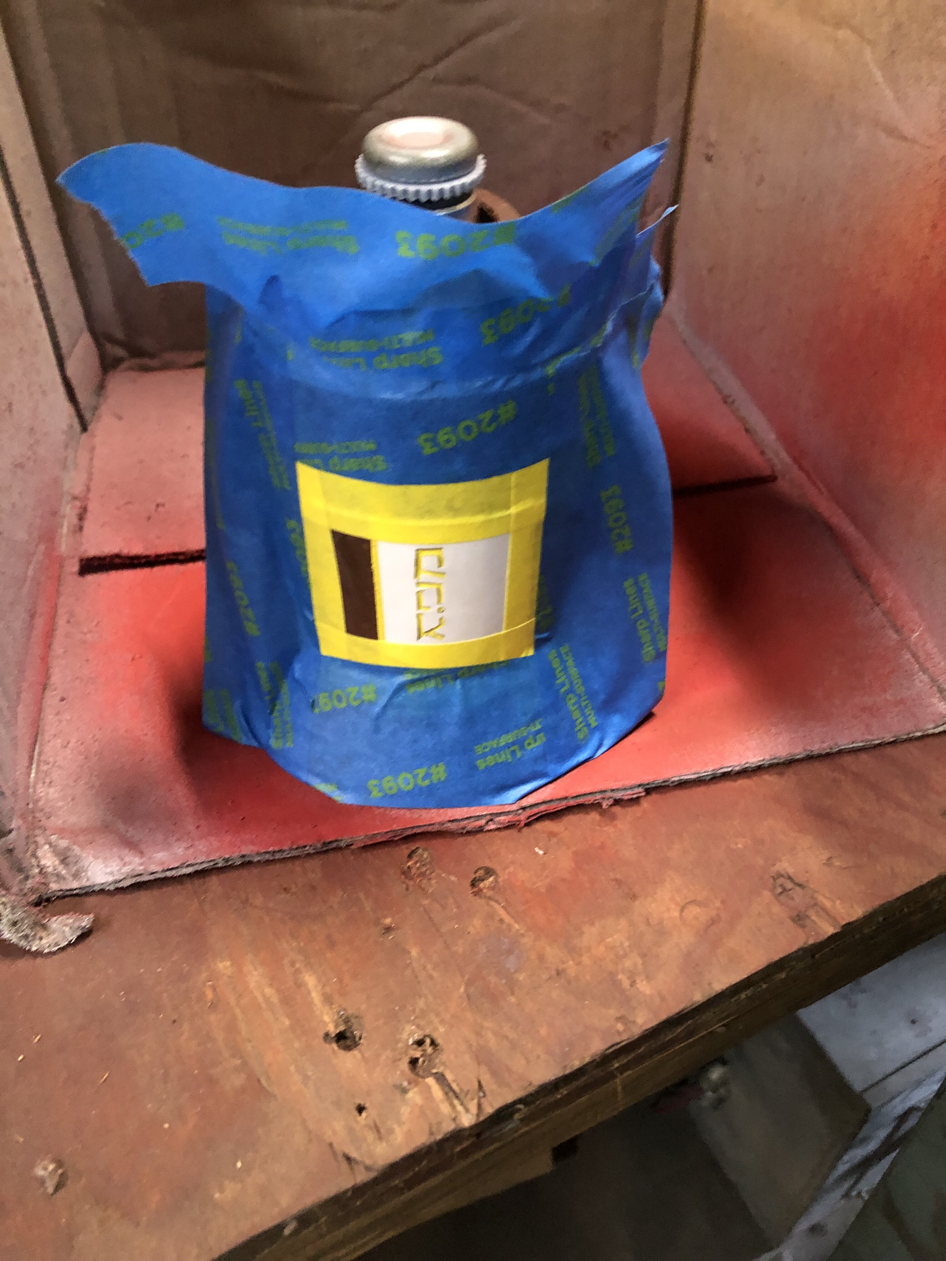

Started the stripes today. I made the stencil for the “lettering” too, but it’s too big, so I printed another.
authentic color bleed…
spray into the cap and cut in the edges with a brush.
Marked the correct side, and correct orientation of the stencil… then figured out it’s too big.

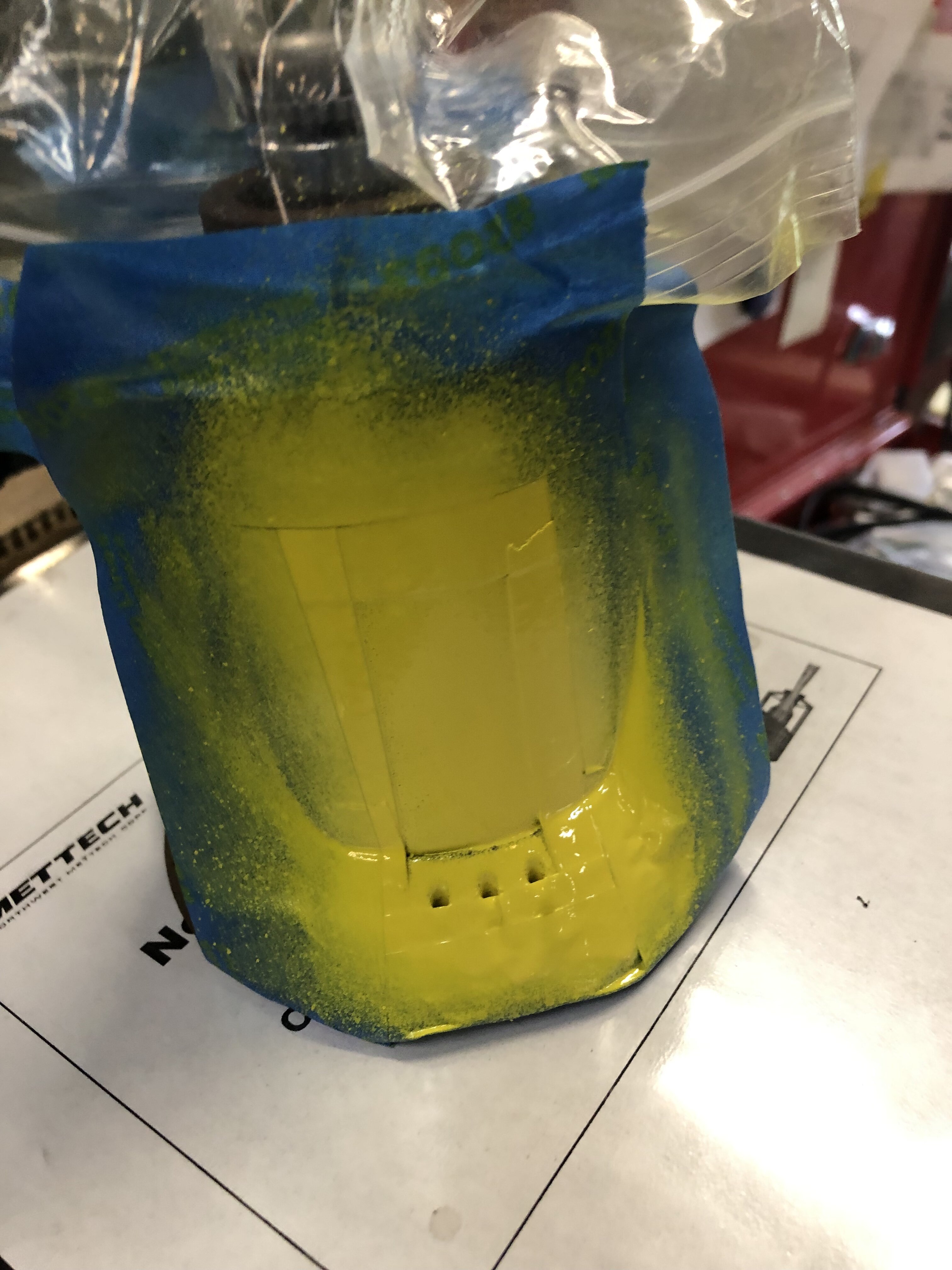

Masking a “straight” line on the skirt- put it on a plate and put a spacer under the blade. Drag it around slowly and… straight!
applying the antique flat red. This is an old can of Testors (used on my snow speeder stripes) from 20+ years ago. Still smells the same!
Done!

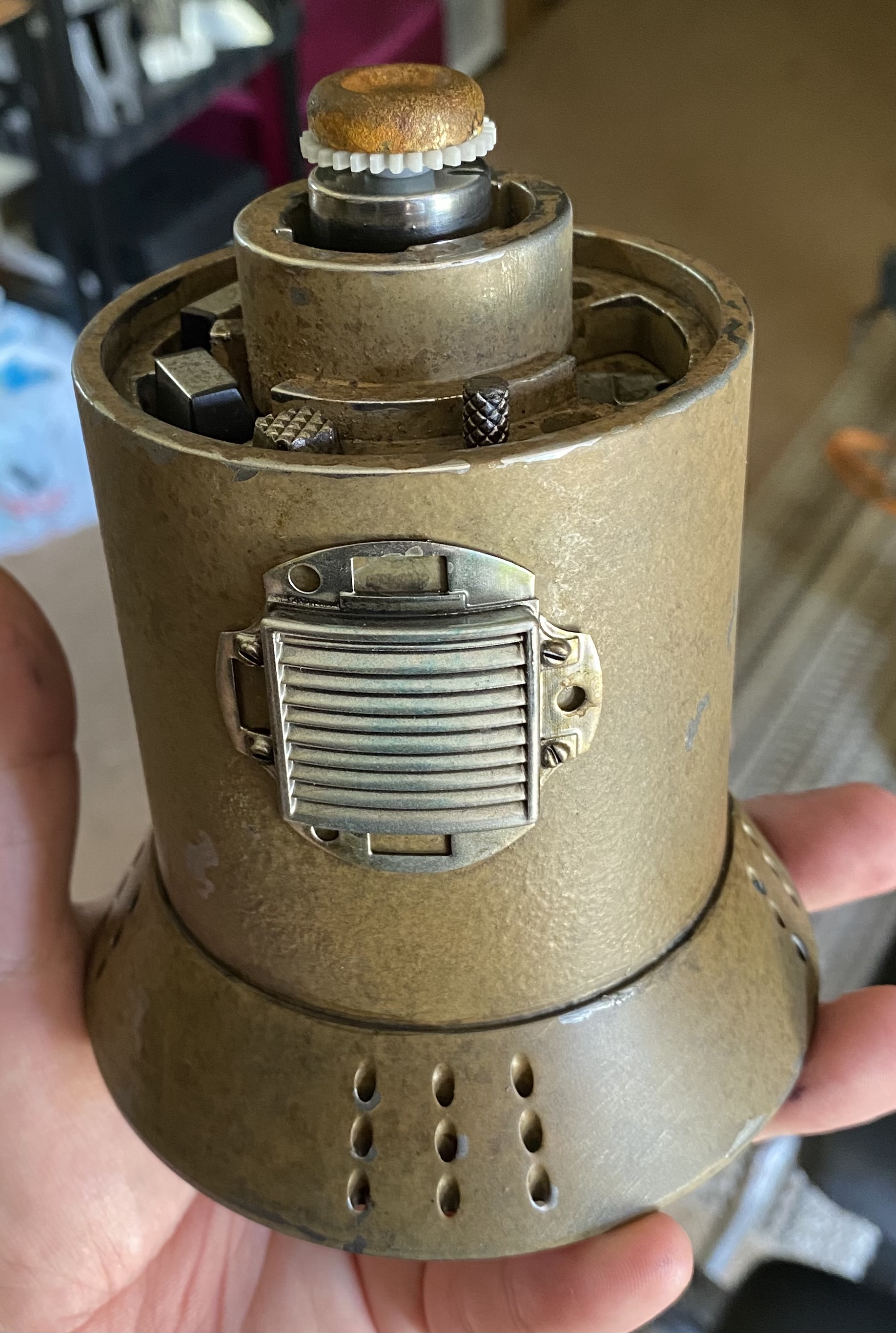

Figured I’d share my current WIP on one of these bunker bombs. I printed this on my Elegoo Saturn with files from FolkyPatrol on Etsy. I’m just waiting for the red paint from Archive X, and then I’ll paint the red and yellow stripes and finish up the weathering on this one.
I’m working on three total. Idealized with a “metal” base (above), idealized with an orange base, and finally an “accurate” one. I think it will be a cool set to see together and I’ll definitely snap and share some pics when they’re done.
