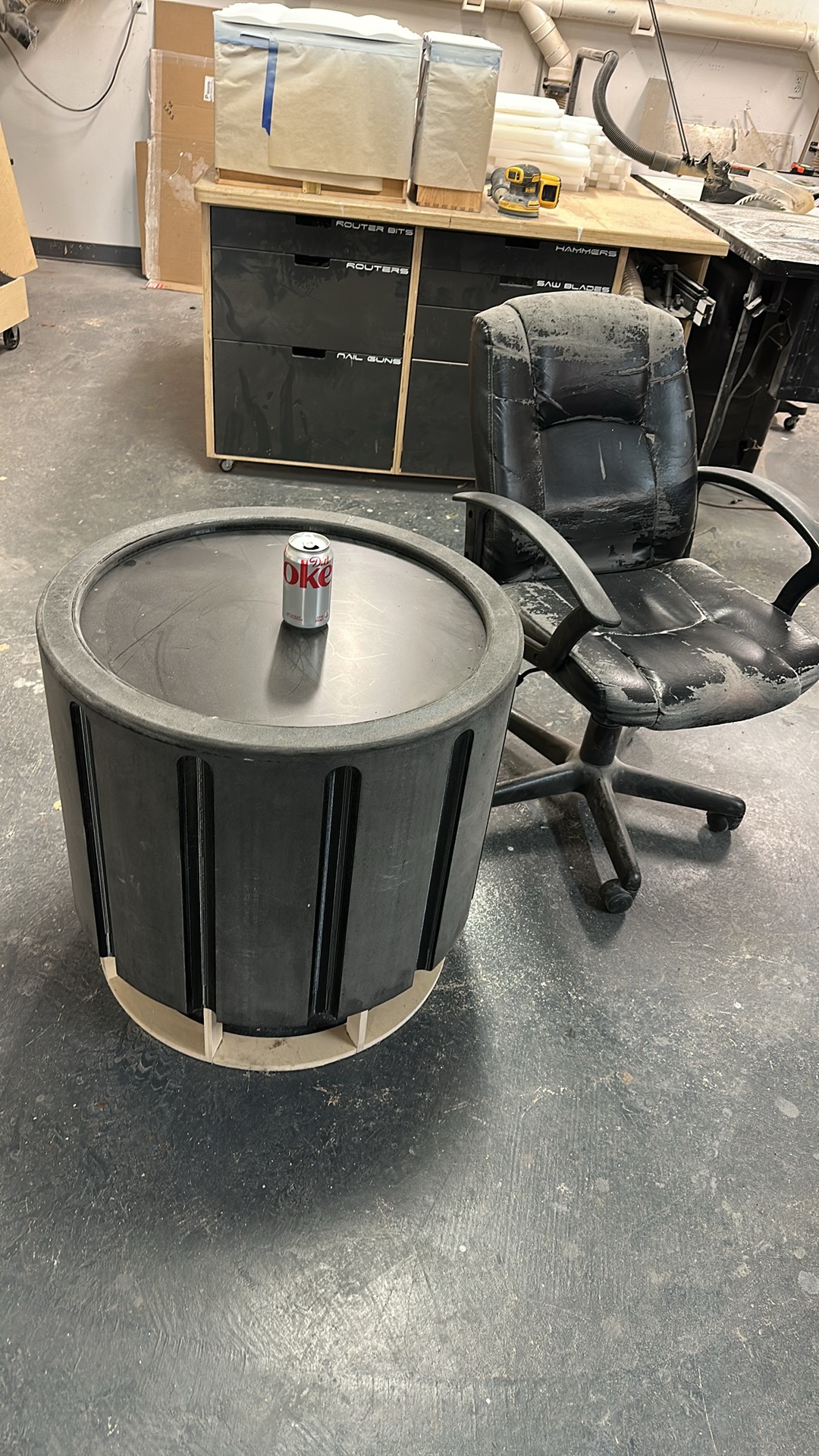

That’s what this is gonna be. In the cantina it was much higher. I can going to make it like a small table you put between two chairs. About the size of an end table. This is 26” in diameter and 26” tall in its present form. I can change diameters and heights. Already thinking a lower version for a coffee table would be cool. Just need to get my wife on board.

The general height for a normal table is between 28" and 29". I think that the receding base is higher than 2". So, 26"tall is too much IMO;)

I might be at the taller end, but I am a tall guy too. If this is too tall when it’s done, then I can use it as a display stand make another.

What size printer do you recommend to print these end tables?
I bought one of the Elegoo Orange Storm Giga printers that does 800x800x1000. It’s why this project is happening now.
I had a few labor intensive solutions to making out of wood and then making a fiberglass mould, but never followed through due to cost.
This is about 8kg of filament to make this one table. So not as costly as the other method.
-Eric

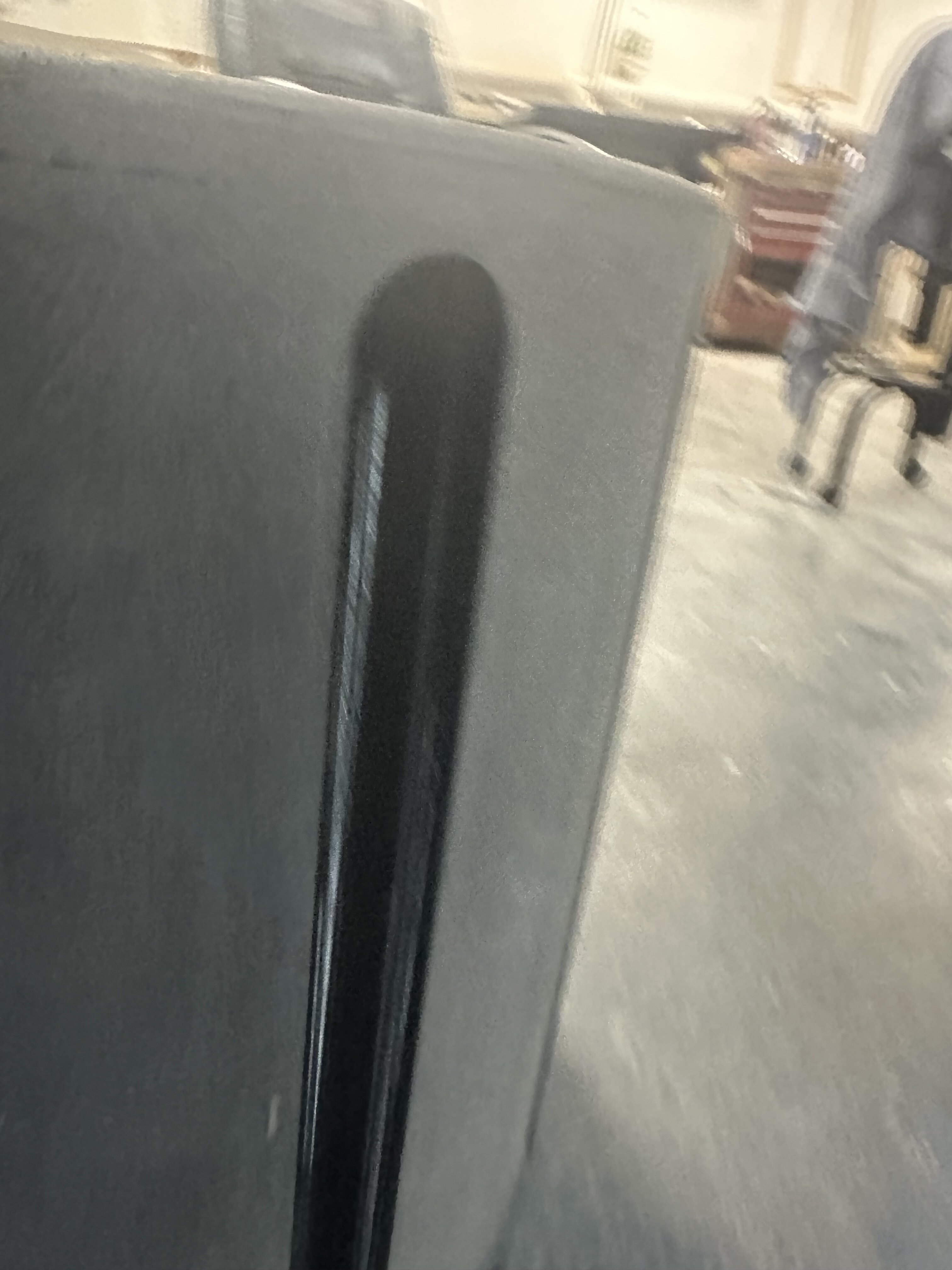

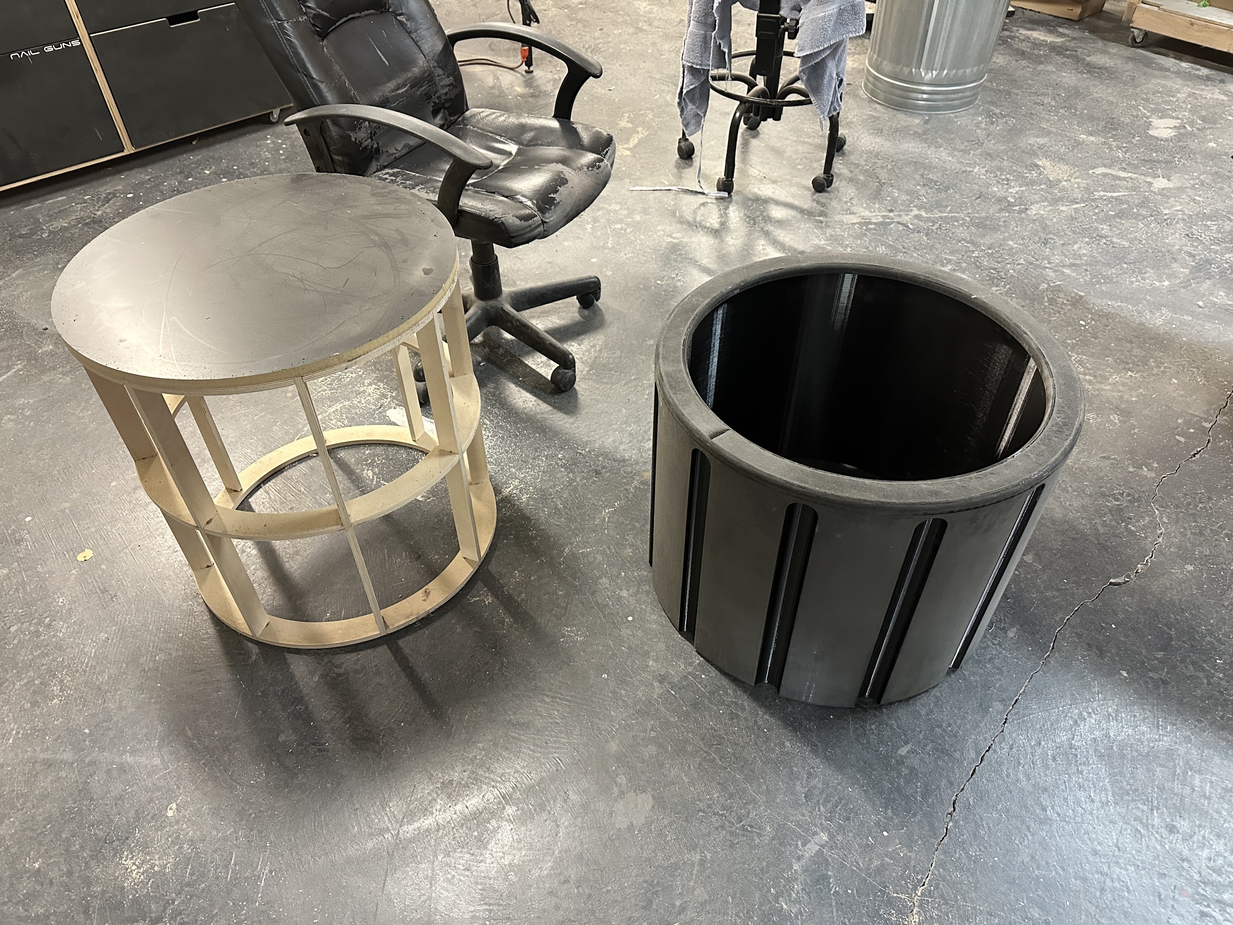

Double update today. Sanding underway on the print and the table base is made.
The outer walls are easy enough to hit with an orbital sander, but the grooves will need to be done by hand. The printed piece slides over the base for inner support. I need to cover the bottom for the toe kick which will also provide extra support to the print.
