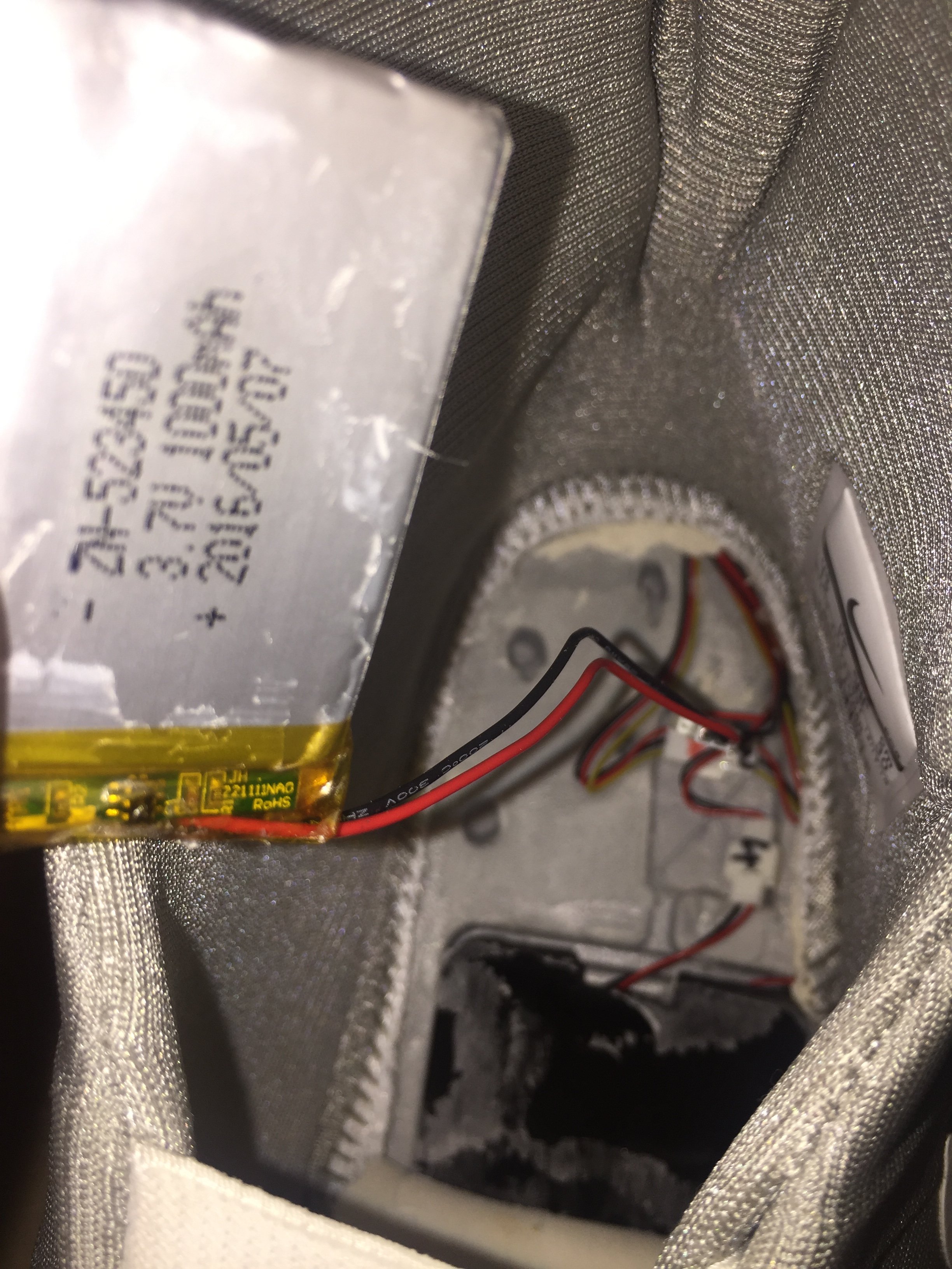

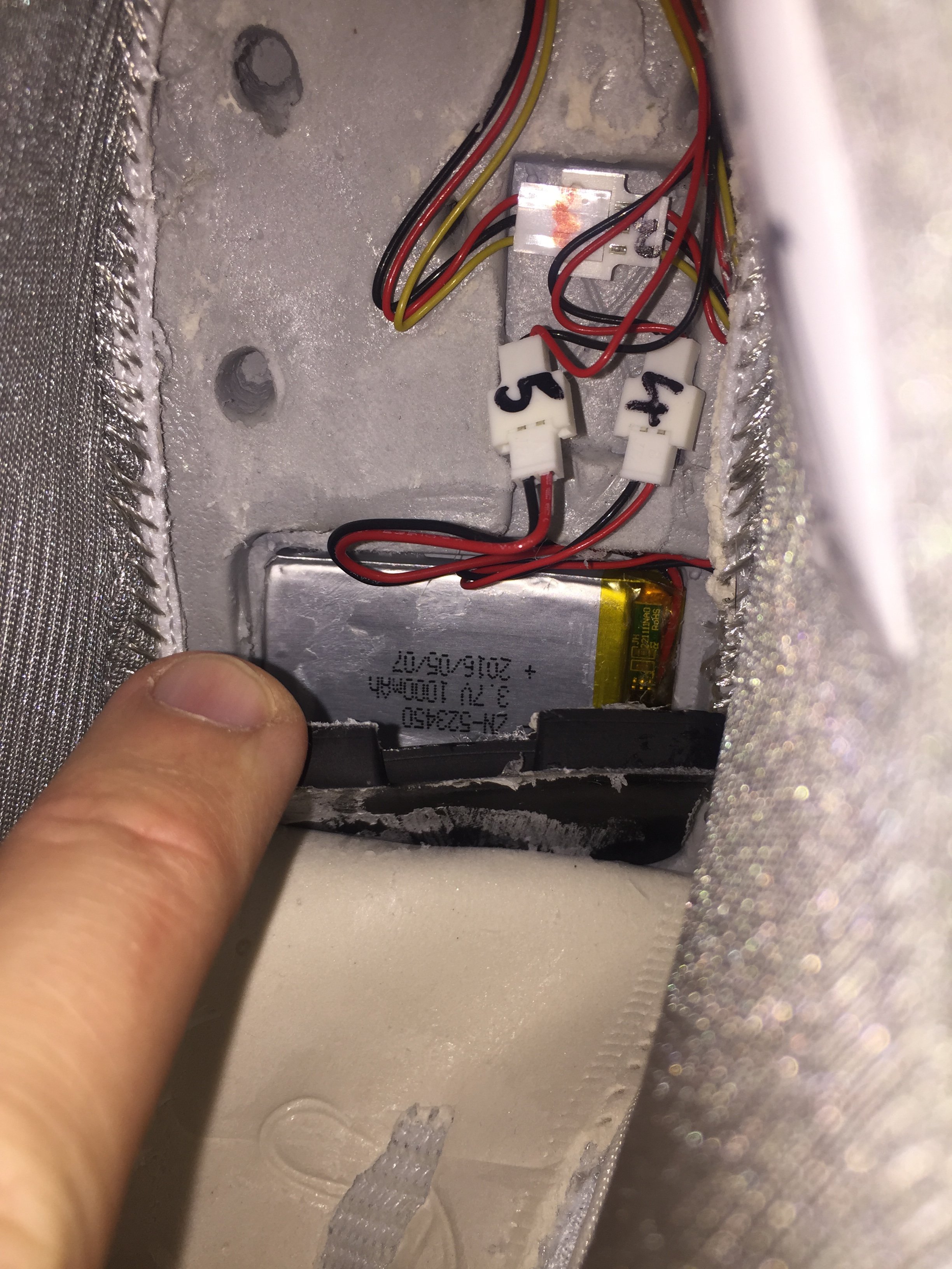

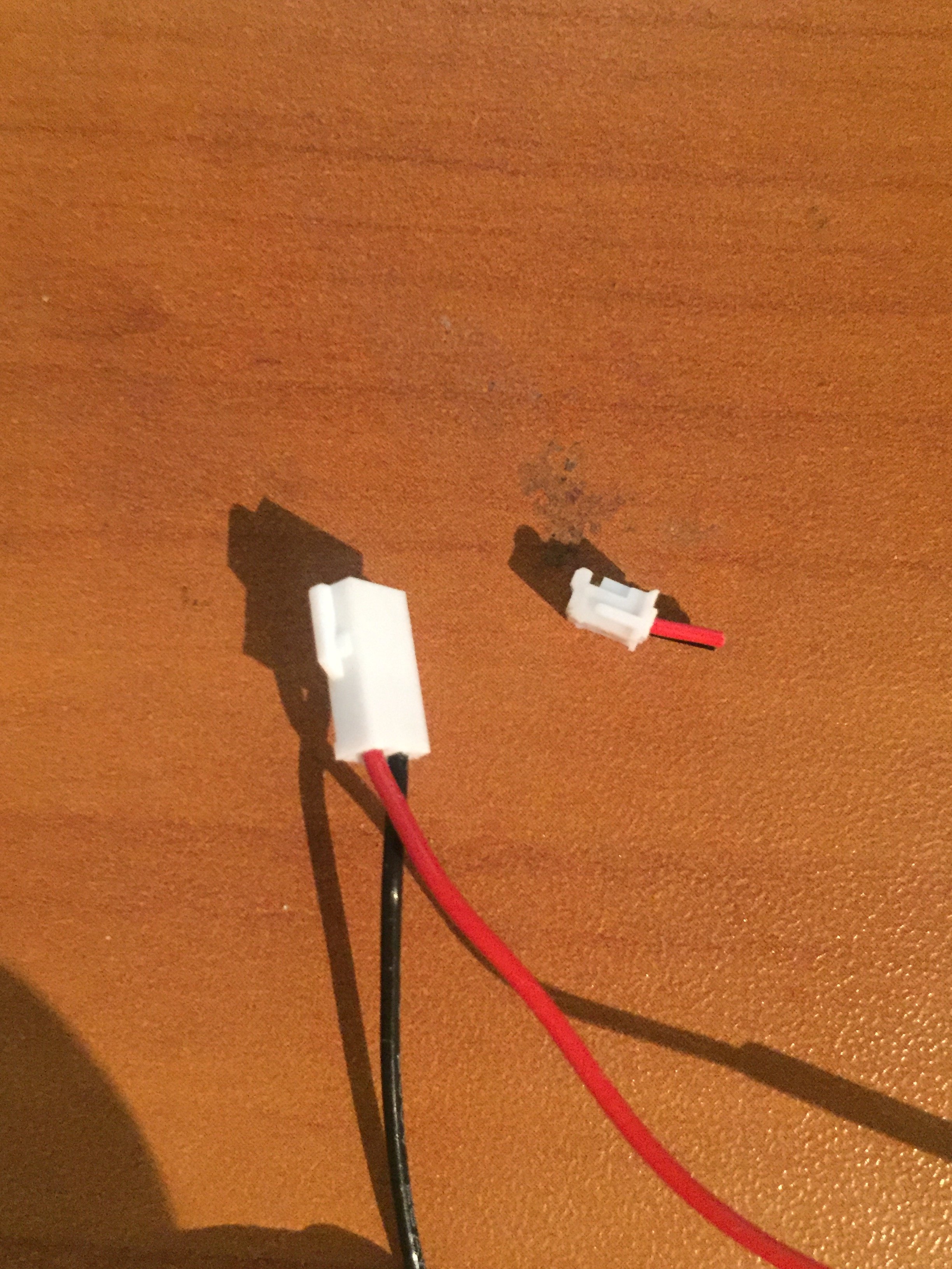

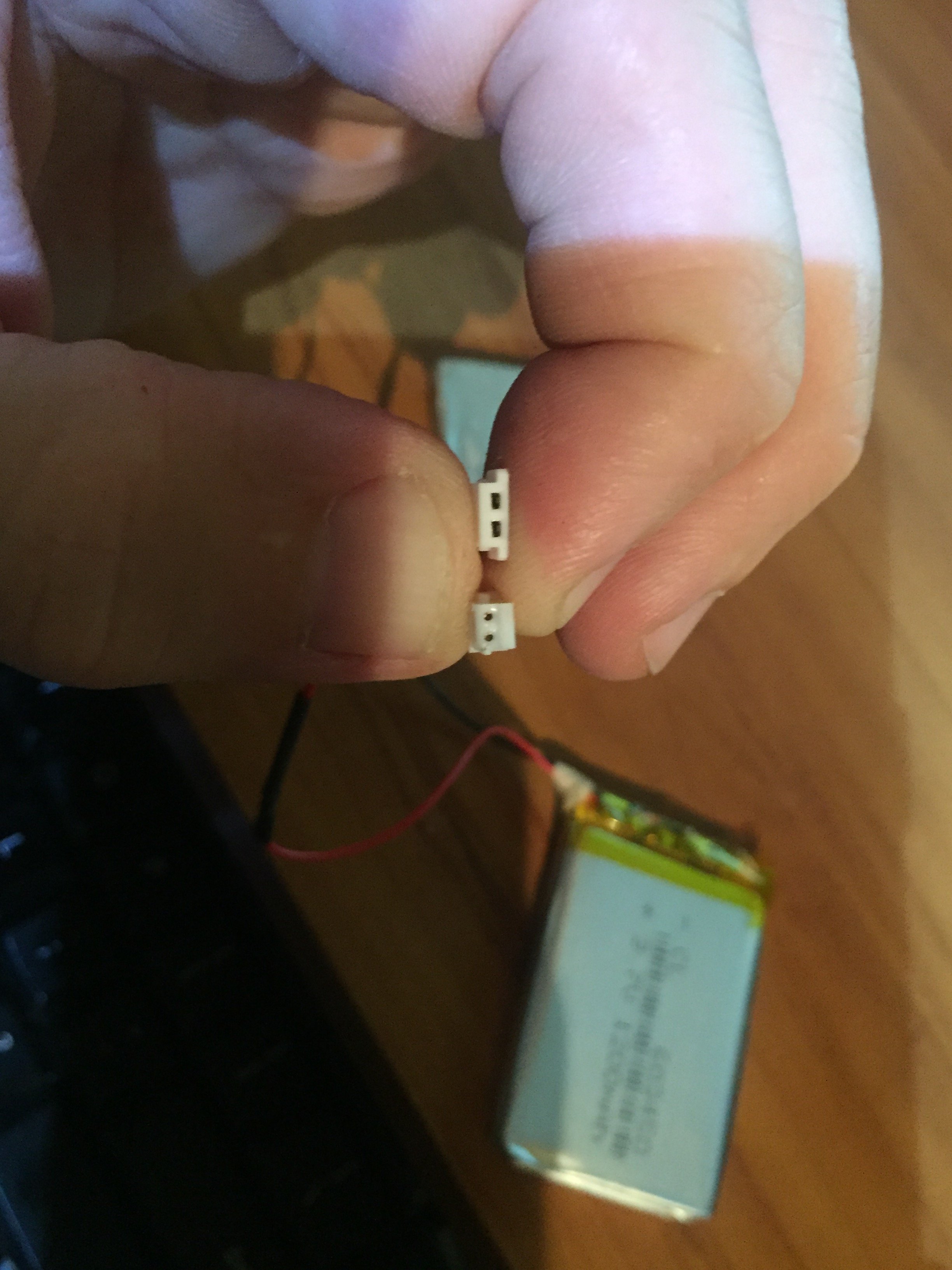

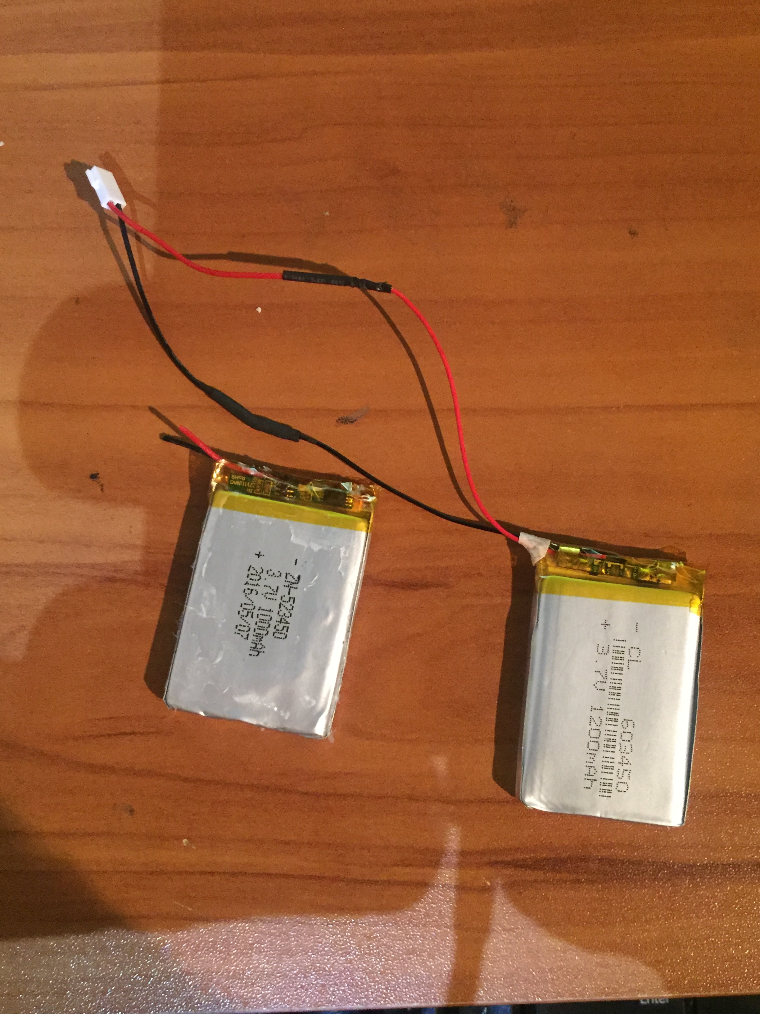

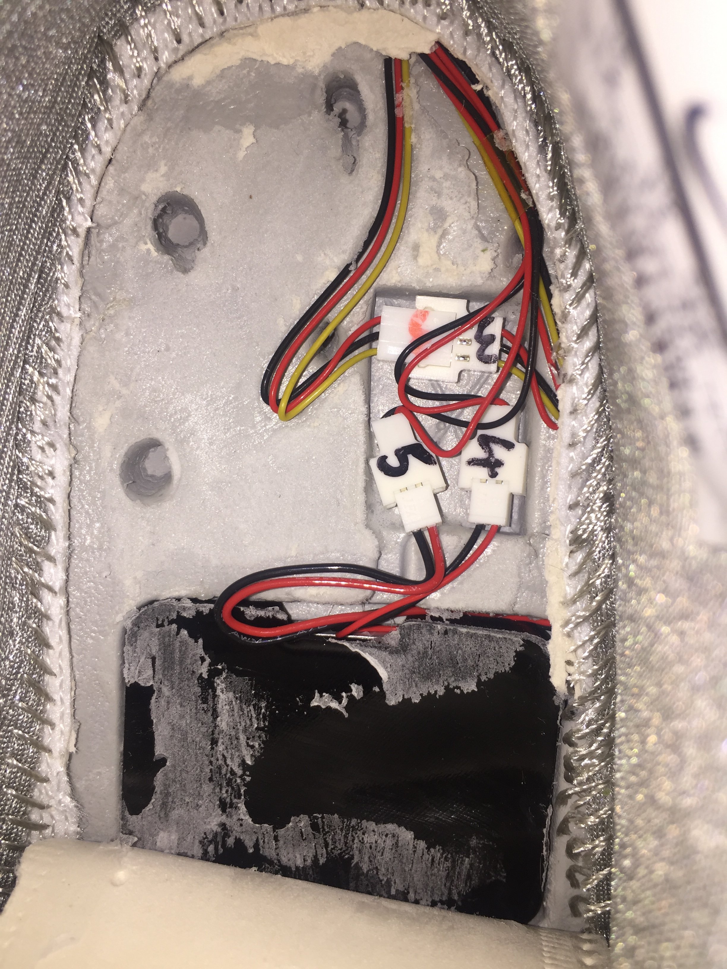

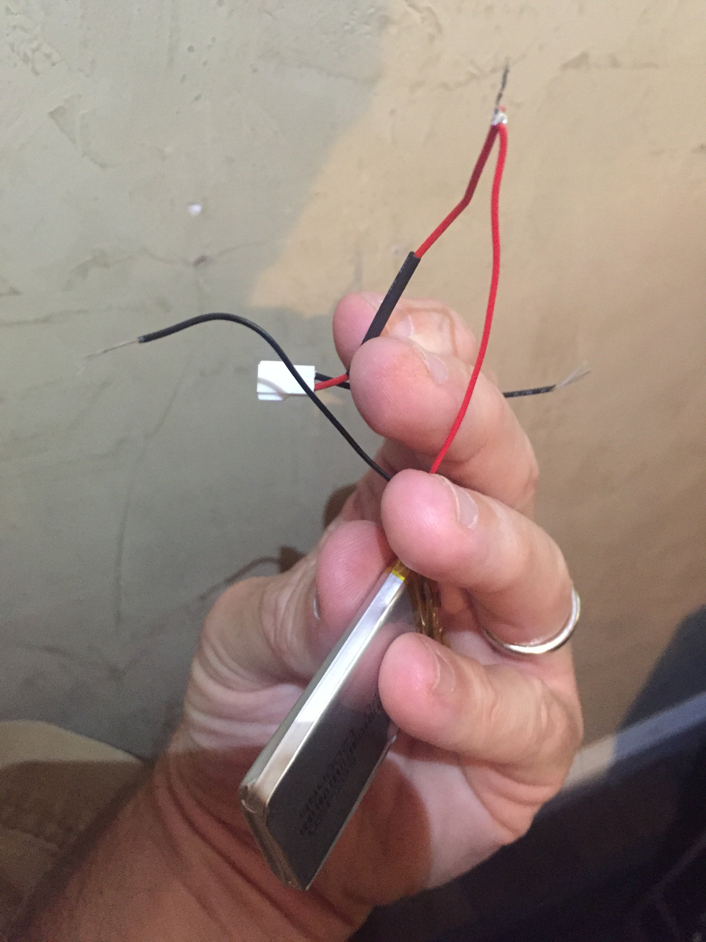

I just completed a battery swap. Seems that another common problem is that some shoes have bad batteries. The shoe won't charge or turn on at all. I first swapped out the charge port and when that didn't work, I swapped the battery. I found an almost identical battery and an identical charge port on Ebay. The only difference in the battery is that the Ebay one is 1200mah instead of the 1000mah battery that comes with the shoe. If you do this swap, you have to switch the wire plugs, since they are different. The most stressful part of this is cutting open the insole. Since there are wires underneath, you must be VERY CAREFUL not to nick or cut them. I used a very sharp exacto knife. I started cutting on the inside of the shoe (not the swoosh side). When I got to the back of the shoe, I didn't push the knife too far down into the sole since I knew there were wires there. Then I just scored the insole the rest of the way (towards the swoosh side of the shoe). Then you have to pry up the insole. Once the swap is done. you can just lay the insole back down and glue it into place.

My question is that as you now have installed the 1200mah battery. Has that made the lights brighter or is it just going to be better battery life now?

Not any brighter. Most likely just longer life but I doubt by much.
Do you have a voltage meter or battery tester by chance? It would be interesting to see what the battery you pulled actually tests at.
As you indicated in the follow up post, the mAh is not a statement of "power" it is more a statement of battery life. The volts are more representative of the "power". Although, the EL panels require inverters. The power available to the panels is dependent on the inverter specifications and the gauge of the wires.
20% longer☝️
I don't have a voltage meter. Besides this battery is dead and can't de charged so I don't know if it would register anything anyway.

Right on, was there any damage evident with the battery? Like does the broken battery flex more than the other, pushed in, etc? I am interested to know if the sole cavity doesn't support the battery from your body weight. Thus, broken batteries will keep happening. Similar to the EL, changing the panels wouldn't be the solution as the soles would keep severing the connection. You are aware of this one, I am simply drawing the comparison to help you understand why I am asking about the battery.
Great question. No evidence of problems. The battery looked fine. The cool things is that it's very well protected and the wires are very sturdy. I was impressed at how good the thin wires are. There's also a protective plastic housing on top of the battery. It's that black think I'm lifting up.

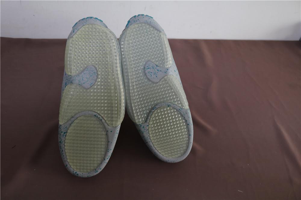

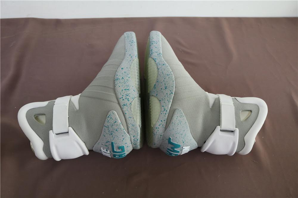

My shoes have just arrived today. even though i was worried about yellowish soles from qc pictures:

in real life they are not bad at all. i guess its just a camera issue but they turned out perfect IMO.
ill upload some pics later on of them in hand.
Also the US9.0 i ordered fit true to size.
If i would have ordered US9.5, i would have been fine.
stprime looks like Don Jon's pictures and comments might be relevant to your issues. Given the LED bubbles on your QC pics appeared to also be yellow, I'd say it is lighting.

can you tell what gauge the wires are?

based on Don Jon's post and the fact that Stprime's QC pics seemed to show the LED bubbles being commensurately colored, I don't know it is definitive there is a yellowing problem.
