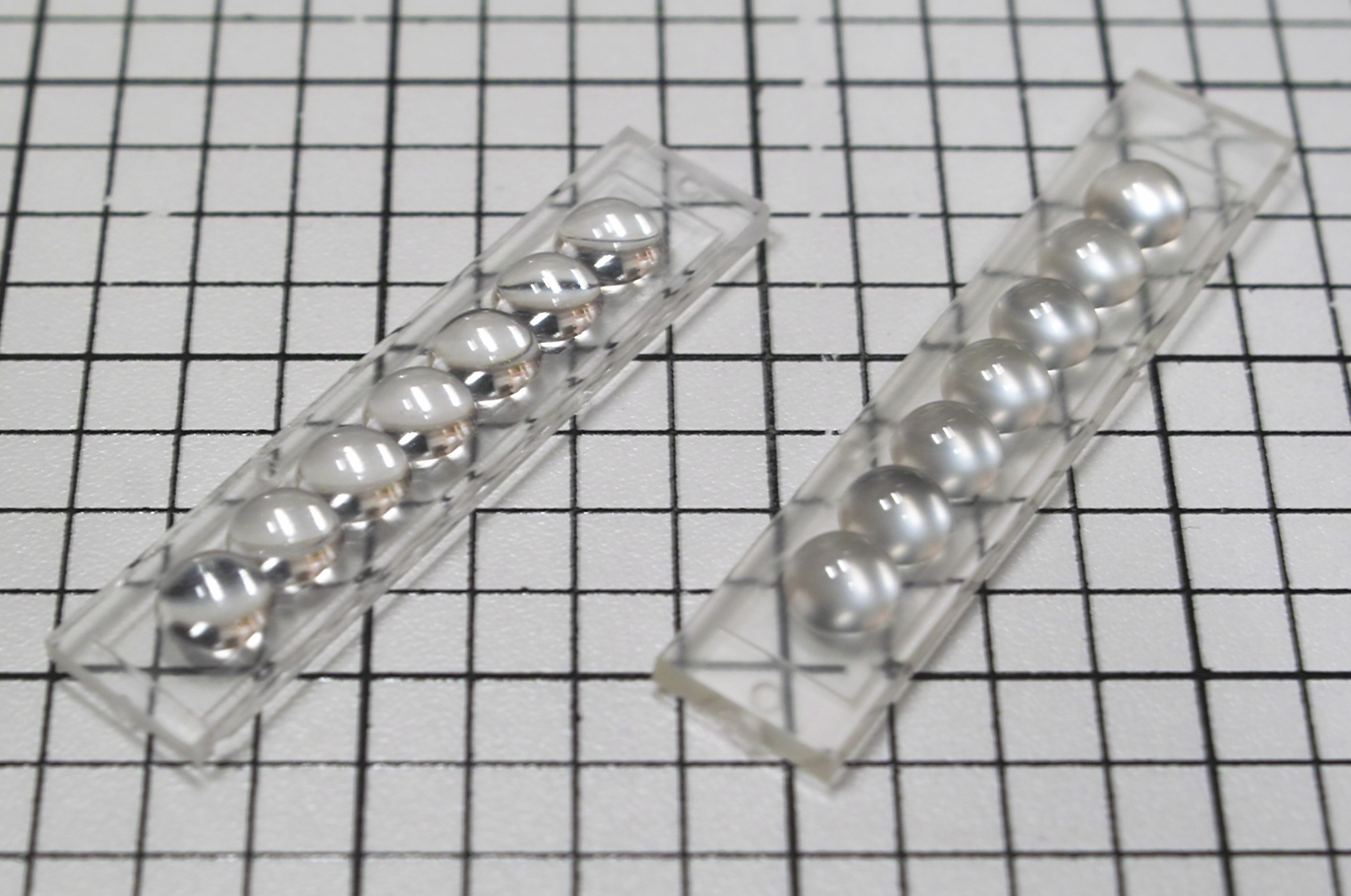

With that in mind, who makes an appropriate vintage style bubblestrip with the correct dimensions?
In my experience, from the ones I've bought, this is the best:
Rebelscum eStore
And this one, from propsplus on eBay is second:
Star Wars Luke Obi Vader Saber Activator Switch Replica Ti19 Ti20 Exactra Calc | eBay
Both need to be shaved, beveled, or the like to fit into a clamp. The Rebel Scum strip costs roughly 3x as much as the Propsplus strip but has much clearer resin so it looks more like an acrylic. I think the Propsplus has excellent geometry, but is clouded -- which could be good for an aged look. Here are the strips side by side, Rebel Scum on the left, Propsplus on the right:

The other thing you have to watch out for with the eBay/propsplus bubble strips is that they are rather brittle. I kept mine hidden away for over a month to allow it to continue curing then I took it out to see if it would polish up a bit with some Novus and it snapped in half :mad:
When I was creating my bubble strip replicas I had to make a choice between an accurate uncut Exactra strip or a pre-cut easy to install bubble strip. Since they are injection molded I had to make a choice. I choose the latter because most people wanted that. Only few of us would like to spend time and effort cutting a replica for use. I don't think I can invest in tooling for a uncut replica; too little demand probably.

A not-unreasonable decision!
The only two bubble strips from production we've seen today had me slapping my forehead and going DUH!
I spent so much time thinning the whole bottom of the strip to fit under a clamp, or shaving the length of the sides down to pinch and here they are milling off the top corner
You have to watch out for the same thing with the Rebelscum ones too though. I know from experience. :(

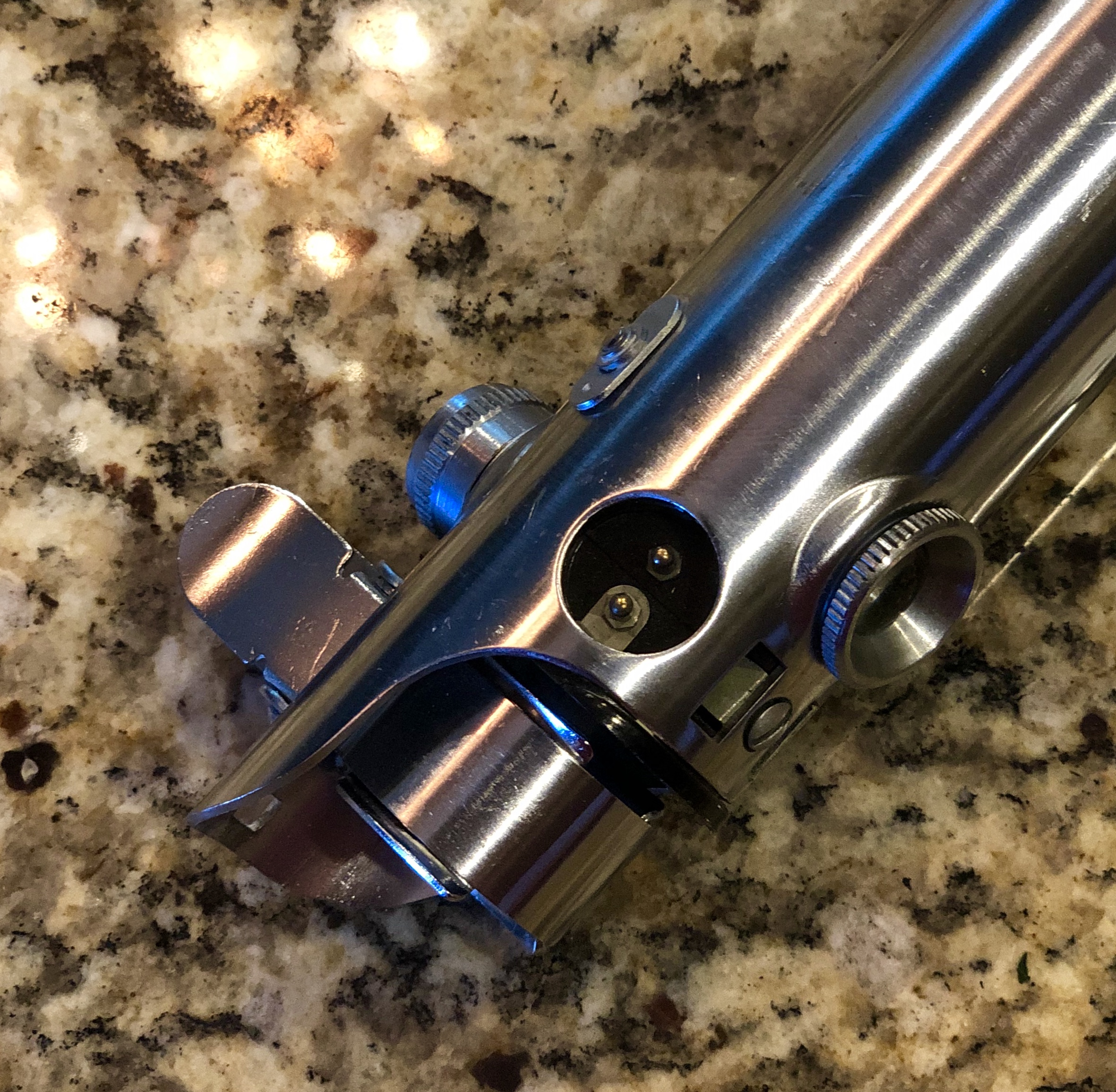

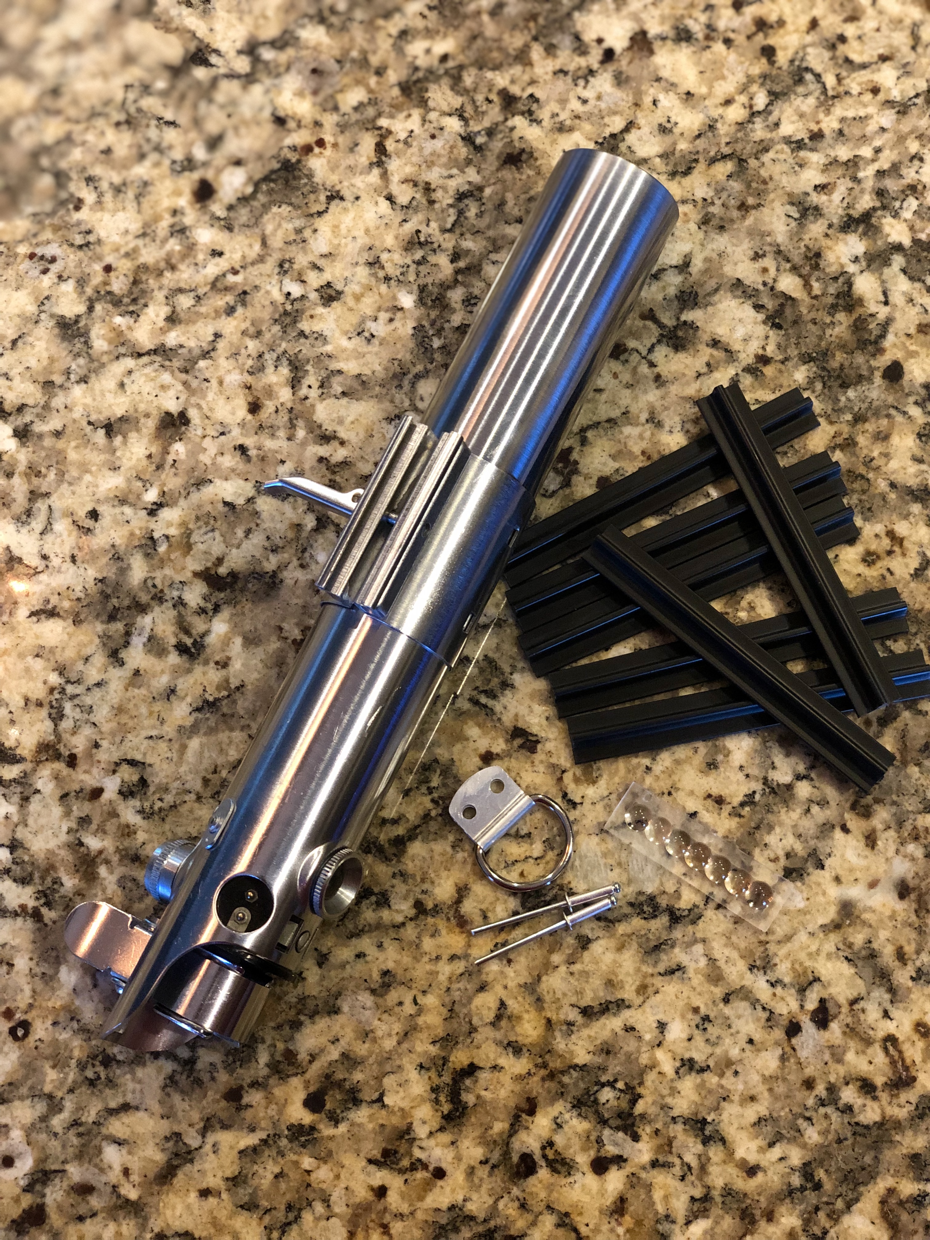

I swore I was not going to do a build-up based upon the details of this hilt, but I already had a vintage Folmer flash with the glass eye and red button that demanded it. Plus, once Wannna Wanga created the D-ring, I had no choice...
Excellent! Still waiting on my D-ring to arrive. Is the bubble strip vintage as well?
