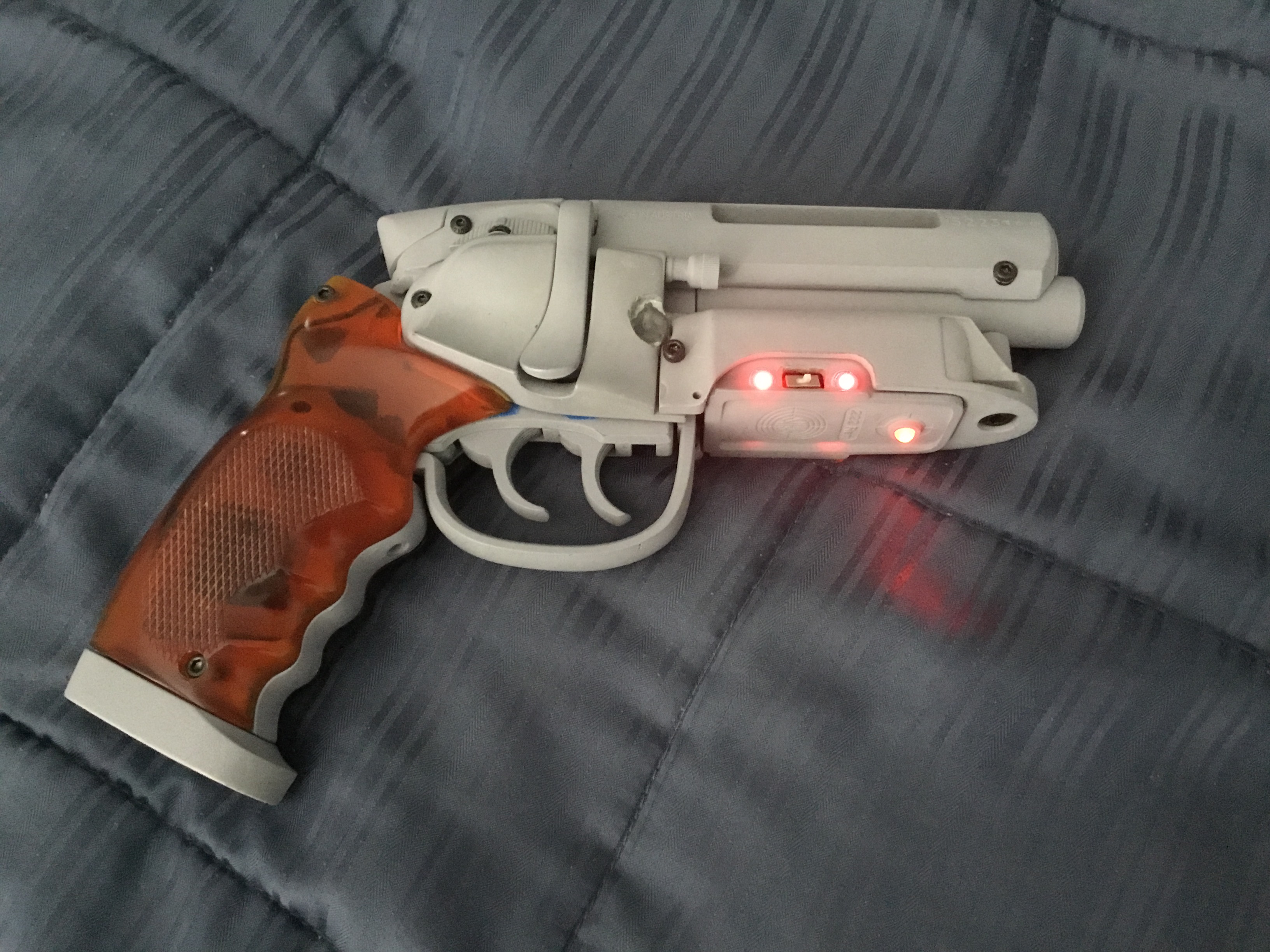

My build is gonna slow up a bit as I wait for replacement/upgrade parts to come in from TipTop. Meanwhile, I can still focus on finishing and painting the parts I have.
The clip needs some more work. Also, I’ve checked and resoldered the LED connections, but fitting everything into the clip (and it’s a tight fit) seems have caused a short or loose connection, somewhere. Seems to be working since I resoldered the connections. We’ll see.
Once I fine-tune the switch hole and the half-moon cutouts in front of the LED bezels, I can light-block with a coat of silver, then more primer, then gloss black.

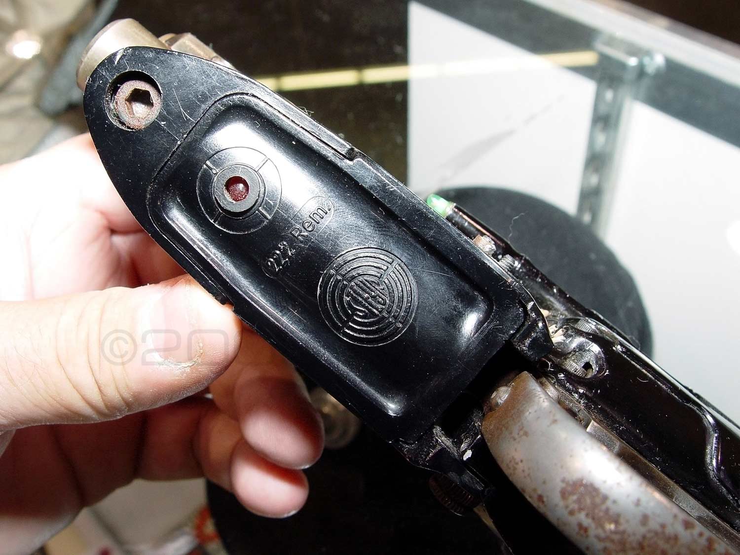

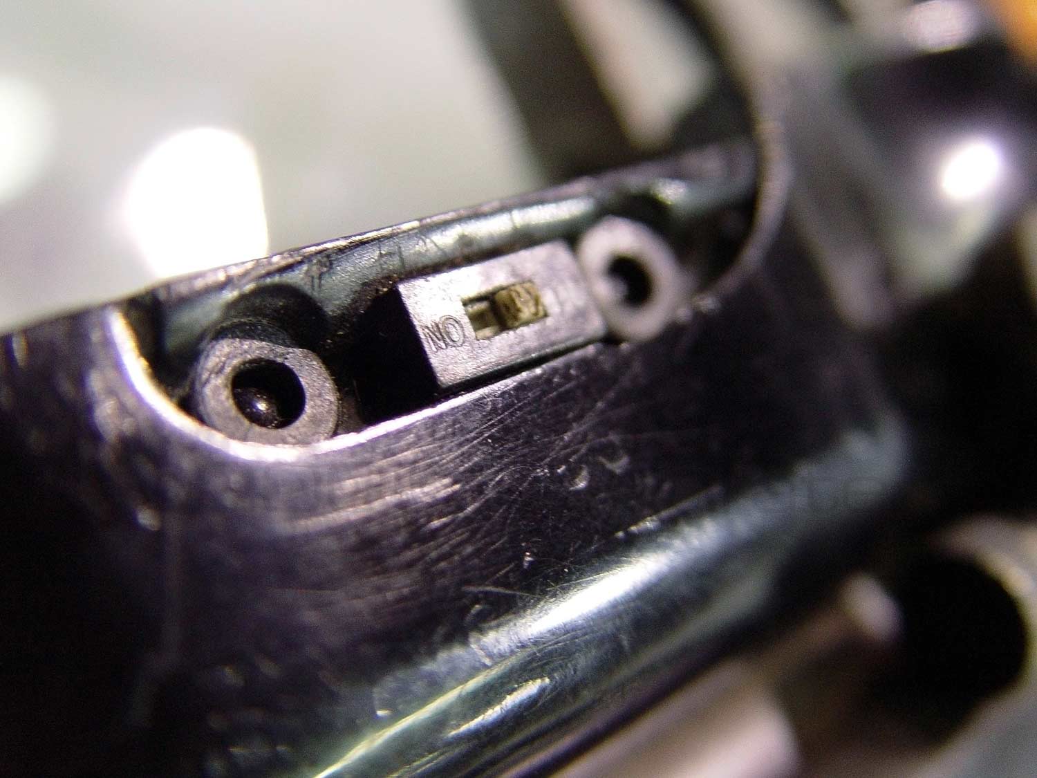

One thing that might be worth double-checking... In the pictures of the original I've seen the LEDs themselves are recessed within their 'holders' (or at most flush with them) rather than protruding through them, both the 3mm ones on the sides and the larger 5mm one on the bottom.
Yes, I noticed the recessed LEDs, and that will be part of the fine-tuning.
Meanwhile, the LEDs have suddenly stopped working again, and I am baffled. A short? A weak solder joint? A problem with the switch? I dunno.
Oh, I hate it when that happens. :confused:
Are the LEDs wired in series or in parallel? If the former, and they're all dead the fault could be anywhere in the circuit. If the latter and they're all out the fault will almost definitely be in the power supply or the switch.
Can you bypass the switch to see if the LEDs work when power is going to them directly? That would at least narrow the possibilities.
…and now it works again. Completely at random. This is a simple, 3V circuit, and so shouldn’t need resistors or anything, right? It can’t be, like, overloading and then not working for stretches, right?
Maybe I should disassemble the whole thing, and use magnet wire, for less wire stress/tension/risk of shorts/breaks when it’s all bent and cramped into the clip.

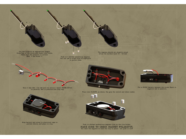

This is how the anders kit is wired if this is of any help.

Certainly not overloading. If it was the LEDs would have burned out... and they only do that once! :lol: If it's an intermittent fault, as you describe, and if all either all the LEDs work or all of them don't (rather than single ones not working) my money is on a short, a dodgy solder joint or a broken wire somewhere between the battery and the LEDs, or the switch and the LEDs, or the battery and the switch. That's why if you can remove the switch from the circuit you can narrow down the location of the fault.
Gotta be a dodgy solder joint or something. Probably gonna have to disassemble the whole thing and rebuild it from the ground up. I could futz around checking connections with a multimeter, but the cramped space of the clip requires wires which can bend and flex without breaking the circuit.
I would bet it’s a short. It’s so cramped in there that something probably touches the wrong thing intermittently.

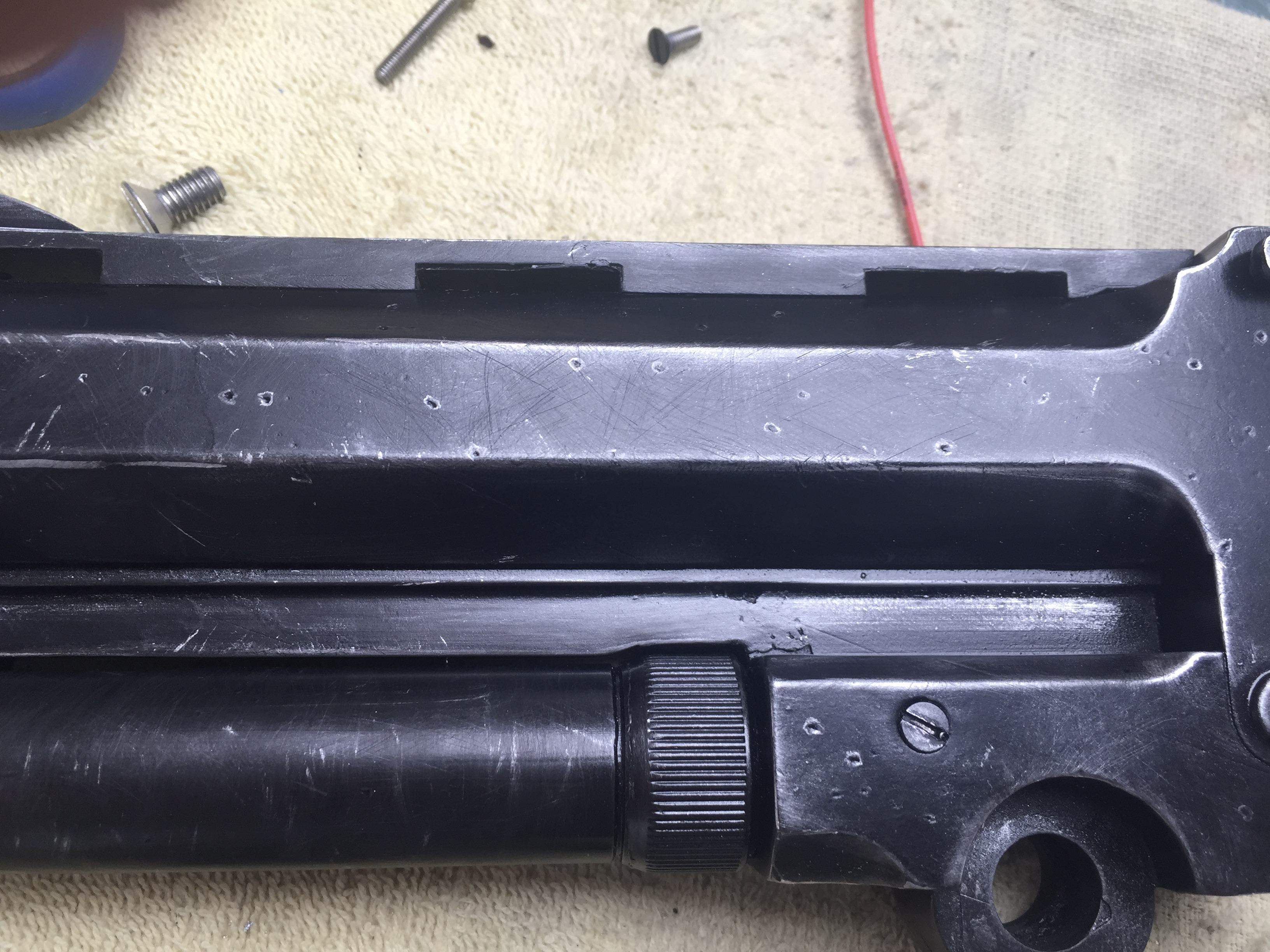

Also, I see you’ve used socket head bolts at the front of your barrel and upper receiver. I was doing the same and then realized my Tomenosuke, which I’m using as a reference, uses button heads. I went back to look at pics of the Hero and sure enough socket heads are the correct bolt so back to those I go. I’m not going for SA, but I like to get the hardware right.
…okay, I just spent the past two hours disassembling everything, then resoldering it all back together with brand-new wires, and making sure all connections were properly tinned before joining them.
So far, so good.

Have you tried some hot glue on the solders to seal everything and prevent shorts?
Electrical tape wrapped over the joints. Shrink-tubing would be a little too tricky, given that there are two wires attached to each LED leg, and that they’re all wired in series.
A little tweaking, and it works again. We’ll see how it goes.
