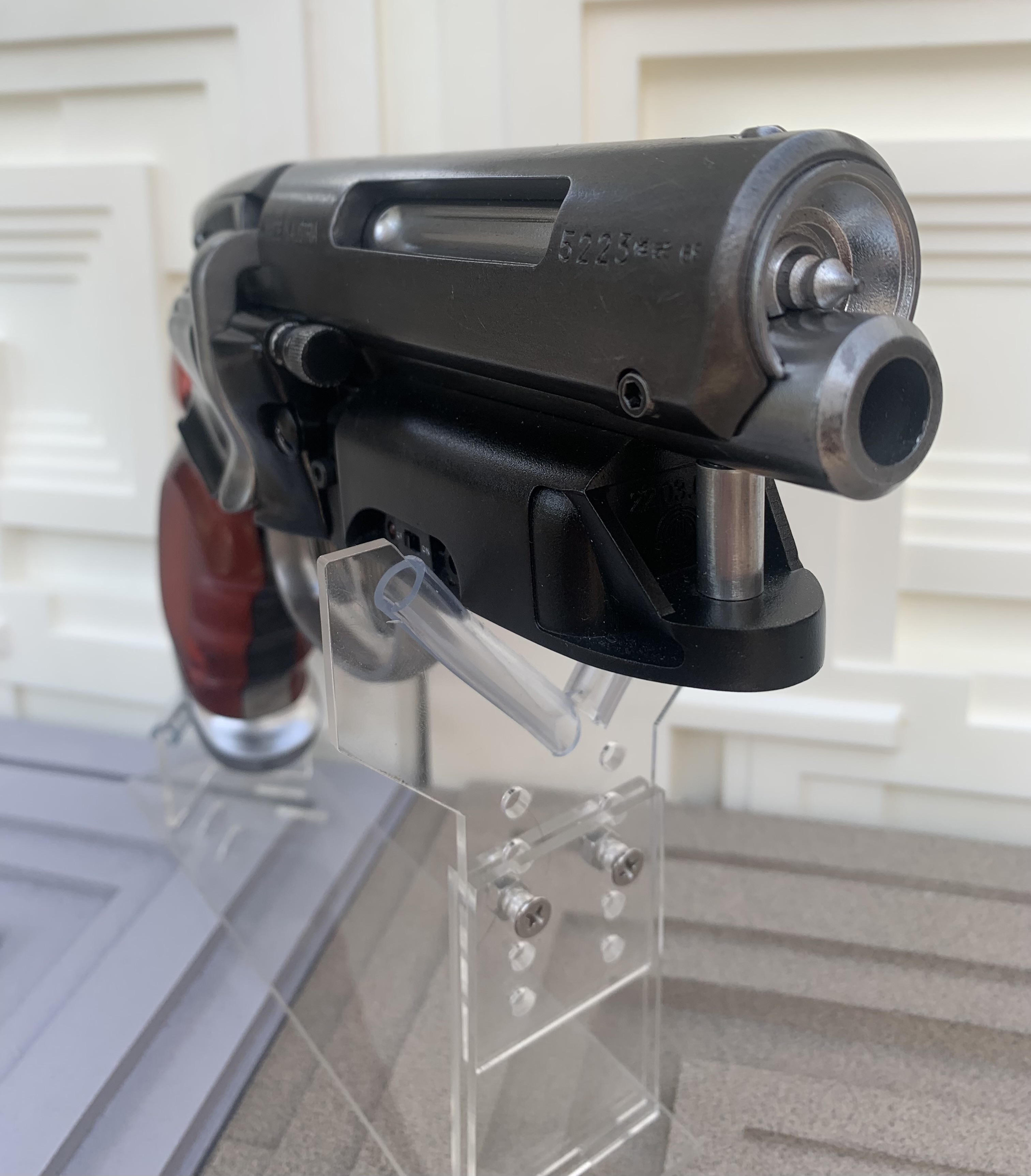

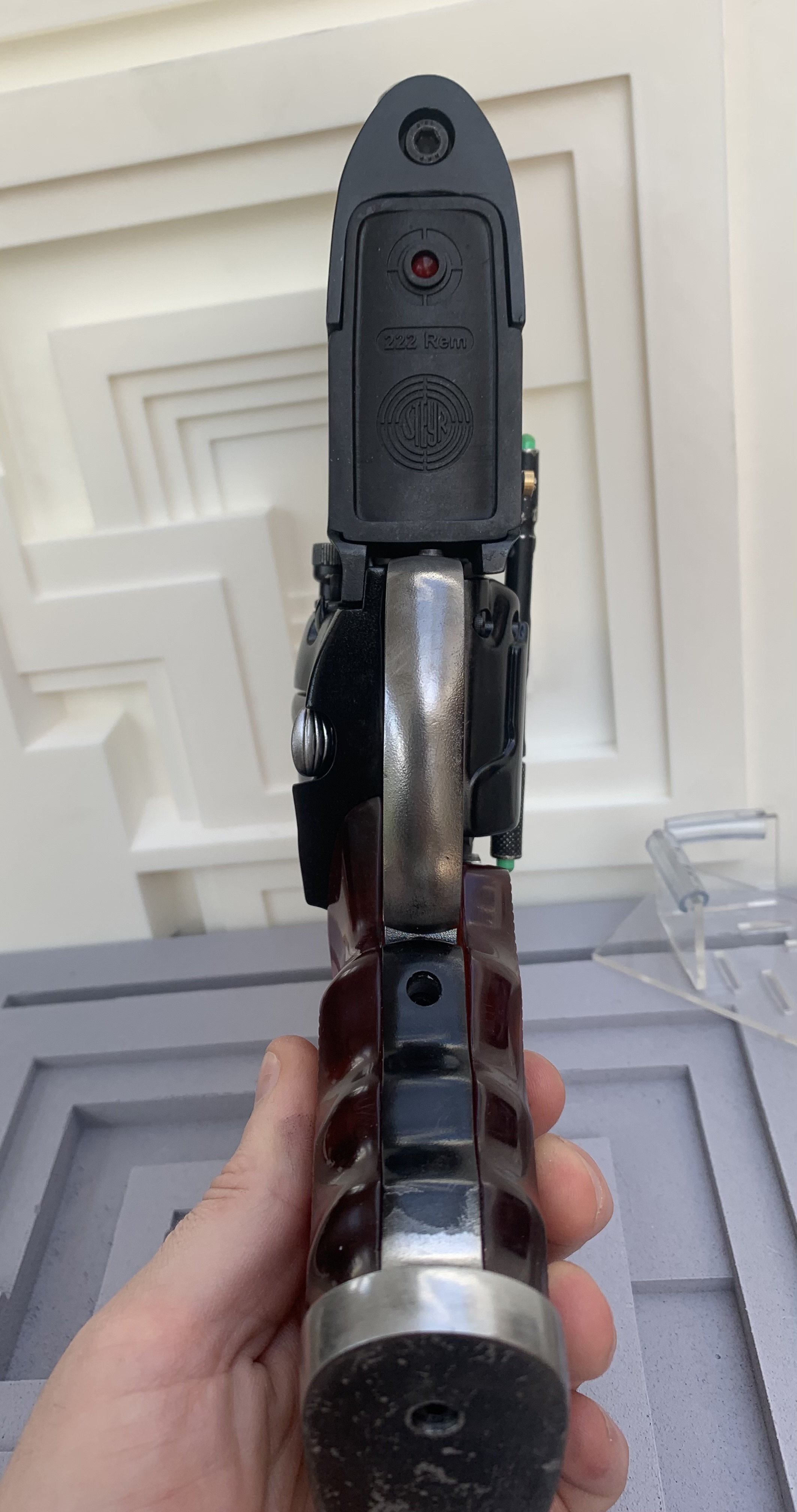

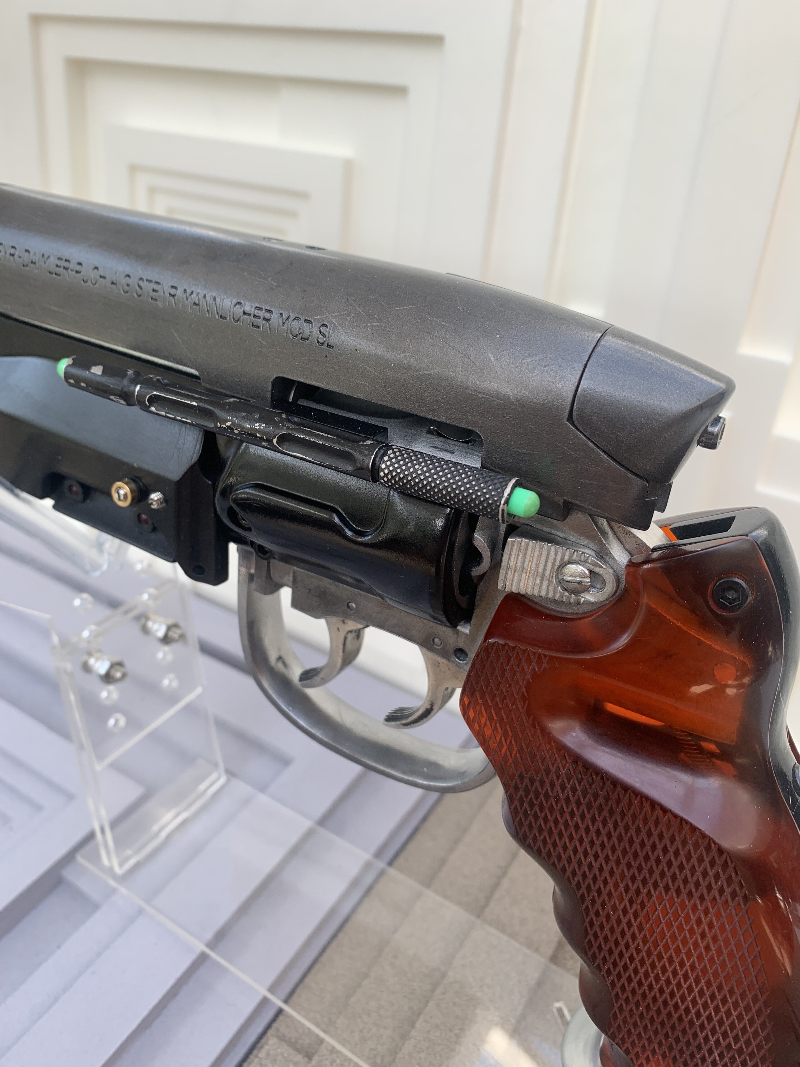

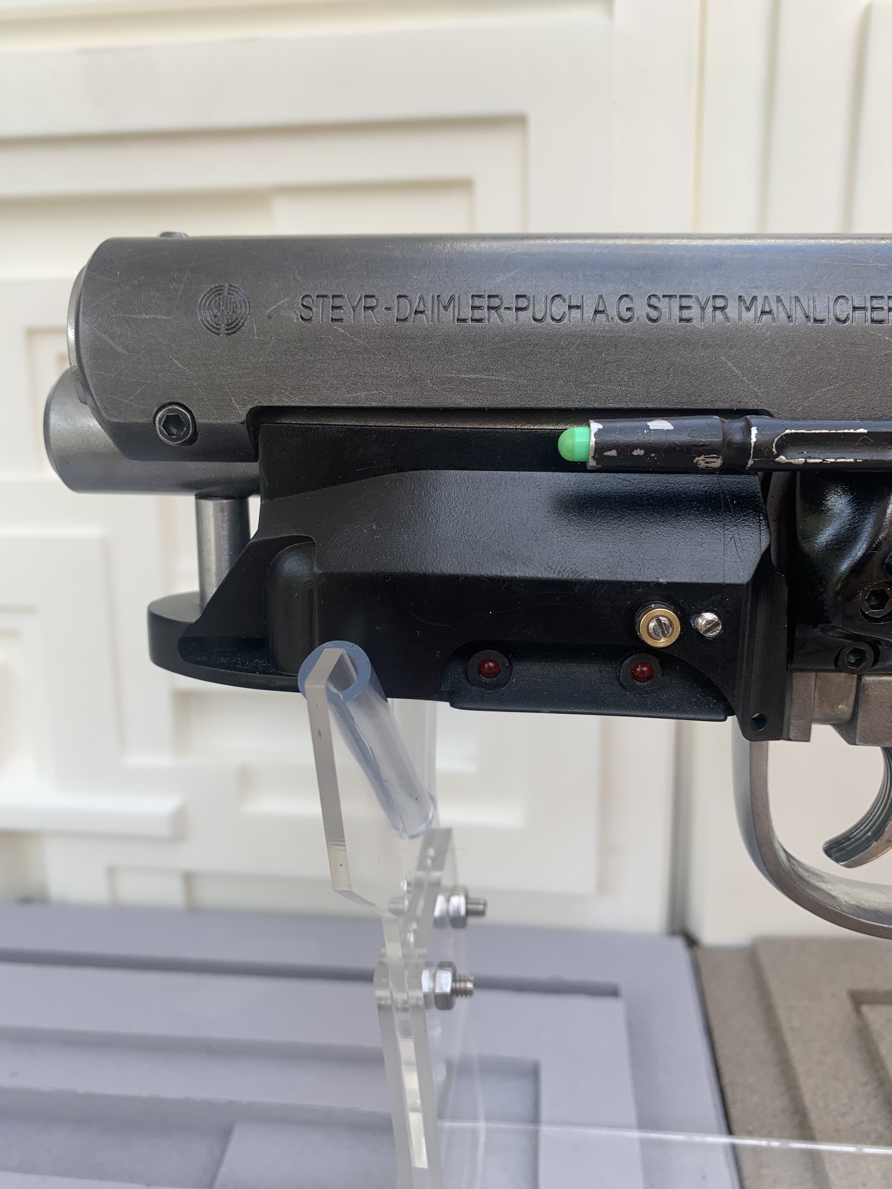

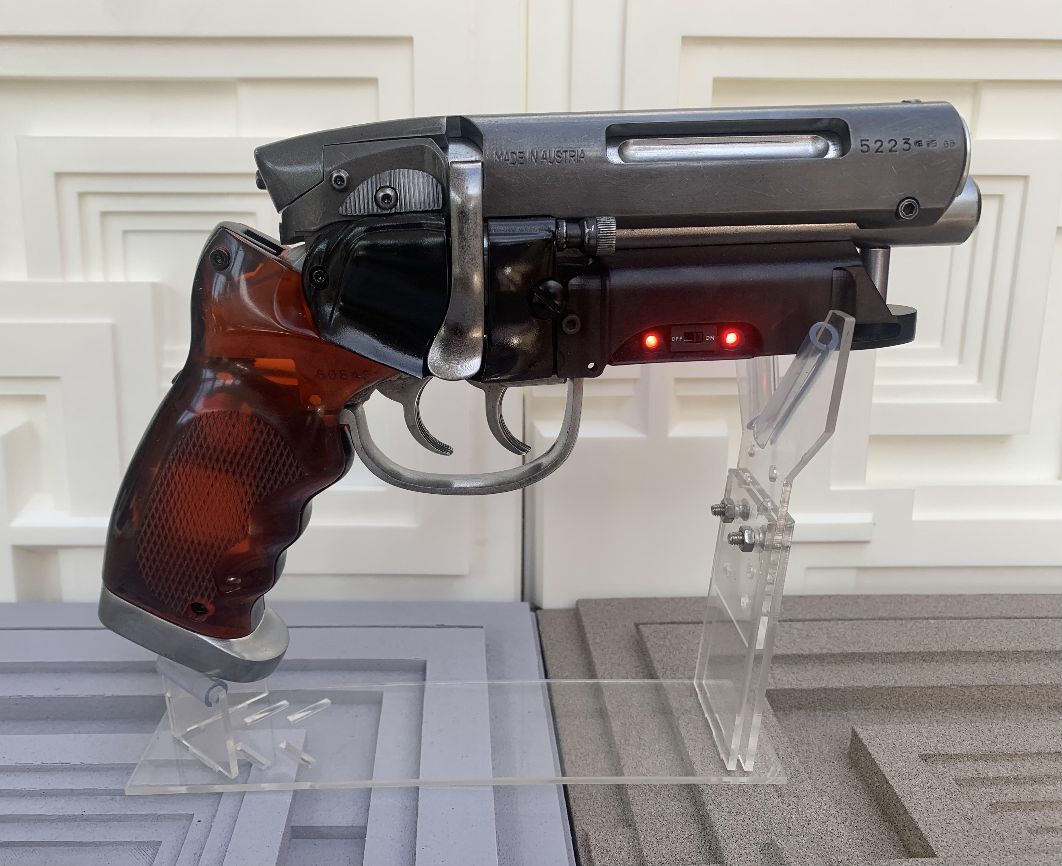

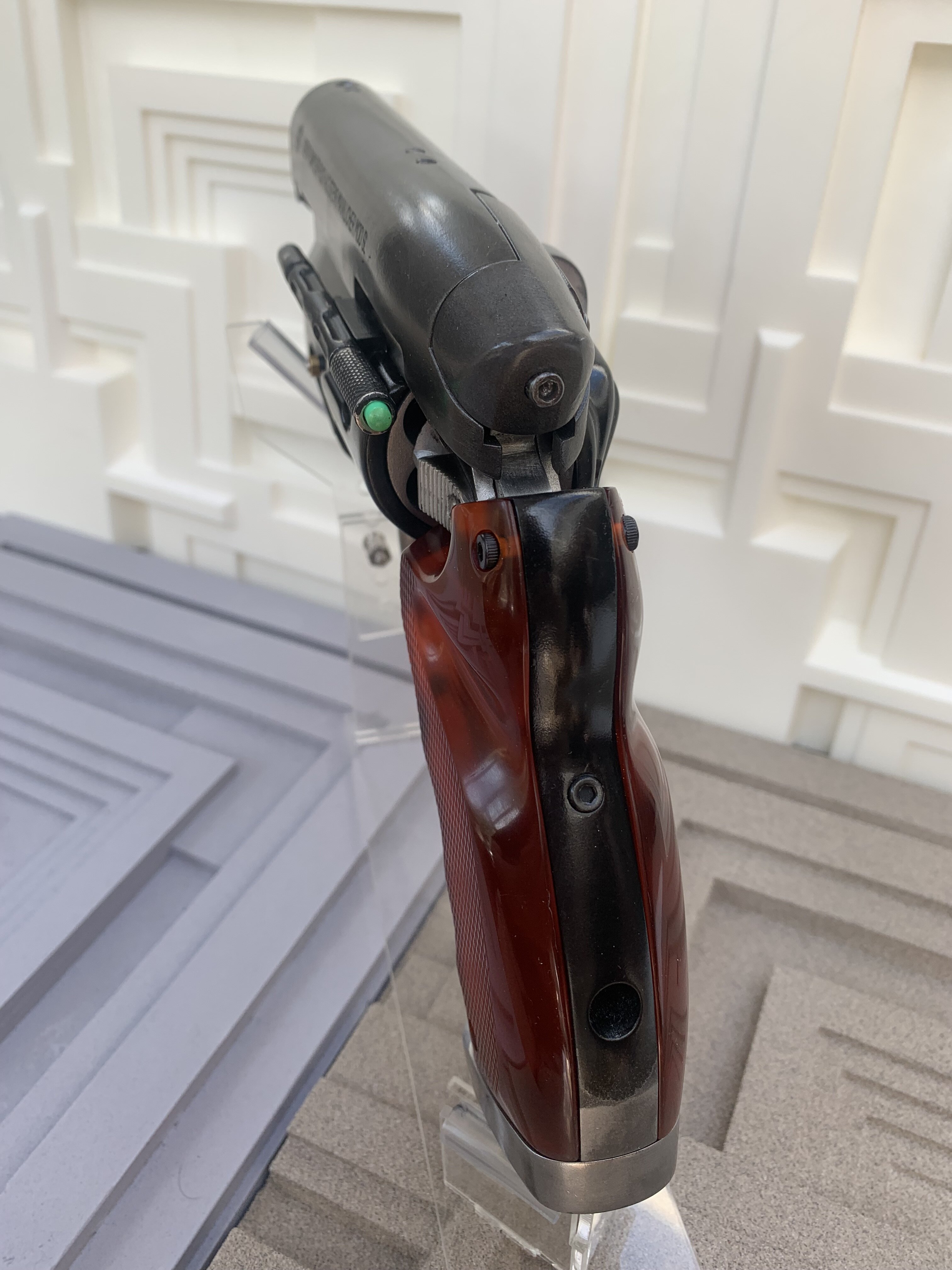

First post! I found this forum while looking for tips on completing my resin Anders Blade Runner Blaster from Tiptop Workshop.
Finally finished after working on it a few hours a week. Rather than replicating the look from either of the films, I actually referenced Adam Savages build as I preferred the colour differences between the metal parts.
-Vallejo steel for the dark metal
-Molotov Chrome for the light metal, this dulled after being handled so I shined it up with charcoal powder.
-Tamiya black gloss spray and the satin and gloss varnish sprays.
-Dlyfull fishing lights for the green LEDs

excellent work ! i started to test fit mine before finishing painting and had problems getting the screws to bite in , did you use glue ? i kind of gave up , i think i used the wrong type of resin when i printed to get the screws to thread in . i might trying buying the kit instead of printing and starting over
Thanks very much! No glue used but I did over tap one hole that I filled in with super glue and bicarb and re taped. My kit was from Tip Top Workshop and I was very happy with the quality of the print. I would finish your print as a test run so the next one will be even better.
