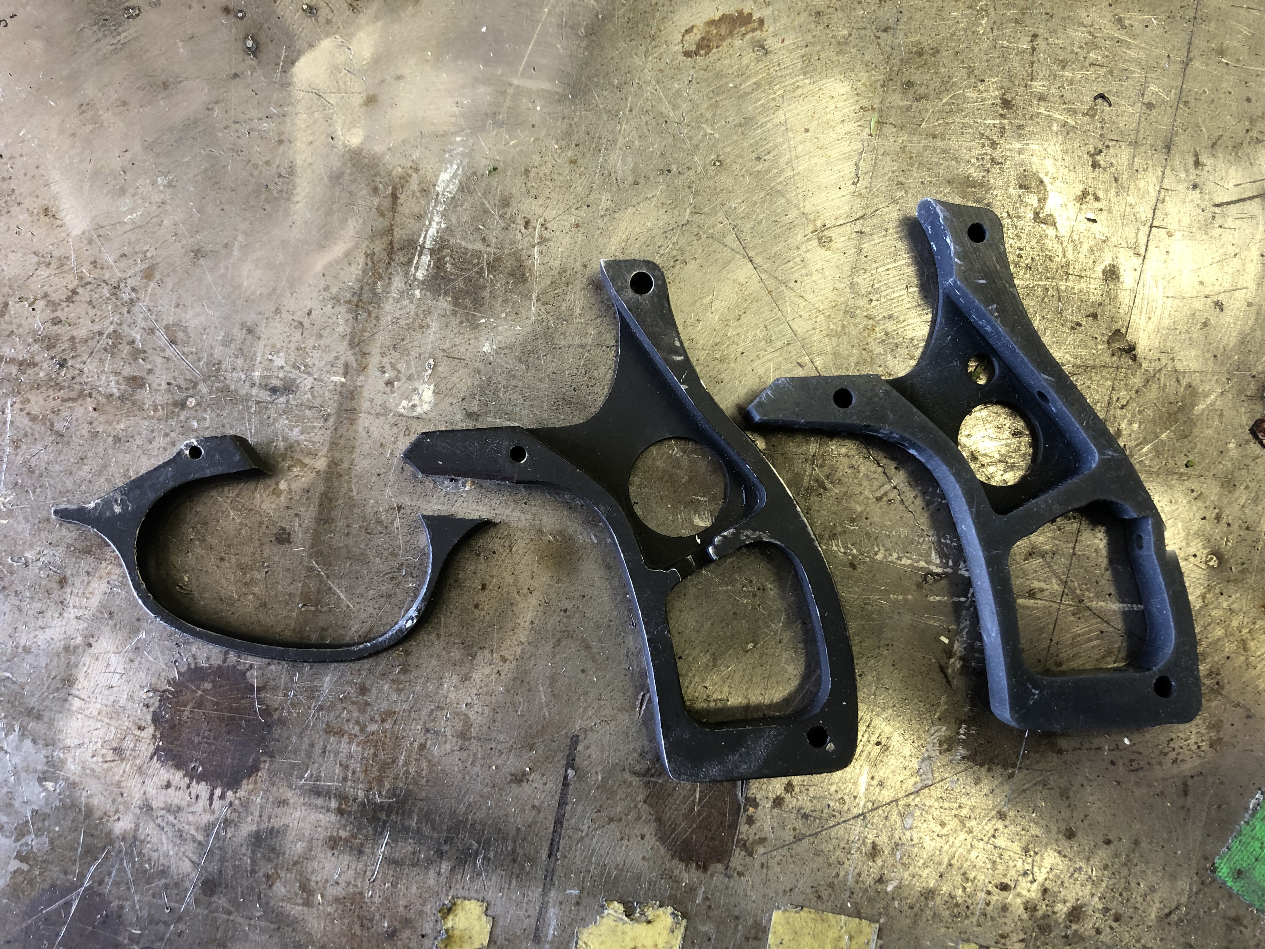

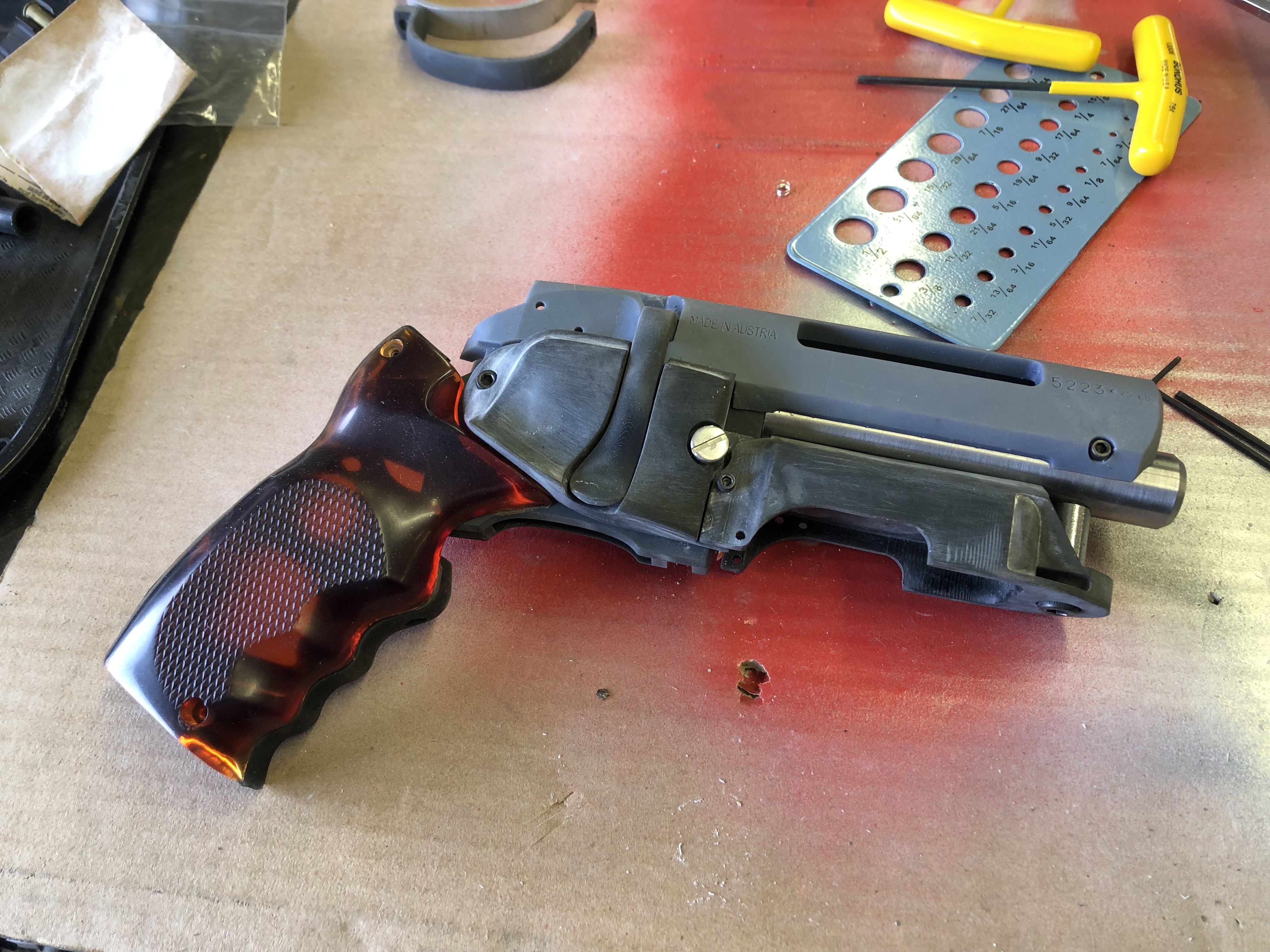

This actually just happened to me in the exact same spot on my model. I just ended up supergluing it back into place. Since I lined everything up exactly it didn’t look like anything even happened. Hope you find a solution on your end.A little progress today. I picked up a Charter Arms Bulldog grip frame a few years ago. I got that trimmed to size. I’ll get the appropriate holes drilled in that.
I got some hardware installed and started a test fit.

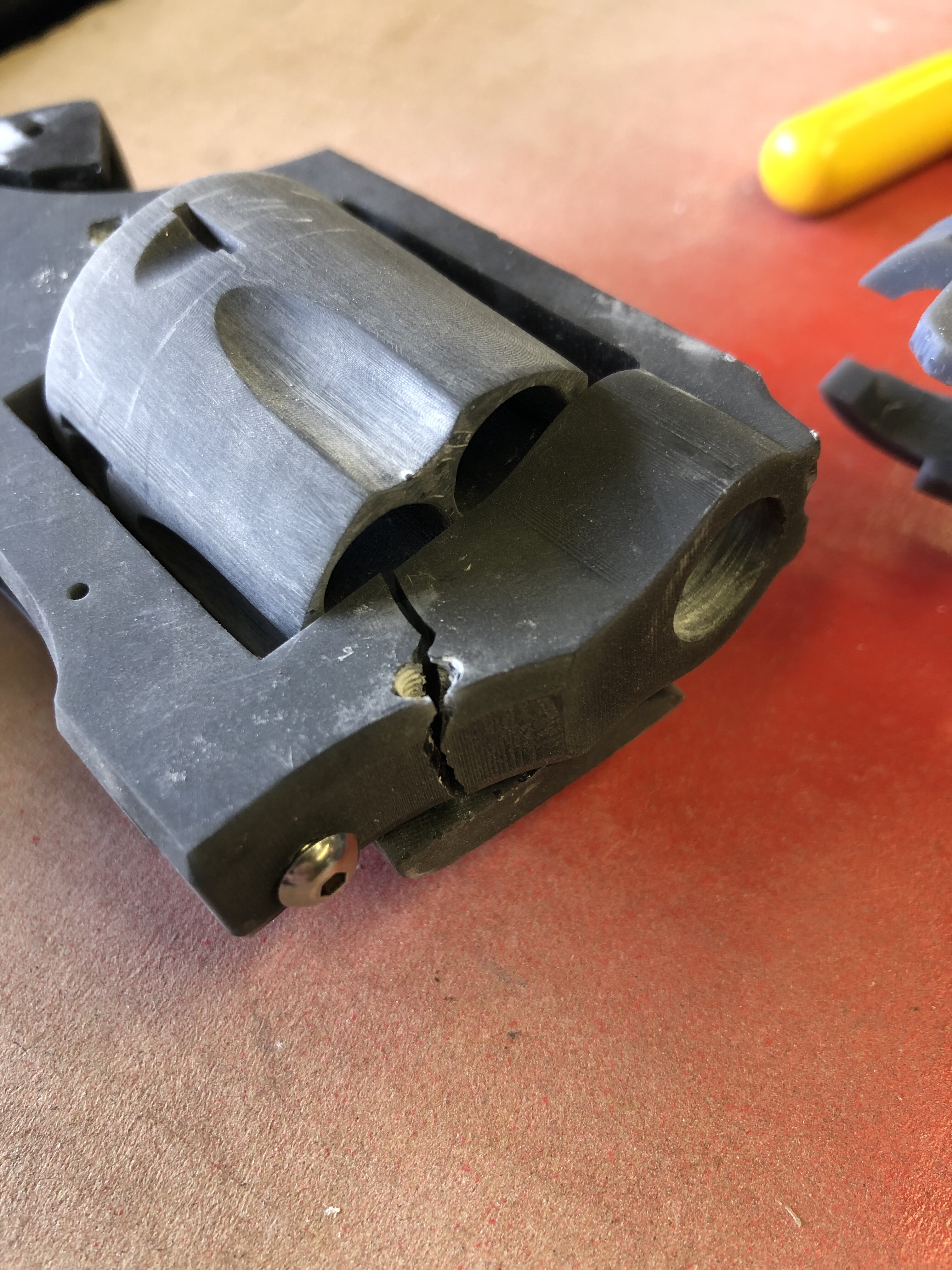

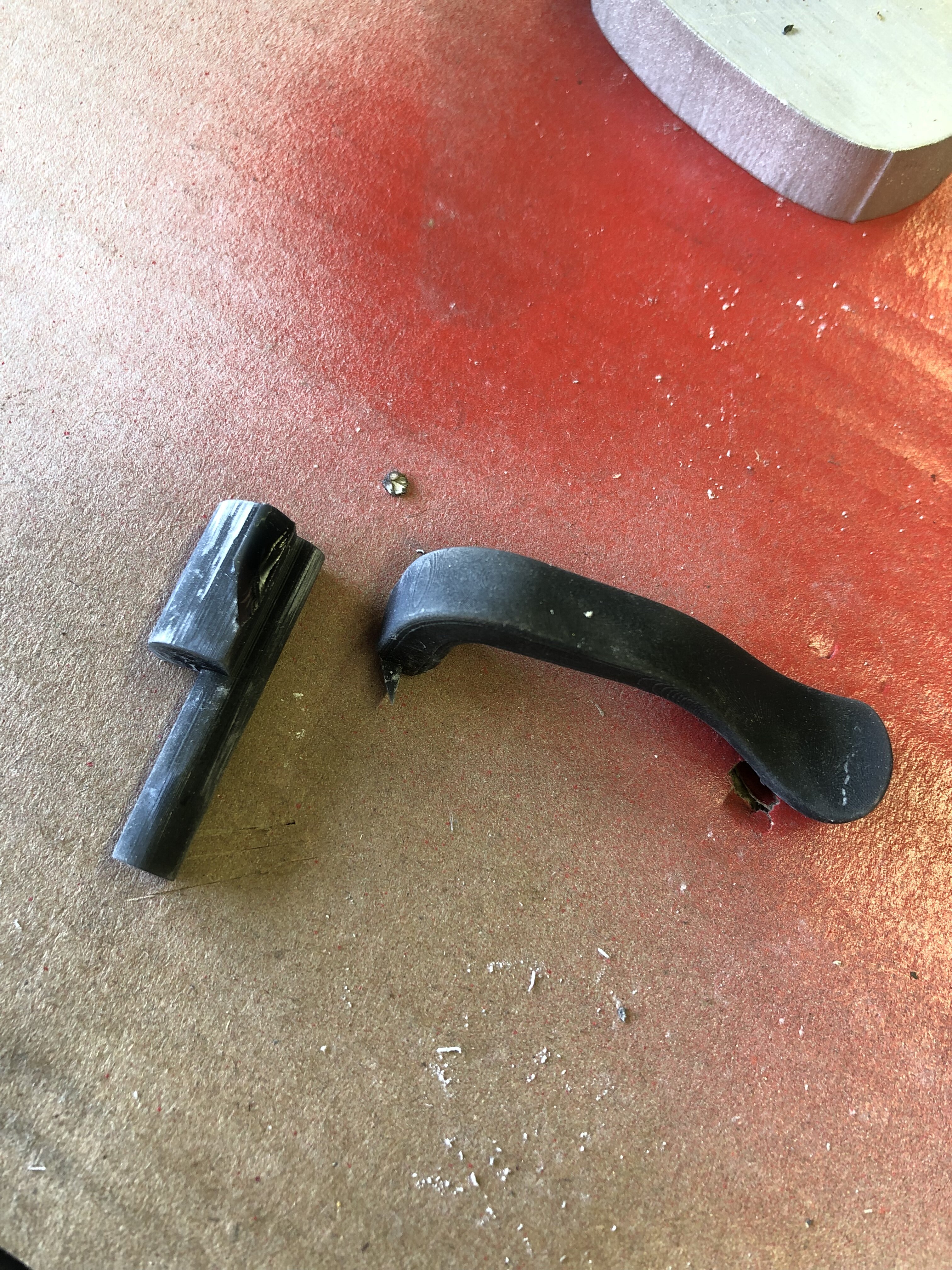

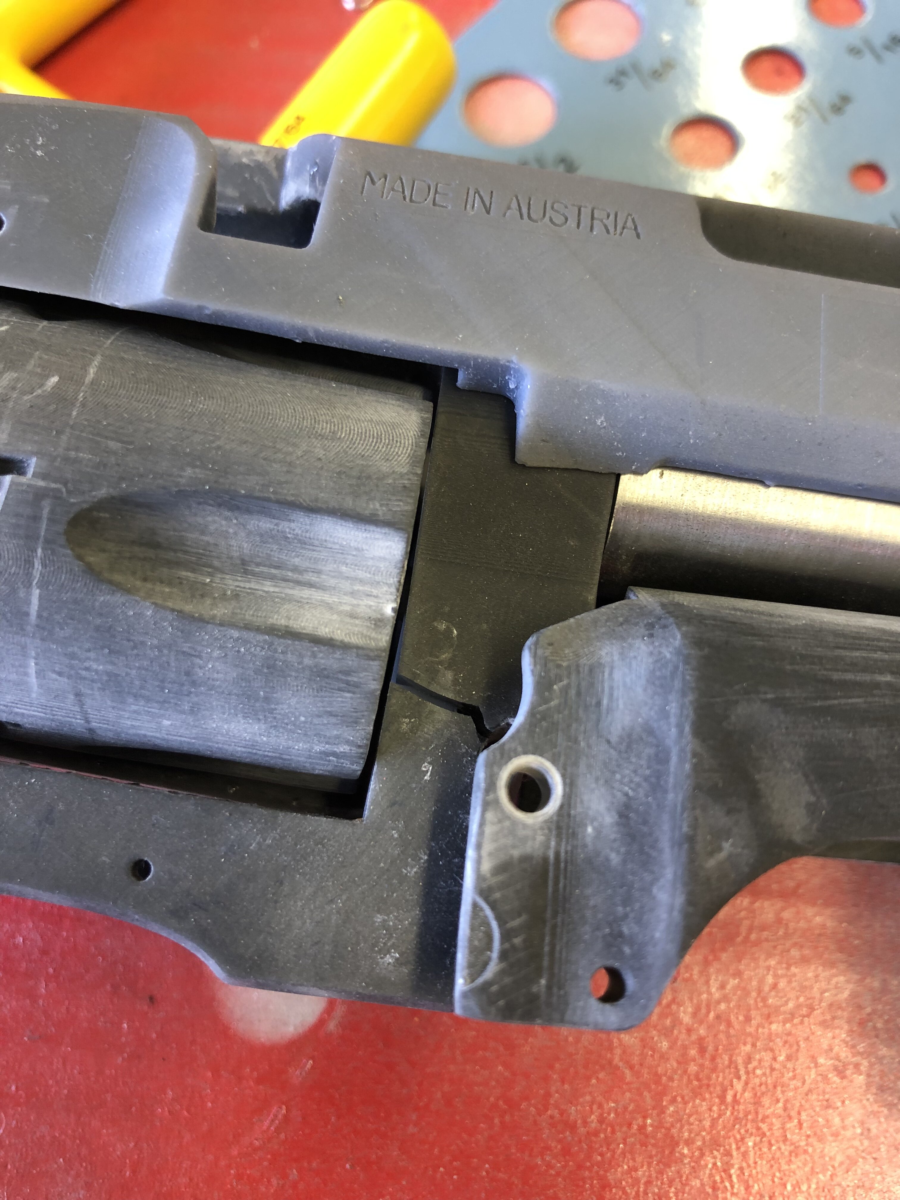

But, a couple setbacks occurred. I heard a crack at some point and when I got it apart I found a huge crack in the fore part of the grip frame and while gently fitting the bolt I snapped the handle off, so I’ve got a bit more work to do.

Sorry to see that.I heard a crack at some point and when I got it apart I found a huge crack in the fore part of the grip frame and while gently fitting the bolt I snapped the handle off, so I’ve got a bit more work to do.

I had thought to put a pin in with the epoxy, but it was hard to line up just right, so my plan is to install one from the back.Sorry to see that.
Too late now, I know, but with the Samaritan kit I've just finished, and in my dry fits of this kit, I've discovered that a tiny drop of sewing machine oil (or any other light machine oil) in the tapped hole before assembly lessens the friction of the screw a lot. The screws will still hold fine, but you don't get that nasty squeaking 'stick' ... or (at least in my case so far, touch wood) the stress that can lead to cracking. Of course I used oil when I was tapping the screw holes too.
From my experience with the snapped cylinder pin on my Samaritan, I'm pretty sure that the epoxy mend will hold fine, though. I used JB Weld on mine, but the they're similar in tensile strength I think. If you haven't already, I'd be tempted to pin the bolt handle together as well as gluing it... just to be safe.
