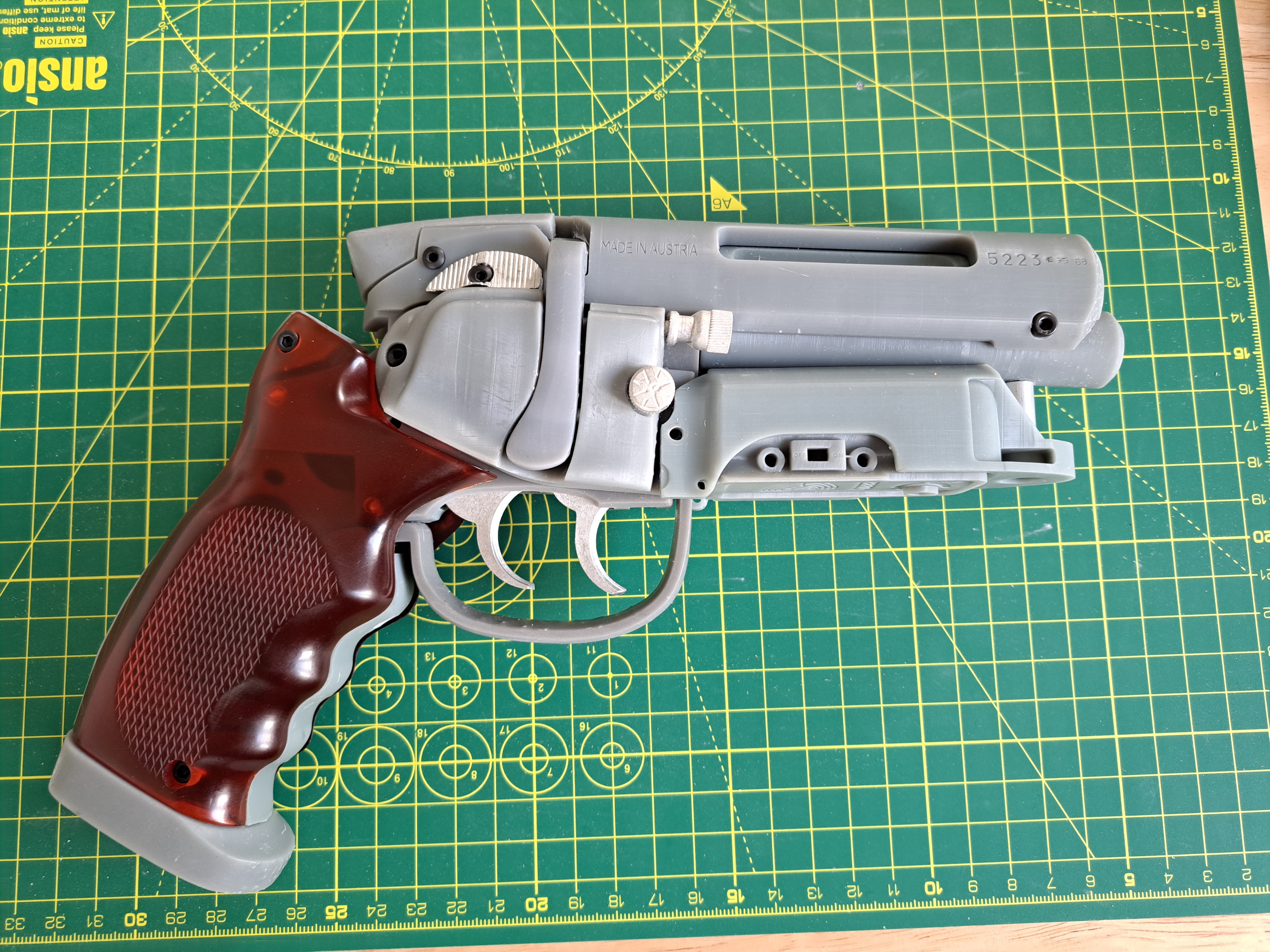

Not the most experienced with this type of thing but the initial dry fit was very easy and looked great! Felt sad taking it apart again haha
Lots of sanding and re fits to before painting.
Photo is from the dry fit I done as soon as it arrived.
I some how missed a screw on the clip next to the weaver bolt (which I will likely change for a slotted screw at some point). I'm guessing it's just a standard m3 hex screw?

Looking great! The 'missing' screw is indeed an M3 hex - from memory I think it's a 12mm.
