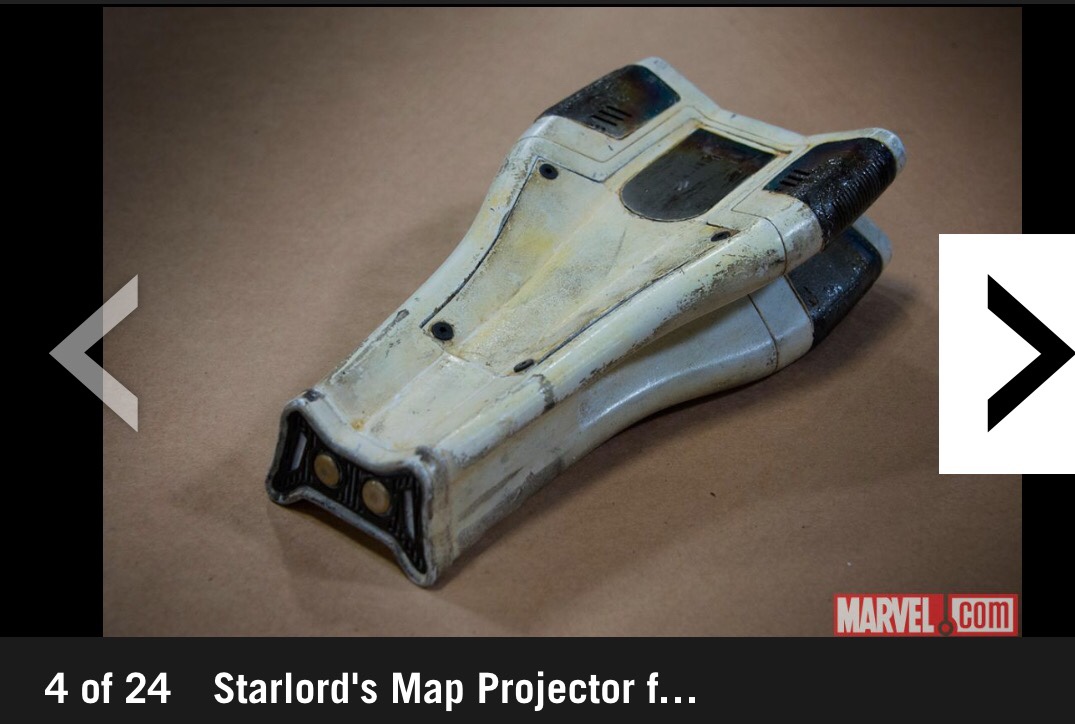

I used xtc on my one and the finish is almost perfect, slight sanding needed as it's impossible to get a dust free atmosphere and that stuff is sticky as hell and does take a while to cure however I love applying it to 3D prints, so easy :) just don't apply a lot of it, very thin layers over time does the trick. I want to paint my one soon and thought I'd post some photos from the film that I screen snapped (on my phone), if anyone has better please post and share your ideas for what colours of paint to use and lights to install. Let's get this finished up :) ImageUploadedByTapatalk1430157328.148595.jpgImageUploadedByTapatalk1430157336.879014.jpgImageUploadedByTapatalk1430157347.380560.jpgImageUploadedByTapatalk1430157354.531661.jpg

Any off-white should do as a base, then use "Tamiya nato black" on the grey parts. A laser pointer will probably work great in there. I don't know if I would try the projector myself... it IS tempting though!
