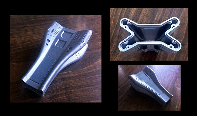

I'm back from LA. Had an overfull schedule while there and only my ipad, sithonly so-so internet, so I didn't have time to hang around here much. I am however back on this. Test printed the new, longer body this weekend and it looks MUCH better:
New shell on left, with bottom "button" printed in grey plastic sitting loosely in the socket. (The bottom button has a loop underneath for adding an axel, enabling you to make it into a functional on/off button, kind of like a see-saw, for any lights you choose to incorporate, saving the hassle of an external on/off switch. Note that I don't guarantee this button-functionality, but it's there for anyone that wants to experiment!) New shell with bezel loose shown top-right. Old shell with test-fitting of the battery cover shown at lower-right.
I am just about ready to start accepting payments on these within the next day or two. Everyone on the list should expect a PM soon.
Answered this on my iPad last week, but it crashed so here goes again. The superglue method will not be needed (or even work at all) with this kit. This is hard, non-porous PLA plastic and superglue does not "soak" into it. You can still use it to glue of course, but it would be useless as a smoothing agent. (Protip: nothing glues PLA better than solvent-based plexiglass cement such as "Acrifix 116". It works just like modeling glue does on styrene, by welding it together.) This plastic is readily sandable straight off, unlike the horrible white nylon stuff many commercial places use. That stuff will even turn away a buzz-saw! (The superglue makes the nylon brittle, thereby easier to sand, though I still prefer filler-primer for the nylon stuff.) I have sanded this plastic smooth without any filler at all... it just takes longer than using the filler-primer, which is why I usually use it.

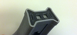

The details of that piece were finalized as of post #33. See the image there. I decided however that it needed to be a tad thicker. The one below is a 2.5mm test, printed in grey plastic (longer handle butt-end shown). The final kit copy will be about 2mm thick.
As for length, the new longer-handle version is actually a few mm shorter than the first print. The first test print was actually too big to comfortably grip, so I scaled it down by a few percent. (I also thought is was a tad big compared to the movie, even if Chis Pratt has large hands.)

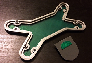

One more image. Here's the first print of the translucent plastic. Some print lines are visible, but that's inevitable when the plastic is clear, the way this is done. (Though in this instance, the lines serve as a nice diffuser for the light, light the tails lights of a car.) Based on how this turned out, the final kit will have BLUE translucent parts, not smoke colored. (I just didn't have any blue to test with at the moment, so I had to use green.) Since I don't usually use this color, I will likely only order just a little more than enough to cover the run.
