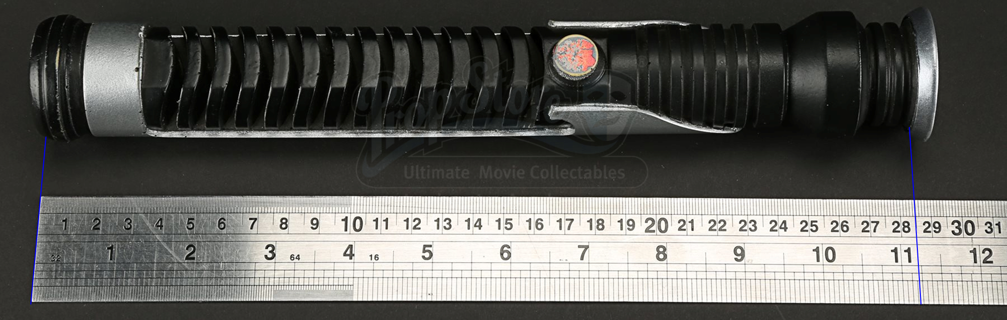

Even if you ignore the saber not being even with the left edge of the ruler in the photo below (though I think it does extend past it), this resin saber is at least ~290mm by my eye:

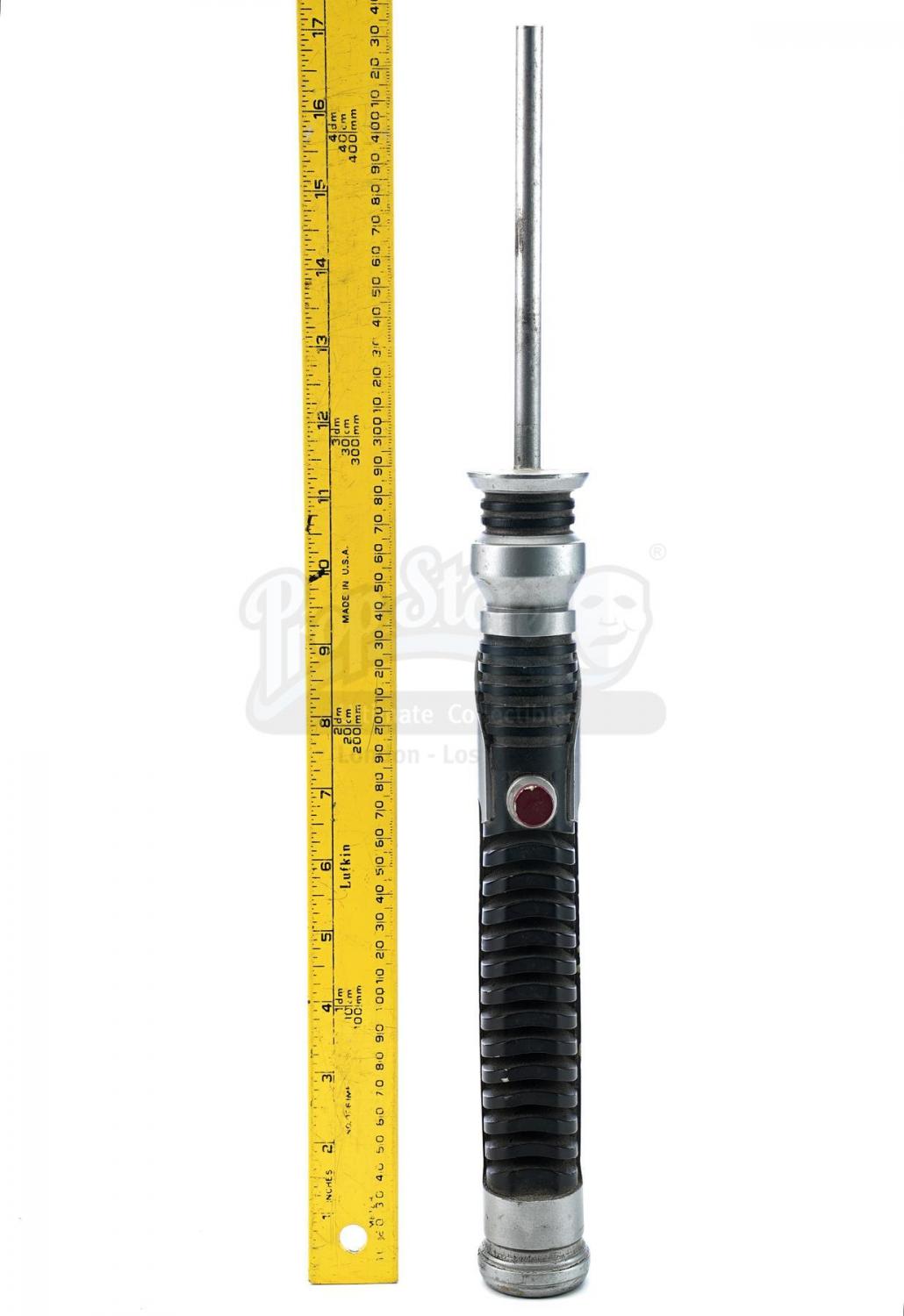

This one is also ~290mm

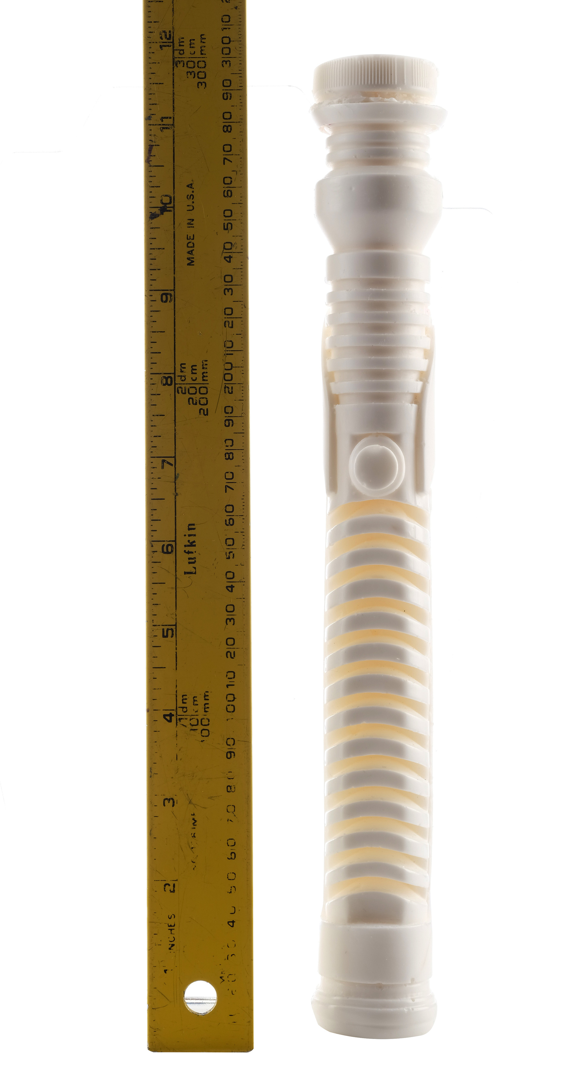

This one is ~280mm:

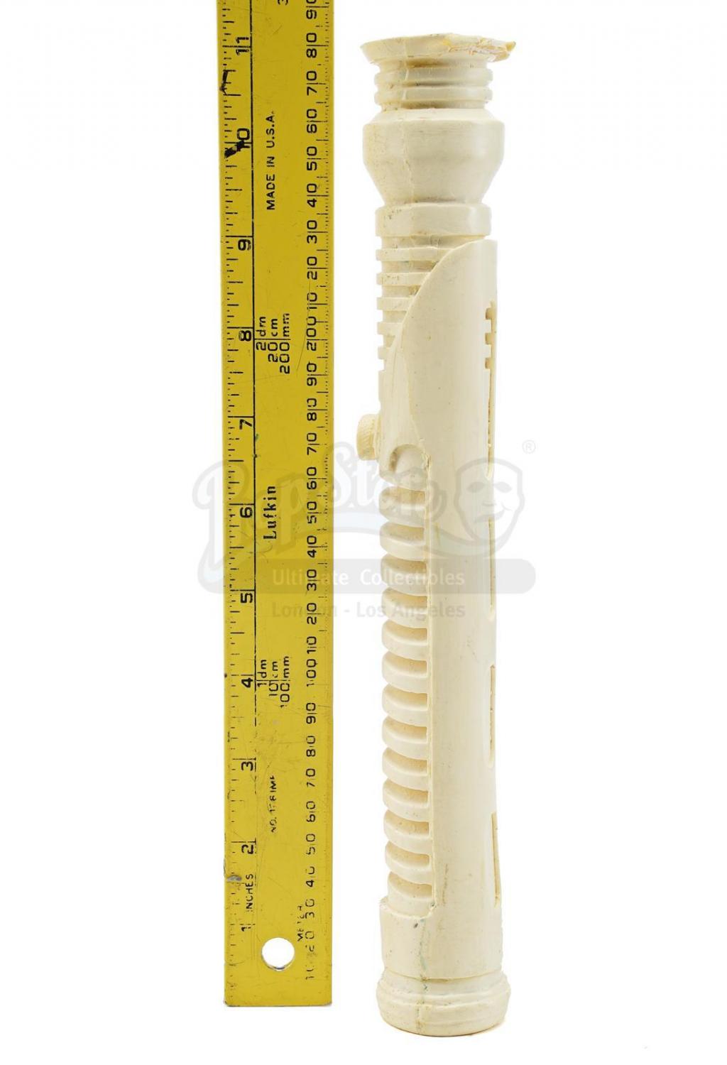

This one is somewhere in the 280-290mm range:
My guess is they were using different types of resins that shrank different amounts. It’s also possible the shorter sabers are 2nd+ generation casts, though I think that’s less likely.
That first one looks very clean, but closer to ~287mm as I see it. Second one is perhaps closer to ~285mm once you slide it right next to the ruler? I tend to think getting all the way to 300mm is out of the realm of plausibility.

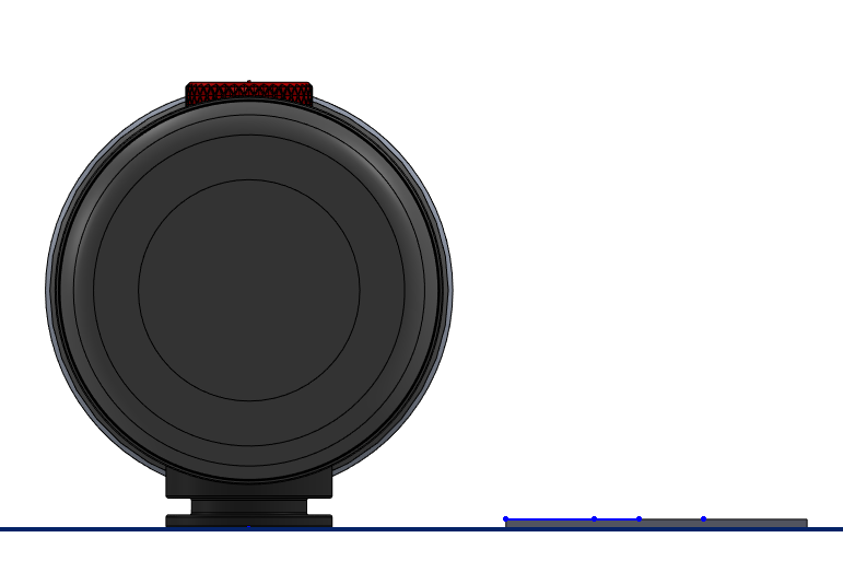

First I dropped a model of a ruler into the model of the saber. Remember this is parametric CAD software so there is no scaling, something modeled as 1mm is always 1mm.
Notice the blue lines extending from the end surfaces of the hilt down through the ruler. Model clearly measures 299mm.
Another view showing that the saber and ruler are sitting on the same "floor":
My attempt at recreating the perspective of the photo:
Notice where those blue lines on each end of the saber fall. I have not moved them between any of these pictures.
