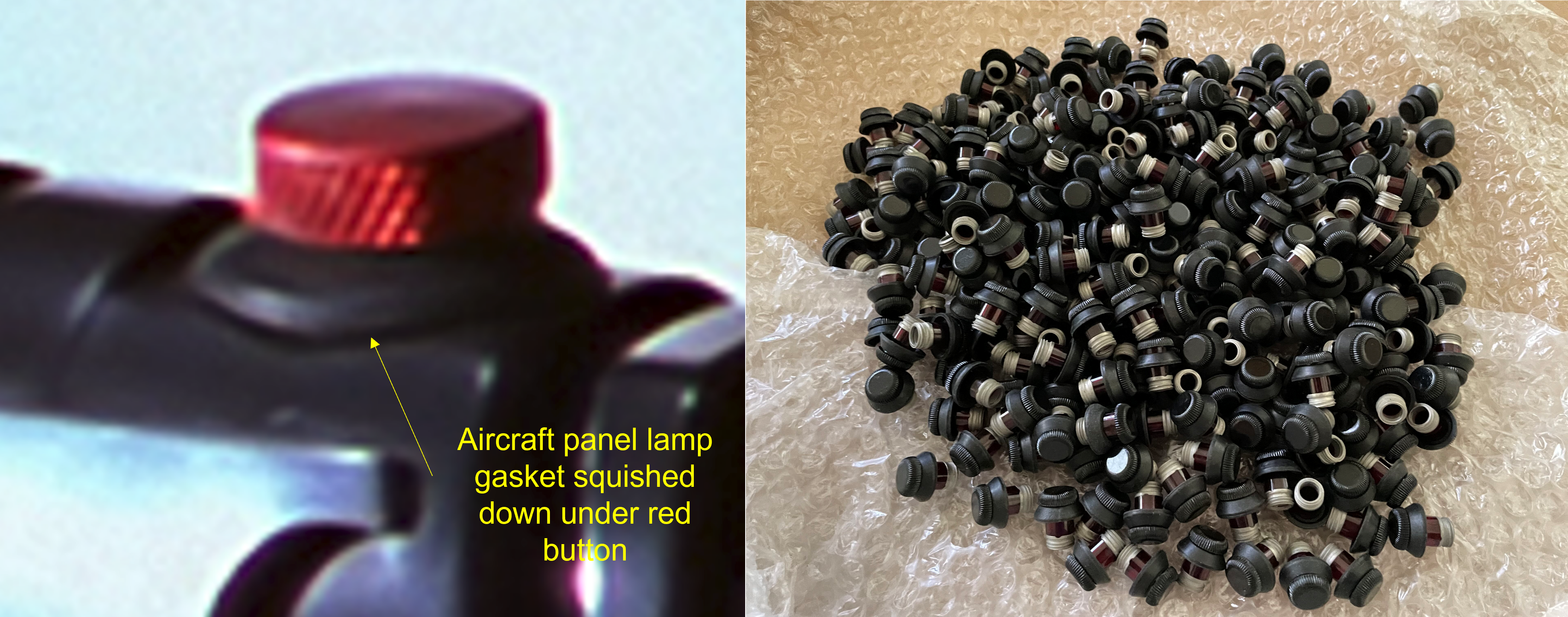

Speaking of authentic materials, each replica will include a 100% authentic aircraft panel lamp gasket under the red button just like the original prop:

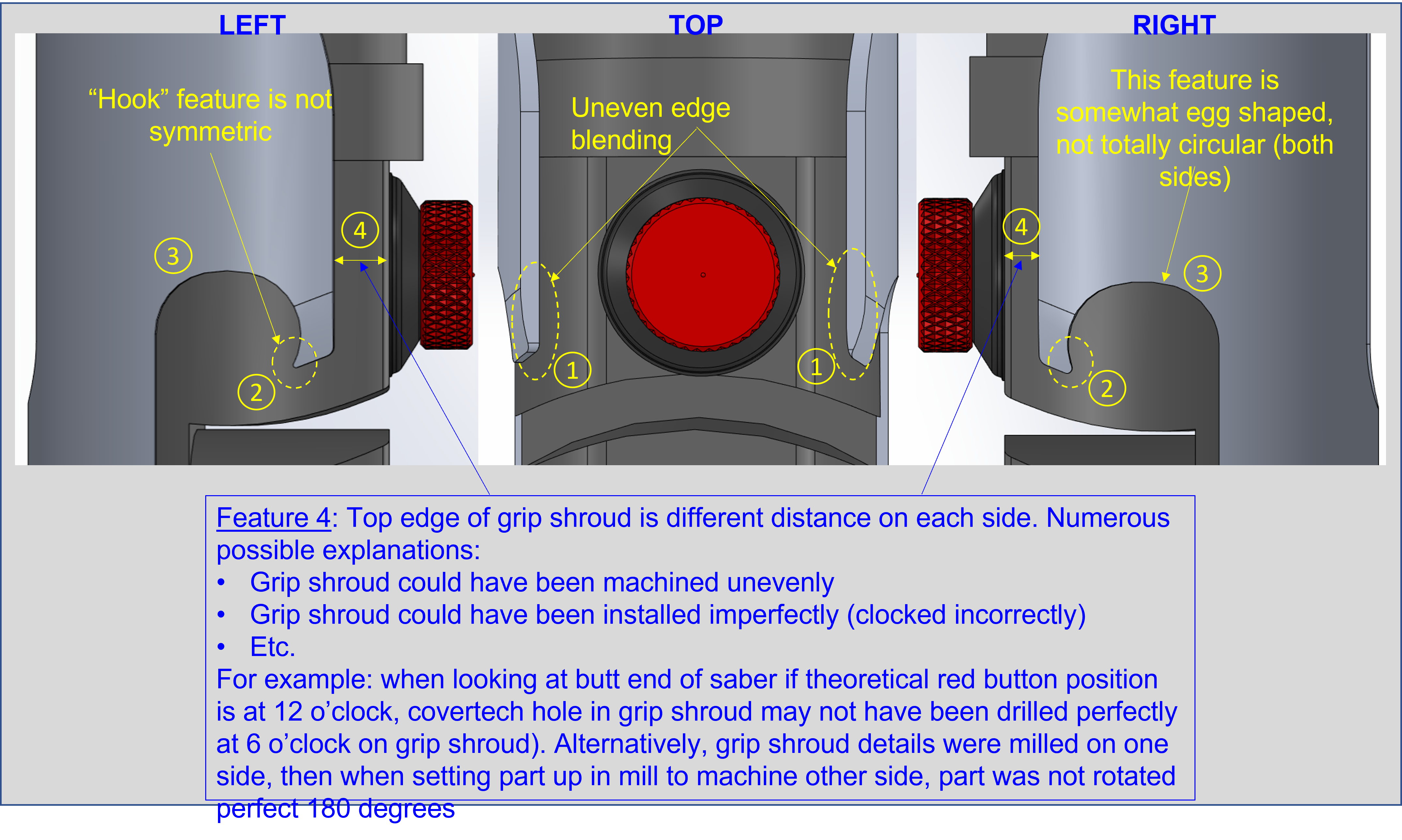

This model is still very much a work in progress. In some ways this saber has been even more challenging than the Obi TPM saber. This saber features some more organic shapes and curvatures that can be challenging to parametrically model. Similar to the Obi TPM saber, there are a combination of features that were originally manufactured into the saber, and features that are a result of (I believe) the saber being “spruced up” for certain shots during filming. For example, the feature in the image below was almost certainly not on the prop when originally made for filming as none of the resin stunt sabers have these features:
Some more of the intricate details:
Pommel:
Emitter details:
Again, this model is still very much a work in progress, but we're at the point where open discussion and more sets of eyes are needed. I will post some more model pictures later. In the meantime, I wanted to ask the community what details and features are important to them? From what I've shown above is there anything that looks off to you?

It looks like someone tried to put a groove in the pommel above the mid-band, but its very shallow. Don't see that on the model picture to the right of it.

It's interesting that the overlay image would seem to indicate that the emitter ring on this saber is off center, similar to the Obi saber emitter plate. That may just be a problem with how it's all lined up, since as you said it's still WIP, but if your model parts are all centered with each other, as they appear to be, they're off in opposite directions from the reference image.
It is super cool that you're capturing all the tiny details. Can't wait to see more.

This particular image I’m using for an overlay is poorly cropped on some of the edges and parts of the saber are clipped off.

As far as details I’m interested in is the asymmetry in general, and the hilt being a static only model, like the actual prop. Specifically I think the hooks on the shroud and the activation button have never been done correctly.
