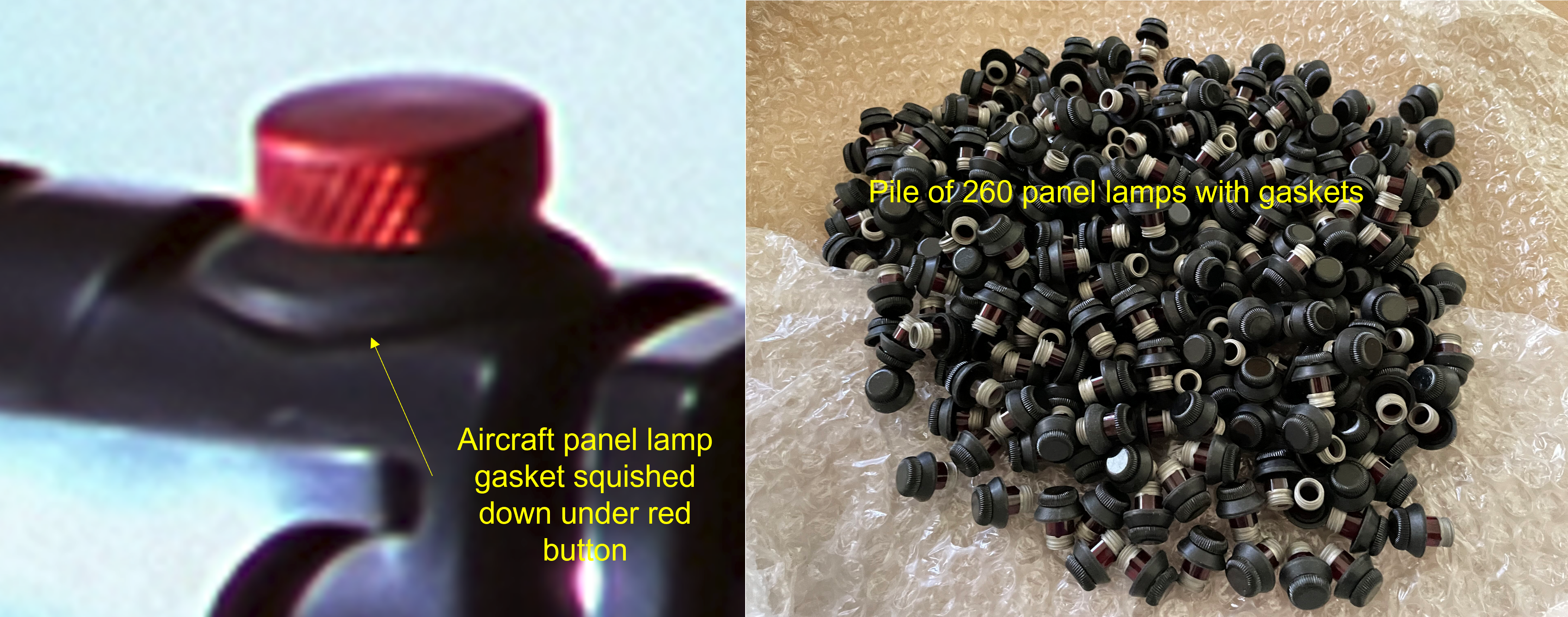

Speaking of authentic materials, each replica will include a 100% authentic aircraft panel lamp gasket under the red button just like the original prop:

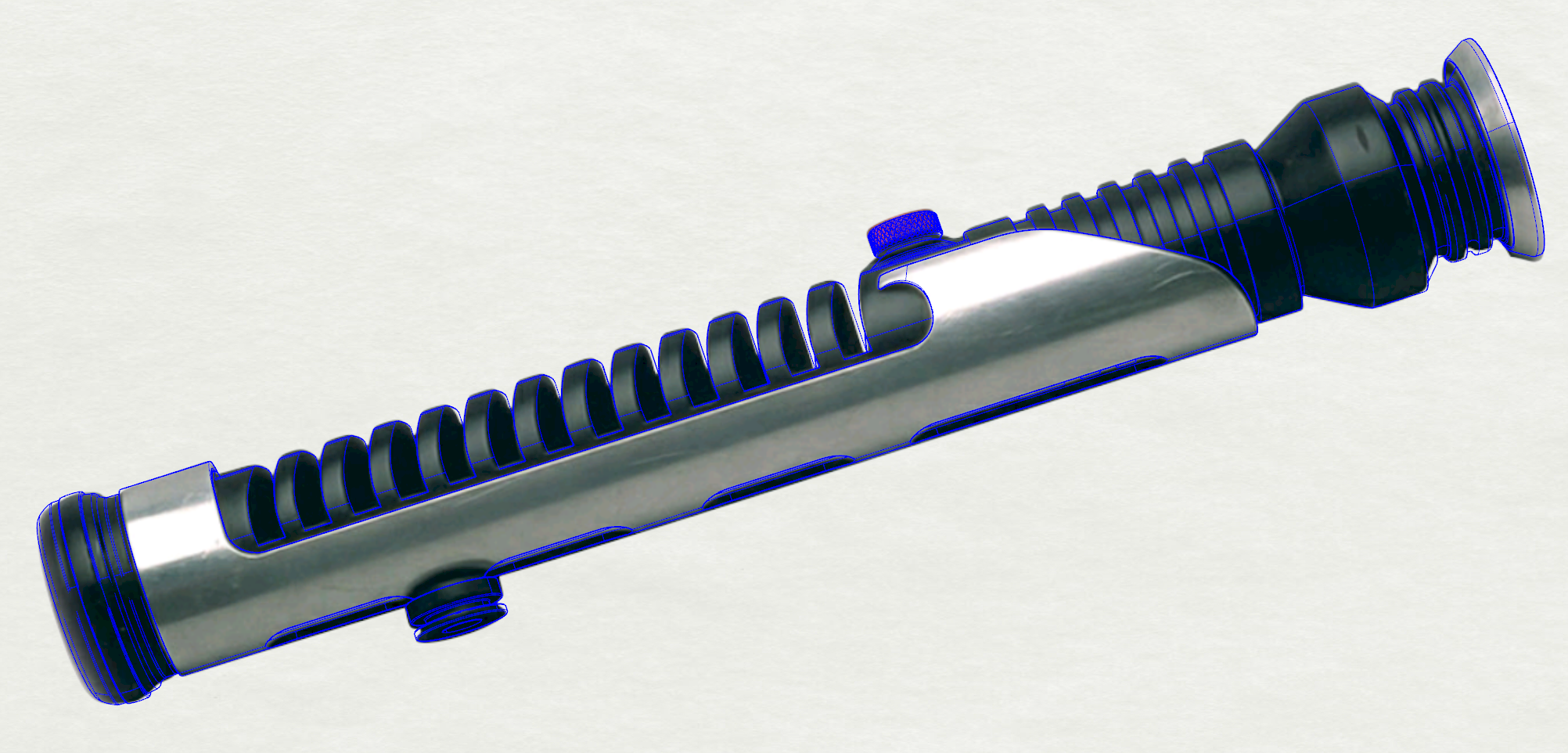

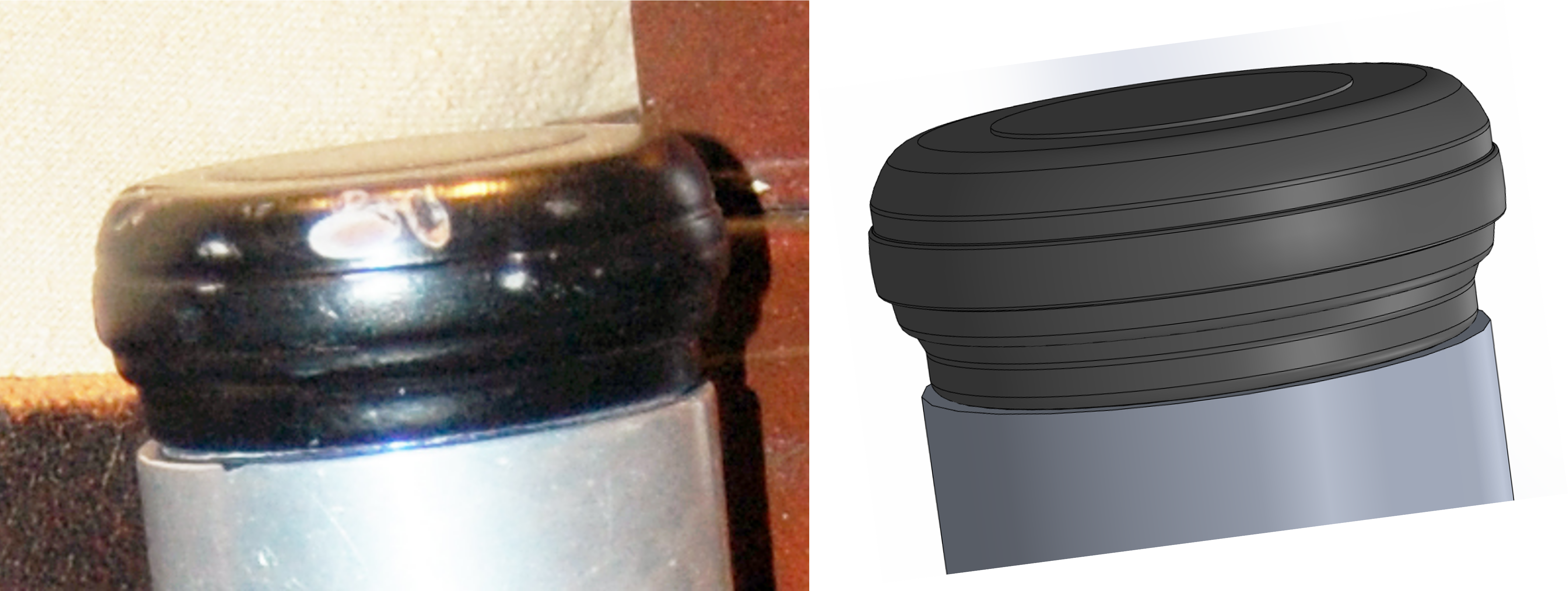

Overlay to hero prop:

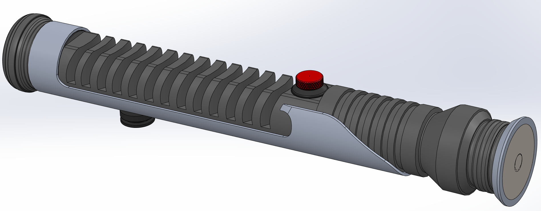

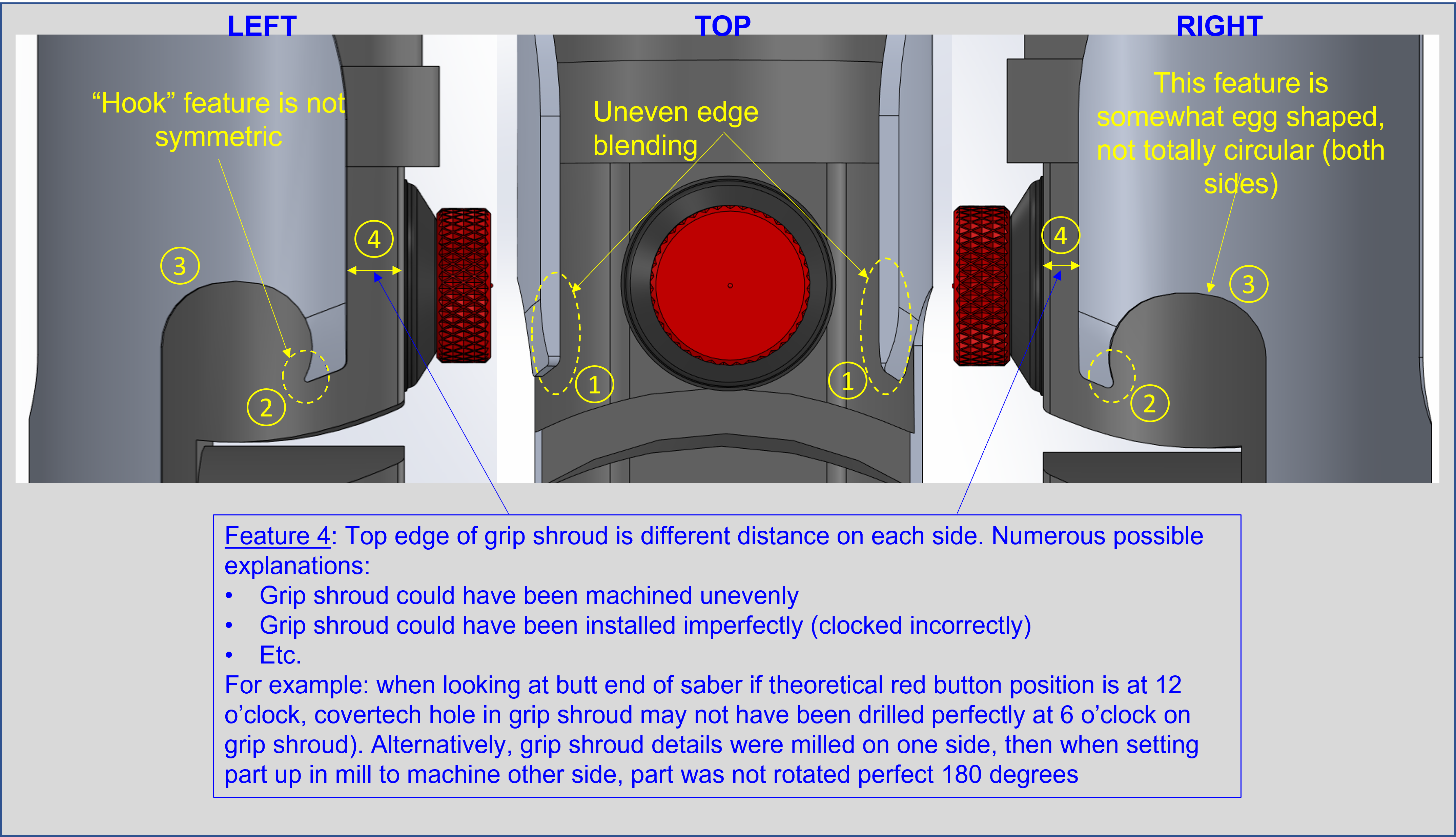

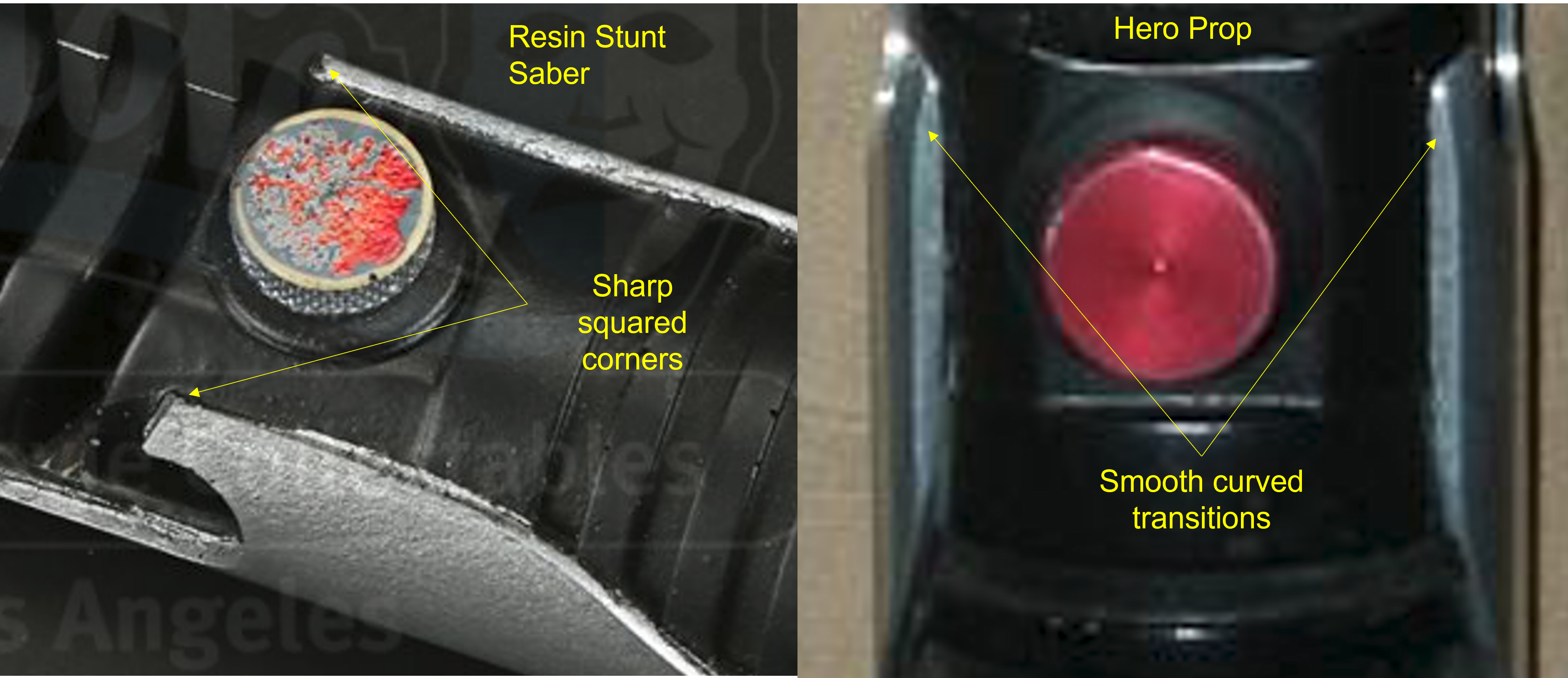

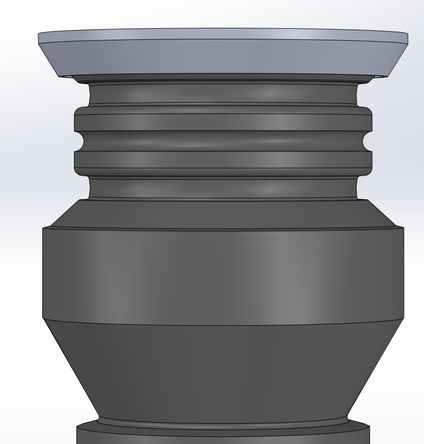

This model is still very much a work in progress. In some ways this saber has been even more challenging than the Obi TPM saber. This saber features some more organic shapes and curvatures that can be challenging to parametrically model. Similar to the Obi TPM saber, there are a combination of features that were originally manufactured into the saber, and features that are a result of (I believe) the saber being “spruced up” for certain shots during filming. For example, the feature in the image below was almost certainly not on the prop when originally made for filming as none of the resin stunt sabers have these features:
Some more of the intricate details:
Pommel:
Emitter details:
Again, this model is still very much a work in progress, but we're at the point where open discussion and more sets of eyes are needed. I will post some more model pictures later. In the meantime, I wanted to ask the community what details and features are important to them? From what I've shown above is there anything that looks off to you?

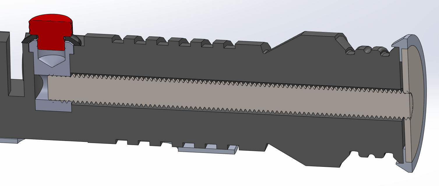

Speaking of assembly, I have been playing around with different assembly options.
The simplest solution would be to just have the red button thread into the black grip section, and to have the emitter parts threaded onto the M10 rod, which is then threaded directly into the black grip section (which would have an M10 threaded hole). The problem with this is the blanking cap really doesn't have a lot of thread length to engage. Additionally, I wanted this saber to have a decent length of threaded rod to give it some proper heft, but the depth of the hole is impractical to tap for threads.
The alternative I was thinking was to have an aluminum "anchor" part that would be inserted below the red button. This would give the M10 threaded rod something solid to engage and would allow the red button the stuck out properly to match the hero prop. This anchor would then be covered by the black rubber hood that sits under the red button. Here's a quick visualization I mocked up:
This is probably overkill, and just one possible idea I played around with. I am interested to get other people's thoughts on assembly. I'm guessing for the original prop, the threaded rod was cast directly into the black resin section. I also think the red button was stuck on with epoxy or some equally sloppy method which is why the prop makers covered it up with the rubber hood from the aviation panel lamps.

This is full of very good points, I suppose I never thought about that threaded rod… maybe that it was tapped into the resin at the base but if it’s all one piece.. yes I suppose casting it in place is a good theory!
If tapping Delrin for the button is not that reliable, the aluminum anchor might be a great idea. As for the main rod, if there’s threading at both ends of the saber an empty hole for it to slide through wouldn’t be the end of the world. I mean.. yea an extra point to thread it into would be nice
I don’t have much personal preference now that I think about it, other than your idea of having a decent amount of threaded rod for heft and structural support
Edit: I just re read the post and realized with the grip grooves there’s no way a threaded rod went through the whole thing. Having some sort of threading at both ends of a rod, even short, is usually a bit more safe and secure

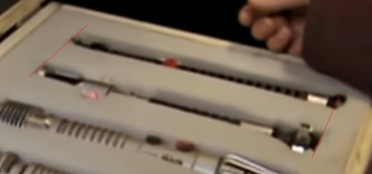

To help ease my mind, I went back to the only reference I am aware of that features the hero Obi TPM and QGJ sabers in roughly the same orientation side by side:
I took a screenshot and drew some rough perspective lines:
This is certainly not scientific, but this helped convince me that the QGJ was longer than the Obi TPM. In-fact they might even reference that in the video when they mention that Liam is taller.

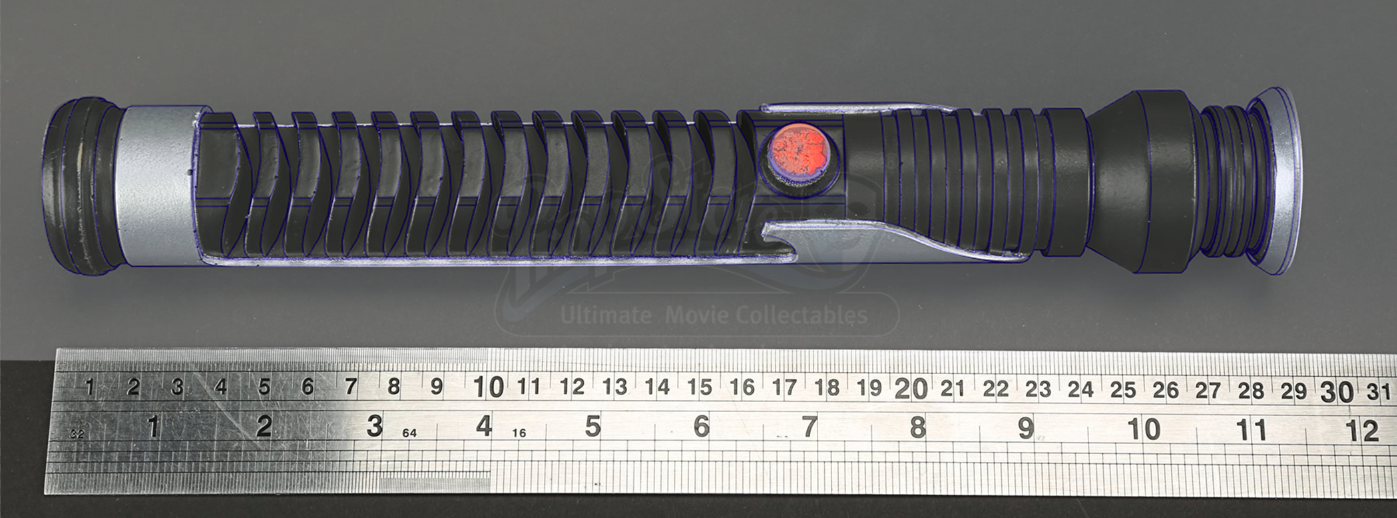

As I mentioned before my 3D model at ~300mm was lining up with the high res hero shots really well, but I still wanted to do an independent verification if I could. I normally don't like to do any scaling from the resin stunt props as who knows how much shrinkage/warpage exists in the castings, but in this case I felt it was warranted purely as a sanity check. In the image below I approximated two measurements from the stunt saber:
  1. From the left edge of the ruler to the vertex of the ellipse of the emitter end of the saber = 294mm
  2. I then found the vertex of the ellipse at the pommel end of the saber and estimated from scaling that the saber is ~5mm beyond the edge of the ruler. This means that, by my crude estimates, the overall length of this particular resin stunt is ~299mm.

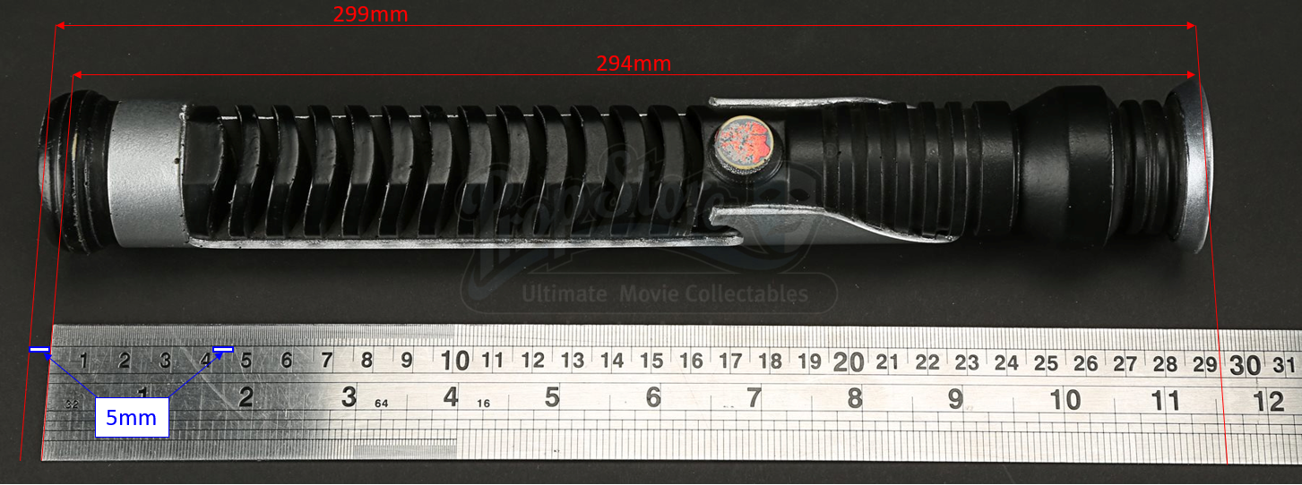

Now, I'm fully aware that this doesn't truly account for perspective, distortion, etc., this is just a sanity check. So to complete this check I did a quick overlay:
I definitely could have done a better job matching the exact perspective and rotation/orientation of the saber, but seeing as this is just a resin stunt saber I didn't want to spend too much time on it. That being said, I'm pretty darn happy with the results.
I'm going to do more sanity checks, but it is looking like the overall length of this replica will be ~300mm. Does anyone have an MR LE or CE they could take some measurements from for comparison?
