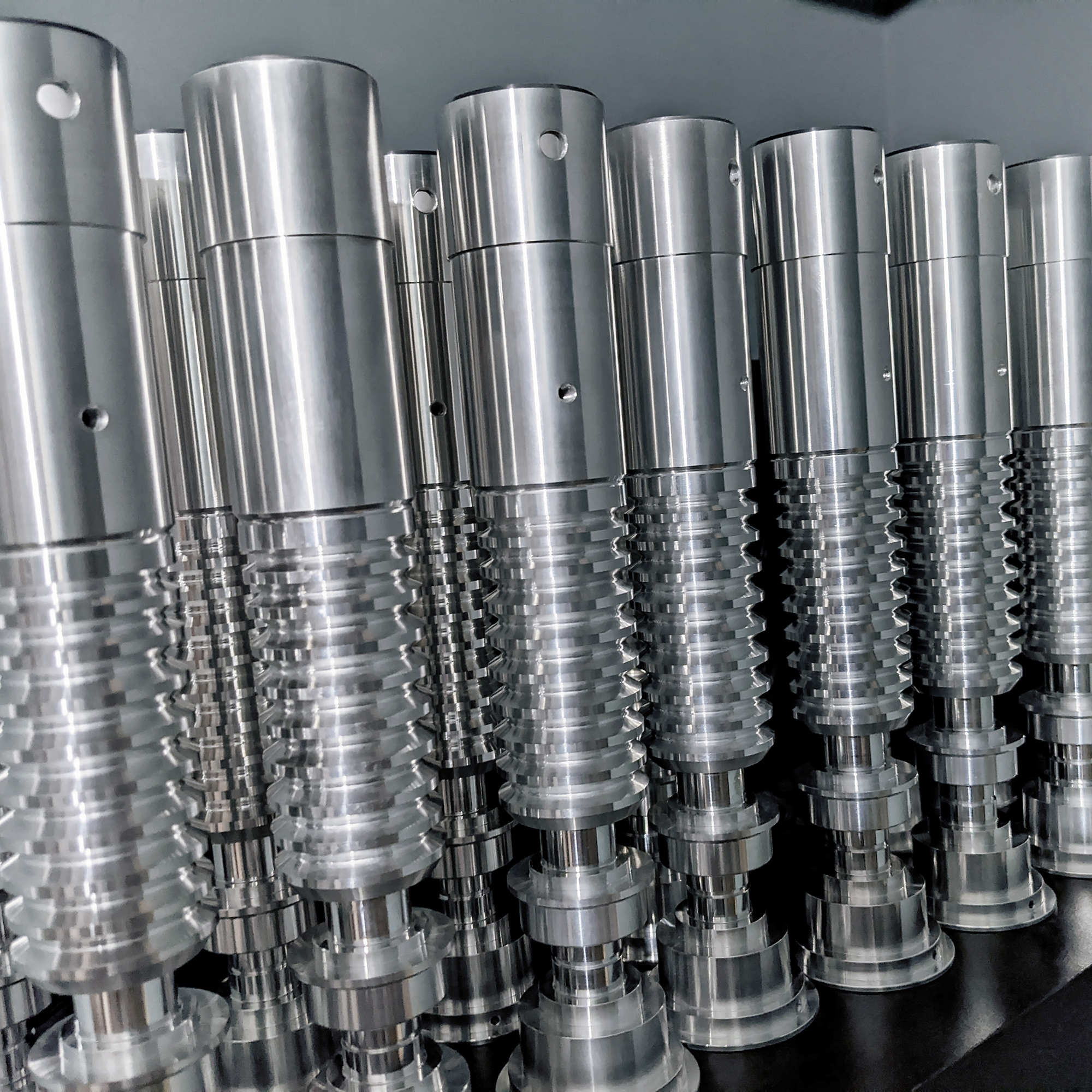

The first batch of commissions is underway! All parts are prepped, ready for darkening/stencilling/painting next week.
There are now X9 ROTJ V2s and 11X Obi Stunts in this first batch. All V2 emitters have been removed and dented, and pommel damage has been applied. General clean up of parts too, including softening of sharp edges on the rings:
Obi Stunts have been prepped, ready for painting next week too. The Switch hole has been de-threaded and set screws added to secure the motors bellow the clamp. As I've mentioned before, I suspect that these are present on the original prop, and wouldn't be happy sending these out with motors installed without including them. They haven't been included in the ROTJ hilt simply because I don't have any concrete evidence of their exact location.
The bearings have been installed in these already, and I'm considering installing the nipple (masked) before painting. I think that will have the best results. I'll be taking plenty of pictures along the way and will document the process of course. (y)

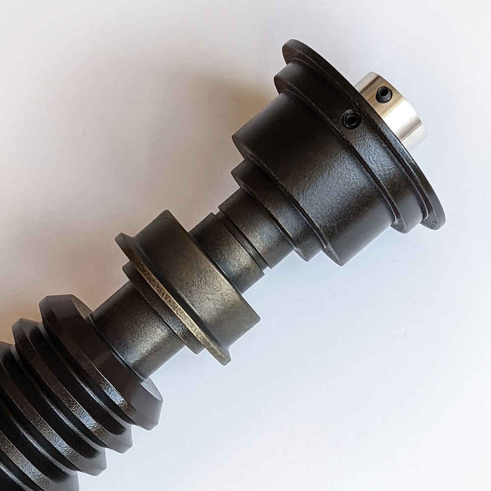

Here's one of the ones that I've Dry brushed so far:

Dave what paint did you use, is it a spray can or airbrushed paint? Looks awesome.
Thanks John!
I used this Acid etch primer as a base:
Followed by my usual matte black (Rustoleum Painters Touch Matte Black)
The brown on the neck is Halfords "Brazil Brown".
Then I dry brushed the neck with Vallejo "Bright Brass" followed by Tamayo Weathering powder (set B - Soot) to dull it back down.
Hope that helps :)

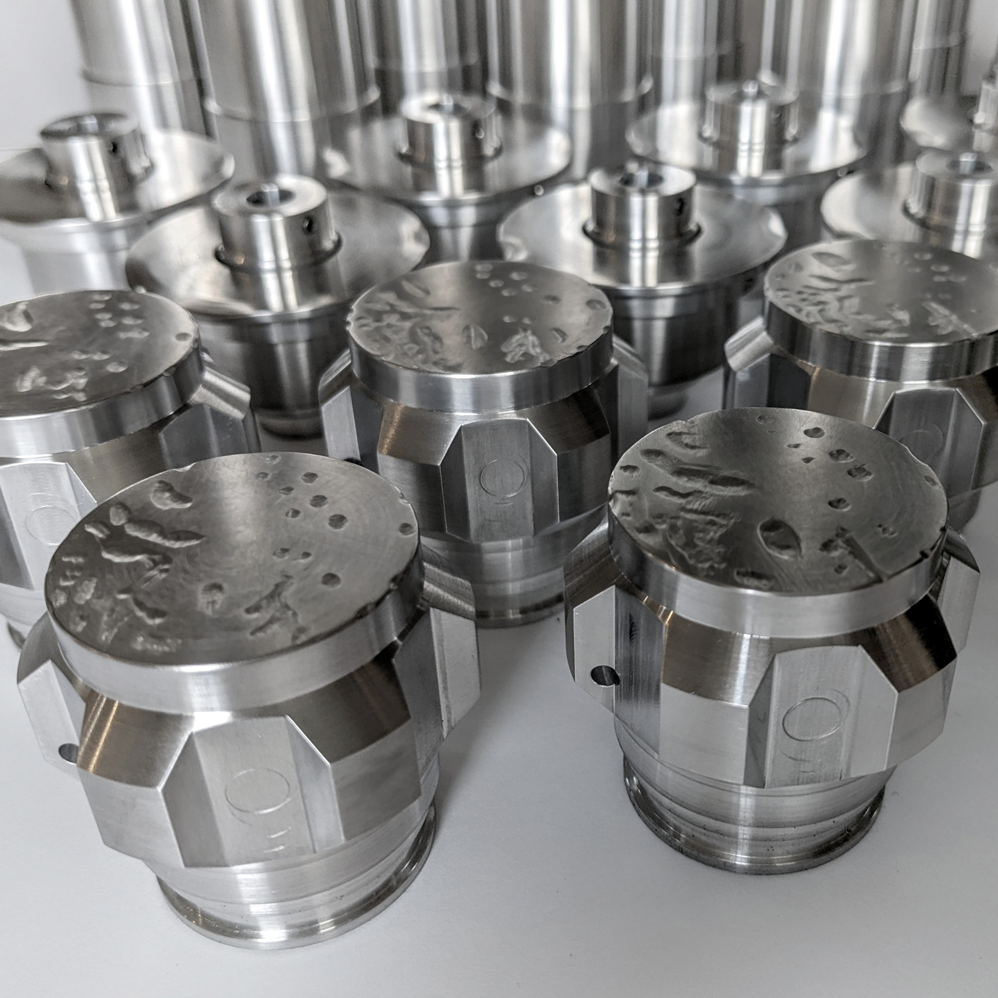

Most of the defining features/marks/scratches are on the pommel:

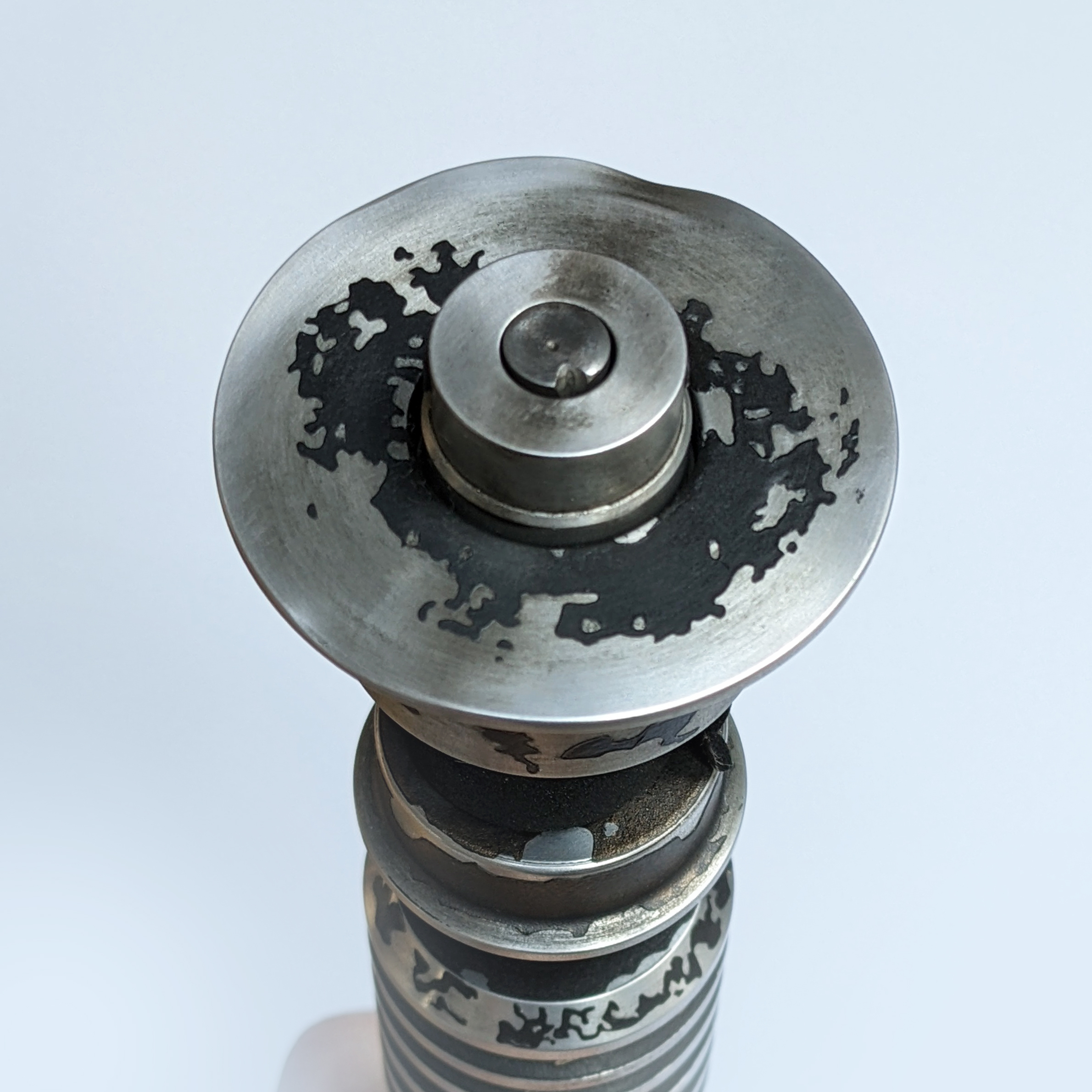

There is also gouge in the booster that some people have decided to incorporate in to their commissions:
The end results are looking great and I should have them all pretty much finished by the end of the week all being well (please excuse the incorrect lever for now):

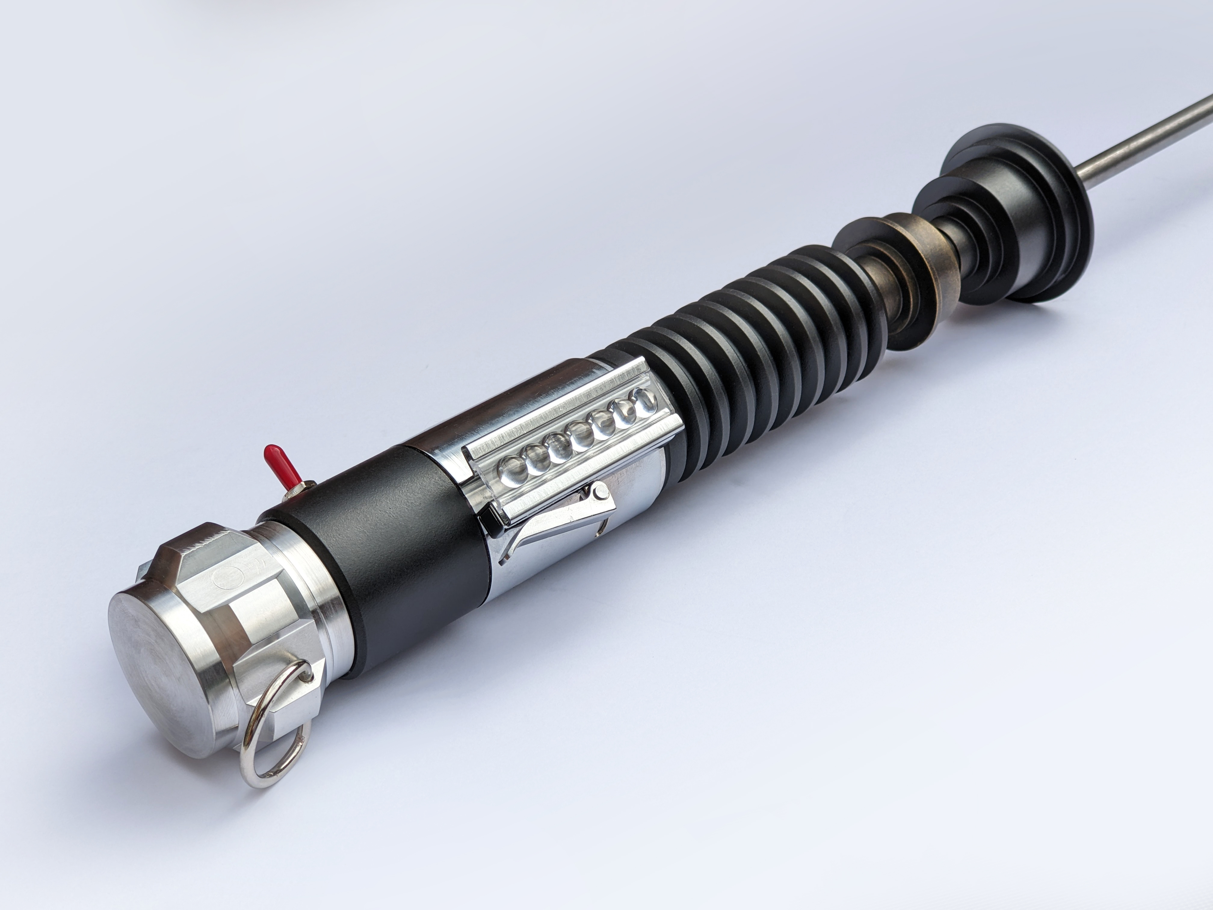

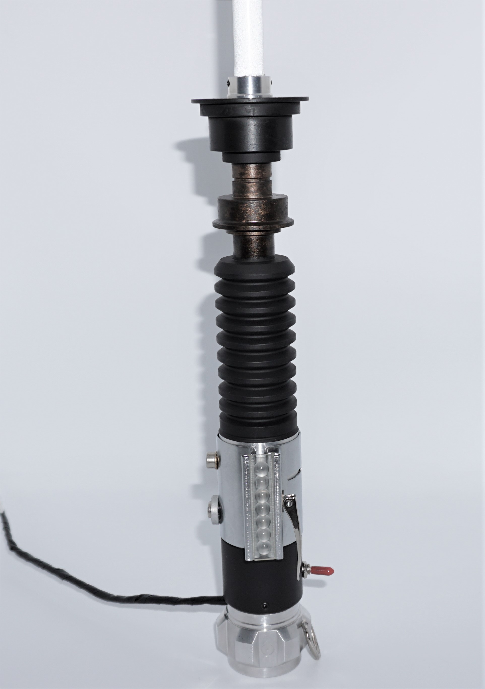

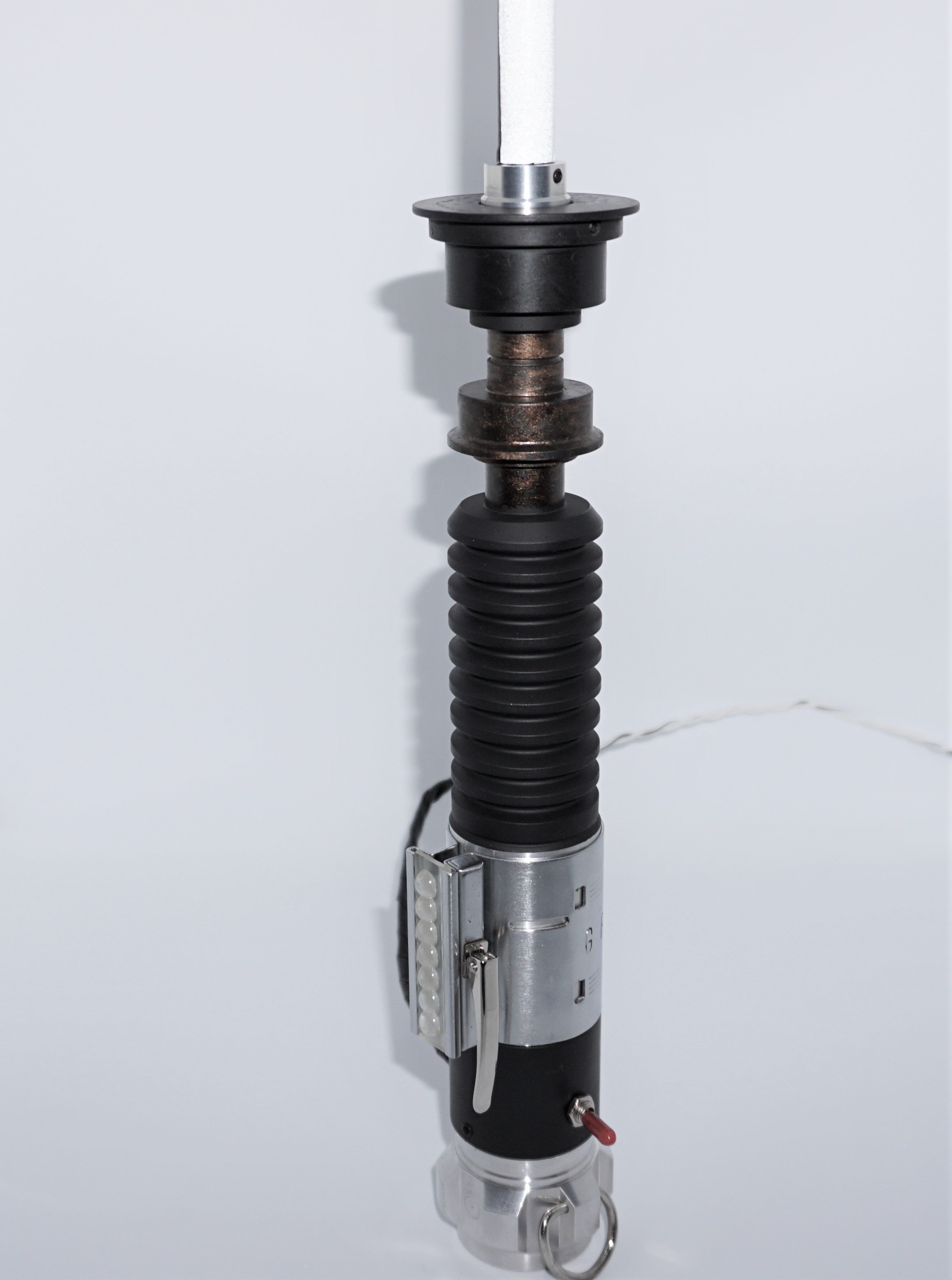

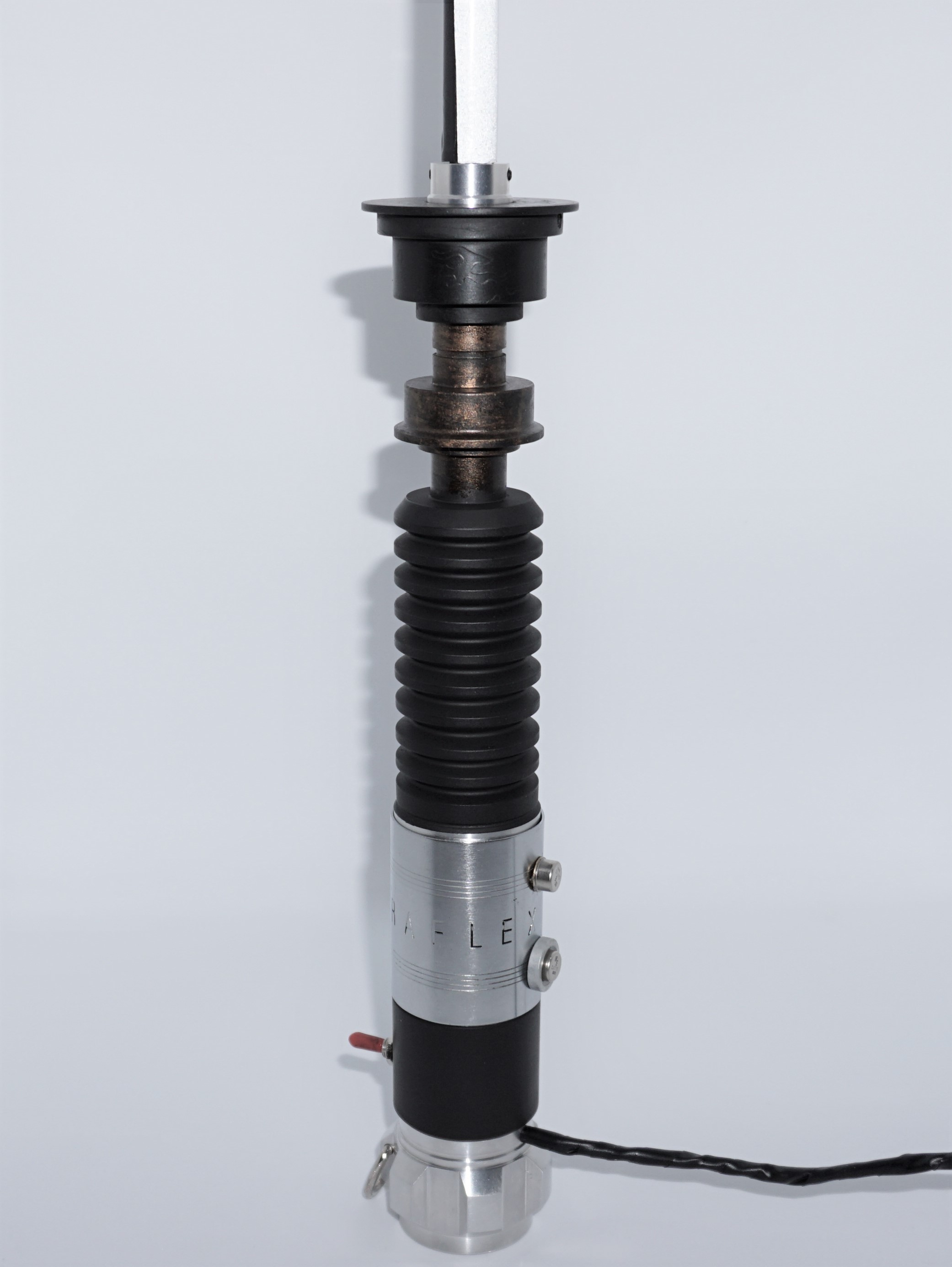

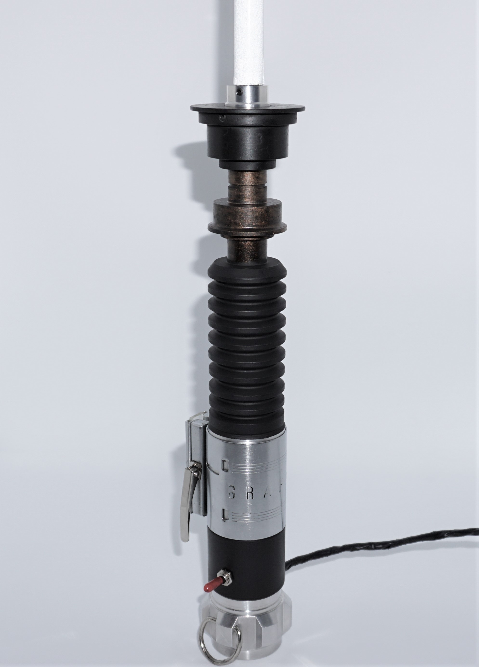

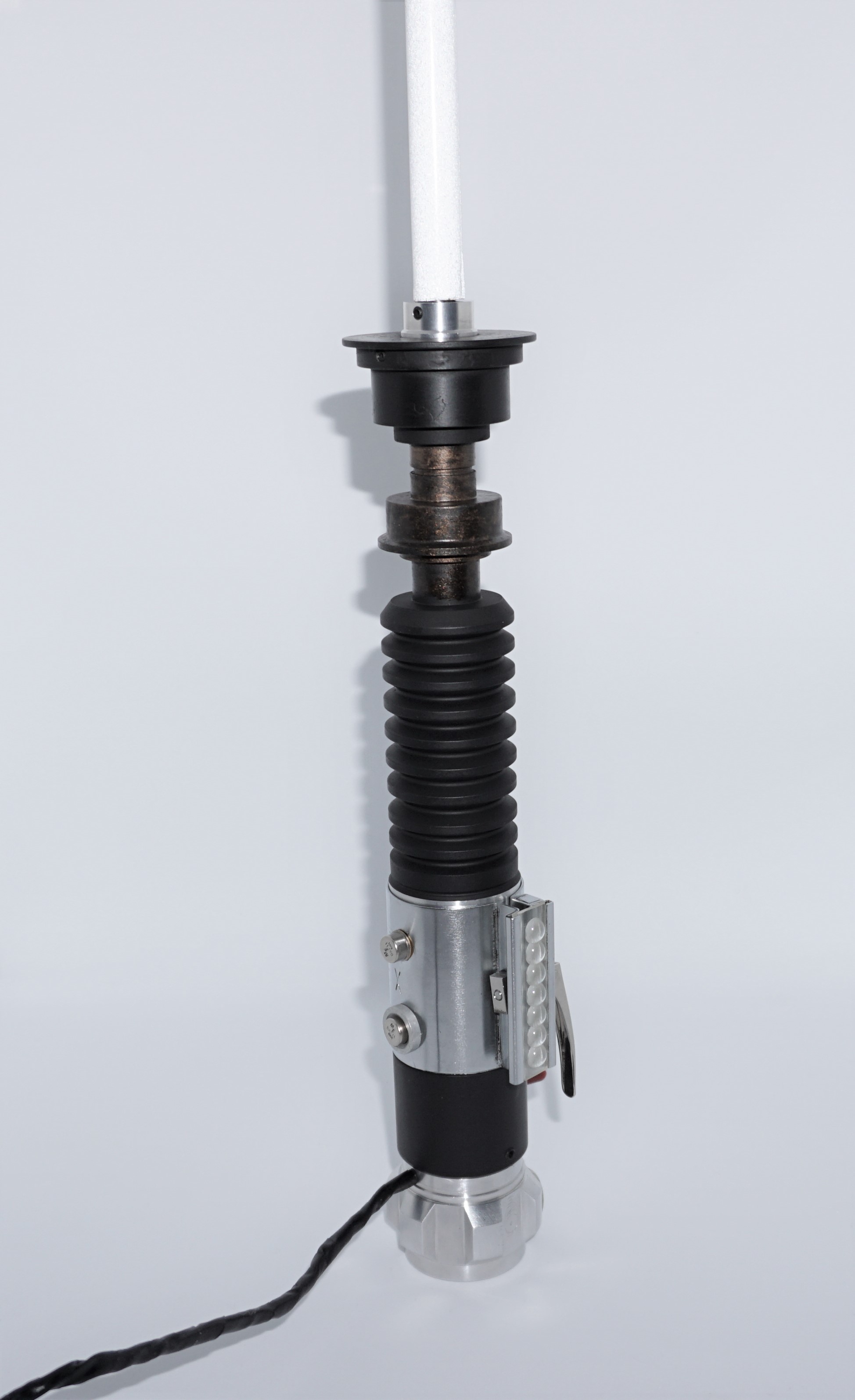

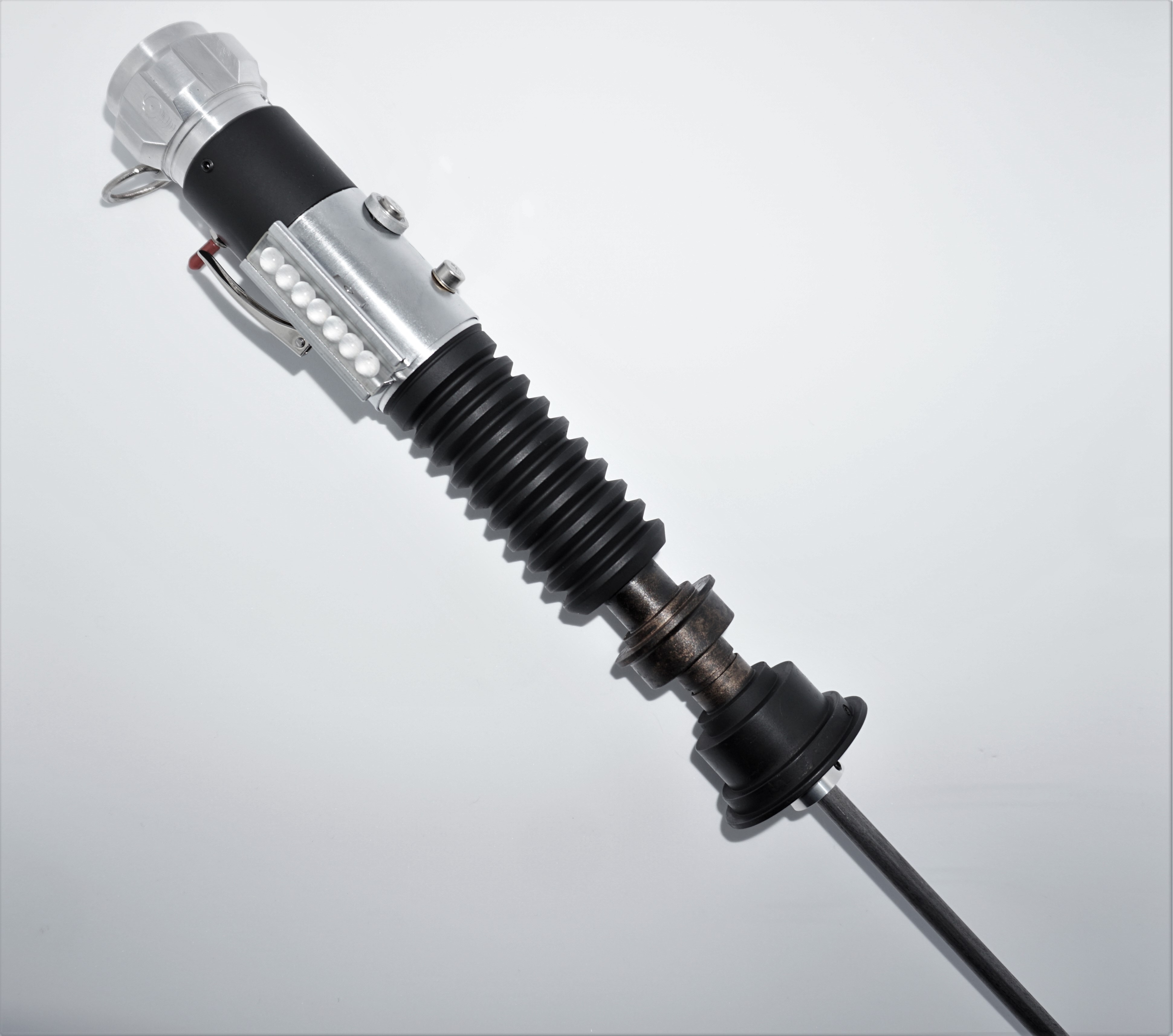

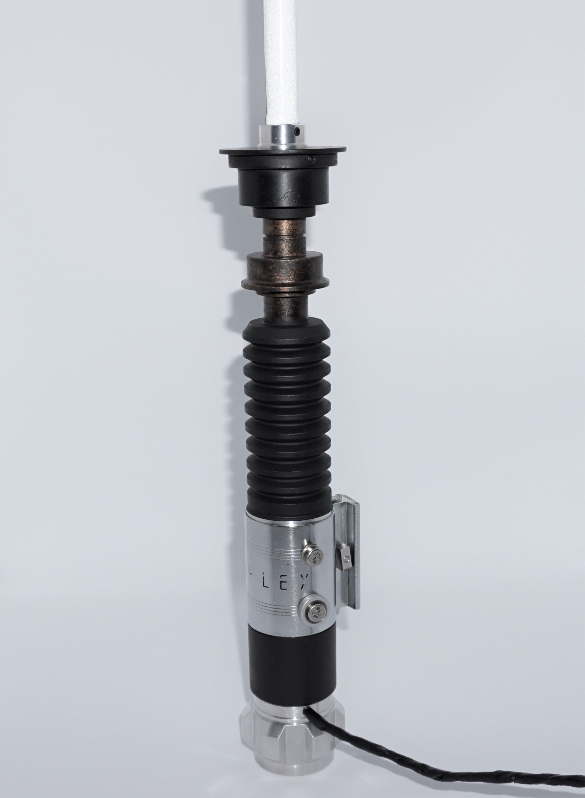

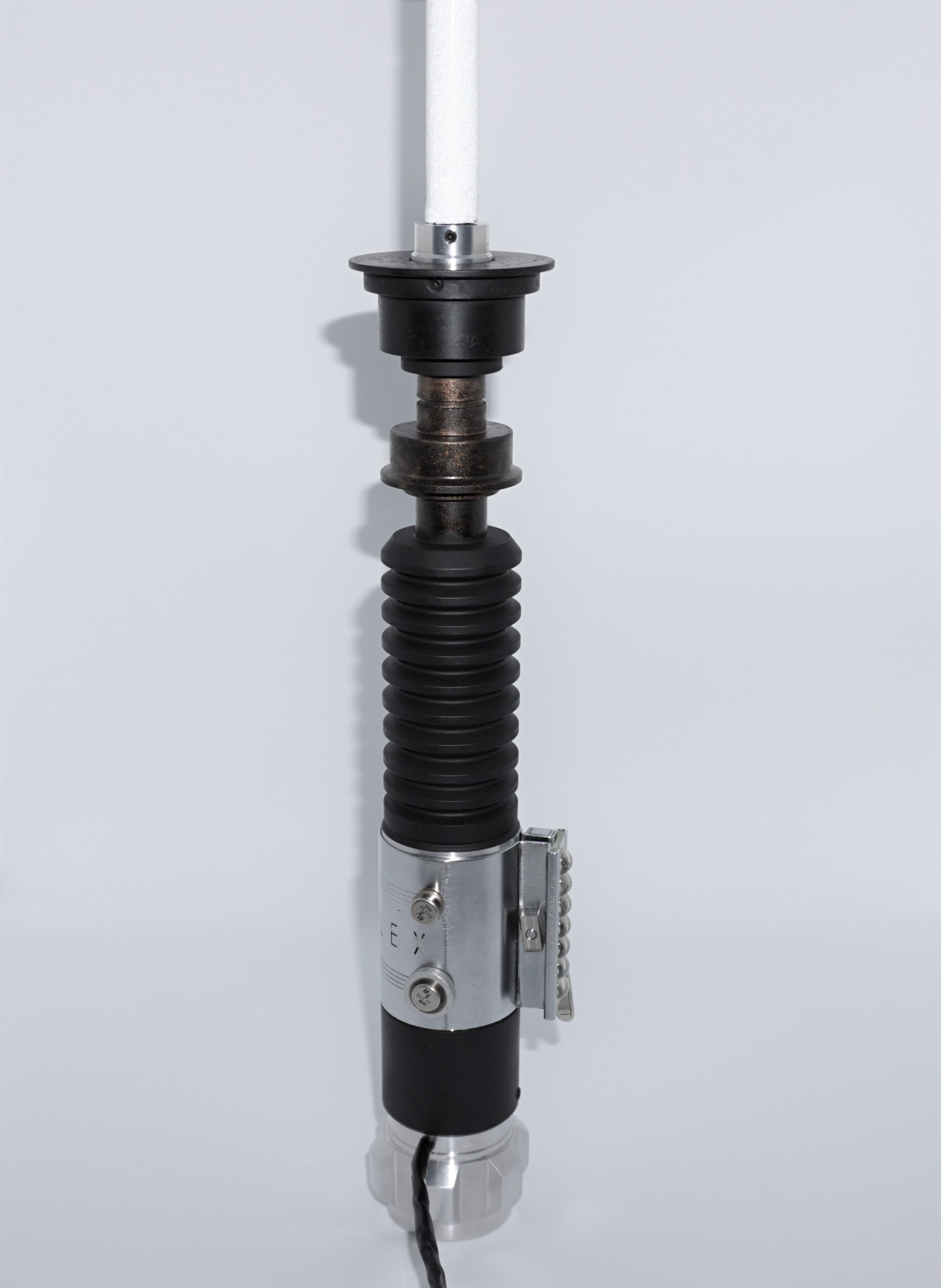

I should be done wiring up the rest of the Obi Stunts this week (tomorrow hopefully). Here's one that's just about finished, apart from the incorrect lever.
