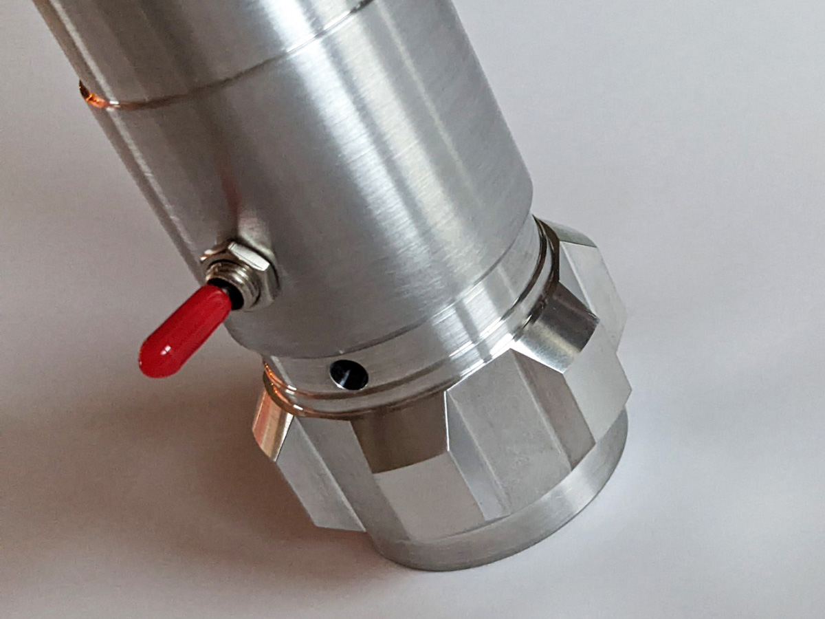

It has come to my attention that, while the switches and the cone knobs are both 6mm, they actually have a different pitch on their threads (this is because the nuts on the switches are shallow, so require a shallow pitch on the threading). For this reason, I have de-threaded the hole on all motorised kits (All kits that come with a switch).
Interestingly, I don’t actually think that this makes the hilt inaccurate. Hear me out… The switch came first (not the cone knob), and there would have been no reason to thread that hole. I wonder… Does this suggest that the hole for the cone knob is in fact un-threaded? This would raise the question of whether or not the cone knob is held on using it’s original grub screw, or perhaps, it is screwed on to a short M6 bolt, pushed through the hole from the inside? A possibility.
This is only a theory, so I have only removed the threading from the motorised stunt kits. The ROTJ kits and the base kits purchased without motors have all been left with the threading intact. Simply for ease of attaching the cone knob. I do suspect that this hole should be unthreaded to be completely accurate though (An assumption on my part).

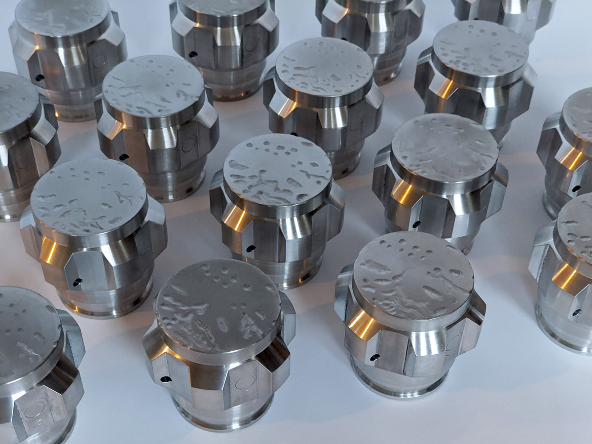

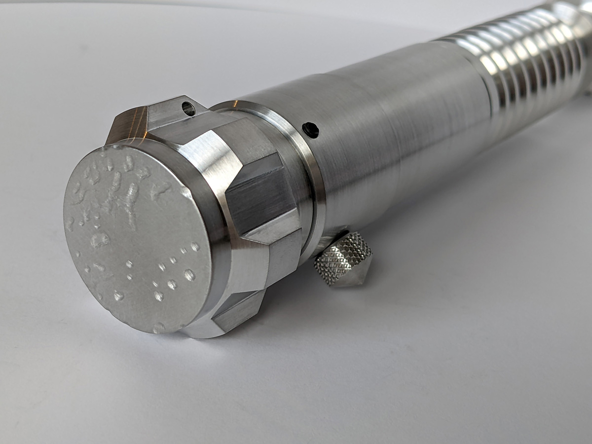

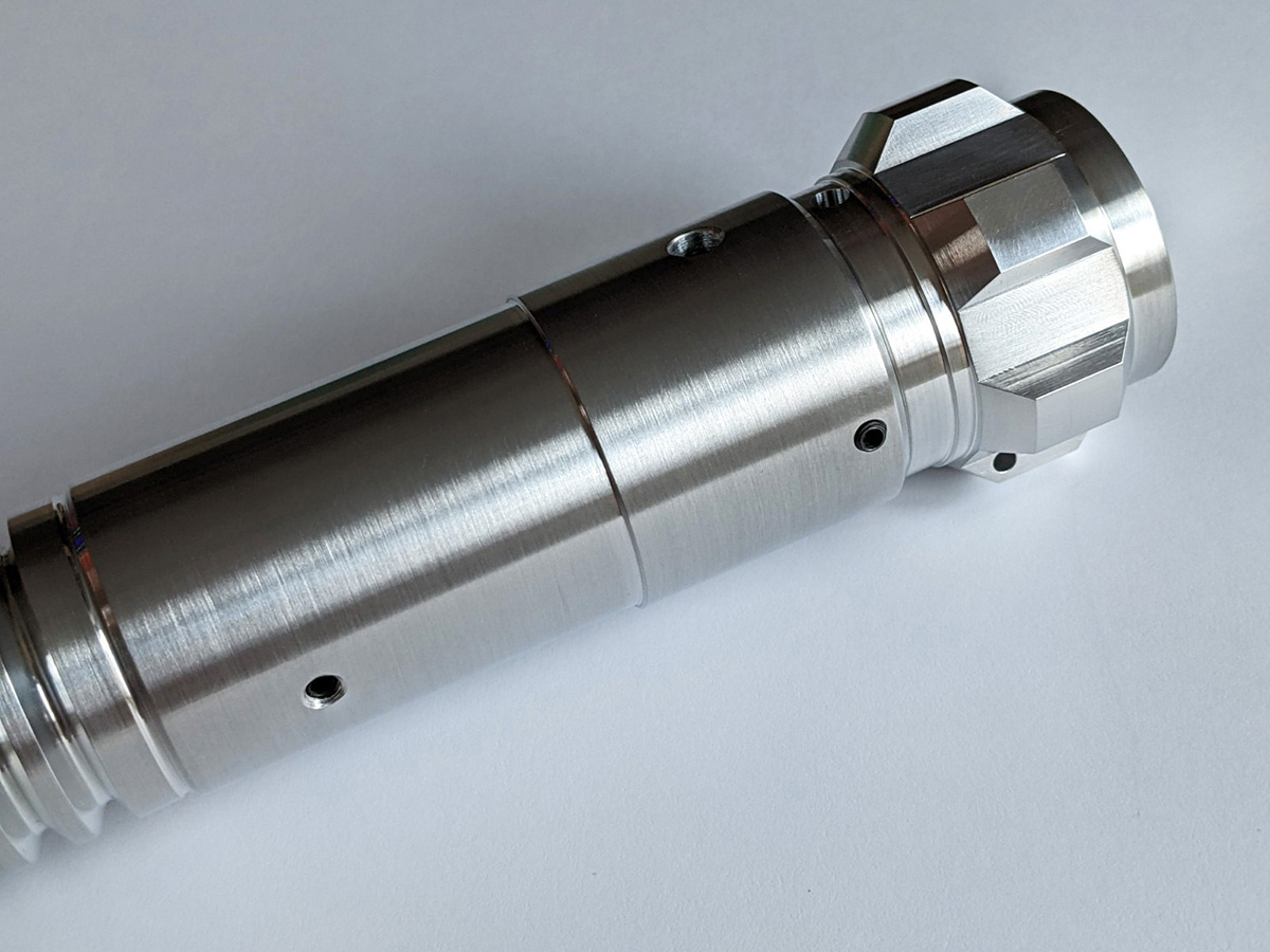

Pommel/Emitter damage commissions for DIY kits are VERY nearly finished. This has been a HUGE job as I hope you’ll understand and they have taken a few days to get through, but they are all very nearly done. It’s not so much the work that has dragged things out, but the shear quantity.

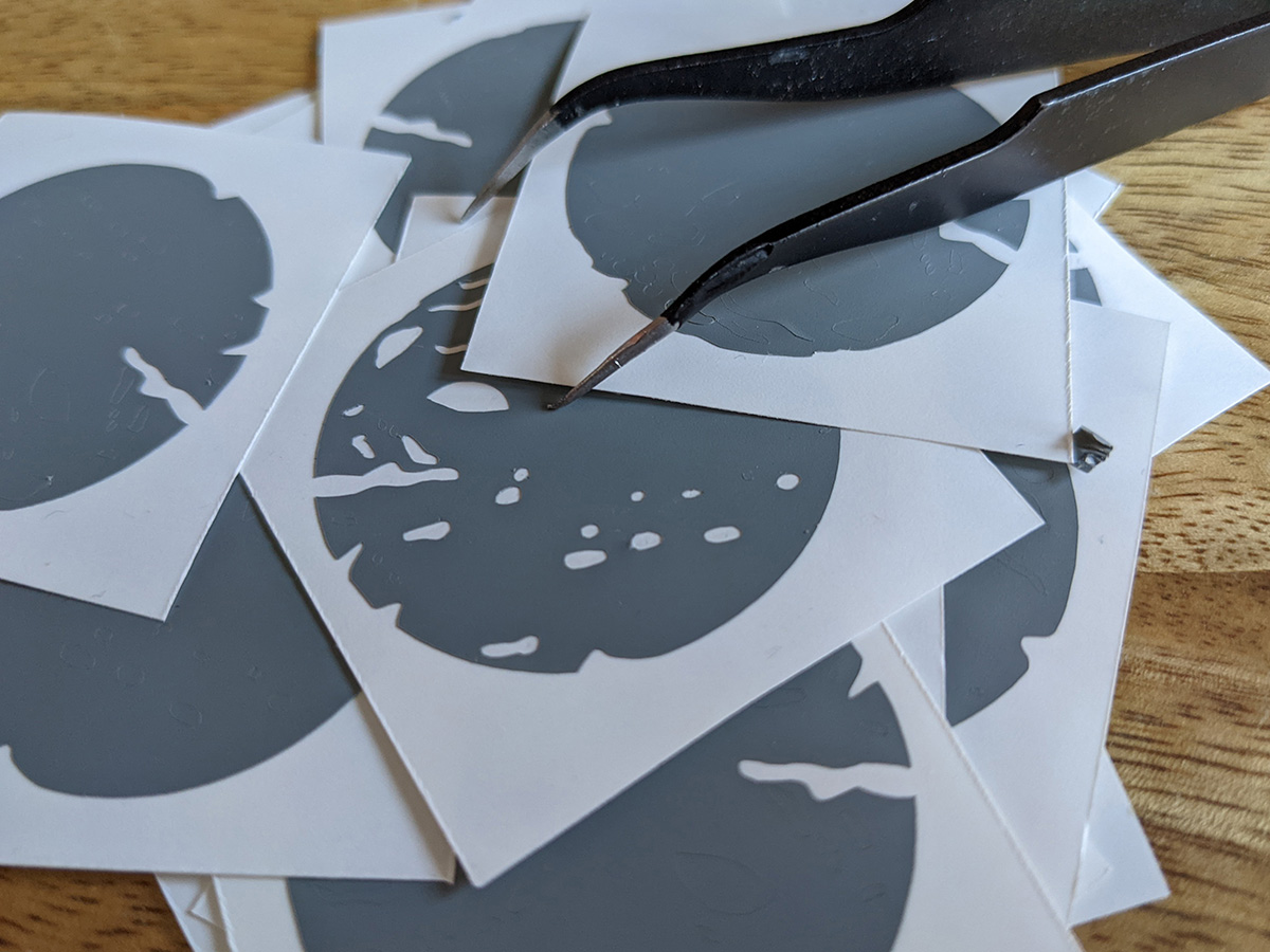

For the pommel damage, I used my vinyl damage guide (these are being sent out with stencil kits).
The emitters are relatively straight forward, but again, the numbers have meant that just getting them detached has taken a good few hours stood at the vice hack sawing! Once they’re removed, I then clean them up and ensure that the cut line is straight, before adding the dents to the emitter face.

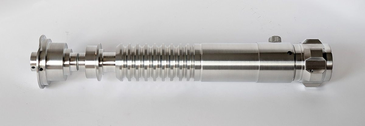

Here is a complete ROTJ kit (with additional Cone Knob) including pommel and emitter commission:

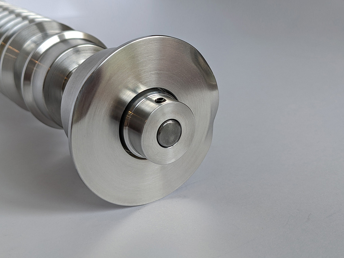

There have been a couple of revelations with the ROTJ kit too, which I’ll explain... Please note the washer at the neck. It’s my strong belief that the neck of the original prop was broken (rather than being cut) This is not something that I’m able to replicate due to the nature of the materials, so roughly 1mm is missing from the length of the neck section. Lost to the cutting process. I’ve replaced this with the washer, which will be hidden below the neck tape (supplied with the stencil kit).
I have also noticed something important that could well be another discovery relating to the original prop and it’s design. As you know, the point at which the emitter joins to the body is a straight cut/break. Whilst there is not enough room for a bushing, unless it was a VERY thin one, there IS a small gap between the rod and the inner wall of the hilt. This would have been necessary for the mechanism to work. Interestingly, this has meant that the emitter, once detached, not only spins, but it has a slight wobble too… Nothing too drastic, but of course, it does make sense. There is a definite clacking sound as Hamill inspects the original prop in PCQ, and it’s not necessarily just the D-Ring. It sounds a lot like the sound that comes from mine when fully assembled:
This got me considering the tape. Why would it have been necessary to prevent the emitter from spinning? Maybe preferable that it didn’t I guess, but it’s not *that* important in the grand scheme of things. Could the tape have been applied to keep it from wobbling/rattling too? Just a thought.
They shouldn’t be necessary once the tape has been applied, and they’re certainly not there on the actual prop, but I have ordered some extra thin nylon shoulder washers to replace the metal one that I’m using at the moment. This should solve both the above mentioned issues in one go (if they are issues?).

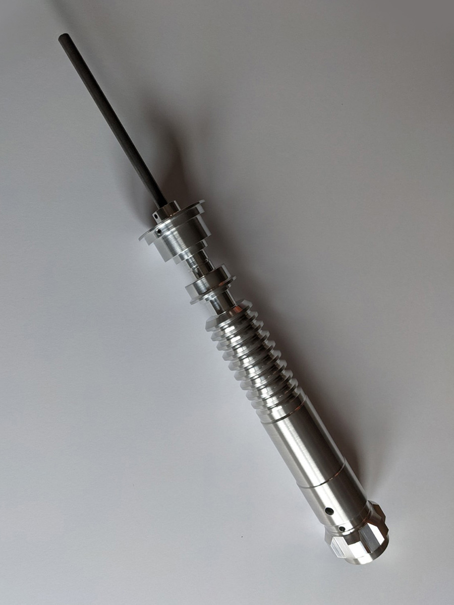

Blades:
Now for some bad news I'm afraid… To say that this has been weighing heavily on me would be an understatement! I have finally heard back from my carpenter this week, and it is bad news. He just can’t seem to get these blades made to a satisfactory standard. Not for lack of trying, or lack of ability. He’s widely regarded as one of the UK’s best wood turners! The problem, is that they’re just so thin that they warp whilst being worked on, and the result is that the finished product does not end up straight in relation to the bore:
This is obviously a problem! After several failed attempts, he’s decided that he’d rather not make them. This is fair enough I guess as he doesn’t want to put his name to something that isn’t perfect, but it puts me in a VERY difficult position. Some of you have paid for blades as part of your motorised stunt kits. I was expecting to have these in hand by now, and I appear to be back to square one!
Well, all is not lost! After frantically looking around for possible solutions, I believe I can still provide you all with blades within the same sort of budget (and in a relatively short amount of time). The only snag is that they won’t be tapered. I have sourced some Carbon Fibre rods that are the correct diameter and available immediately from within the UK.
I just need to check with everyone that this is acceptable before placing the order, as it’s a lot of money still, and if some people would prefer a refund on their blades instead, I need to establish the right quantity.
Something to consider is that some references do appear to show blades that have no taper, so it does appear that at least some of them were straight:
18mm is very thin to start with, so the addition of a tapper wouldn’t make too much of a difference really, and I believe that these alternatives will still look the part.
After speaking with my wood turning friend, I actually have my doubts that wood was ever used in the first place. He believes that the grain in the wood would have prevented them from drilling a perfectly centred hole.
Tapered carbon rods can be found, BUT, it would be impossible for me to get the internal bore in line with the centre without having a tapered internal plug made (Too expensive). These tapered rods are also TOO tapered, tapering to a near point. The straight ones are actually closer to my original design than the available tapered ones are! There is also the problem that these would be well outside of the budget, which was based originally on the quote I received to have them made in wood.
** So, please, if you have any objection to a non-tapered carbon blade, please do let me know, and I can arrange a refund for the blade part of your kit. If you’re happy for me to proceed, I’ll get the order in over the next couple of days, and should have them constructed/coated at some point next week.**
If it’s any consolation, I actually think these carbon ones will be superior and more mechanically stable than the wooden ones could ever have been, and like I said, I now have my doubts that wooden ones were ever used in the first place.

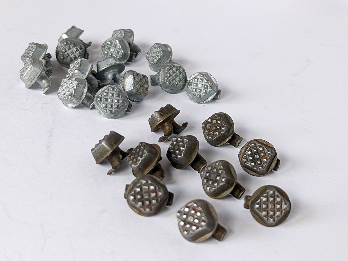

Boot Studs:

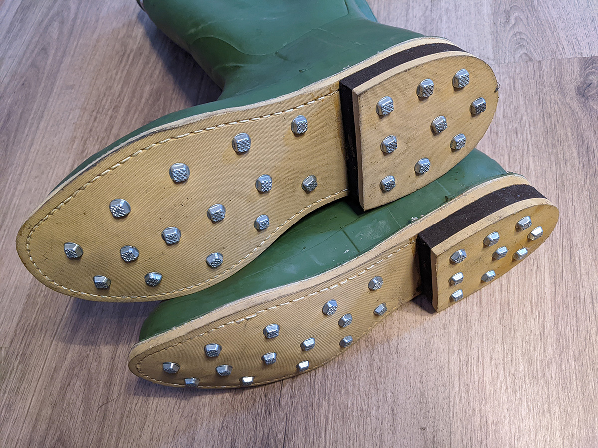

It’s not all bad news! I was lucky enough to get my hands on a second pair of Uniroyal boots! I was a couple of studs short somehow, so I had been on the lookout for another pair, but they’re rarely in Grade A condition like these:
So, I now have plenty of vintage studs available for those who need them. I’m afraid I can’t cancel orders of Wannawnaga studs at this stage I’m, as the order has been placed. I can sell them at a lower price of £15 to those who have already ordered one of Roy’s though. The usual price is £20.
The price is not to cover the cost of the boots (although this pair were considerably more expensive than the last pair). Anyone who has extracted these before will know that the price is to cover the time and effort of extracting them, as well as the time and energy taken to find them in the first place.
Please let me know if you would be interested in taking one of these. I'll be putting any remaining ones up on the Junkyard once the run is finished.

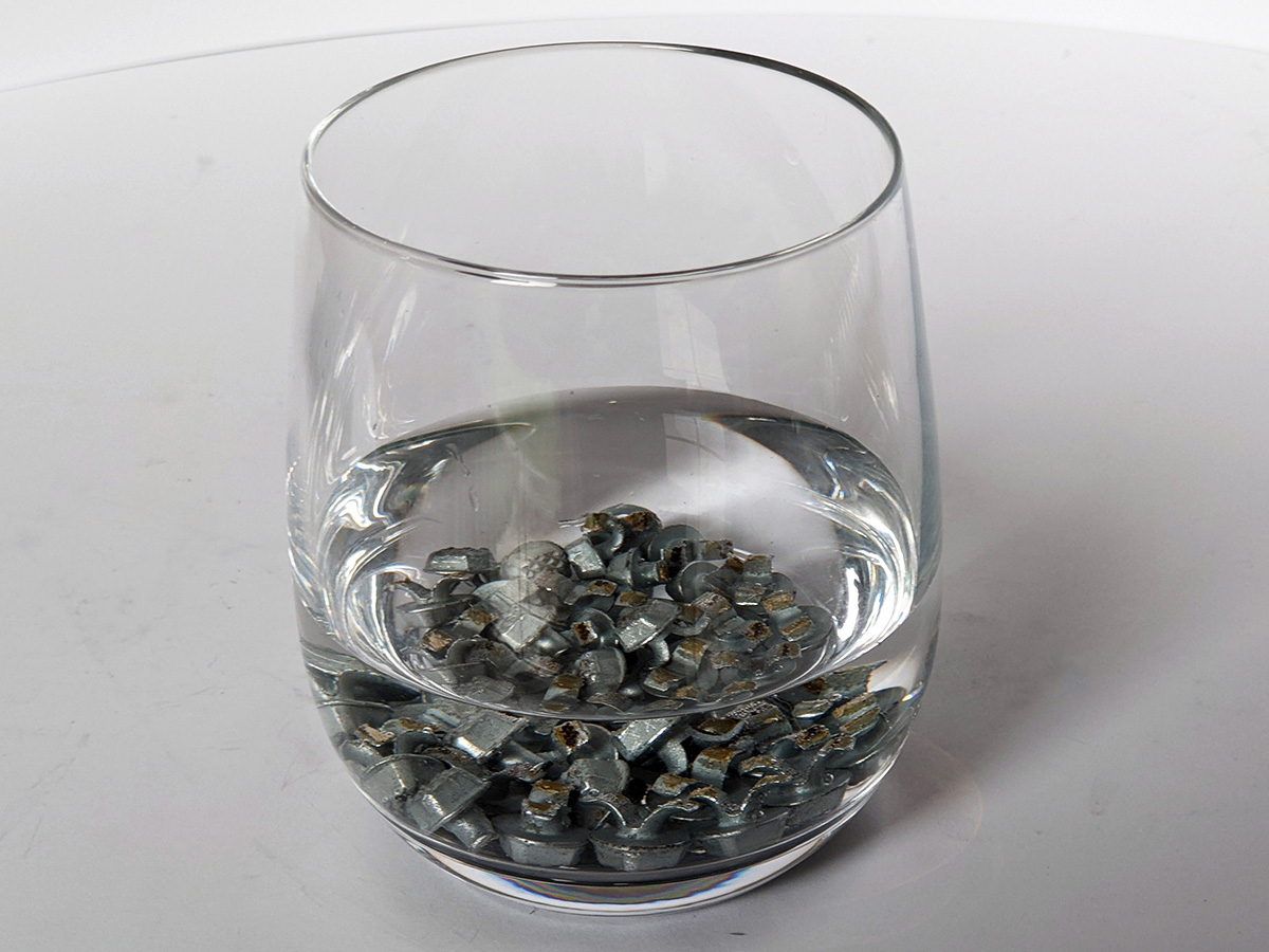

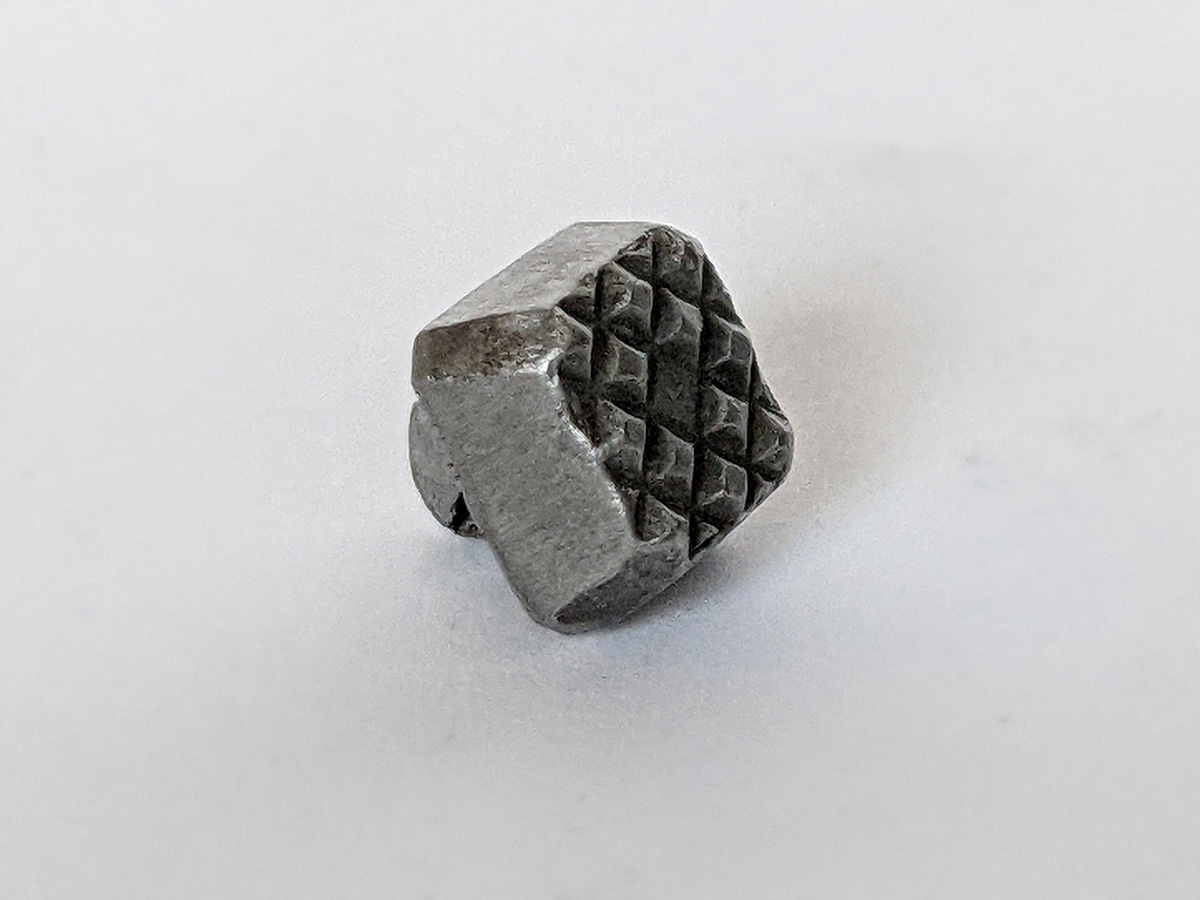

On the subject of boot studs, I did a test run on removing the zinc plating on ten of them (the ten for my first batch of commissions). Distilled vinegar works an absolute treat and they’re now safe to work on. I now have a load more in the process of being stripped too, and have removed the tabs from one, just to check how long it takes.

Hi everyone. Just a quick update on the blade situation... I believe I've found a suitable carbon rod now (with taper!), thanks to some very helpful suggestions from vadermania. Thank you! :)
So, everything is back on track. In budget and sourced in the UK (so should have them in hand fairly quickly). I'm going to go ahead and get them ordered!
Please speak now if you have any objections to the blade being carbon rather than wood. As I've said, I now have my doubts that they were ever made from wood in the first place.

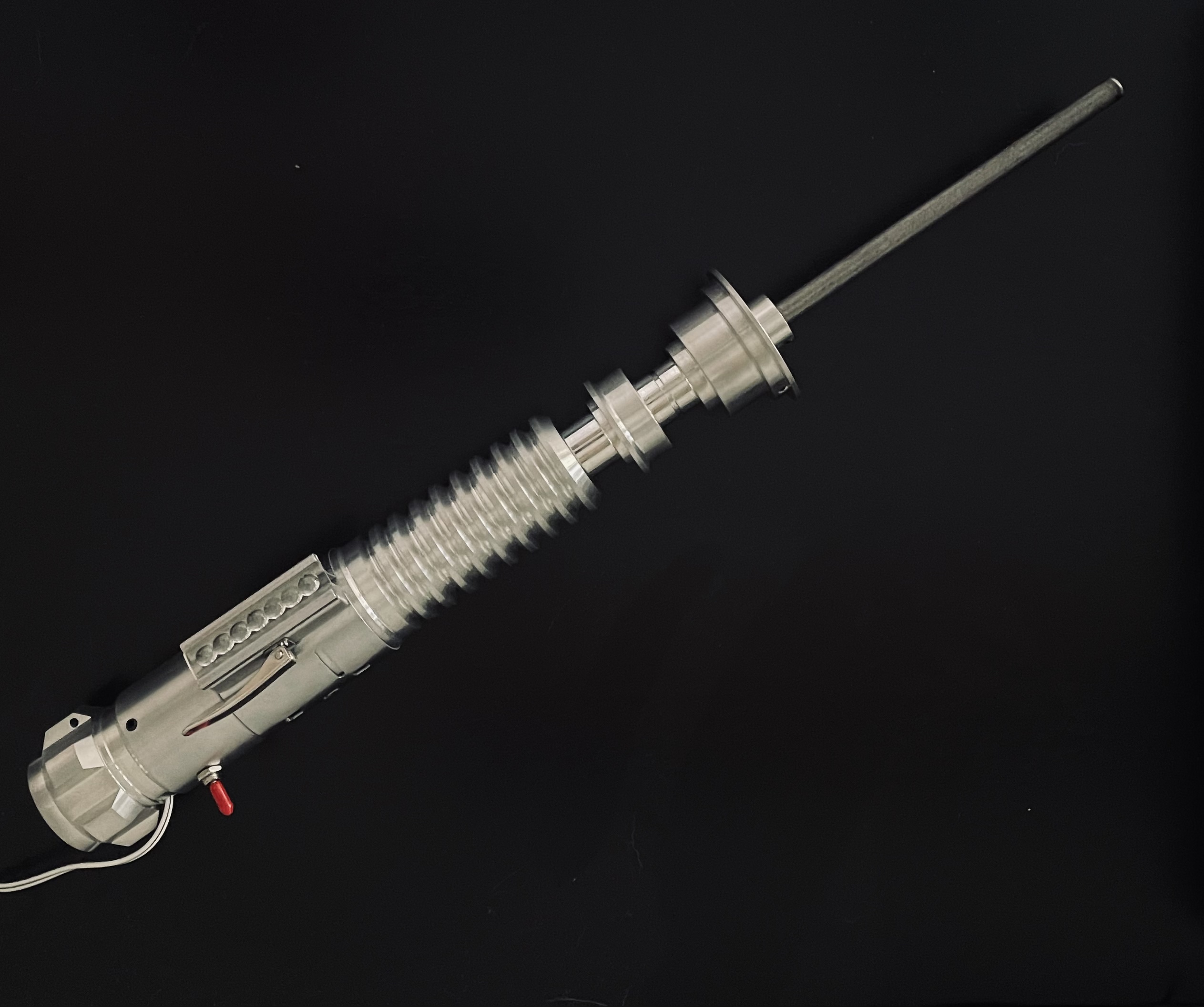

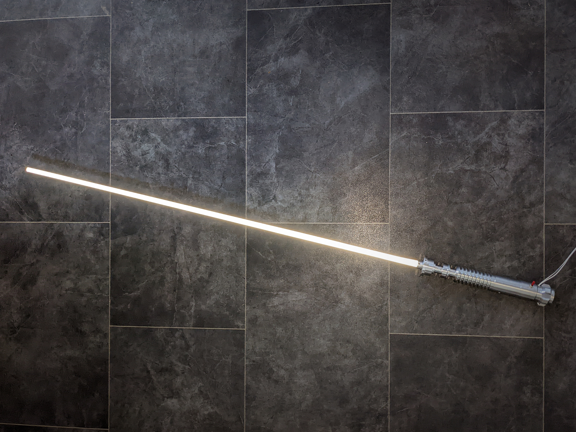

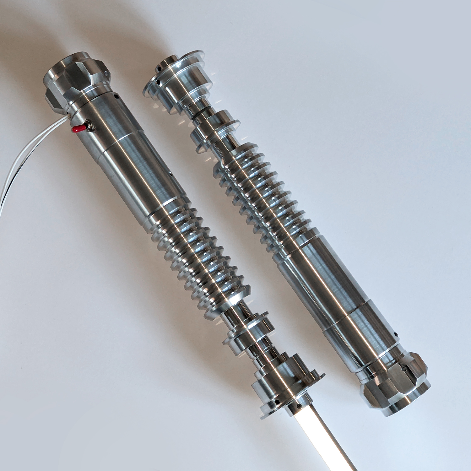

Hey everyone. just a quick update to show off the blades. They turned out great. Really VERY happy with them. I got one of the Obi stunts wired up this morning to check that everything works ok, and it's sooo smooth compared with the first attempt that I made from wood. The vibration is completely gone. (y)
Here's a shot of it on the floor using the flash. The reflective tape works really well. (y)
And a shot of the Obi Stunt next to a finished V2 kit (with pommel/emittter Damage):
