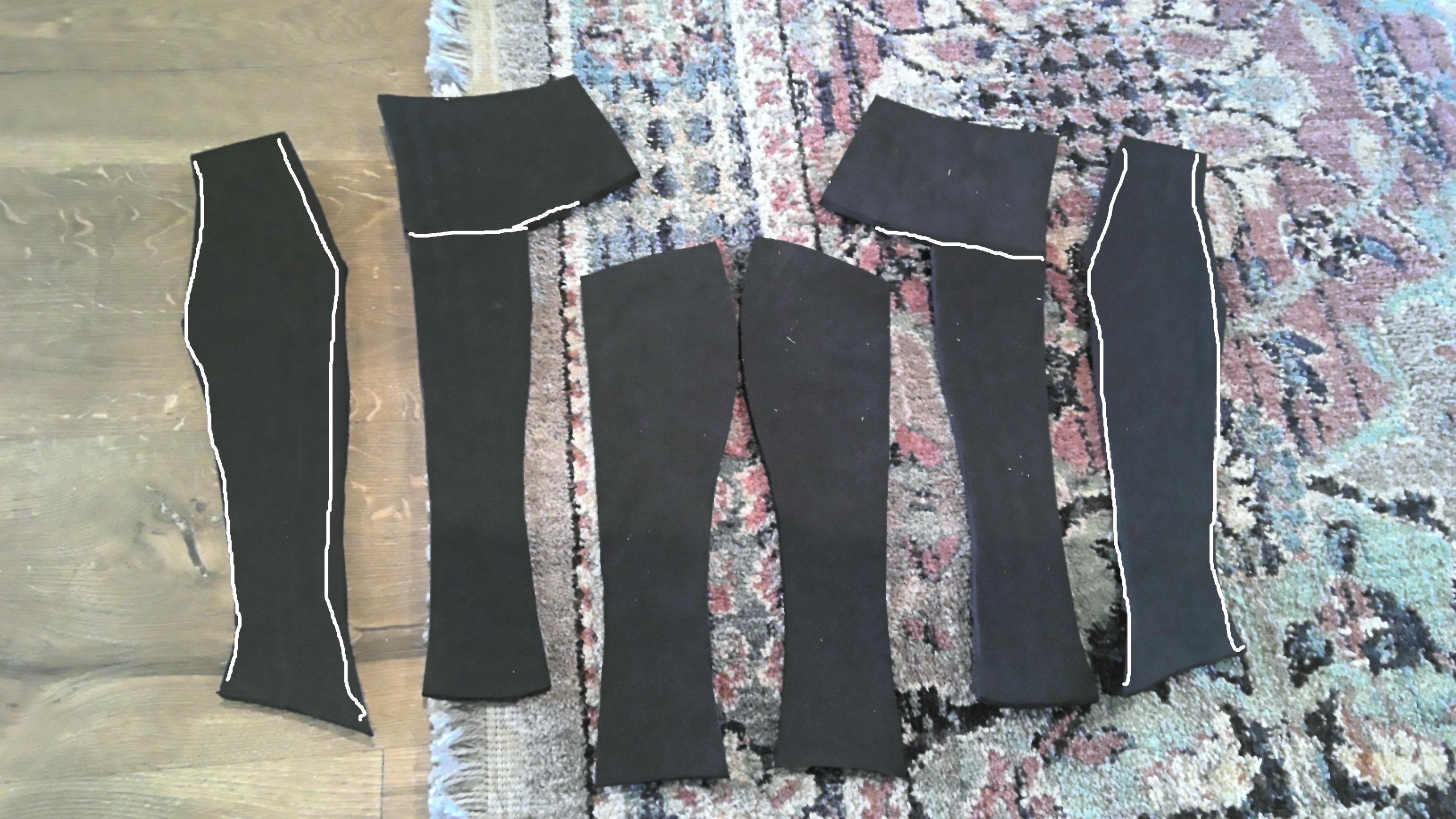

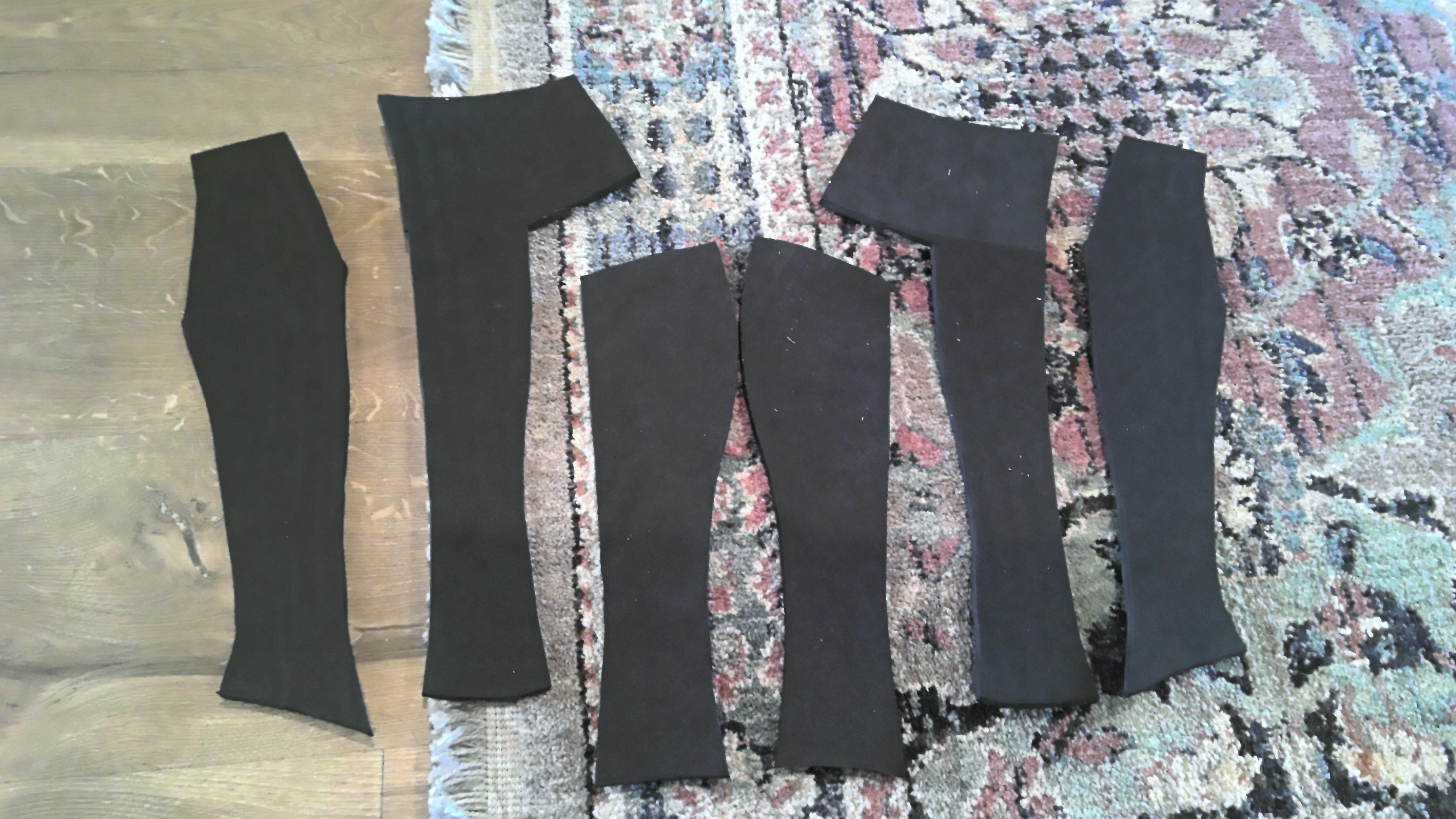

hello! i am working on the shins, but i cannot seem to see all of the bevel lines in the videos, here are some pictures
i know the front of the shins are beveled, but what else?
I'm pretty sure this is all that should be beveled. The sides of the shin shold point out a little near the top. If you look at the shin in the video you can see it sticks out on both sides near the calf muscle.
