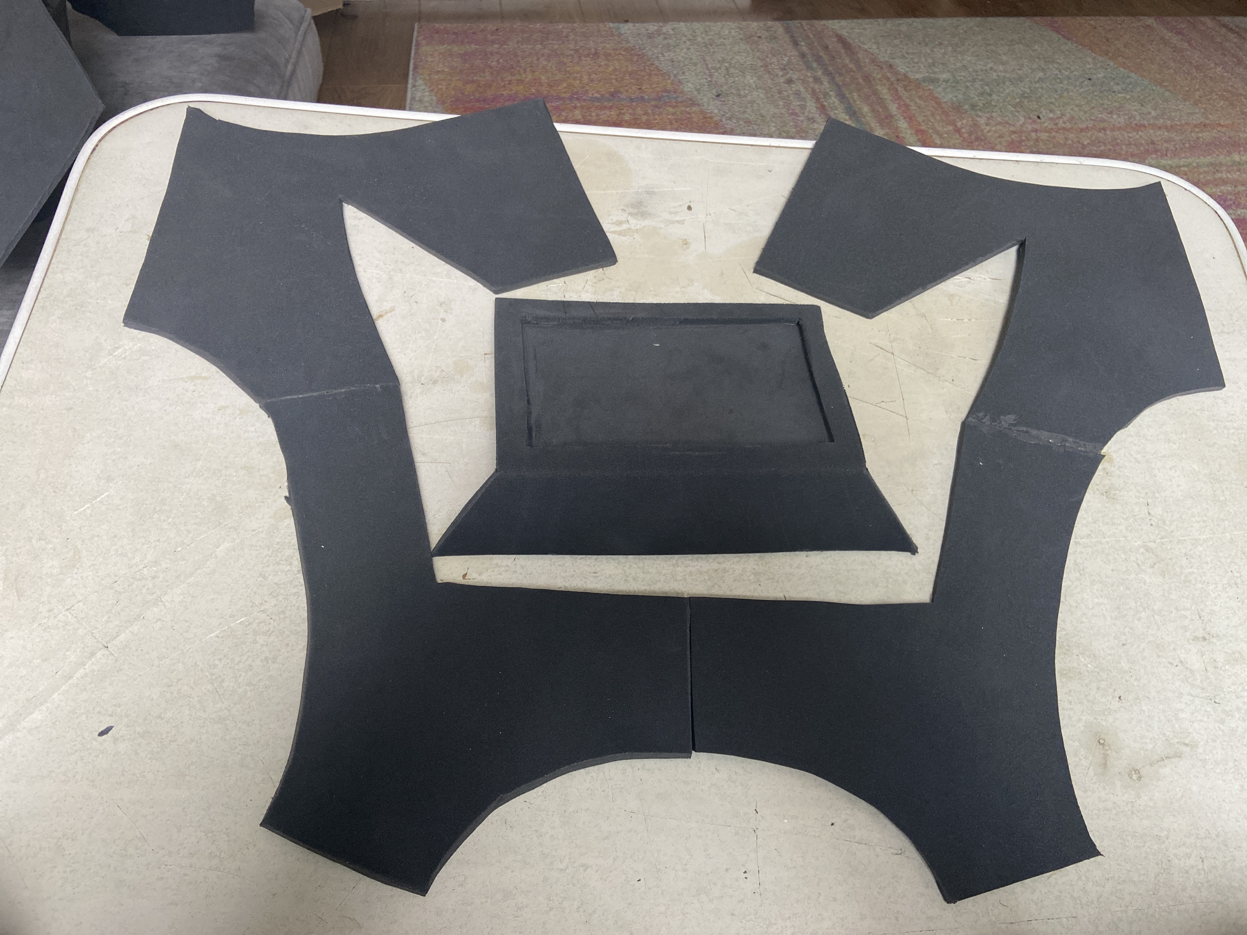

Hi, first can I say these files are a blessing, I am reall enjoying making mine. However I am currently making the back and I just can’t figure out how it’s all gonna fit together. I’ve attached some images. Any help would be appreciated, Thanks Josh
Hi, first can I say these files are a blessing, I am reall enjoying making mine. However I am currently making the back and I just can’t figure out how it’s all gonna fit together. I’ve attached some images. Any help would be appreciated, Thanks JoshView attachment 1296971
You're doing it right,however you have to find the side pieces of the back (highlighted on the picture). I don't want to misguide you but I think you're looking for those side panels to attach to the rest of the back files on your picture. I hope I could help with this!
Hey Josh! Glad your enjoying the templates.
For the back, you'll need to bevel a lot of the edges of the pieces to make the backpack section stick out more like I showed in my video. I'll make another video soon going over the templates and how they fit to the foam.
Your armor is looking great so far!

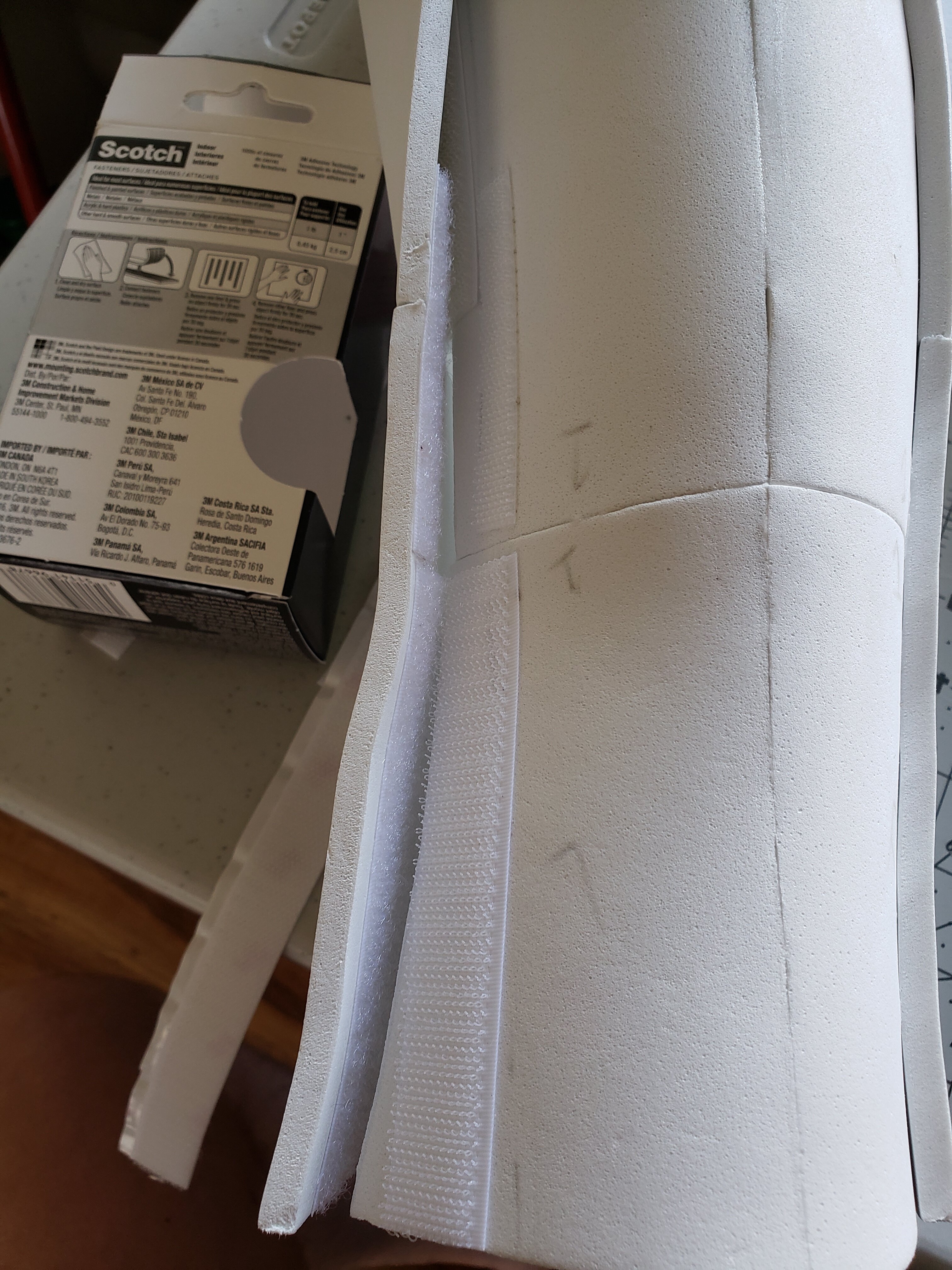

Hello all,
Ryzer117 thanks for uploading your cosplay trooper! Love your pictures and YouTube video. I appreciate your explanation videos.
I decided to give this project a shot since I have just gotten into making a foam cosplay the mandalorian outfit for my son's birthday gift.

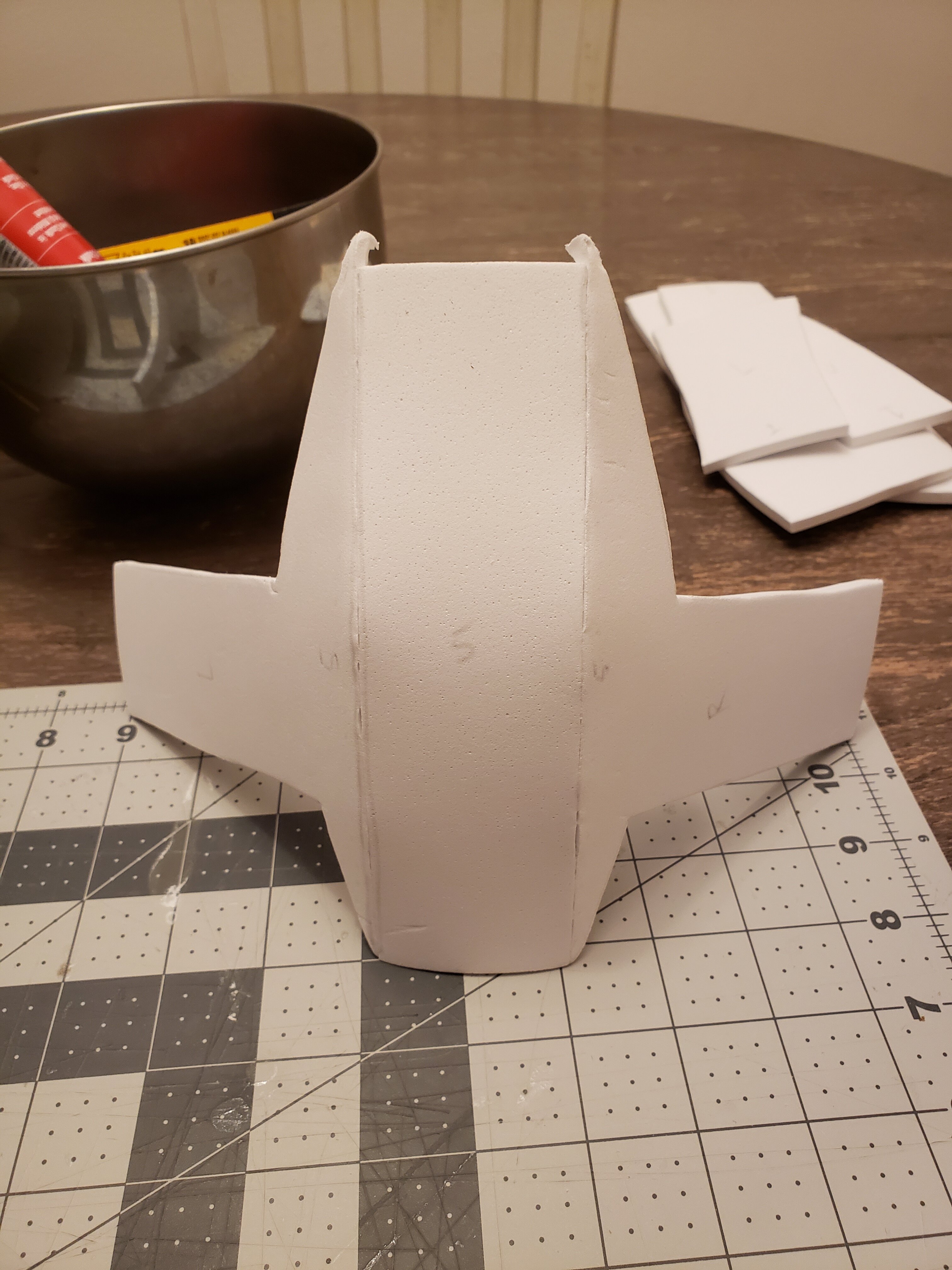

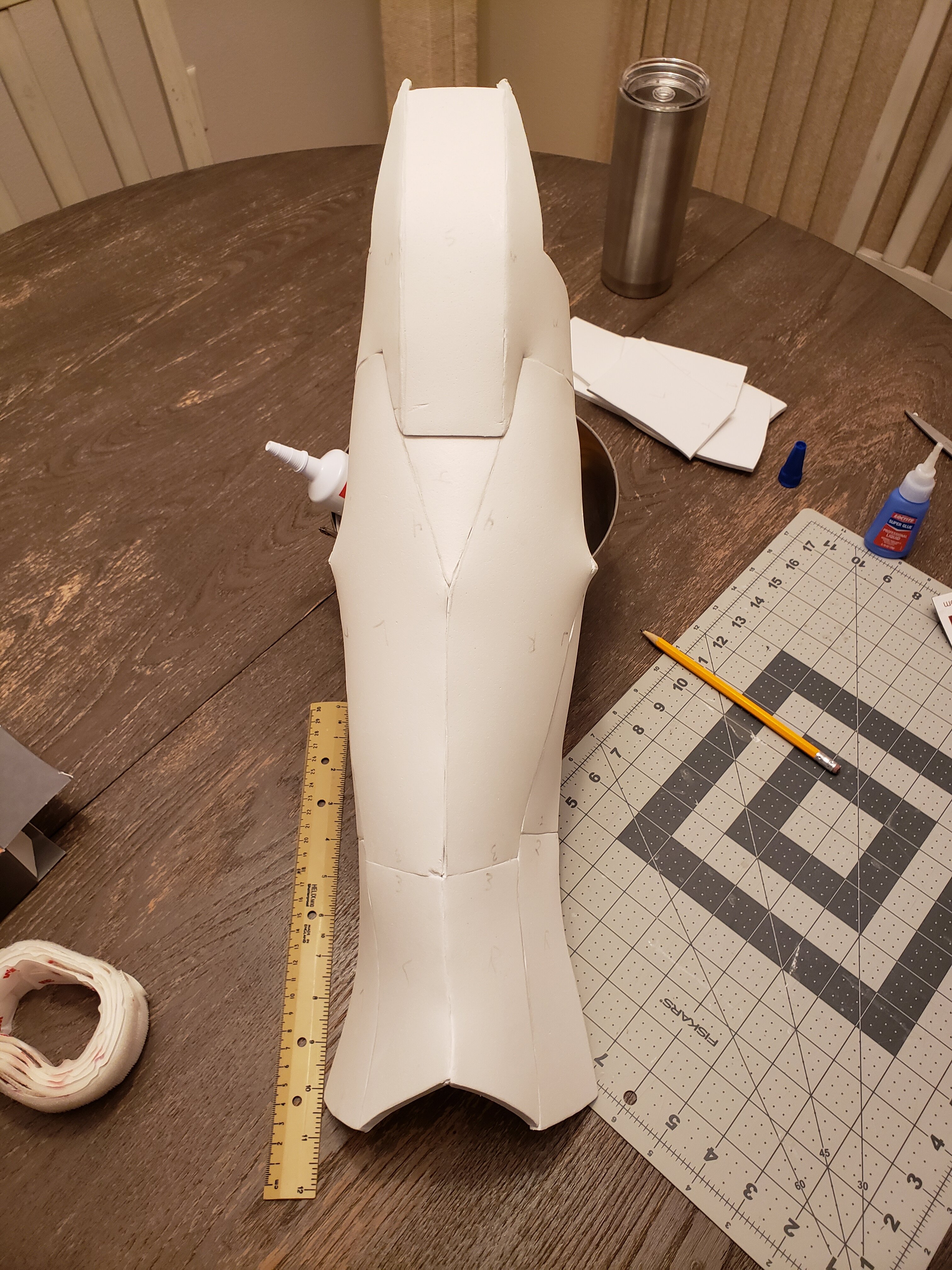

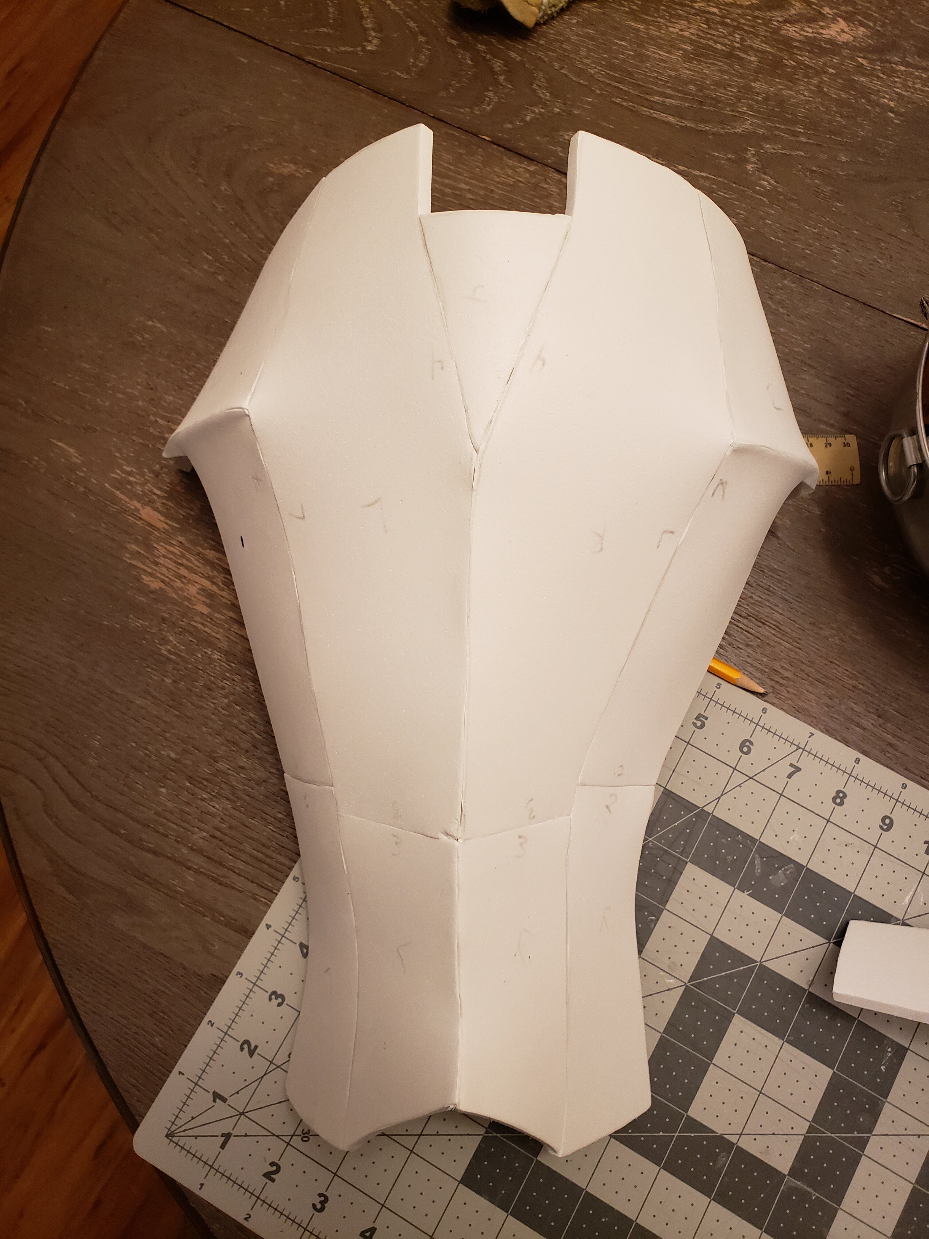

I figure I can use Odinmakes YouTube video for the foam captain rex helmet to go with this suit. I started with a shin pattern going to attach a picture or two of my progress so far.

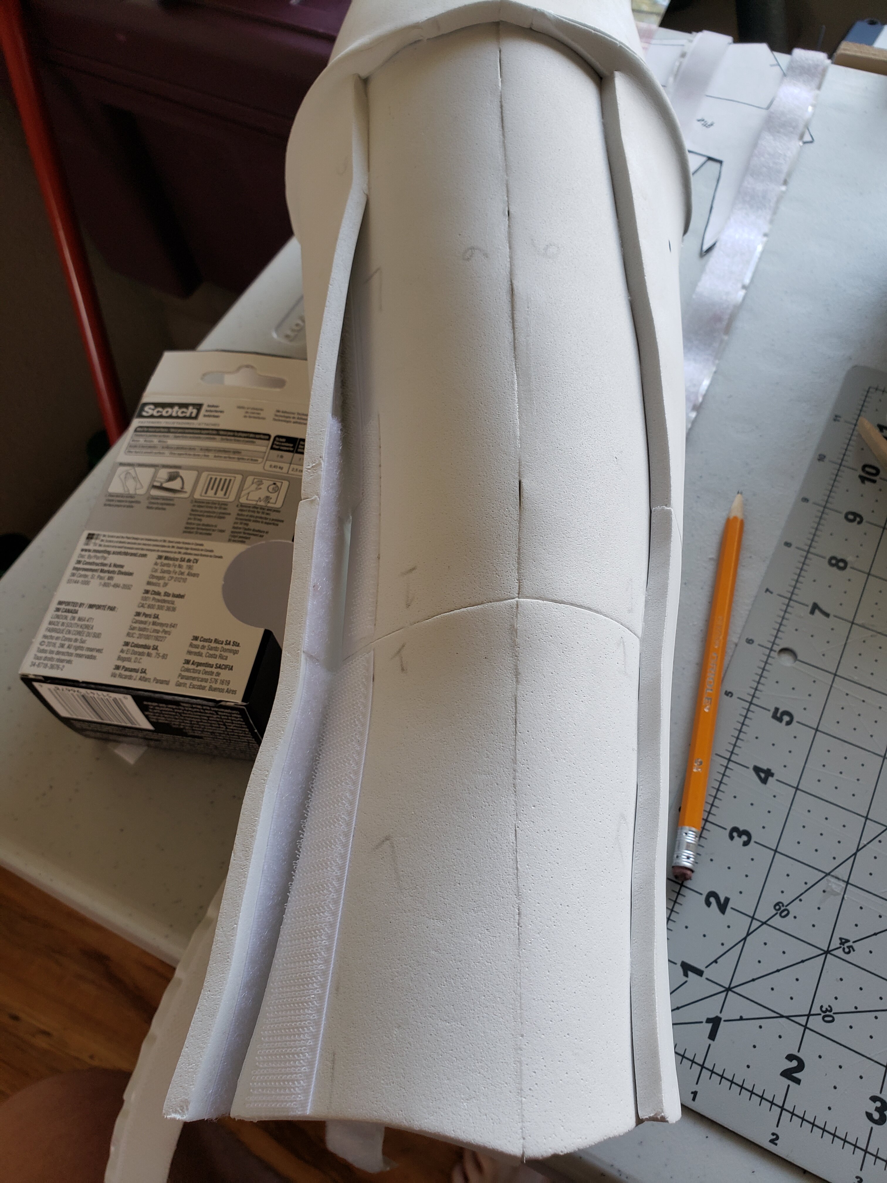

Back side of the shin with velcro added. This is the left leg side.
