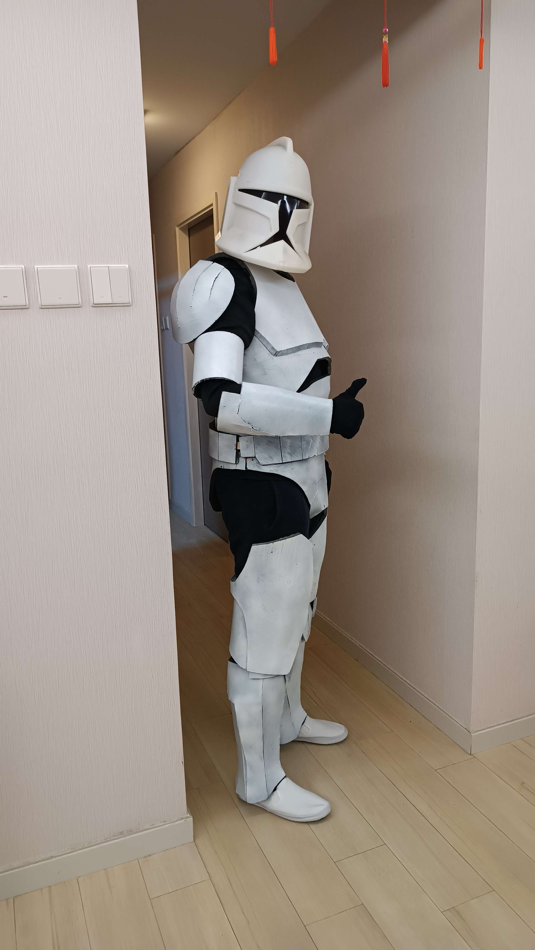

Hey! I attempted to make your armor as a last-minute costume for a local convention! I think it turned out pretty good, though I'll probably want to take more time to fill in the gaps in the shin area :O as well as some other details and smaller missing pieces. Felt and worked awesome :D ps, the helmet is was a prior project, 3D printed with ABS plastic.

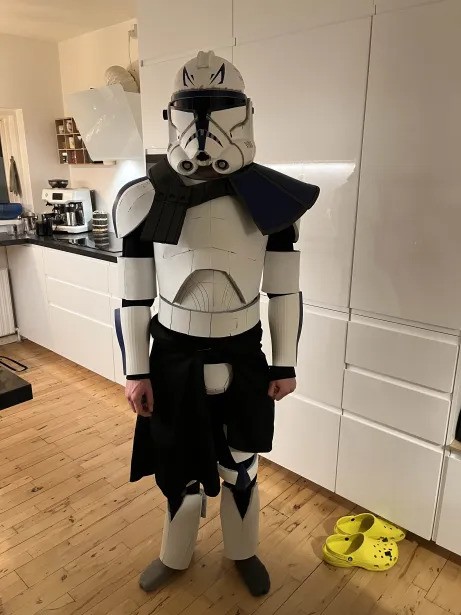

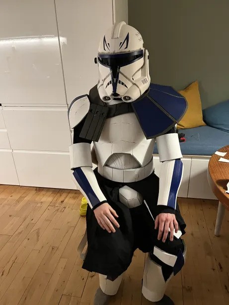

Thank you so much for these files, they where really nice to work with, i had to 3D print the arms as i did not have the time to do the arms. (dont use 10mm as i did realy hard to do) i attached a photo of how it turned out agein thank you very much ( it's my first time trying to build something out of foam so i think it turned out great)

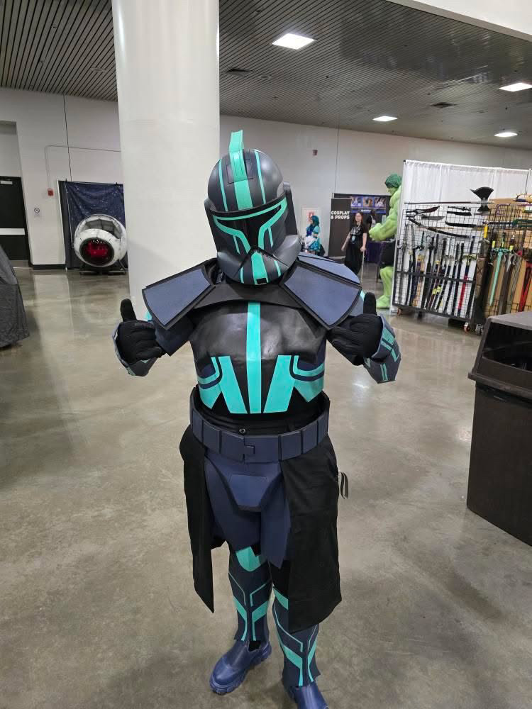

Ended up making my own with your files! Even won a cosplay contest. Had to heavily modify the files to make it suit my need like height and being a phase 1 arc trooper, made out of Cintra and EVA. Took almost 4-5 months to finish but hell am I proud.
