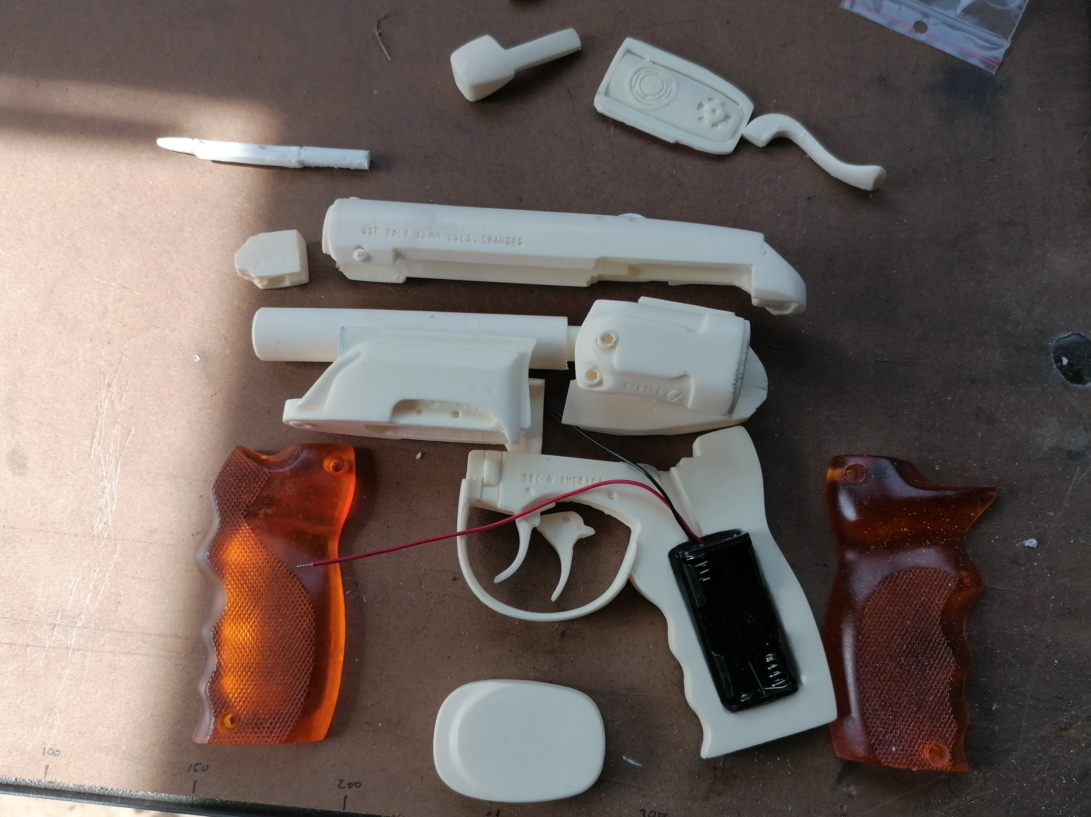

This came as a nice surprise birthday present from my wife. She knew Blade Runner is a favourite of mine, but she'd no idea that this gun also appears in Fallout which is a big obsession of mine.
The kit came from etsy and a bit of research reveals it to be a recast of the Doppelganger productions/Rick Ross PKD-2. Actually more likey it's a recast of a recast...
The kit is cast in a decent resin, but all the parts feature lots of pinholes, some are more like an aero bar that a kit part. Many parts are warped, with the barrel and the grip frame being particularly bad. The grips are cast in Amber coloured resin. They look a little orange compared to the original, but are bubble free - though there are some flecks of poorly mixed pigment.
Part quality isn't great, most of the parts have a rough surface and generally show signs of being shot from very well used moulds. Detail is generally fuzzy and there are lots of air bubbles in evidence. The cast screw heads all look poor with lots of bubbles and will need to be replaced. There's lots of fine text that's mostly good, but some areas will need attention.
Part fit isn't great, the two grips aree different sizes, the main parts are very loose and nothing really locates positively.
Overall its a fair garage kit of a hard to find subject. Going by what I've seen of the quality of the original kit I'd say this probably is a cast of a cast - most of the crisp definition is gone. It'll take a bit of work to get the best from it, but I think it'll turn out pretty well in the end.
There are also some inaccuracies which I'm hoping to address as the PKD-2 kit was originally produced before the original hero prop was shown to the public.

The barrel is hollow for about 50% of its length and there was a significant bend at the point the hollow section ended. I heated it locally with a hot air gun and taped it into a V block to harden up straight. Similarly the grip frame was bent to one side, so I heated that and clamped it between two boards to straighten it. Luckily the upper reciver seems straight - I've read that can be a problem with this particular kit.
On to the Steyr magwell. The PKD kit has the baseplate sitting proud of the gun where it should be flush. I carved out a recess and cut back the side walls to allow the base plate to sit in the correct position. I also sanded the plate to a more even thickness and gave the side lips a new profile.
The positions for the four LEDs (2 per side) are slightly off - they should be further apart and there should be a switch between them on one side. I'll fill them and re-drill once some isopon arrives (thanks corona for closing the hardware shops!). I'll also add a styrene tube bezel around each led to reflect the original better.
The Steyr logo on the bottom plate looks rubbish and it's really annoying me - it'll have to go. I've got an airsoft AUG with the correct logo of a similar size, so if I can come up with a straightforward way of copying it I will - I won't be buying a tub of rubber just to mould a small logo though ;)

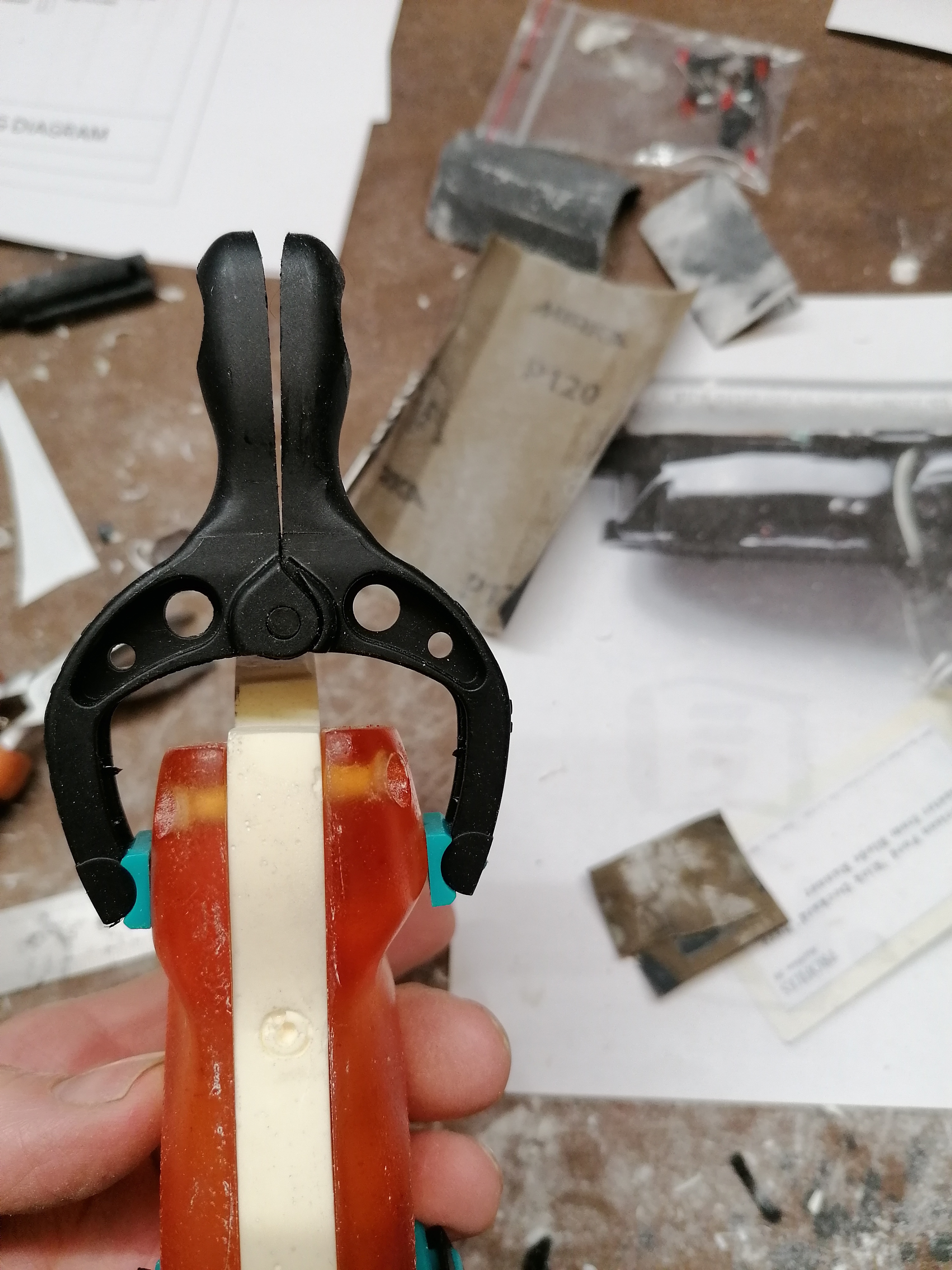

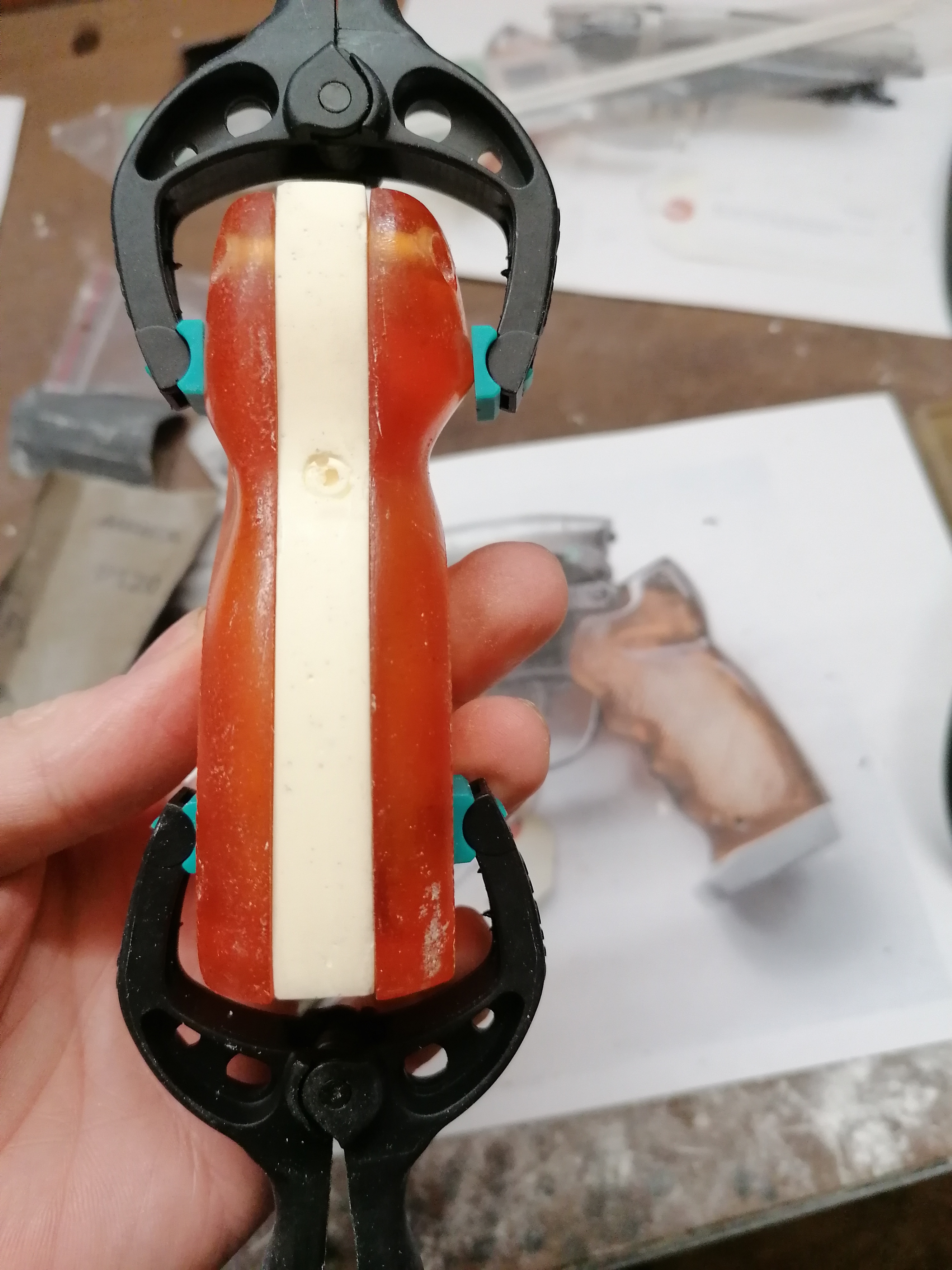

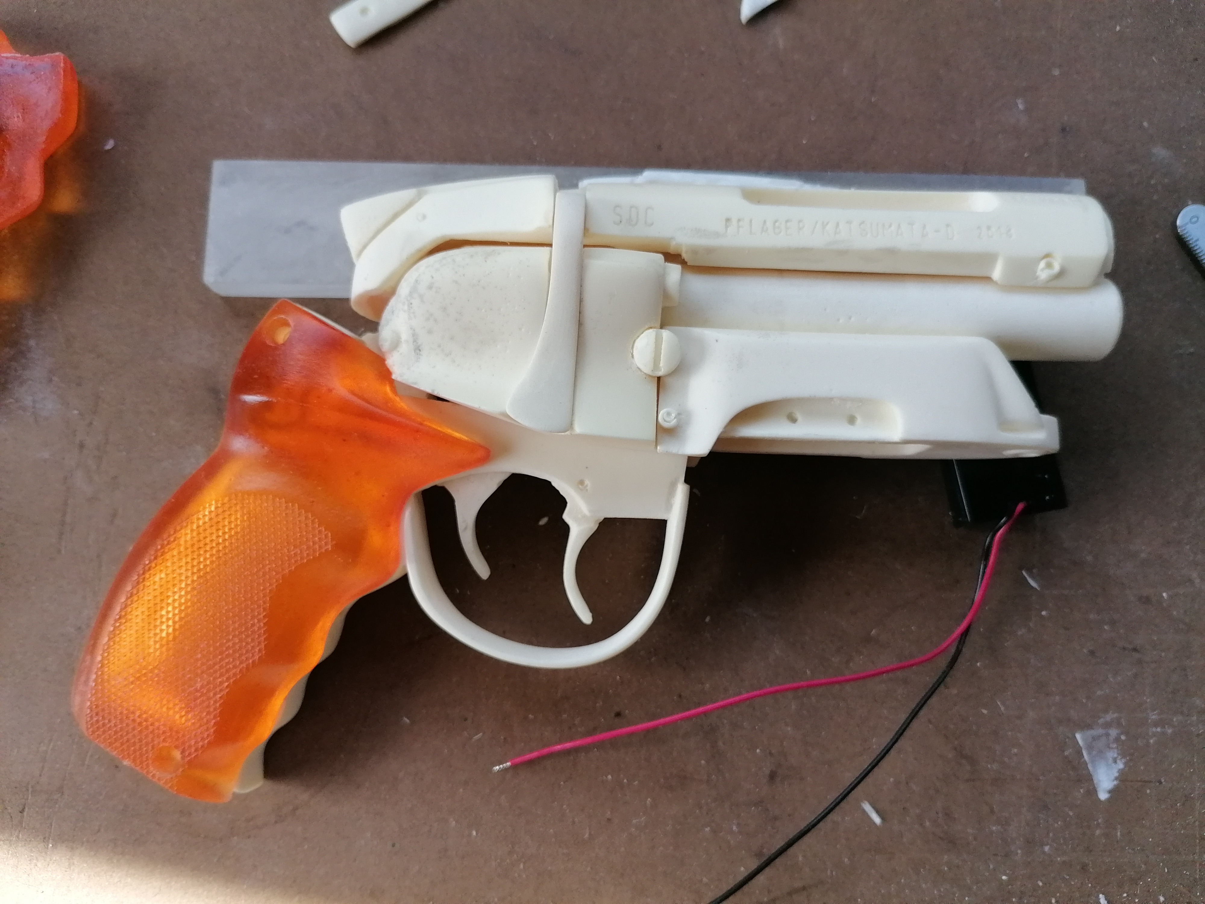

First thing to tackle is the grips. They're both different lengths and slightly bowed, so the first thing I did was straighten them a bit and flat sand the inside faces.
Once they were nice and flat I began to look at the alignment. The back profile was a good fit for the grip frame, but the front was overhanging and didn't quite line up. I clamped them into position and reprofiled them with a dremel. At the same time I deepened some of the finger grooves to give it a better profile.
Once all this was done I worked both grips back to a good 800grit finish for polishing later. This also eliminated the slight orange peel finish of the castings too. I'll polish them on a wheel when I get back to the workshop. At this stage I didn't trim the ends to fit - I'll do that once they've been screwed on to the frames later on.

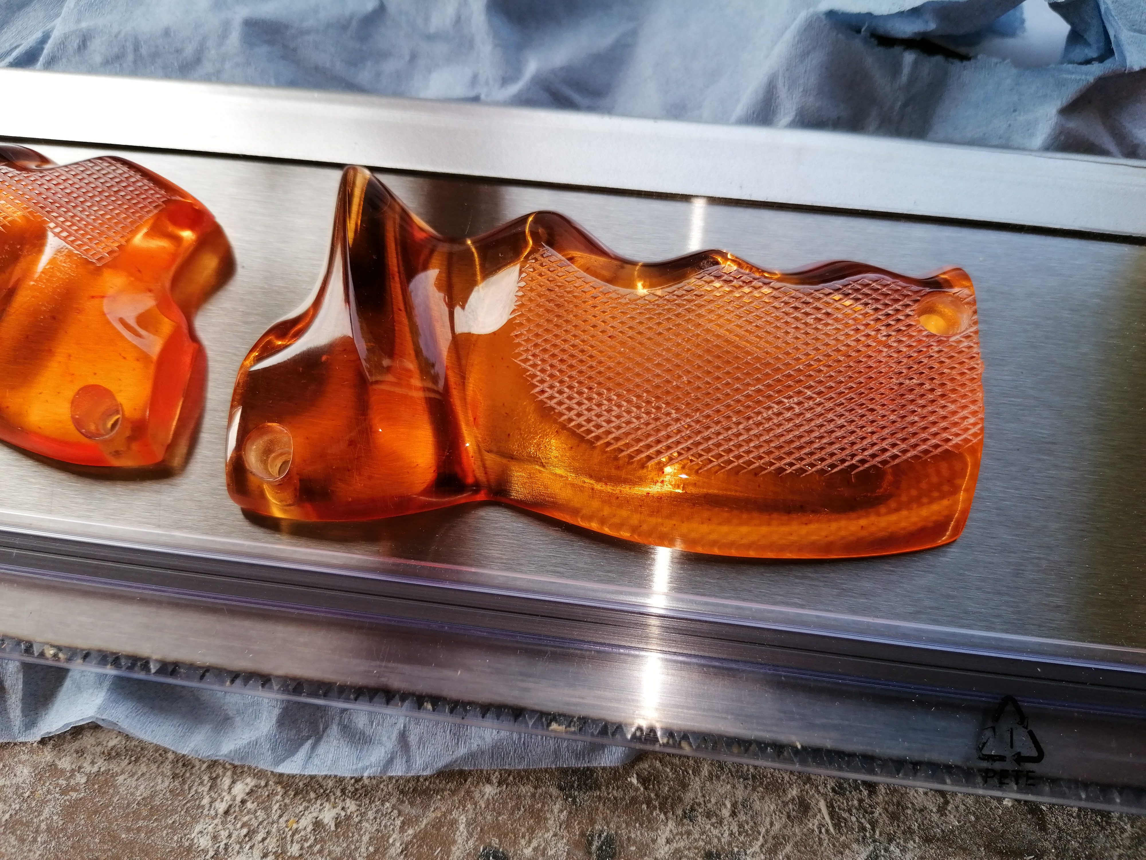

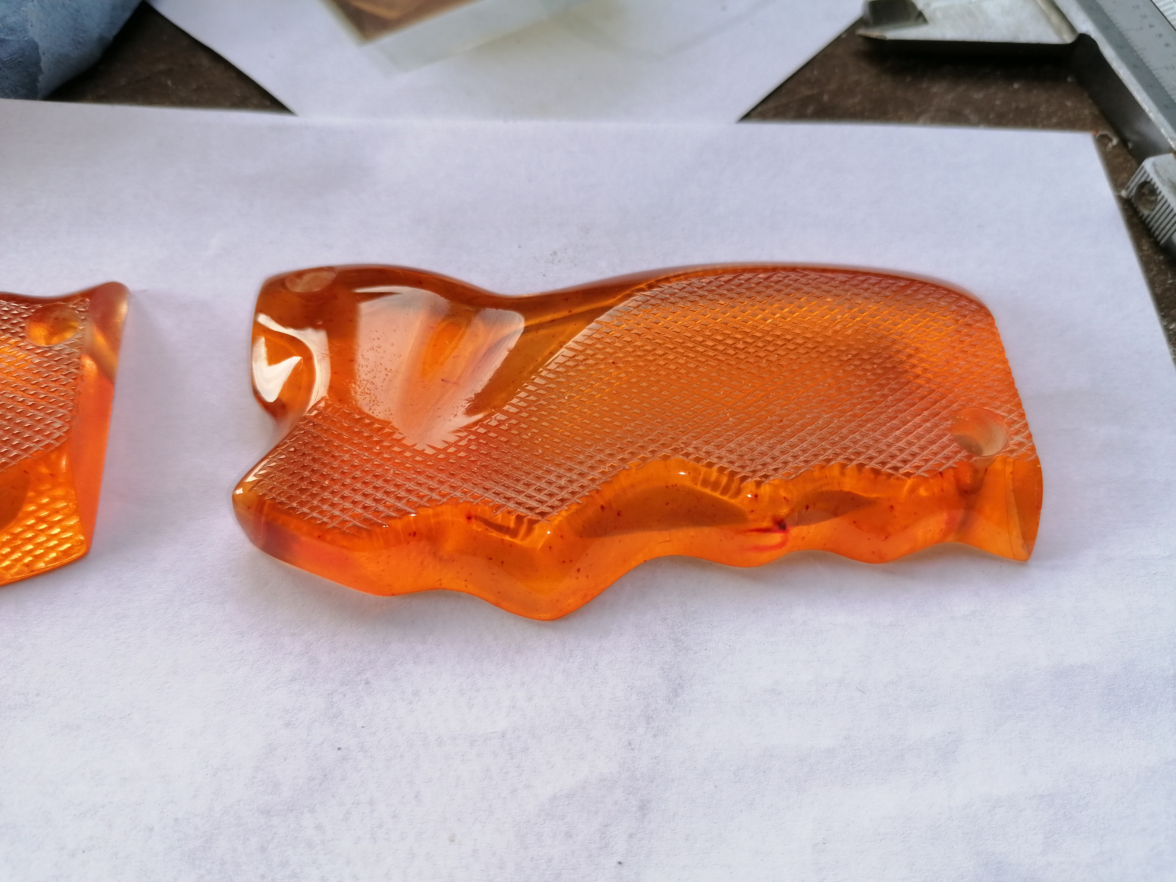

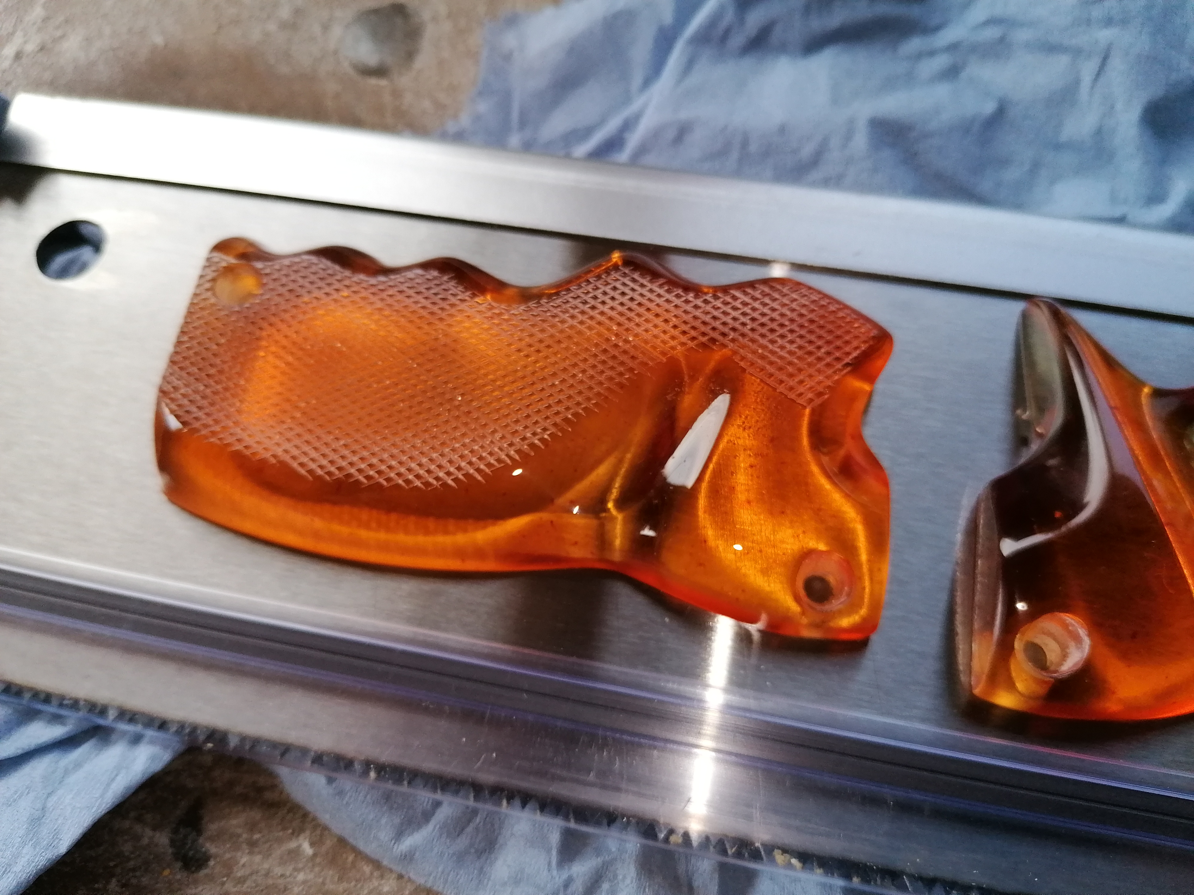

Got the grips polished. Some pitting came up on one which was annoying - will deal with it later. The polish really showed up the unmixed pigment which I'm really unhappy with. Against a white background it stands out quite a bit.
They do look better against a brushed steel finish, so hopefully they'll be OK. If not I'll mould them and vacuum cast a better set - don't particularly want to go to that bother, but we'll see how it looks at the end...

Well, despite the small flaws, I'm quite surprise with the result you got! they look quite nice and I actually like the color a lot from your photos. Nice work! (y)
Great work so far. I think you really made the grips look 10 times better. Keep up the fine improvements on this kit.
