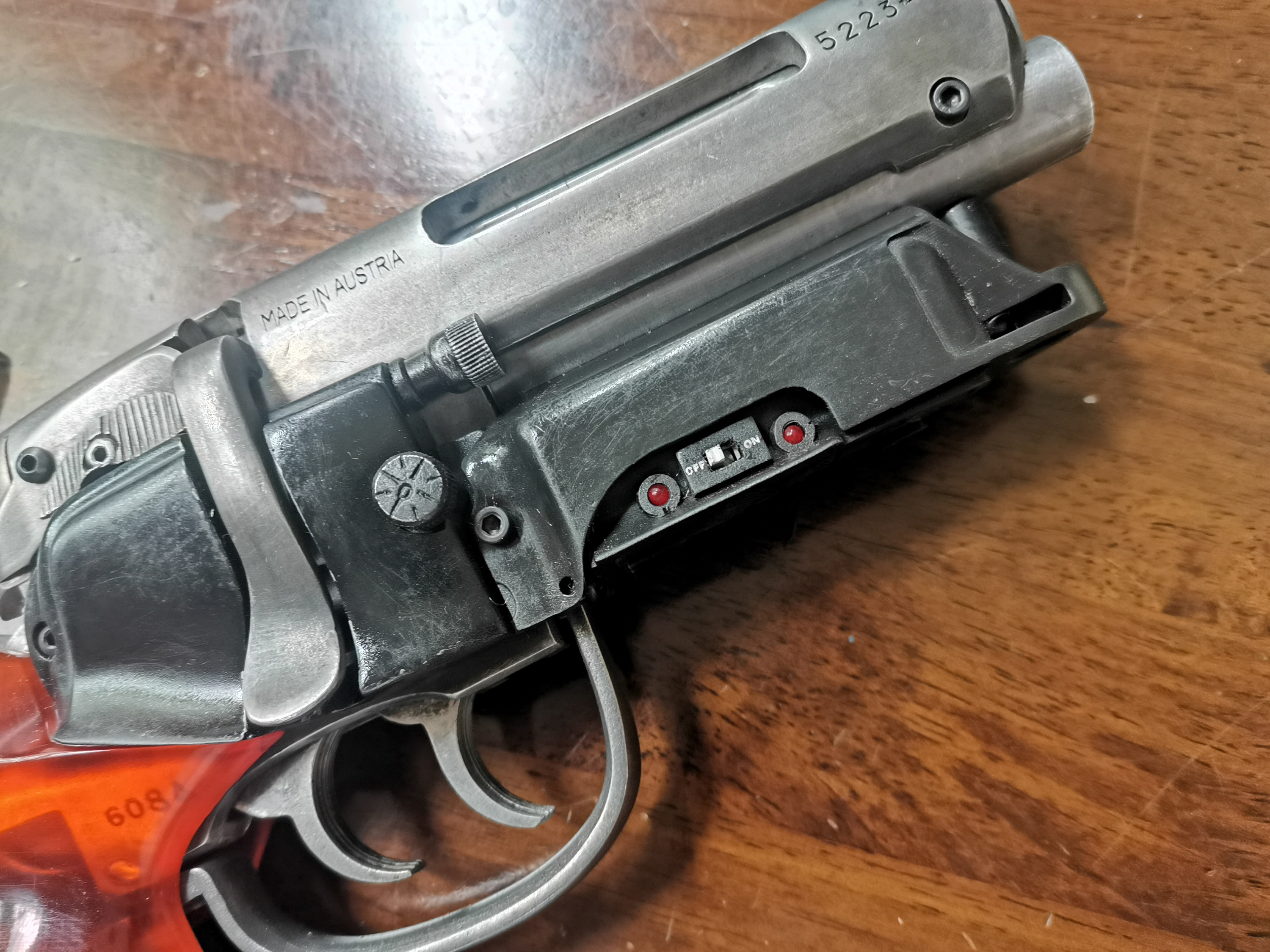

Your current LEDs are Charms candy green. Those are incorrect. The old LEDs are very close to true green. If you can find old electronics, you may be able to see the difference.
As I mentioned, the white switches are a challenge. There are white switches available, but I have not seen the correct size in decades. I do not know who made the originals.
Otherwise, your circuit looks very nice.
Perhaps the plastic parts of the switches can be printed.
How do you keep the clip from falling out?
This is approximately the right green:
Because colors in digital pictures can vary, the green looks about right but the red is wrong.
Thank you for the reference. Alas, that green is hard to locate and whatever LEDs I have now is based on this era's manufacturing technology. Earlier in the thread, my problem with green LED was that I had two versions. They both looked like Charms Candy Green but when it was lit, one was a sickly yellow/green while the other was just green. I was overthinking a little since in actual Movie, they were never lit. I do have some vintage LEDs but never the 3mm ones, either with diffused or clear lens.

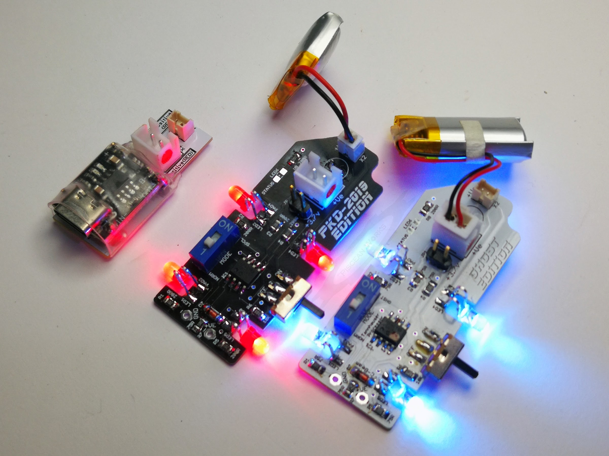

With reference to the AndersFP files, the clip was held with eight 5mm neodymium magnets where the pair or magnets at the rear also serves as connectors to power the green LEDs. I have included that in the circuit board and it is optional if they need to light the green LEDs.
The story so far...
The pre-Production Boards are in and I will populate them and test them for one final time sometime this week. Then I'll have to rush to complete the Manuals.
The ones that do are through-hole switches which solders directly onto the PCB and thus, will not flex when being inserted into the Ammo Clip.

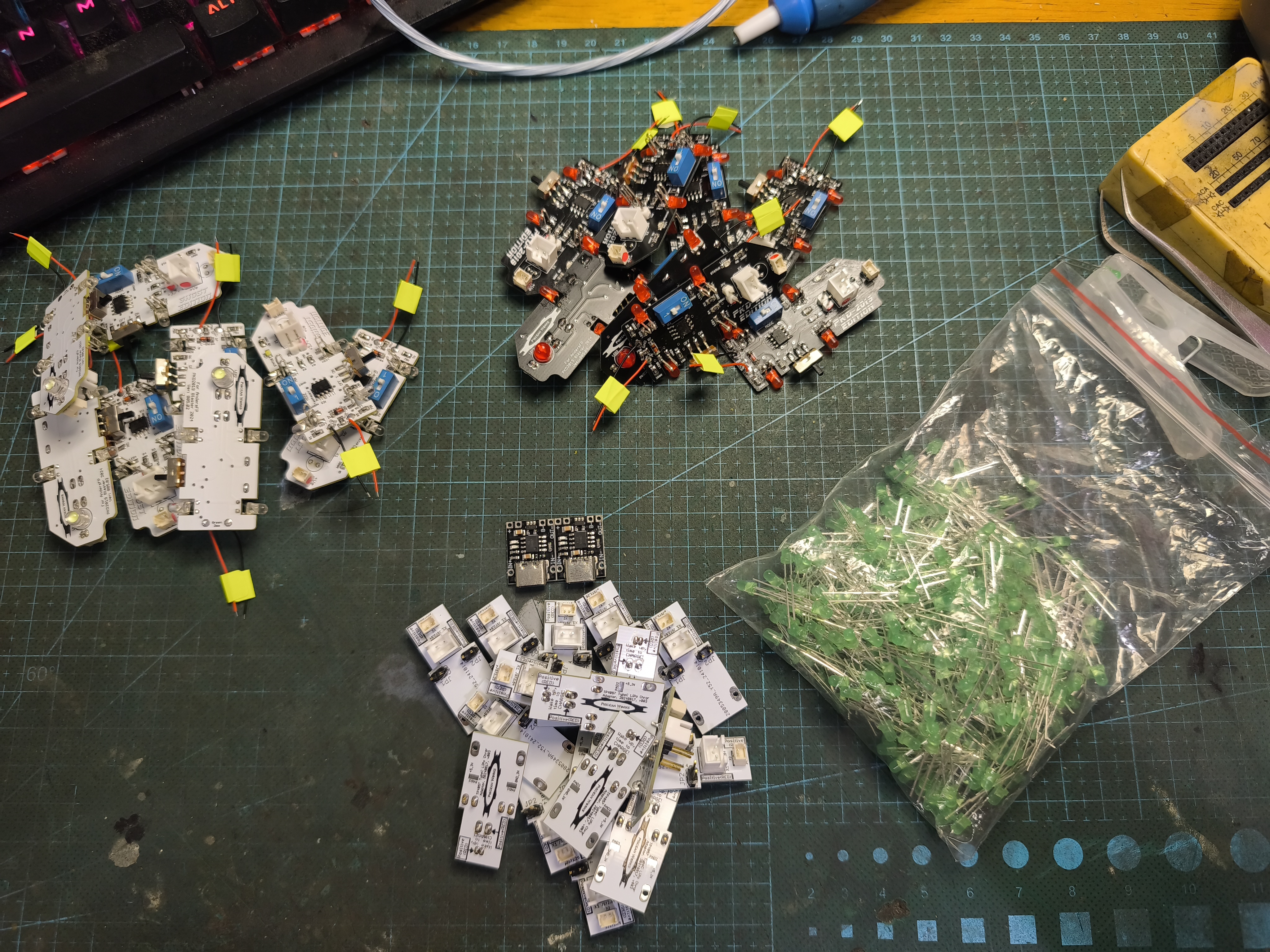

Just an update as I've been soldering for the past few weeks with the components trickling in. The main delay is trying to get the switch cover 3D printed. Months ago, I had designed it using the only 3D software I knew, which was SketchUp but the file has a lot of errors. Finally, through referrrals, I got one guy to agree to rebuild the file and print it. But so far, there is no response after our first convo.
Both boards are ready and I am waiting for the components for the LiPo charger and soldering the pair of green LEDs. Lastly, another one hurdle is getting the Colour Assembly Manual Printed in small quantities which is a problem as the rates are quite high.
Sorry for the lack of update as I've been posting Production Notes on my Website but today, I want to share with you guys that the idea of using 3D printing to replicate the switch finally worked. Most of the components and new equipment has arrived. It's taking longer than I liked as I am using some of my Day Job to finance the Project.
