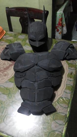

no problem man. I don't understand why people would become members of this community if they wanted to keep everything a secret.
As for your questions, in its current state, the pieces are just taped onto the mannequin but this is just to hold them into place for the pictures.
The abs are in fact glued into place onto a 2mm craft foam sheet. This way I could align the abs and then wrap them in vinyl without worrying about them moving around. Next I'm going to get another sheet of foam(probably 5mm) and try making an interconnecting piece that borders the chest and the abs. Then I'm moving onto the details on the ribs. I'll take a couple pics of the process as I go.
Good of luck on yours!

Finally made the frame for the abs. And was originally going to make the abs/chest a one piece by interlocking them into one backplate but it was making the whole thing too stiff and difficult to contour against myself. Cut off the plate behind the chest and the fit is much better.

thanks. It depends on he piece you're building. The gauntlets for example I don't heat shape at all. I hold the foam against a cylindrical tube and shape the pieces as I glue them and the glue makes them hold the desired shape.
the chest however I did have to pre-shape with heat prior to glueing the pieces together.
so really there is no finite answer to that as each I project is different and might work better using one method as opposed to another.
