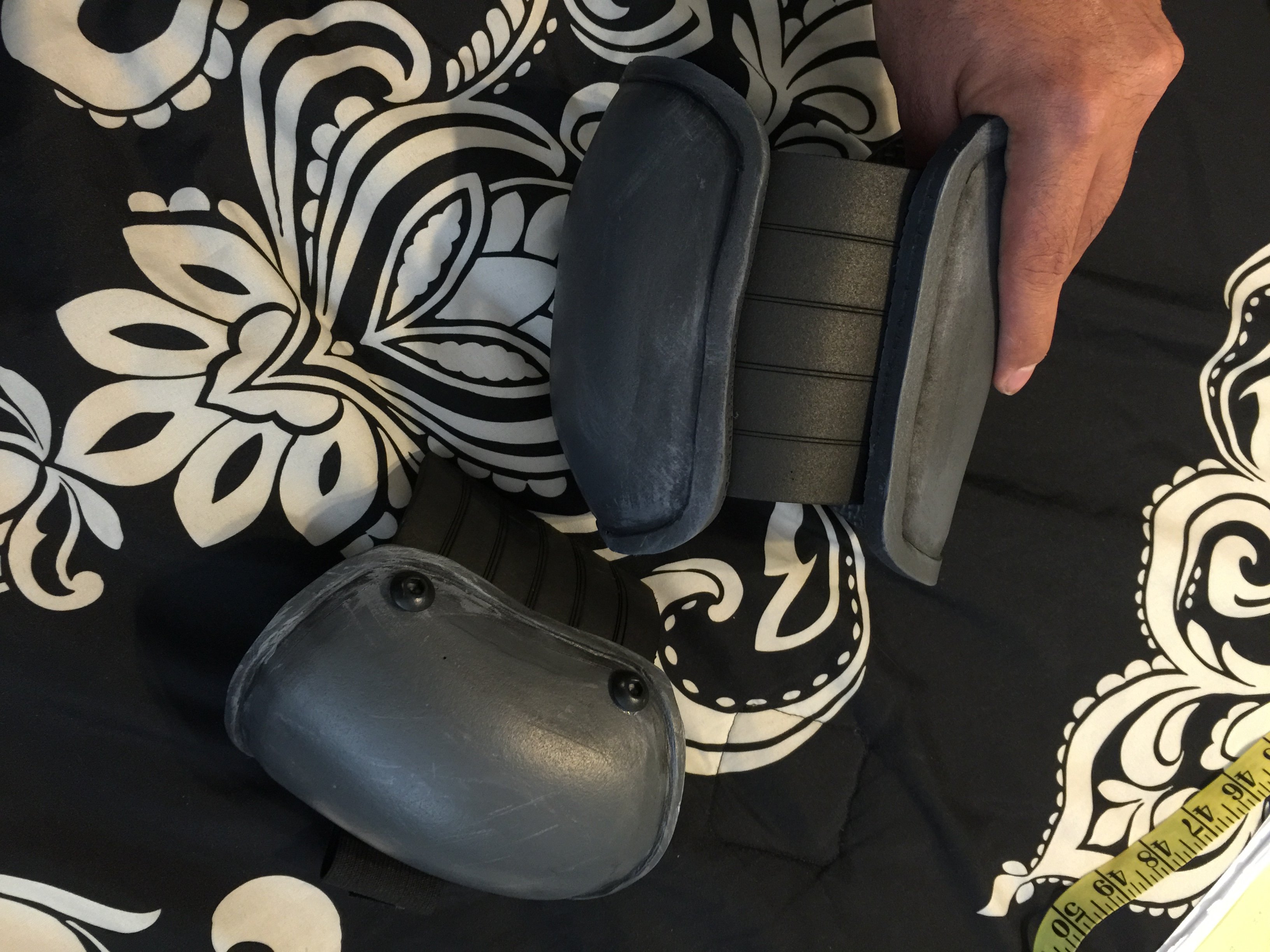

As for the bicep pieces, I simply drew a line all the way around the border and used the sanding drum of the dremel to make a smooth depression all the way around. After spray paint I dry brushed some black acrylic into the seams and then lightly wiped it with a damp cloth to give it a grungy used look and to add depth to the detail around the bicep. Anyhow here is a pic of the biceps.
On my version 2 suit I might try something different with the biceps as I plan to recreate them using foam wrapped in vinyl and bordered by a vinyl piping. Got to try it and see if it works or if it fails.
That explains a lot, I hate to be a bother, but I heard you said something about vinyl pipng, what is that, exactly?
