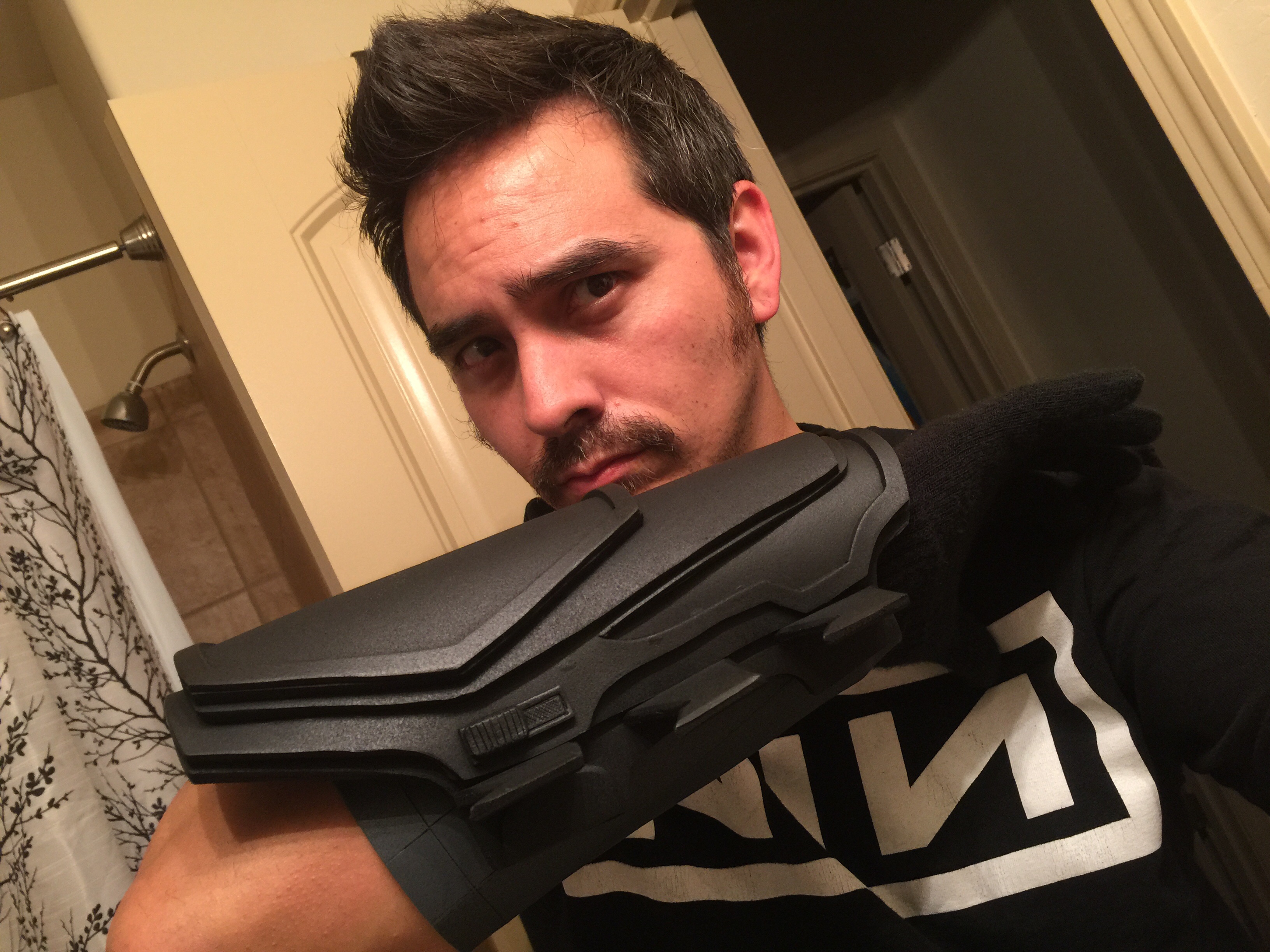

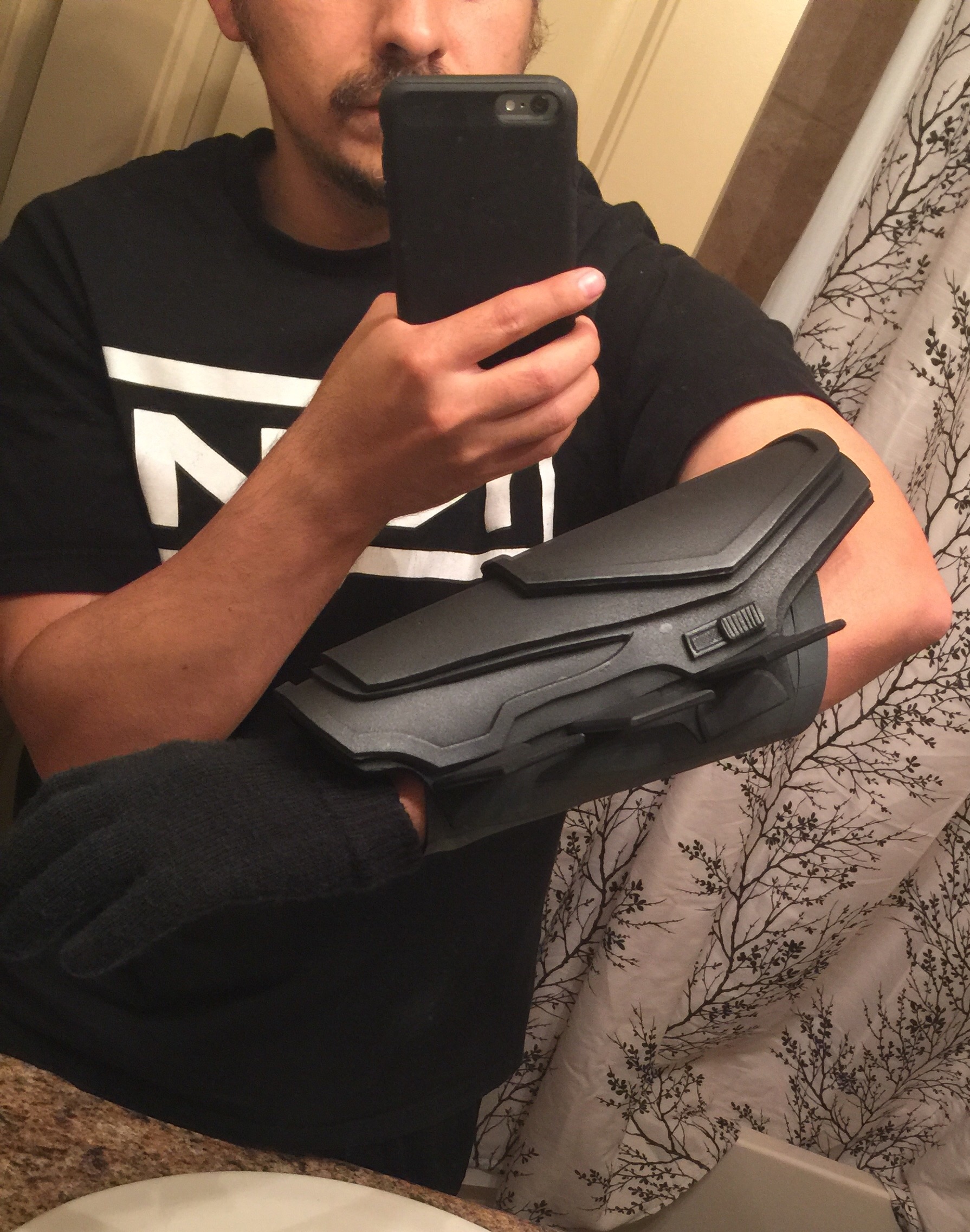

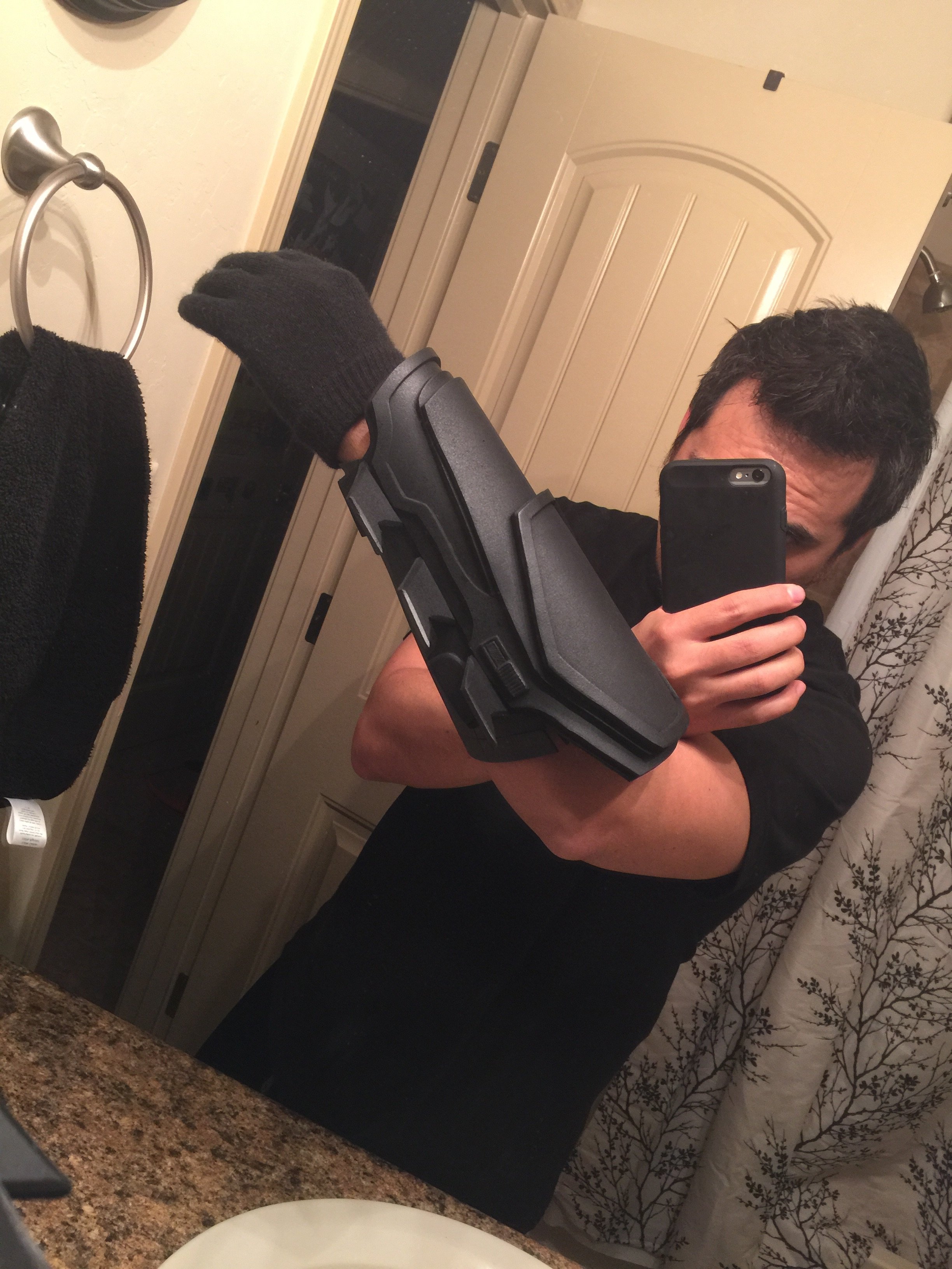

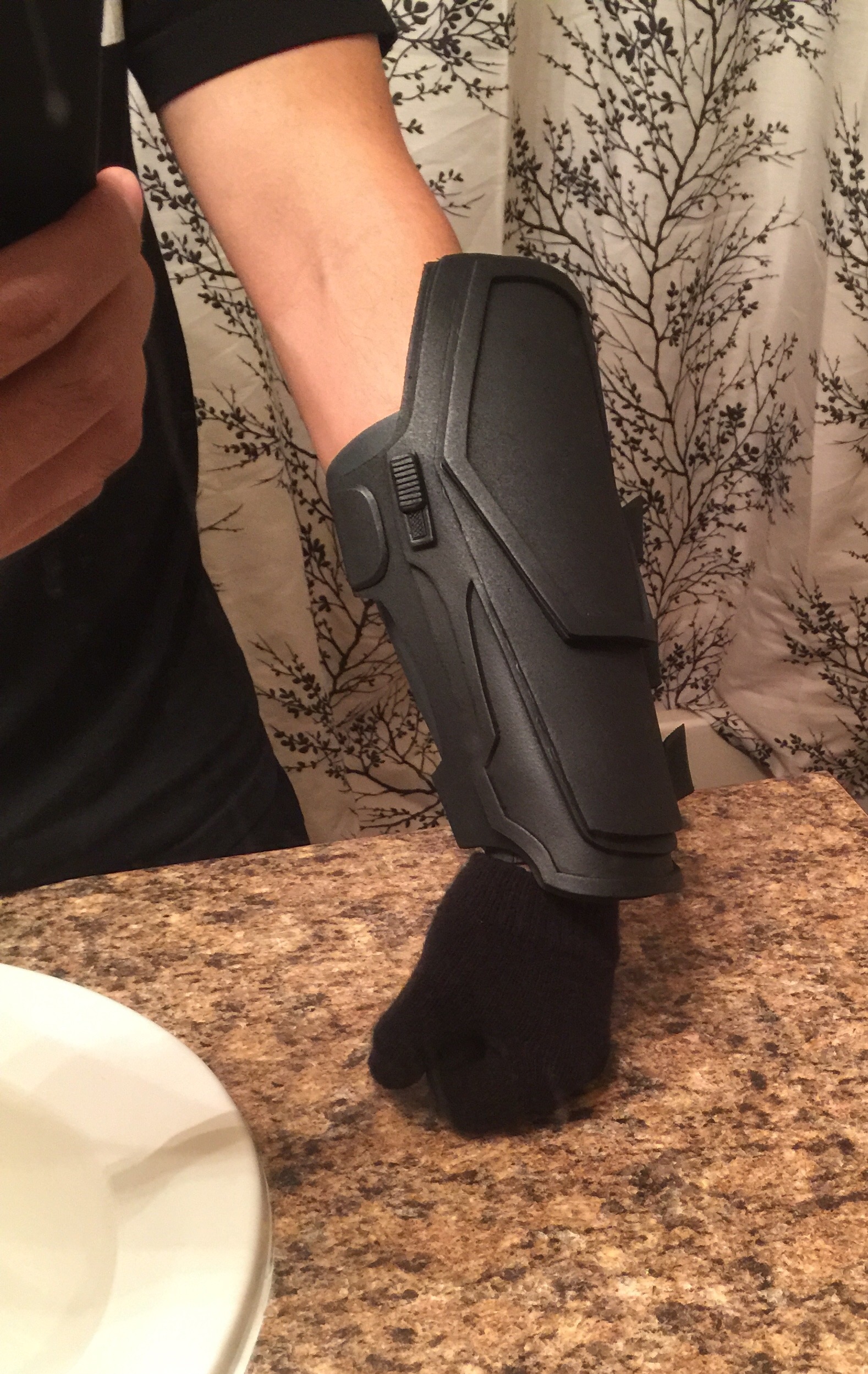

Only had a couple mins tonight to work on it. Carved out and added the sliding switch to the opposite side of the gauntlet and a little panel where the bolts will be attached. Threw on a light coat of plastidip. Came out nice. Almost done with the gauntlet. I'm pretty damn happy with the results. So much better and easier to construct than my old ones and much more accurate to the game model.
View attachment 454851View attachment 454850View attachment 454849View attachment 454848
If you don't mind, I have two questions: Did you plastidip before or after you glued on the Velcro on the straps and the straps to the gauntlet? I'm always fearing this chemical reaction that would destroy the gauntlet.
Re: Batman: Arkham Origins Build - Version 2.0
I always add the straps after plastidip and paint. Depending on the adhesive it could cause a reaction. Superglue no issue. Contact cement can start to mess with the dip but just be percise on where your gluing. Or you can use the sticky back Velcro. Which is what I do on my gauntlets.
