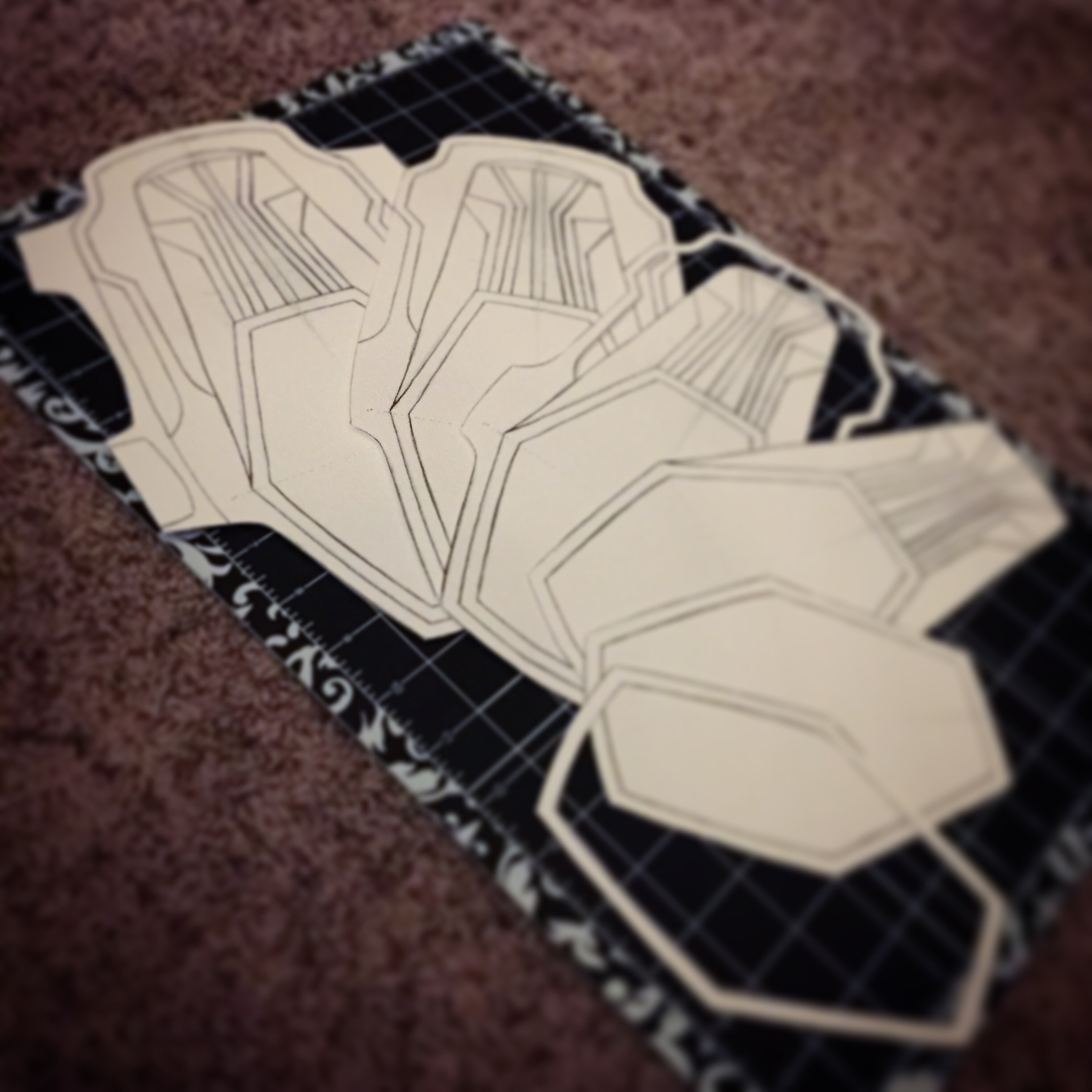

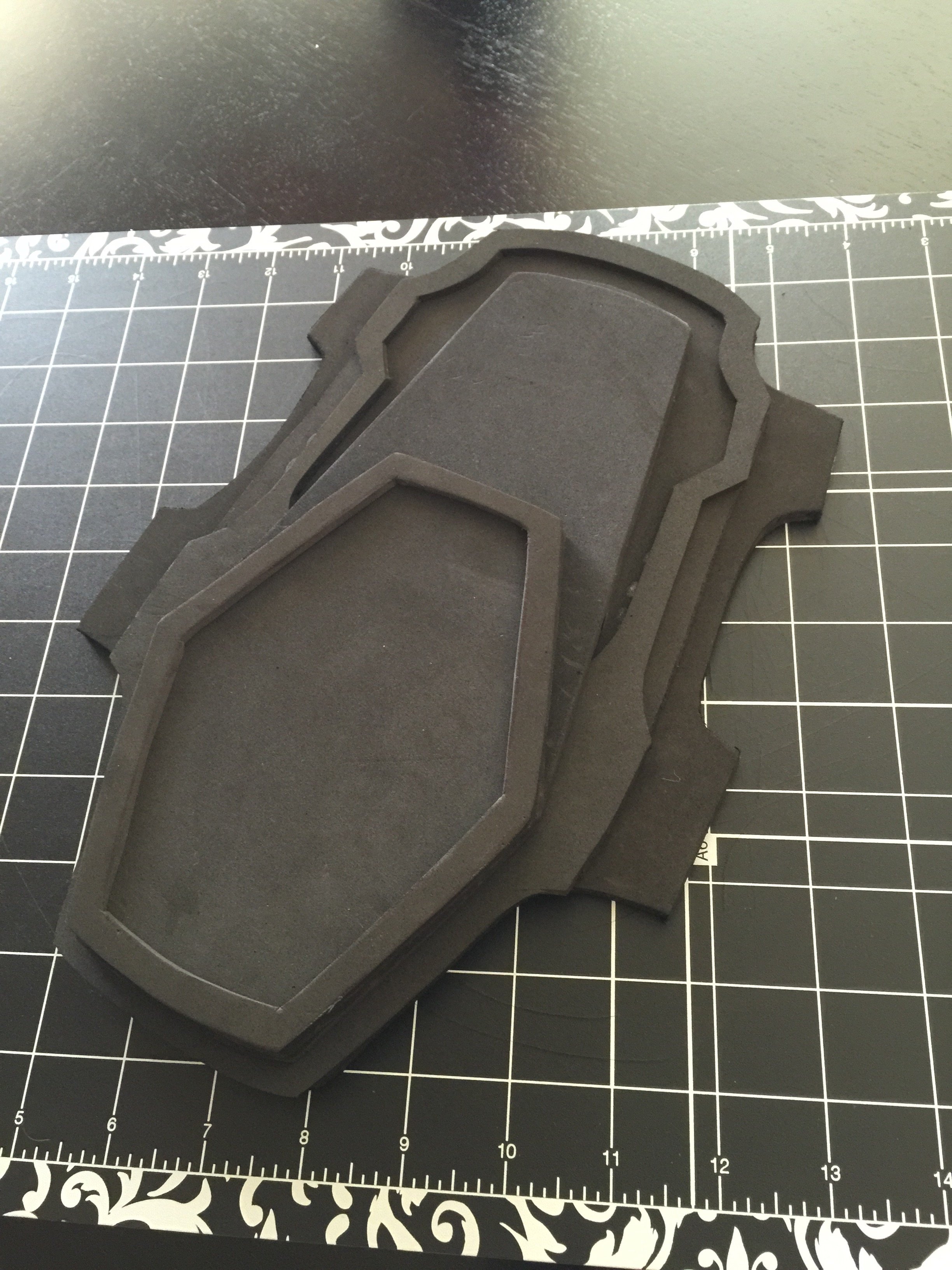

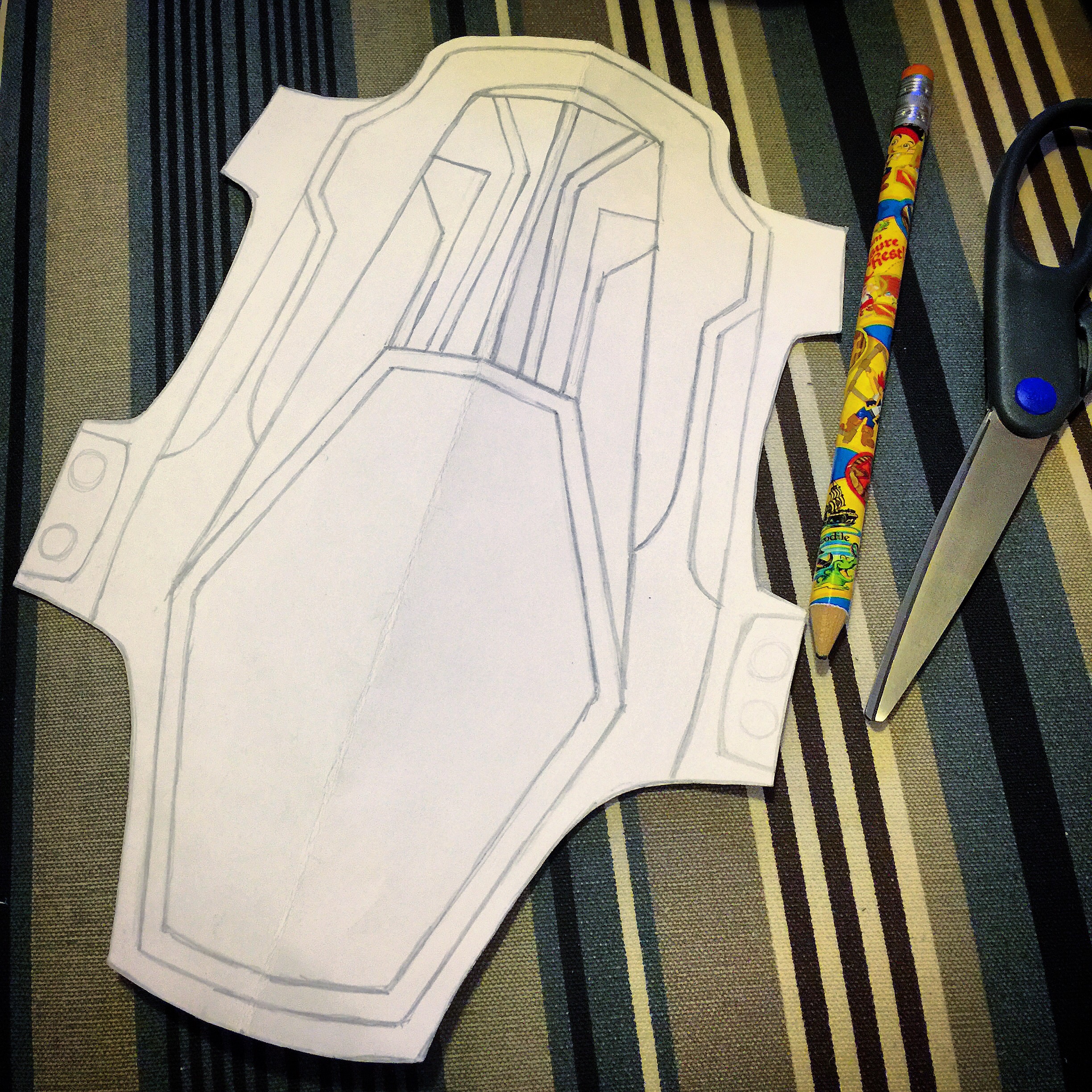

First things first. Where to begin? This time around Ive decided to start on the gauntlets, so I've free-handed a new template. Printed it on card stock which divide into 6 layers of foam(3mm and 5mm)

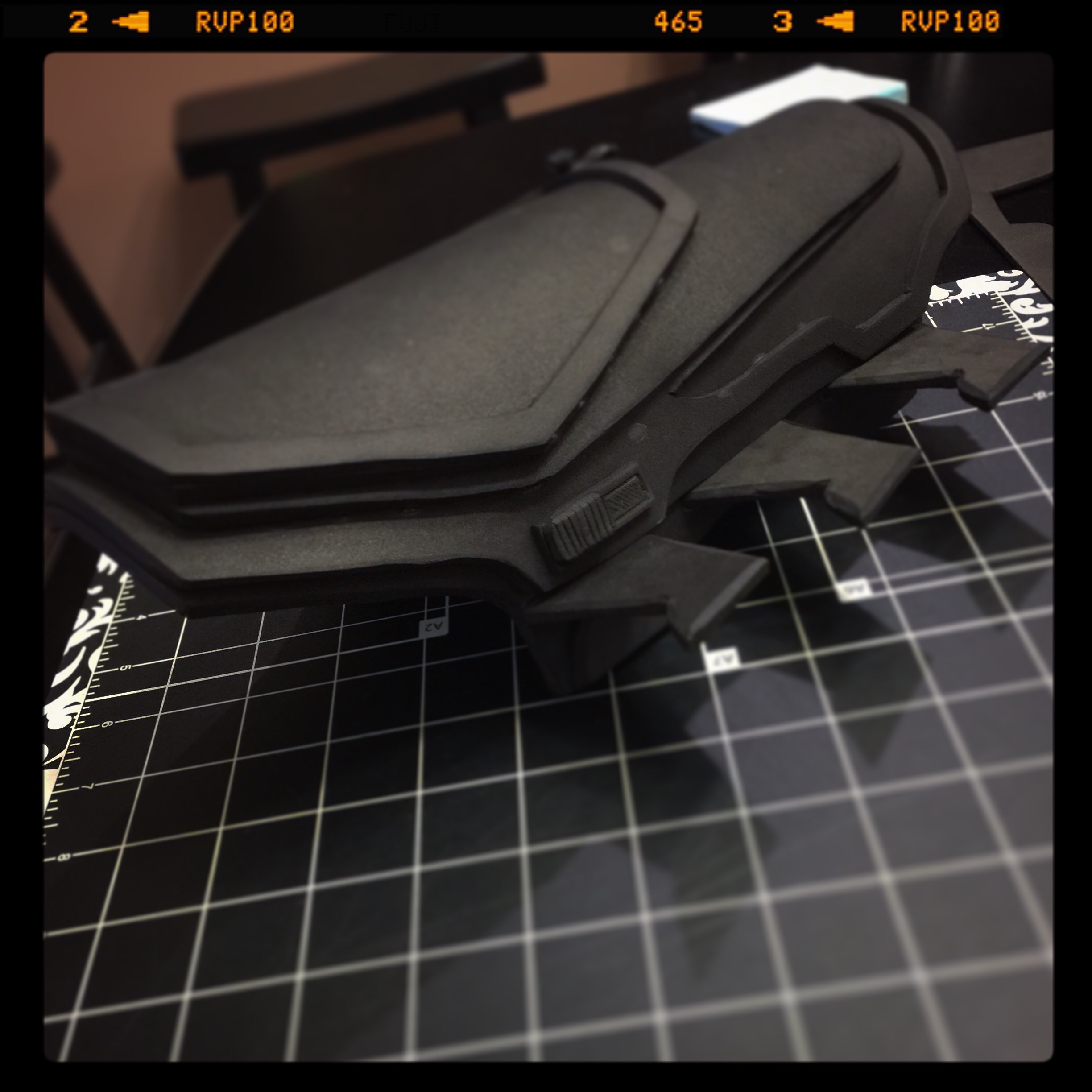

Since im looking to create an embossed look around the borders using a thin 3mm foam, I decided to use super glue instead of hot glue. In my previous experience I found that the hot glue would warp the thin layer of foam and actually was quite messy since the coverage area of the border is small as well.
Ive finished cutting the layers and I've glued, heated and shaped the first gauntlet. In my opinion this version looks far better than my original design.
I'll post my current progress as I'm done for the day, but the gauntlet is still not complete however as I still need to add more details, the spikes and straps... as well as a plastidip and acrylic dry brushing.
After this I was able to draw out and cut out a card stock template of the blades.
i then traced it onto some 3mm foam, beveled the edges with the dremel and attached them with super glue.
After this was complete I utilized the time I had to carve out the little sliding switch that appears atop the rear blade. Not sure what it's purpose is but it sure looks cool. :D Almost ready to plastidip this bad boy.

Yeah. After a couple frustrating experiences using hot glue and thin foam with my previous build I completely scrapped the use of thin foams. Upon venting my frustrations a user by the name of bigbat told me that he uses superglue in those situations and finds it cleaner and easier to control. I tried it again when I was constructing my boot covers and he was right. Hot glue has its uses for sure, but for the precision work you need to get some kind of superglue. Only thing with superglue is that the bond is pretty instantaneous. Hot glue allows you some play to slide things into position until it cools. Super glue doesn't give you that. You have about half a second to make any adjustments before the bond becomes permanent.
as for the cuts, Im simply using an xacto blade with a cheap self healing rotary board underneath.. Using my template to trace onto the foam in pen... Then lightly scoring with the blade, then do a once over with adequate pressure to complete the cuts. I used to try light pressured passes several times till I broke through but found it can create an uneven cut requiring the use of the dremel to smooth out. Which in some cases will make you lose the particular shape you traced out to begin with.

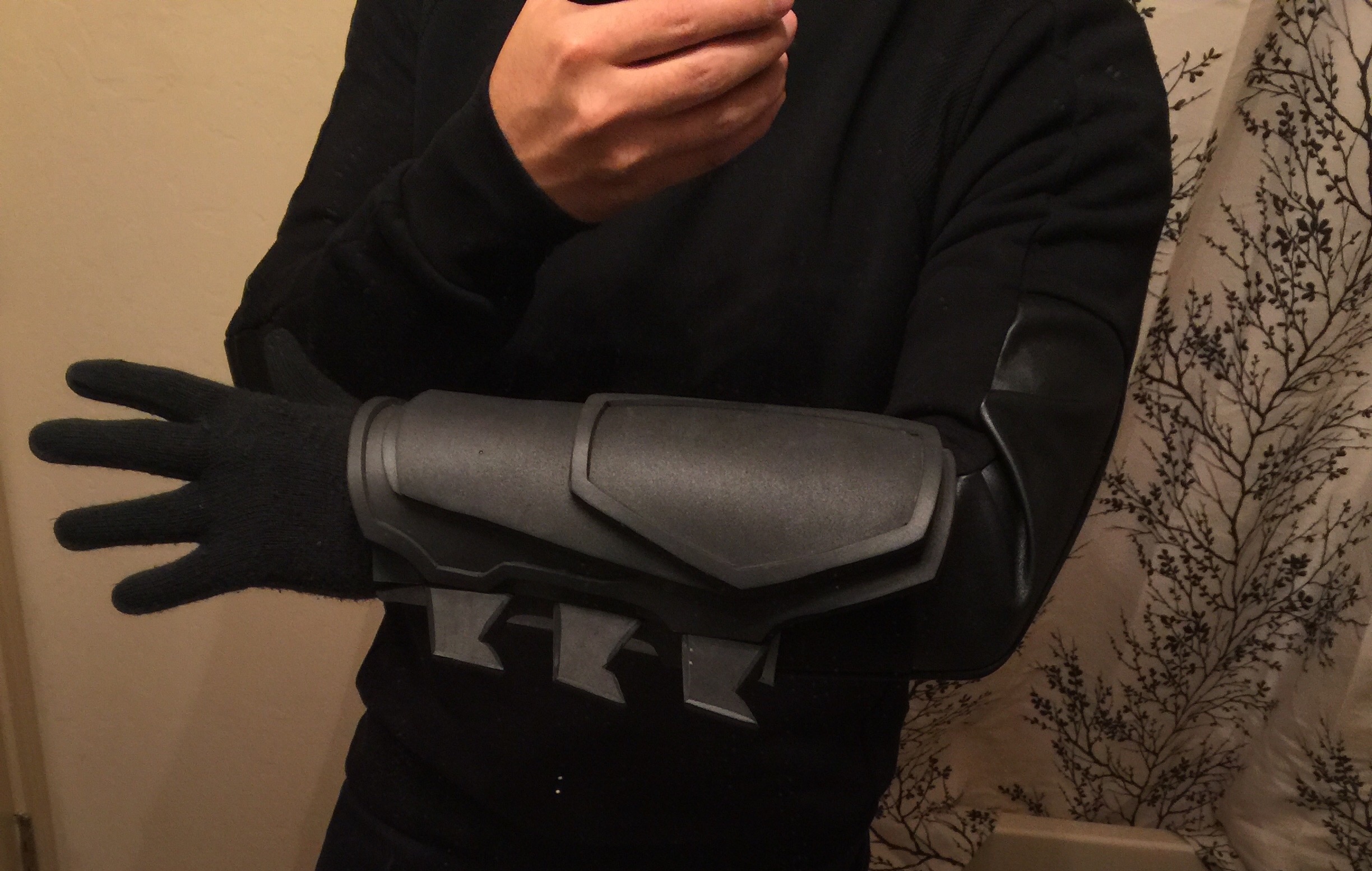

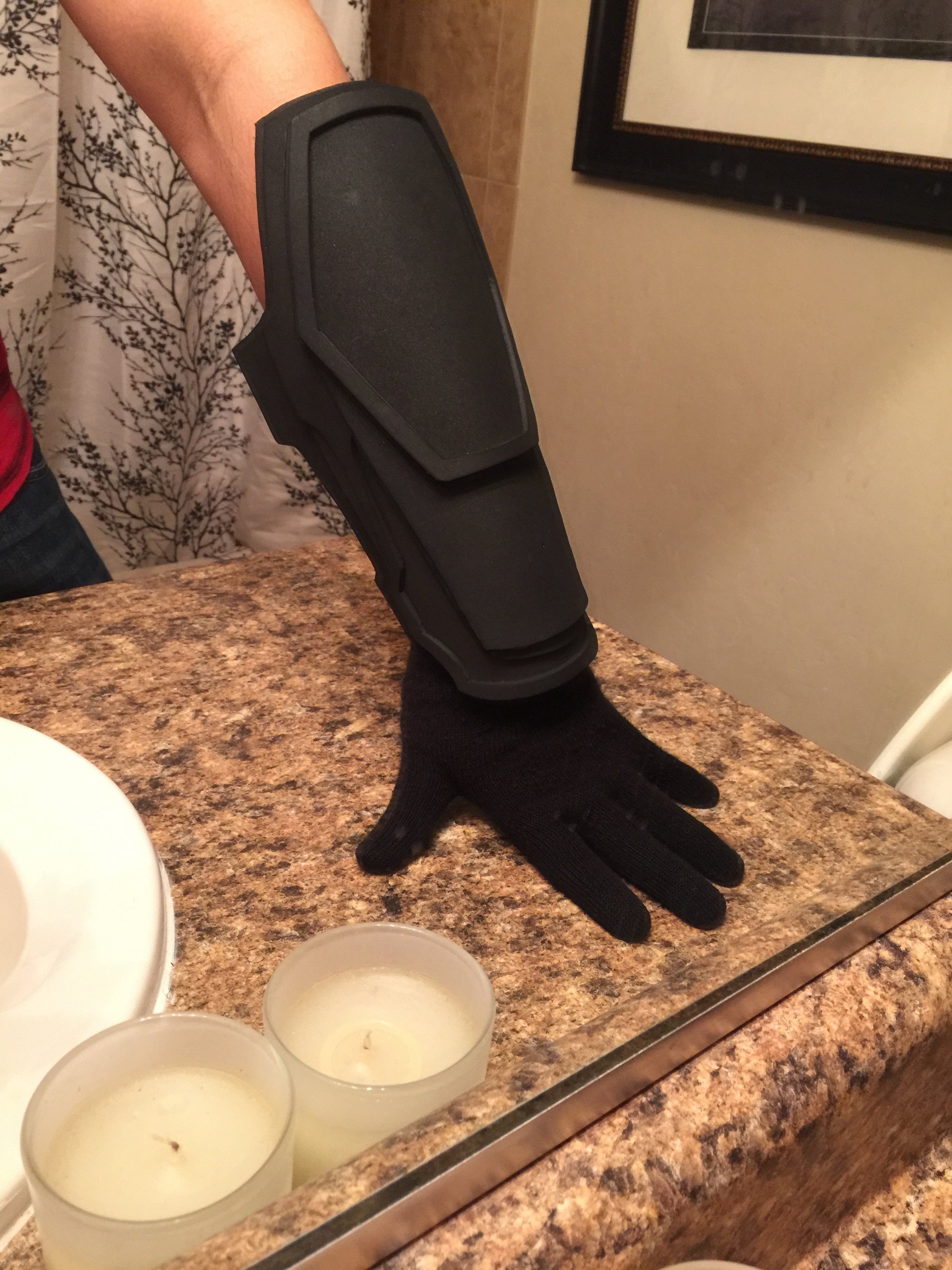

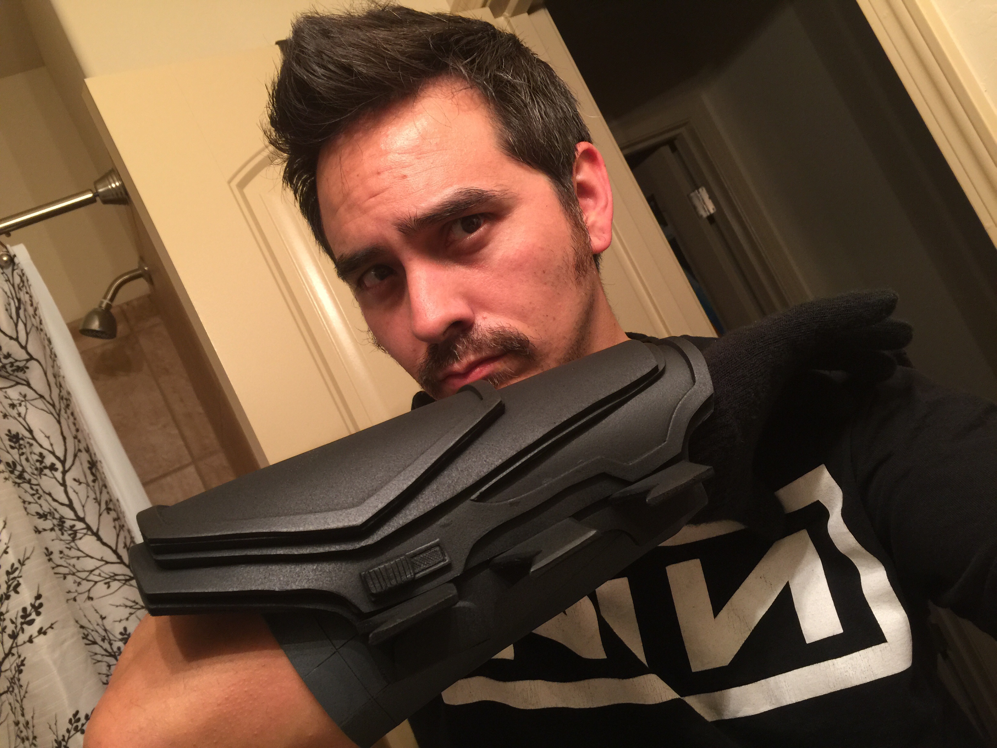

Only had a couple mins tonight to work on it. Carved out and added the sliding switch to the opposite side of the gauntlet and a little panel where the bolts will be attached. Threw on a light coat of plastidip. Came out nice. Almost done with the gauntlet. I'm pretty damn happy with the results. So much better and easier to construct than my old ones and much more accurate to the game model.

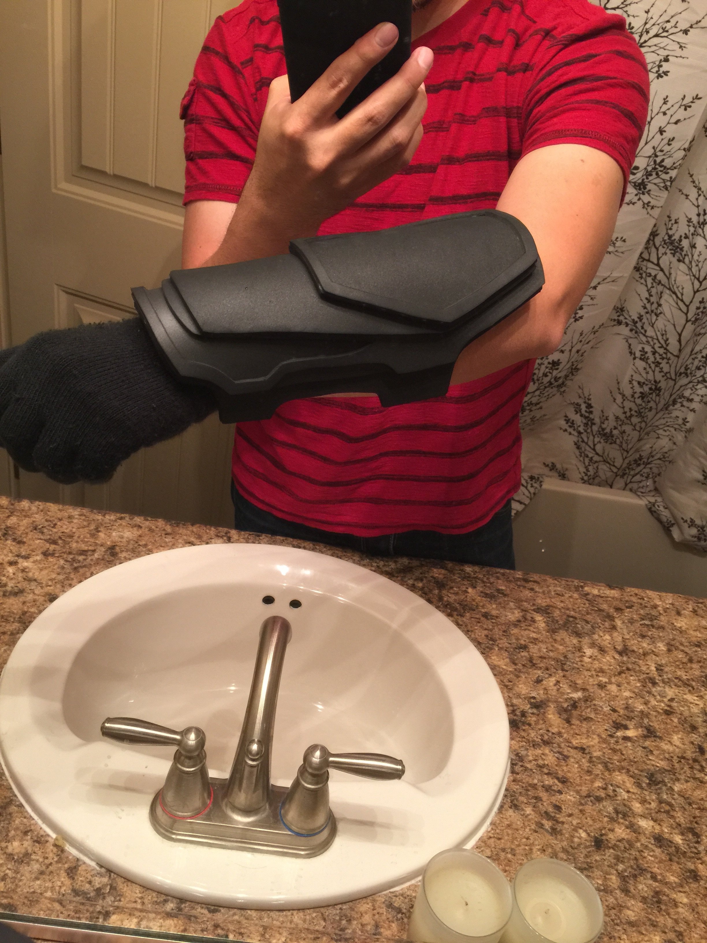

Thanks for the kind words guys, I really appreciate it. I'm going to spend tonight probably making the left gauntlet. Now that I have all my templates made up I'm wondering how fast I can complete it. I'm guessing an hour. then I need to decide what's next. :D

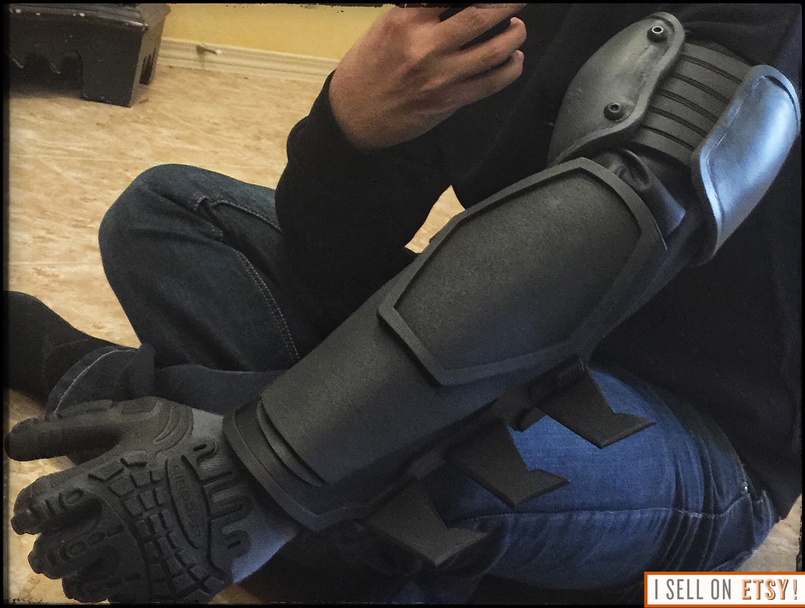

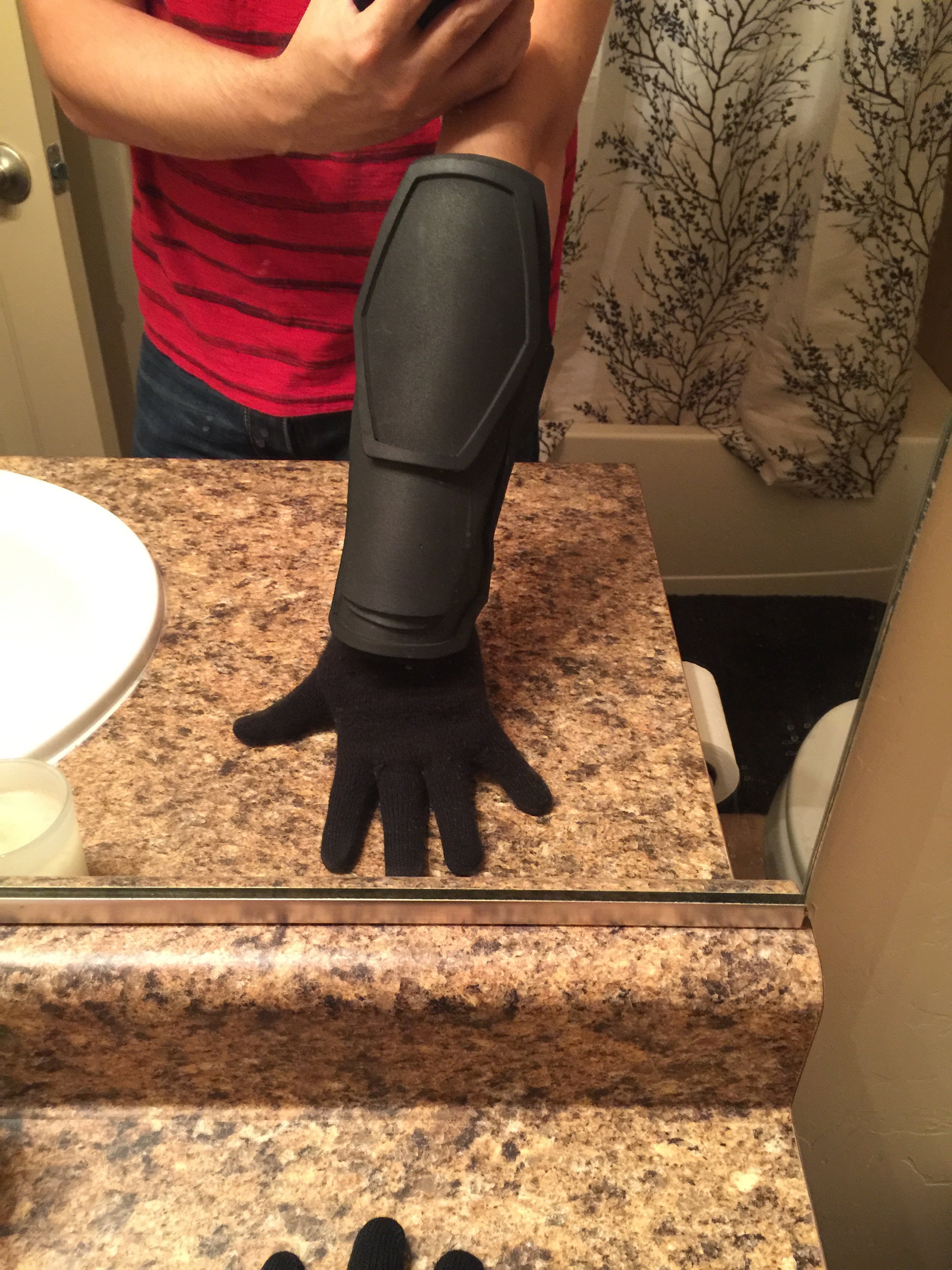

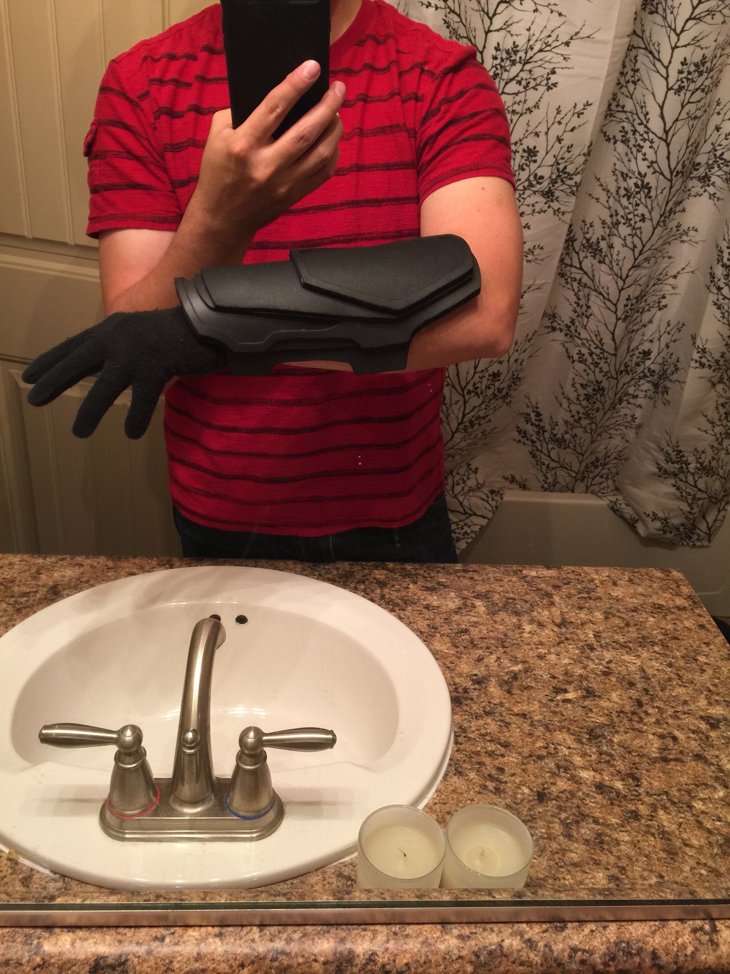

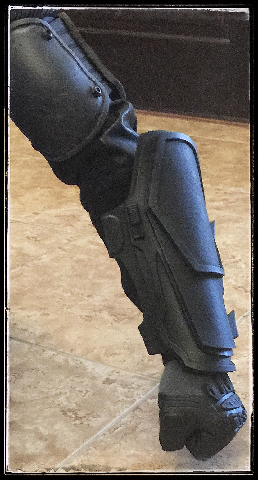

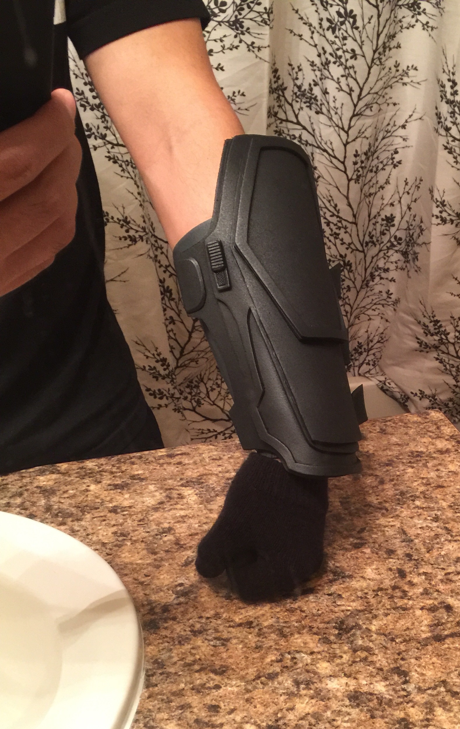

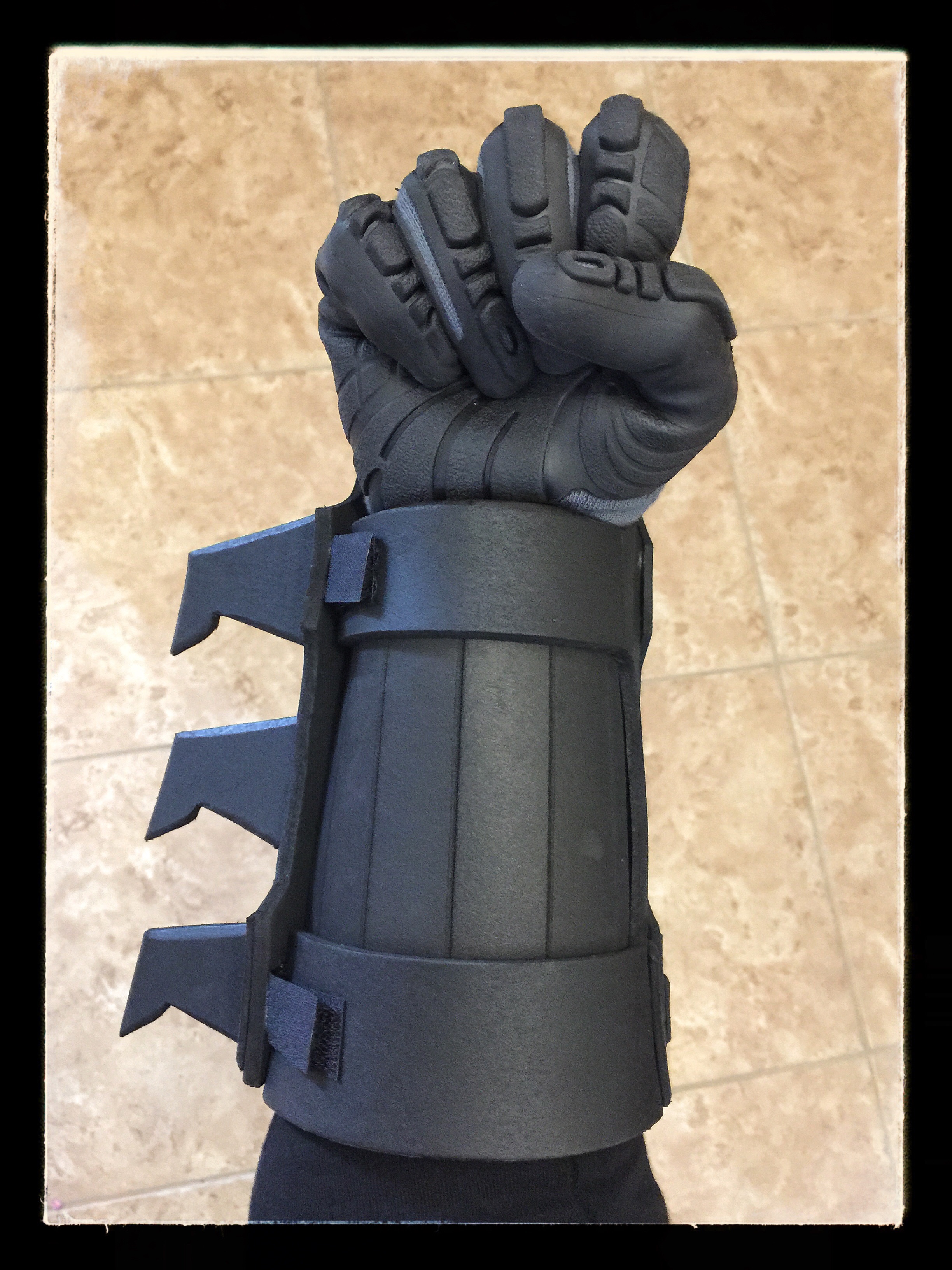

Nothing really new to add. All I did today was complete the second gauntlet. Tomorrow need to figure out what I should work on next. In the meantime for those interested or bored, Ill just share some more images of the completed gauntlet. Picked up a set of cheap gloves at Lowes and the bicep armor in the pics comes from my Ver 1.0 Origins suit.

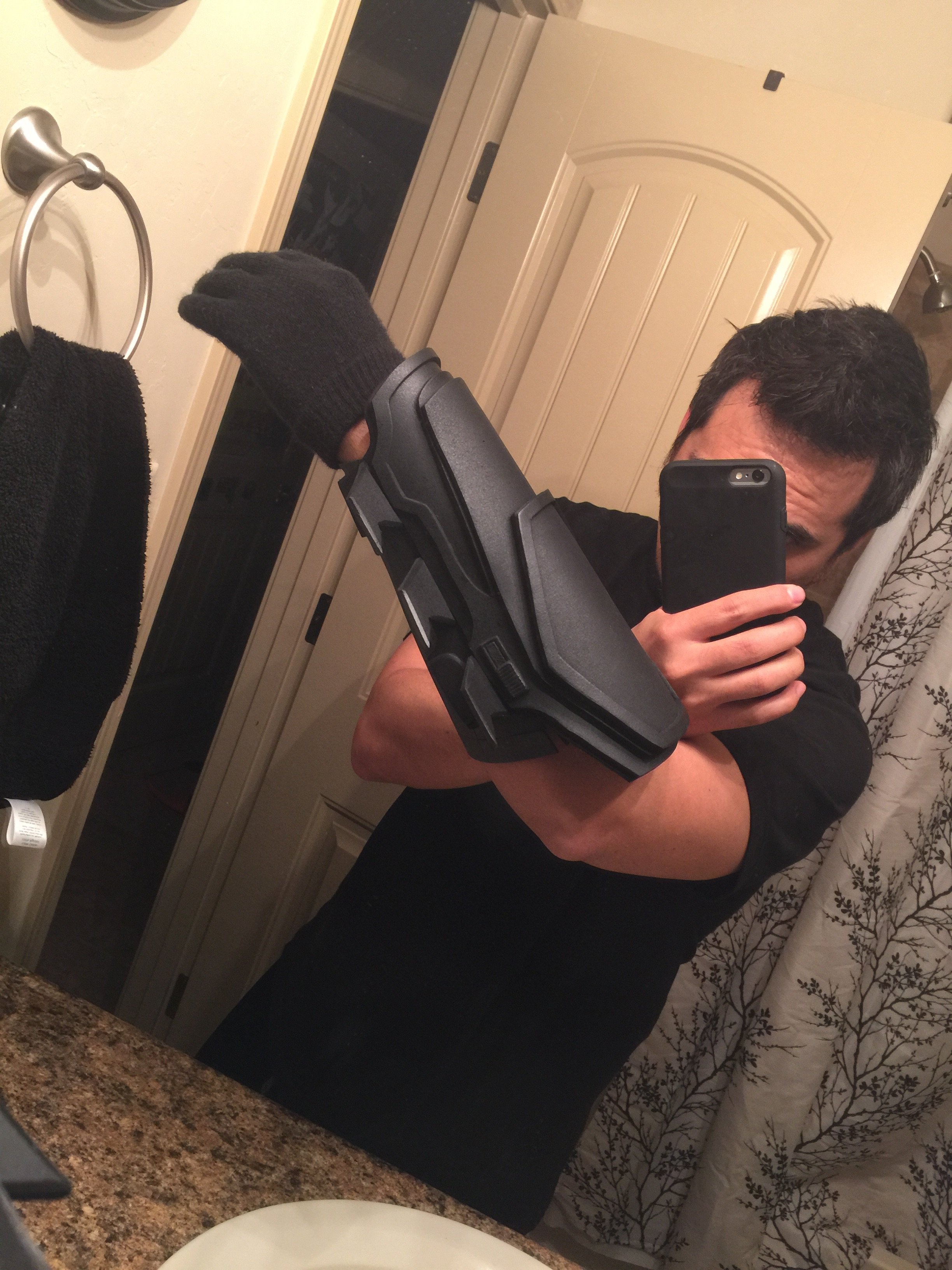

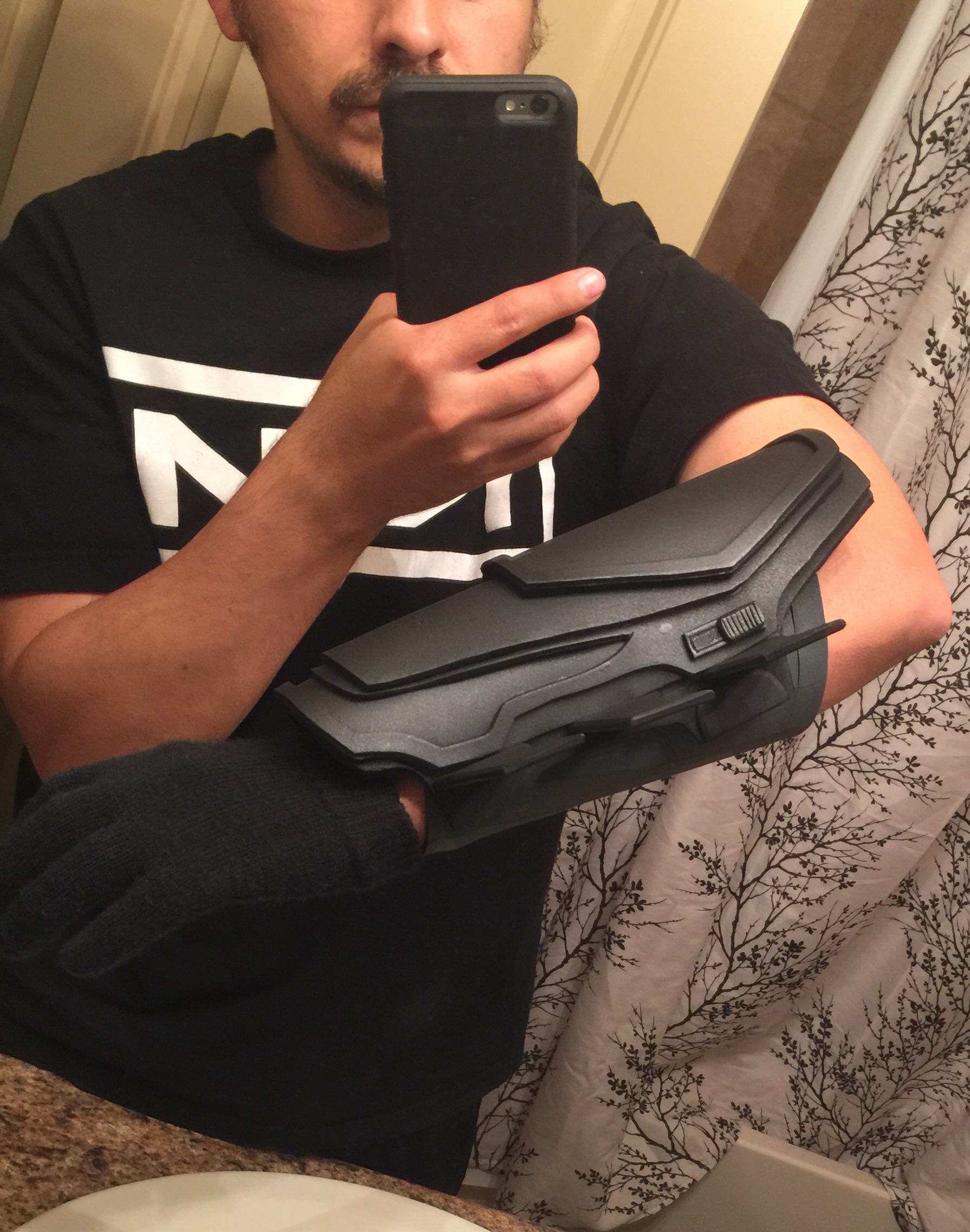

I only had Velcro holding this thing in place but decided to redo the underside to round it out and add a little bulkiness to it. Might add an extra 3mm foam strap to overlay on top of the two existing ones in order to hide the Velcro... But I dunno. Cause it's not really noticeable in person.
