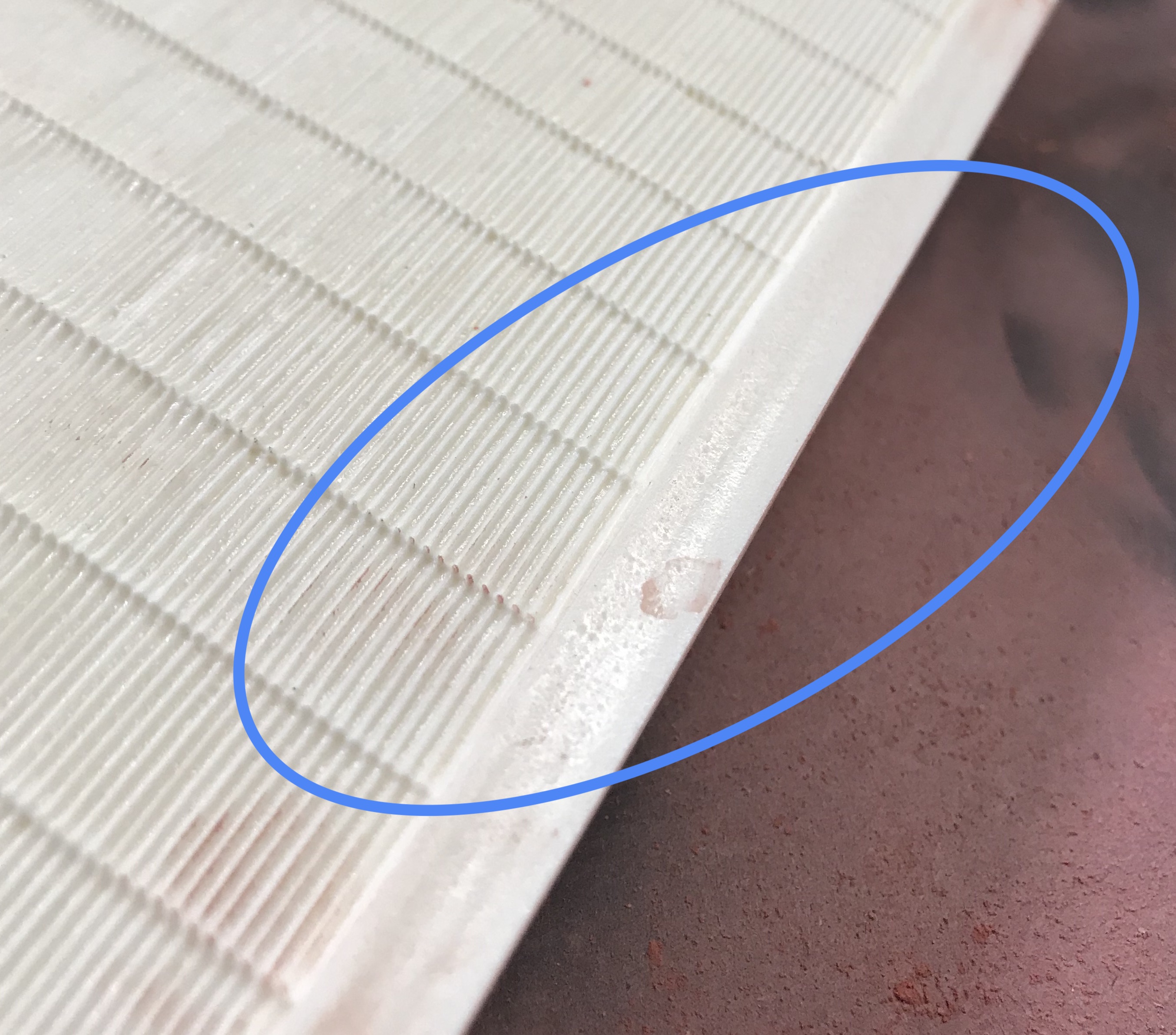

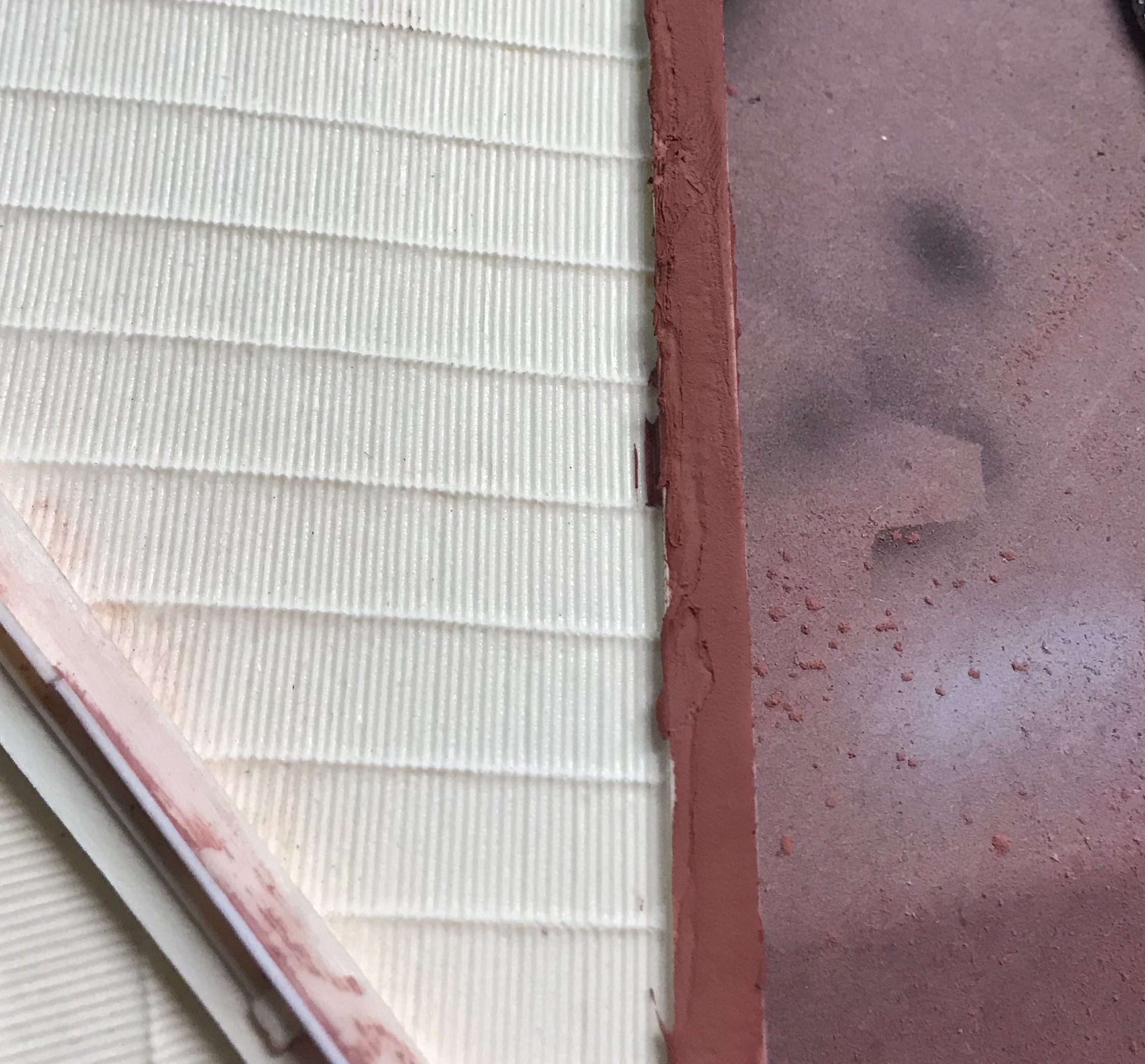

So I noticed on the edges of the wings, there was a bit of a dip on most of them. You can hopefully kind of see it here:
It wasn't on all the sides, just... well, most. So I grabbed my Bondo and went to town... (and yes... I Bondo like I'm a three-year-old with a twitch...)
I will say though that after sanding it down with 220, 320 and 400 it filled in the dip, and came out pretty smooth. The proof will be in the primer pudding. I'll be doing that later this week when the Mr. Finisher arrives.

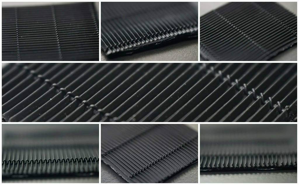

So my CoolShade looks pretty bad. Almost like an air conditioner at a crappy motel...
Any suggestions on how to fix this? I mean, I'm sure the black will hide some of these crimes, but damn...

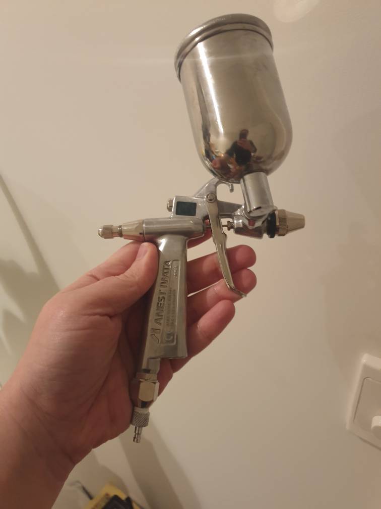

I've bought an Iwata mini spray gun for such situations, otherwise you'll be there forever laying down a uniform coat.

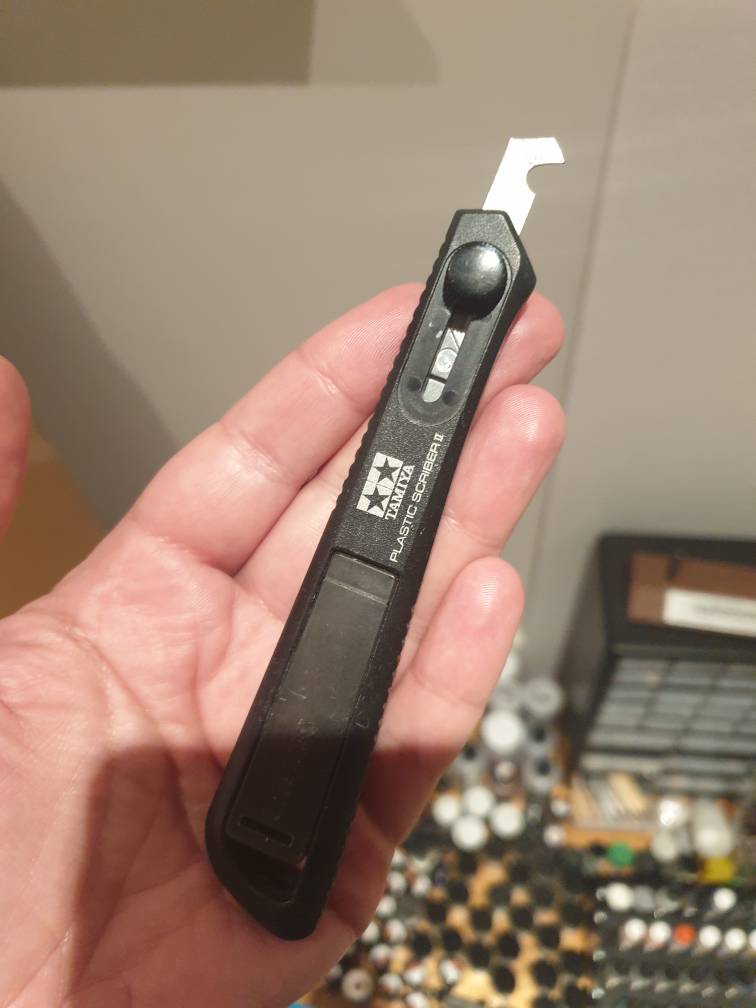

If you have the patience, gently go over the grooves with a scribing tool (guide it over a straight edge ruler). Tamiya make a nice panel line scribing tool that you can find in Amazon.

It may help to first rub along the direction of the grooves with a stiff brush to remove any loose gunk, but from the look of the cast Koolshade it's more likely to be irregularities in the resin in these grooves which can only be cleaned up by rescribing them.
madebyap
Thank you! I’ll pick up one of those scribers and give it a go.
Nice! I did not know such a thing existed. I always use rattle cans on larger projects because I can never get a perfect coat on my larger builds with my air brush. I will look into one of these for sure.

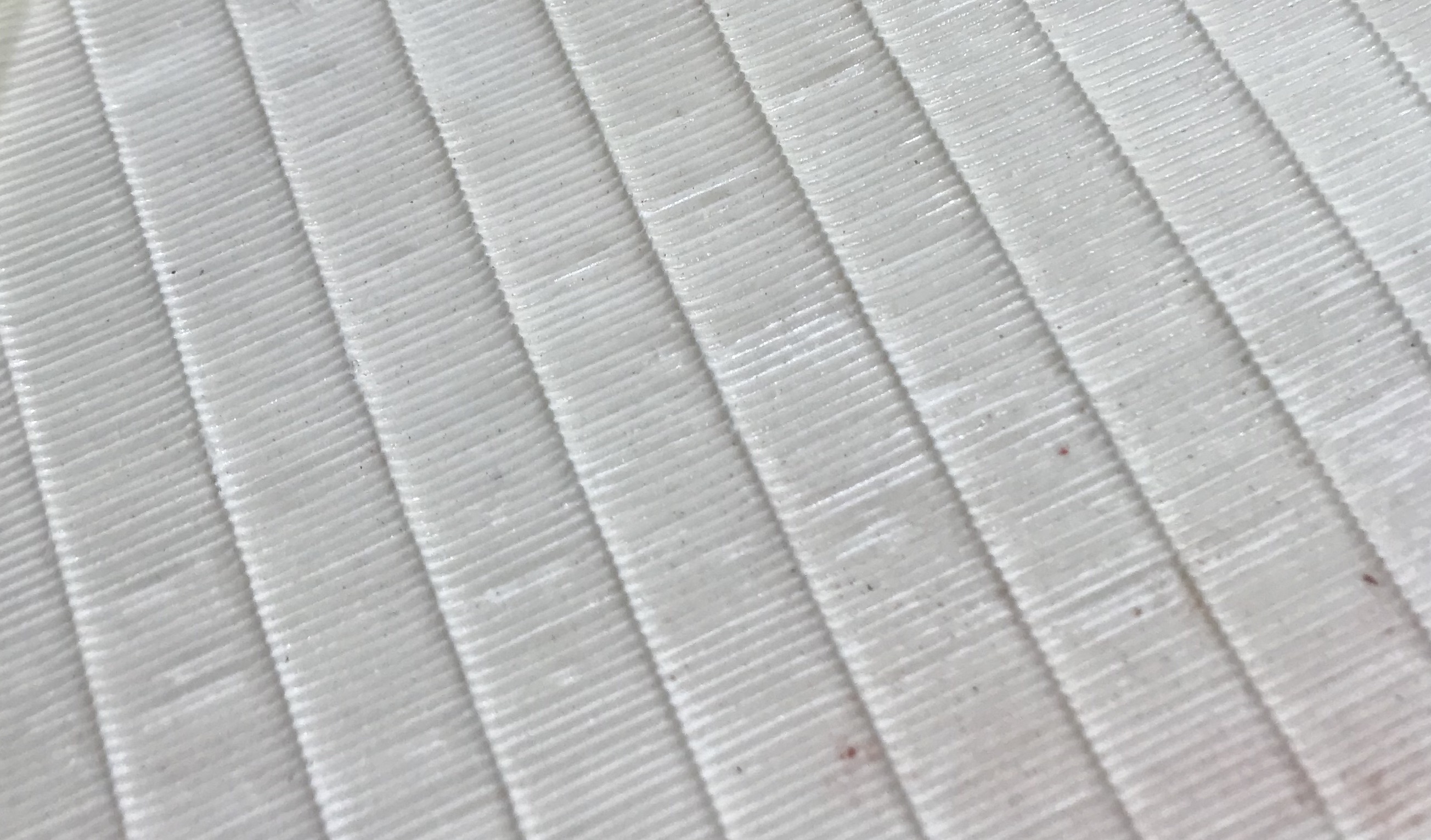

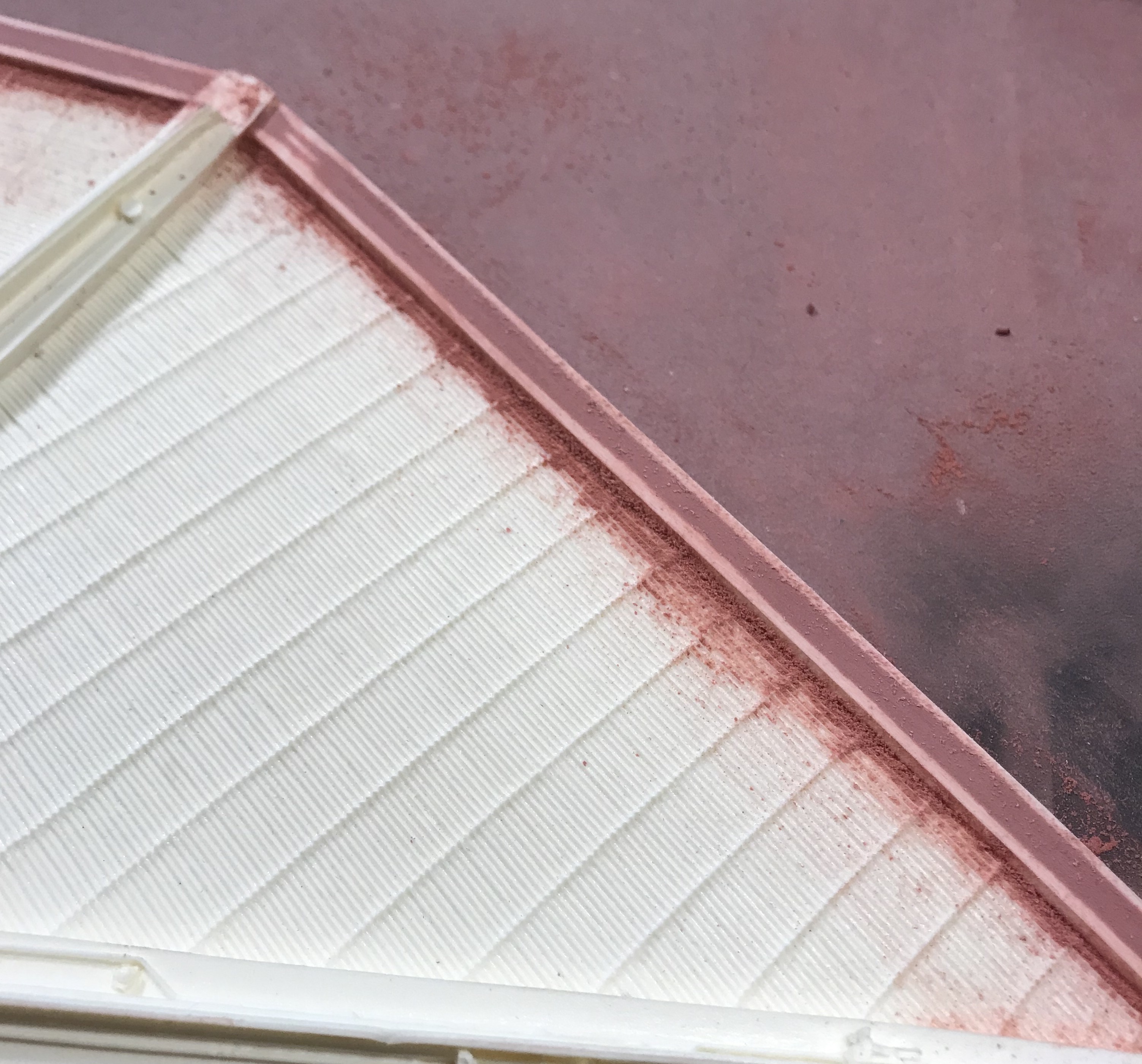

These wings are just hella busted. I tried using the scribing tool (thanks PeetL for the reco, I'll be using it on projects for sure!). The problem with the koolshade/coolshade (what is the proper spelling? I've seen it both ways haha) is that it all is physically dented, or just cast poorly (this was listed as a miscast so I knew kinda what I was getting into).
Here's an extreme close-up. You can see how it's just a wavey, dented mess. I think the only way to fix this is to replace all the coolshade somehow.
I am going through and scribbing some of the really bad ones, just to try and define them a bit better, but damn...

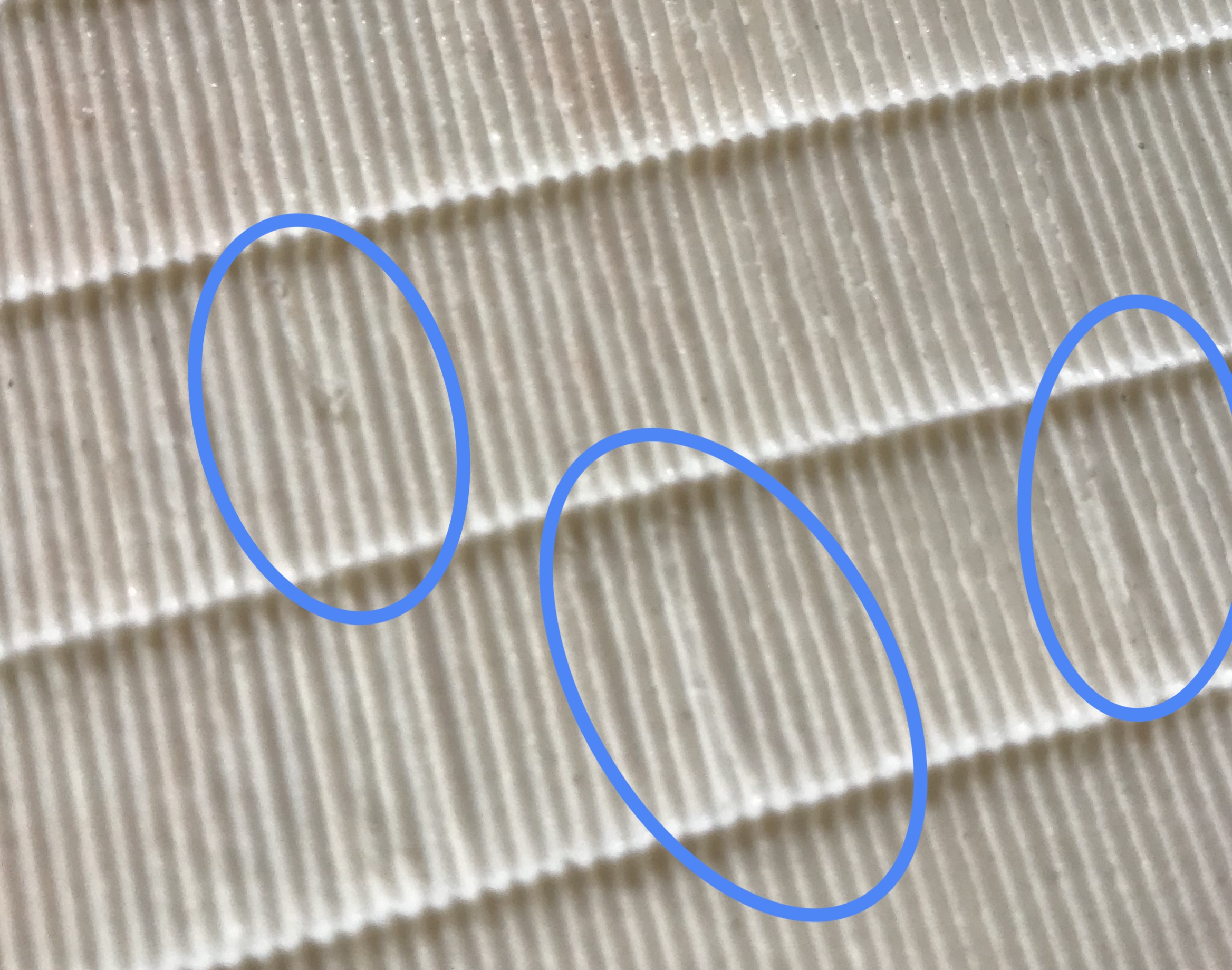

Another fun thing, so I started priming as well.
And even though I washed all the parts, I guess I didn't get into the coolshade grooves (that sounds like a jazz album) as well as I should so the Vallejo primer scratched off... so, I cleaned it all off, re-washed and really got in there, and have since primed with the Mr Finisher 1500 Gray (thank you again PeetL) and feeling pretty good now.
The primer did reveal some crimes that I need to solve but we'll deal with that tomorrow!

Great job!
As for the "dented" regions of the Koolshade (yes, spelled with a "K" as per the past company's name), you could chisel those areas as flat as you can, fill them with some epoxy putty to make them level, and then create styrene louvres and glue them on.
If there are too many such damaged regions, an alternative is to forego using this casted Koolshade and opt for using the following high quality cast that my friend makes.
PM me if you want to follow this option.

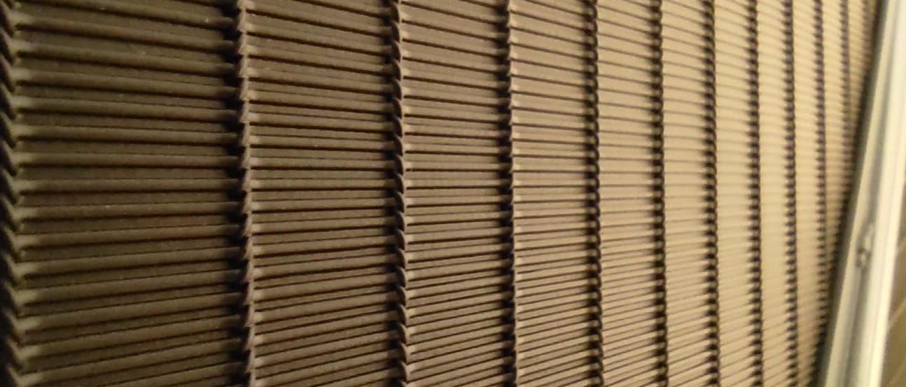

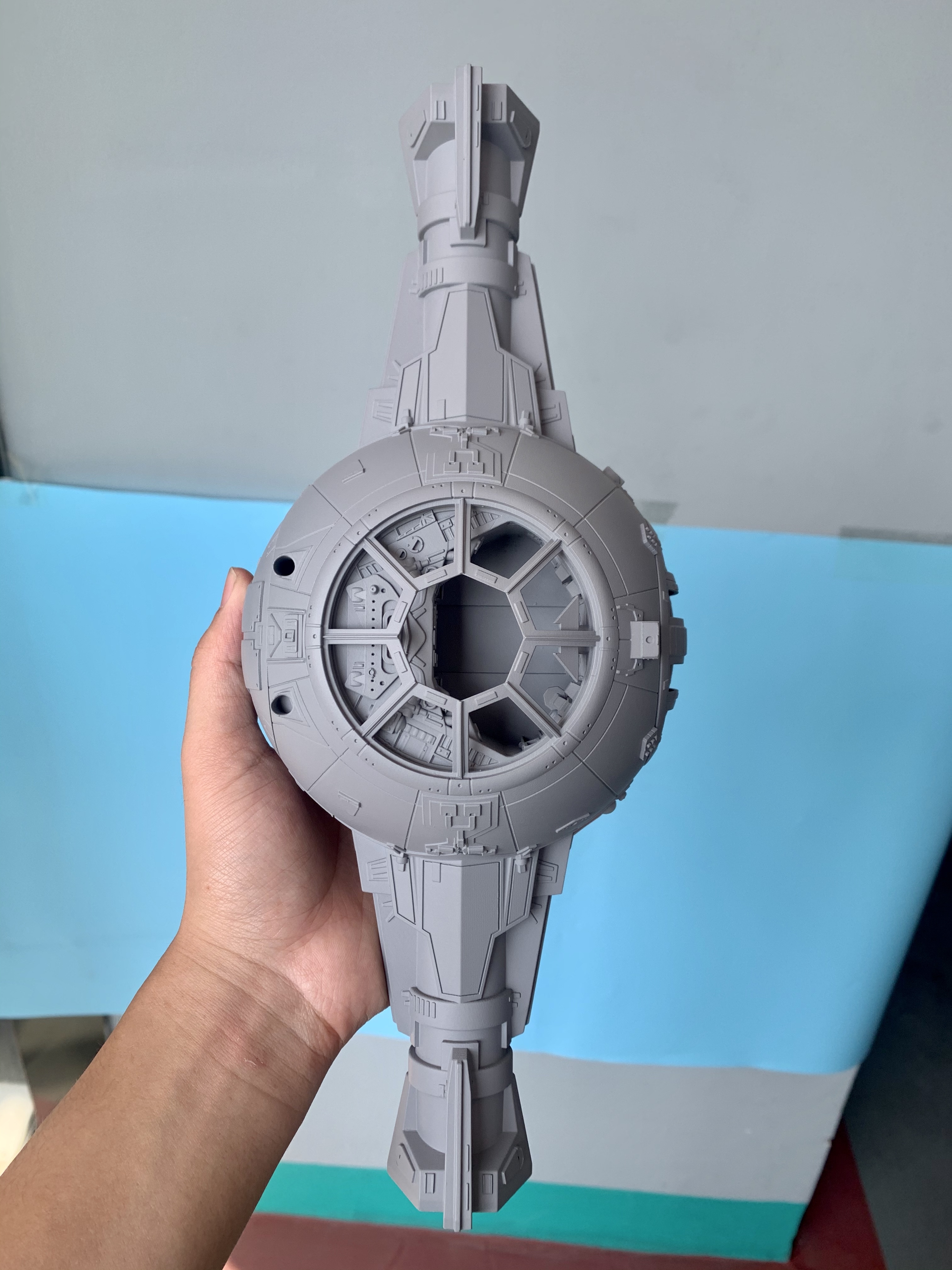

hi madebyap
maybe this could be interessting for you ;)
what you see here is a Resin SLA Laser 3D Print, the Parts are assembled. In this case here are 4 parts
1. main body
2. cockpit window
3. top part
4. bottom part
inner cockpit and backside are merged with the mainbody :)
Thinking about the koolshade was not easy but the result is also good for a 3d print, check this:

Hope you like it ;)
Cheers
