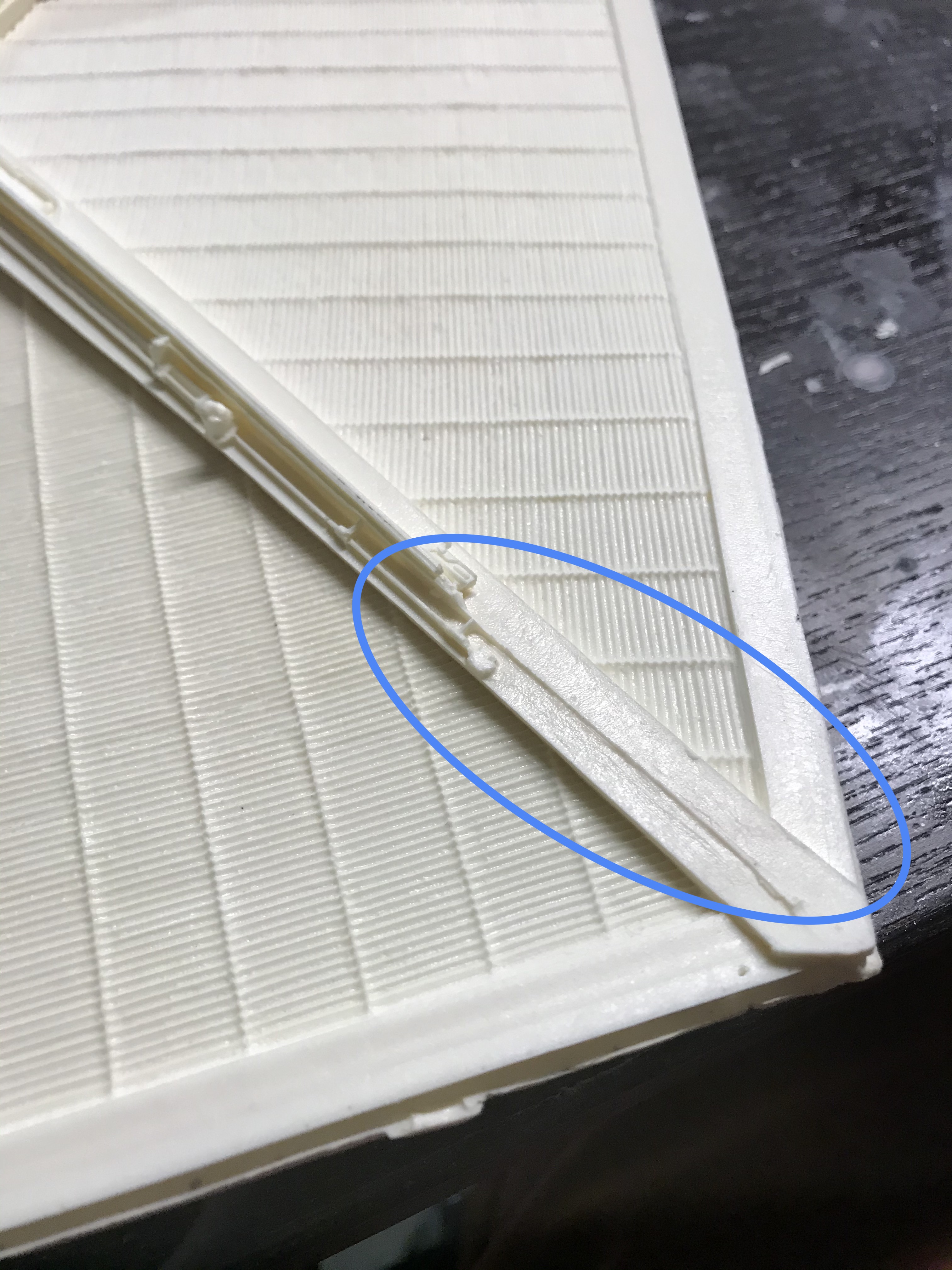

As you can see from that (and the pic below) there's a lot of work that needs to be done to this. Mostly on the wings, which are a bit warped, lots of clean up that needs to happen. Broken pieces that need to be rebuilt.

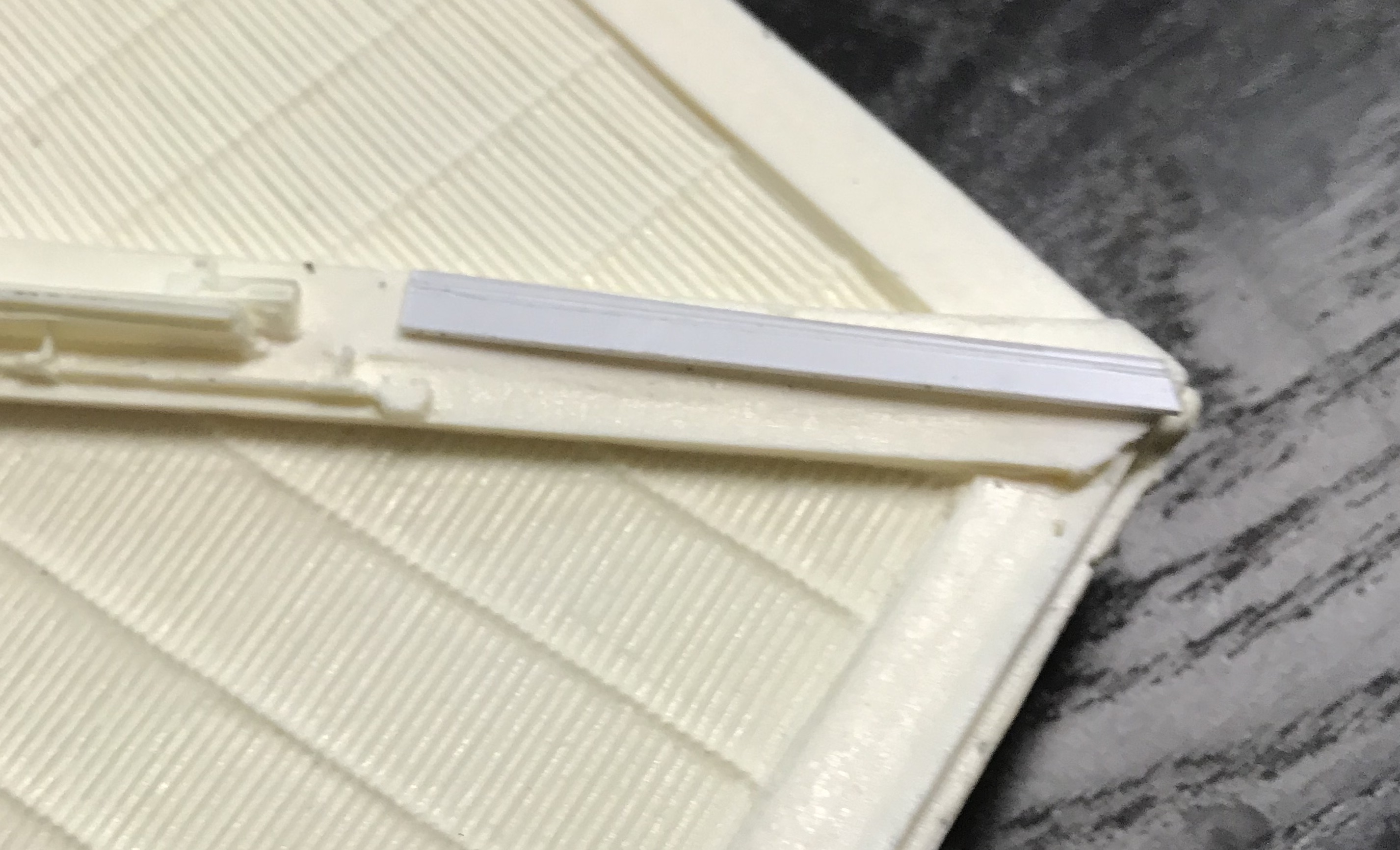

So first fix... rebuilding parts of the wing with styrene...
Pretty much replacing all of these as they have just snapped off. Even the slightest bump against them and they came undone. So I'm going to tackle this with a piece of styrene I have left over from... well gosh I don't remember what project that was for - ah well.
I'm just tracing the old piece, cutting out with an Xacto and then gluing on with CA glue and zip kicker.
The thing that stinks about this is that I'm not going to be able to re-create, easily, that little ridge on the original. Maybe I'll carve it out somehow... hrm...
So far the CA and zip kicker are holding nicely. I've replaced almost all of them. It's okay. I'm learning new things!

Go to your hobby store and see if they have a full selection of Evergreen styrene products or/and Plastruct. I’m sure you can find something to replace it. ILM used it in building several models.

Oof, I wish my hobby store was open. I'll check out some of the online places, I've been picking up stuff from ScaleHobbyist.com and a couple other places. Thanks for the tip!
